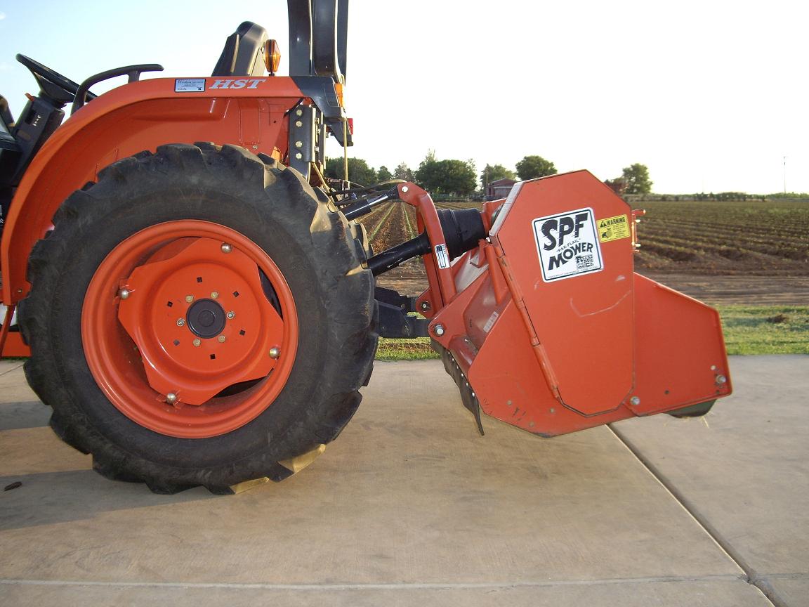

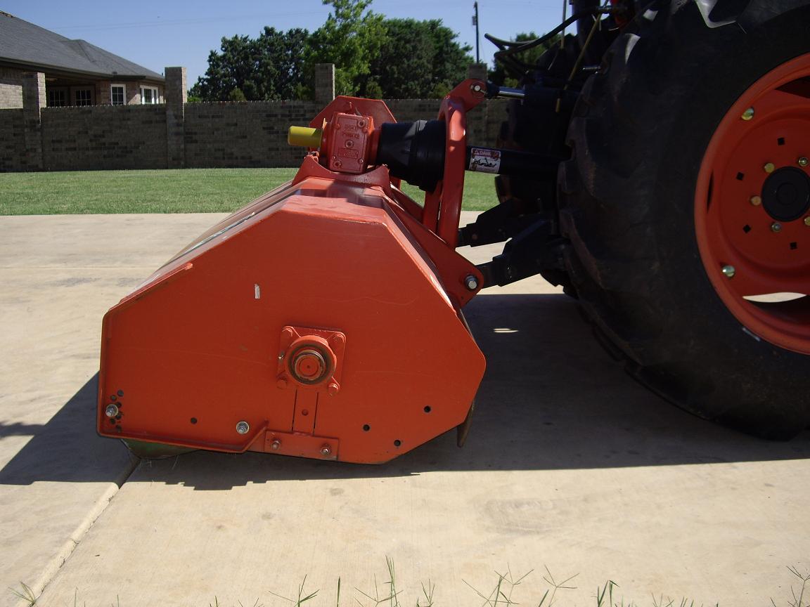

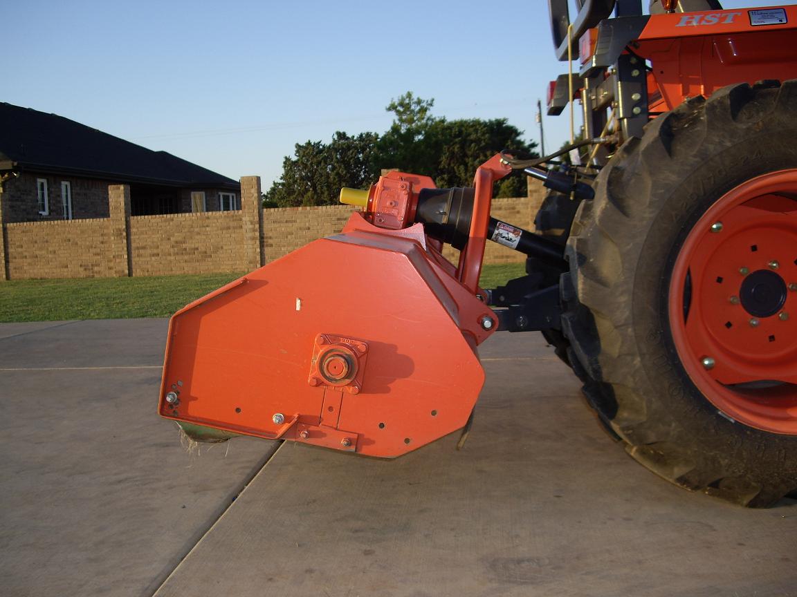

In another thread I mentioned I was confused by those who say they use a chain for a top link when using their flail so the mower will float.
I don't get it.
If I used a chain for my top link, my mower will flop over on it's nose. My mower floats on the rear roller and moves up and down just fine over uneven terrain the three point hitch just moves up and down with the mower. I don't carry any weight on the three point.
Please explain to me what you guys are doing. Like I said, "I don't get it"
Here are pics
The first two are the mower lifted (obviously) and the third is to show it on the ground. The only thing that keeps it from flopping over on the PTO shaft is the top link.
I also realize from pic 3 that I need to raise my roller so I can keep the mower a bit more level. It is set where I used it to mow the grass you see in the background. I use the Hydralic top link to set my cutting height

I think the reason some use a chain is due to mis-matched implement with 3 point hitch. I have read where some implements just dont match up to some of the smaller tractors.
There was a thread going around where a guy bent his top link. I didnt understand how that could happen, until someone pointed me several pages back in the thread where it was pointed out that one of the brakets was upside down.
I agree, properly setup, the implement should raise up as a unit when going over terrain. Without a toplink (i.e., chain), the flail will just roll forward... the lower links will not raise.

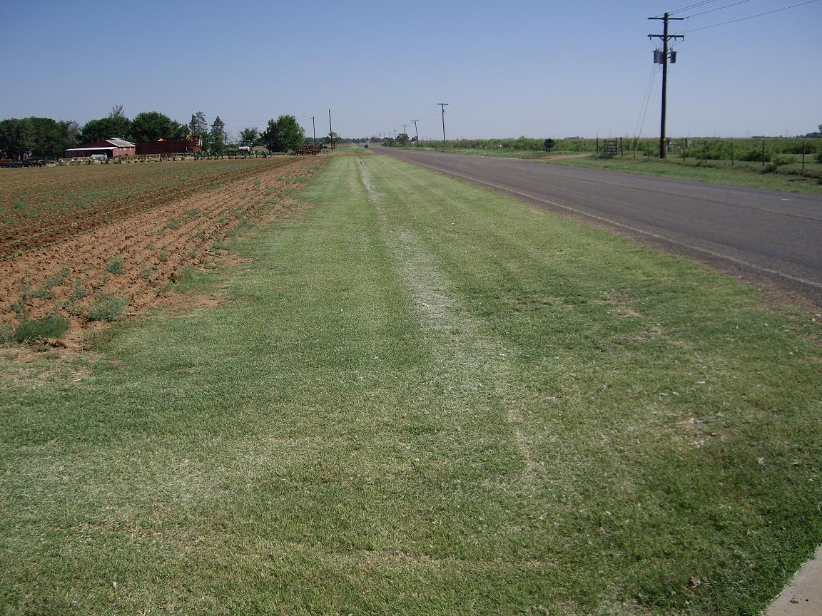

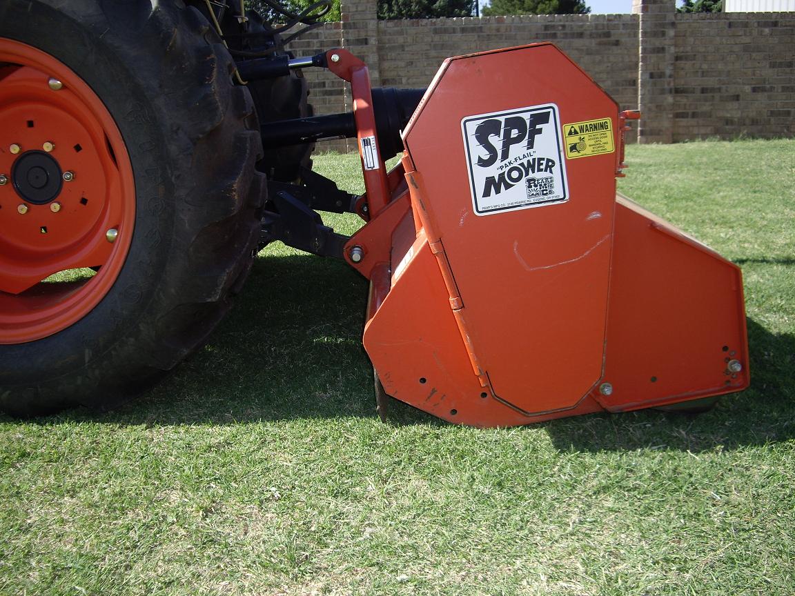

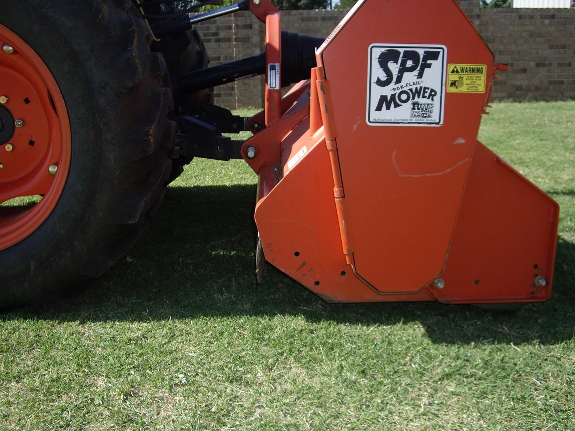

more pics, different cut heights all set with the top link
#1 set to cut low, even scalping all the way to the dirt
#2 Set to cut high, about 5 inches
#3 The bar ditch on the edge of my property that I mow with this mower.
