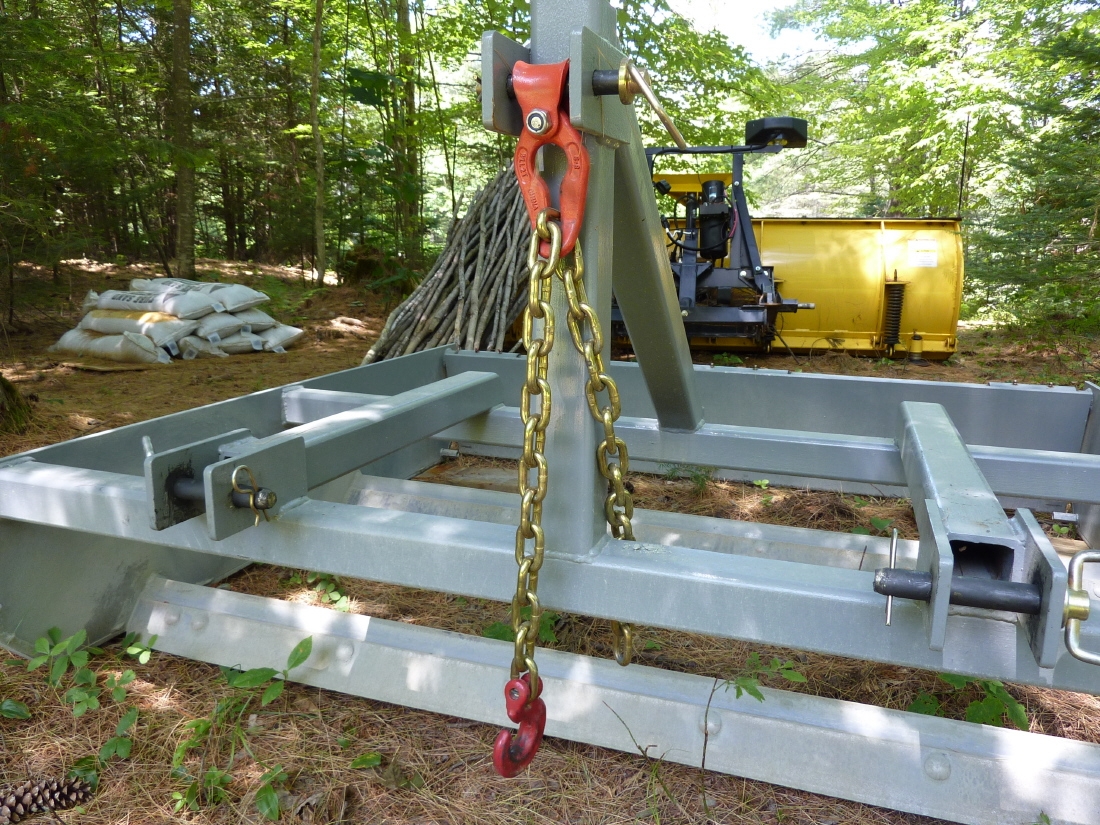

I rarely hook up the toplink to either the finishing mower or the bush hog. If there's a rock to hit, lifting the 3 point hitch gets it over any obstacle.
My 3 point hitch holds it's position quite well, no drop so no worries...
What does that do to the PTO shaft U-joints?
/ 3pt Top Link chain #24
After reading about guys using a length of chain top link, I made one. I considered what happens if the mower or land plane tips up all the way. My rotary mower would tip up to about 60° before the A-frame hits the back of the tractor diff. housing, but by then the PTO shaft has already broken, which I should've already known and shut down the tractor. Using a short pipe 6" shorter over the chain prevents this from happening.

/ 3pt Top Link chain #28
Don't really know, never a problem for me. Plenty of overlap but not enough to ever bottom out. The pto shaft and 3 point hitch arms are pretty parallel and only a few inches higher. So nothing gets into a bind no matter how deep a ditch I cut across.
As for the OP, not sure chains are recommended for any other implement except for mowers...

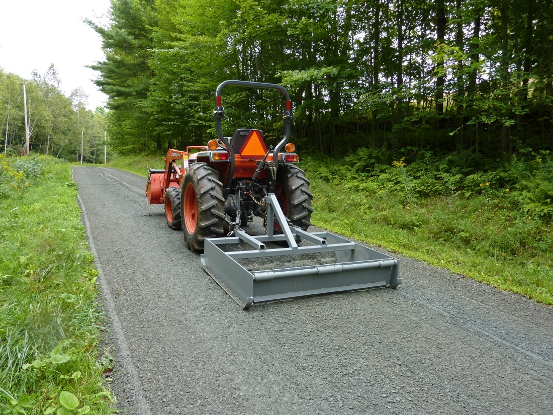

All., thank you! keep the comments coming. About 80% of my mowing is done going backwards. I live in a holler and to keep the roads and ditches clean its usually a case of backing the mower over the edge back and forth all the way, thank God for HST. I know that is not the intended design of a rottery cutter. But i dont have a flat peice of ground on this place except where i have made it flat. How do you thing using a chain would work out mowing backwards.

/ 3pt Top Link chain #32
Since no one has mention chain use on a box blade I'll point out that it works as long as you don't use the rippers which are mounted at the front and WILL tip the back of the attachment up. For just scraping it works well and follows the moderate ground humps and dips fairly well.
/ 3pt Top Link chain #34
For the most part I would agree but my experience has been when moving forward, the front tires will drive over dips and humps causing the blade to either lift or dig in as it passes. The chain can help with some of that initial leveling before finishing with the solid top link.
Any others with their experiences to improve land flattening with a box blade would be helpful.

Assuming the OP is using a Kubota L3901, I don't believe that model has draft control. I don't understand why every utility tractor does not have draft control which makes using a back blade or a box blade easier to control. As for leveling out the highs and lows. I move the tractor forward to fill the box blade then I push that pile in reverse with the cutting edge even with the bottom of the wheels. The result is a flat ground. This is how a dozer creates flat ground. As for the chain top link, NO.
