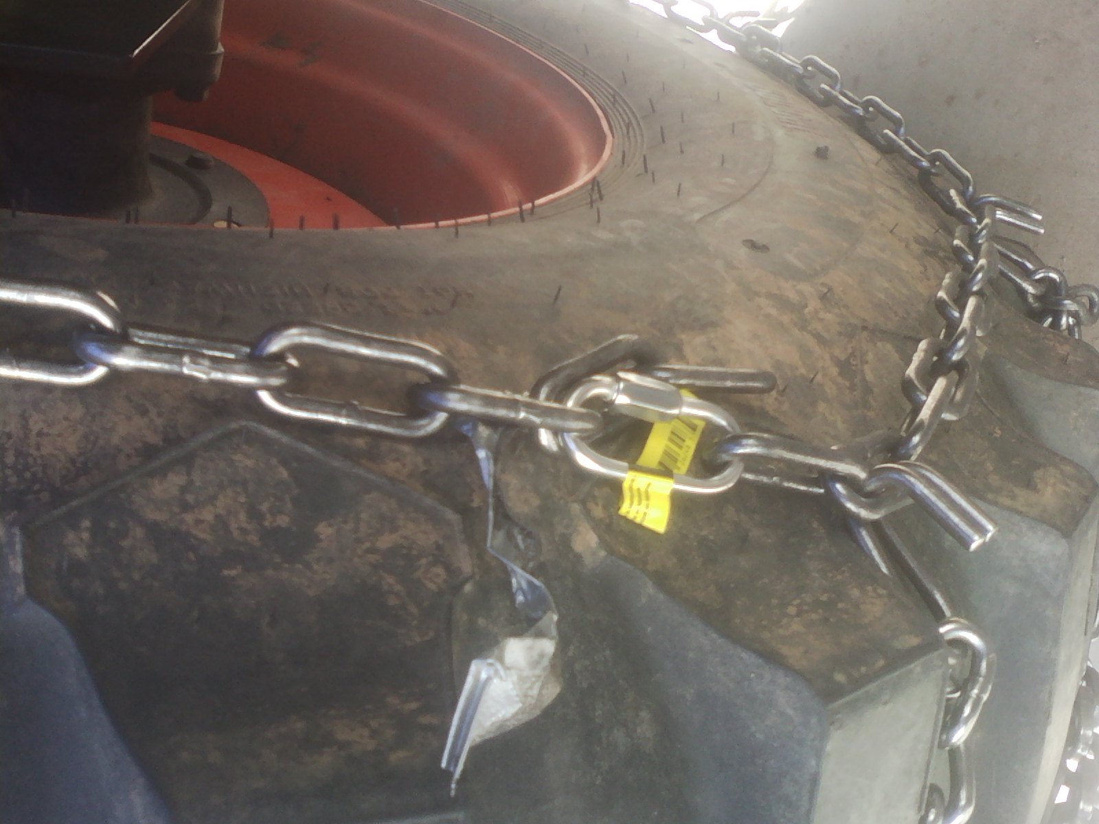

Well I started on the measurements today using the rope and tape method. I did not stretch the rope out, just snug, I will add a few links from this dimension as a start. I measured the center circumference and the length for the side chain. I also used the rope to measure across for width. I will need to adjust it for the side chain dimension. I have enough lug above the chosen location to hold them in place using chain tensioners.
The reason I am high on the sidewall at the base of the lugs is due to a clearance problem. I only have 3" free.
Next the layout and fabrication.
Thoughts and observations are welcome

If you're gonna run them that high, you'd better plan on keeping some bungies on them. If you don't, the chains will twist around sideways.
/ Chain fabrication help
#15
I have a heavy duty set of spring tensioners like this Adjusters Tensioners for Tire Chains the extra large set, so hopefully I will be good. I also got the tool to do them correctly.
I have marked up the cuts needed, but before I do I plan to jack up a rear tire and drape the set over and assemble on the tire for the first fitting. Should be fun. I have lots of baling wire to tie things together for a start :)

I am attaching photos of the test fit. It appears got the exact length needed, no extra, unless I did something wrong. I used a clevis on the inside instead of the cam lever tighter thought on this? Took up less room, but I may get a slightly bigger one for strength.
For width I used 3 links each side. If I go less I think I will end up short in the center. I may try 2 on the inside and 3 side links to the clip on the outside before I do any final cutting. I ended up with every 8th link for the side connections. I do have spring tensioners for the outside. Ant thoughts from the experts here. In this configuration it is snug at the center, but not tight I could just get the c-clips in the last H pattern using the lever ratchet. I will be setting the roll pin during the final install To install I draped over and connected the end to the tire using duct tape, then rolled forward, centering as I went. I did do a short test drive and everything stayed put so with the tensioners I should be good. It appear I still have good clearance with them setting at is.
Would appreciate feed back before I starting cutting and crimping.

Do you have fluid in the tires,, or can you do the deflate-inflate thing to tighten the chains??

I think the easiest way to install chains is with the wheel in the air. Allows you to tug at the chain and work the slack around the tire. I've never used a tensioner to take the slack out. Personally, having a adjuster on the inside and the outside has worked the best. That and some bungies on the outside to help keep them tight.
I run wheel spacers on my skidsteer and havn't had a single problem with them. Trust, me I've loaded that machine and a skidsteer has a significantly higher side load than what you'll see with any tractor. The steel spacers would be stronger than the aluminum ones so go with the steel spacers if you any concerns.
As for making chains, this really isn't hard to do. Just time consuming. Layout your cross chains, put the end links on and then layout the side chains. Make sure the chains are laid out correctly and start bending the side links closed. Every time you bend the side link you'll move the chain so there is no reason to lay out the whole chain at once. Just do one cross link at a time. Once you get all the cross links attached to the side chains, put your adjusters on and then drape the assembly over the tire. Now you can determine the final length of the side chains.
