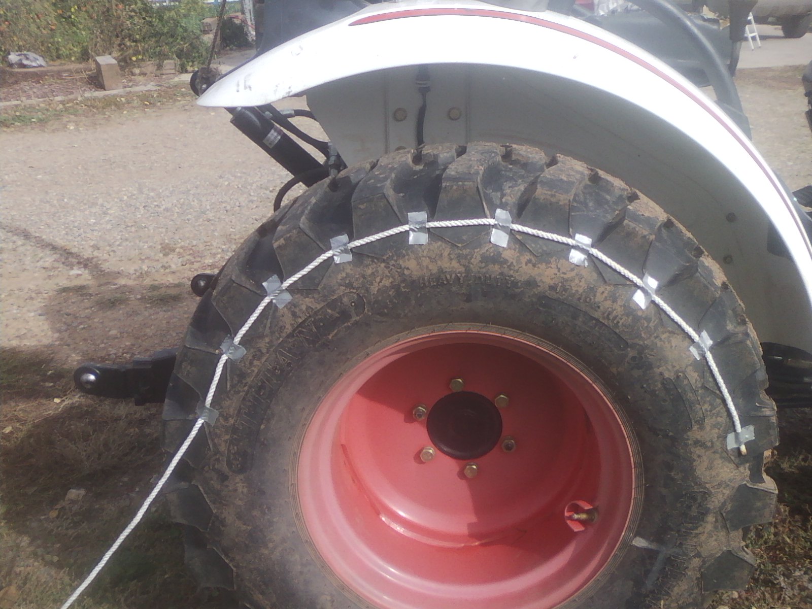

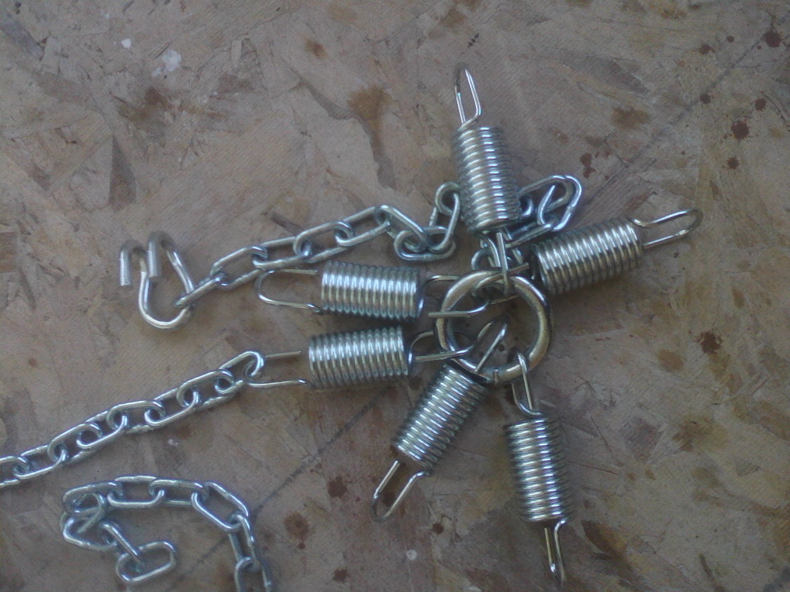

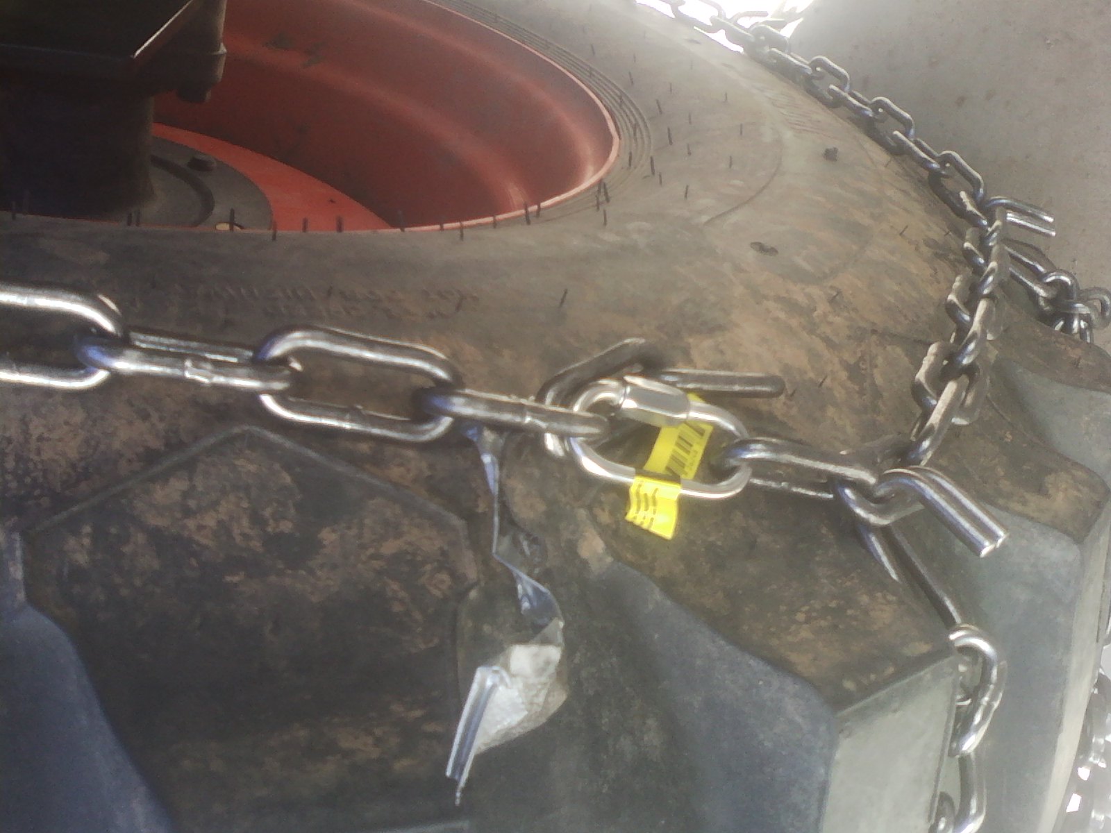

Well - I undid what I did and now have both sets fabricated. Next the fitment and fine tuning. It is helpful to have the correct tools. Without the chain tool it would have been much harder.
/ Chain fabrication help

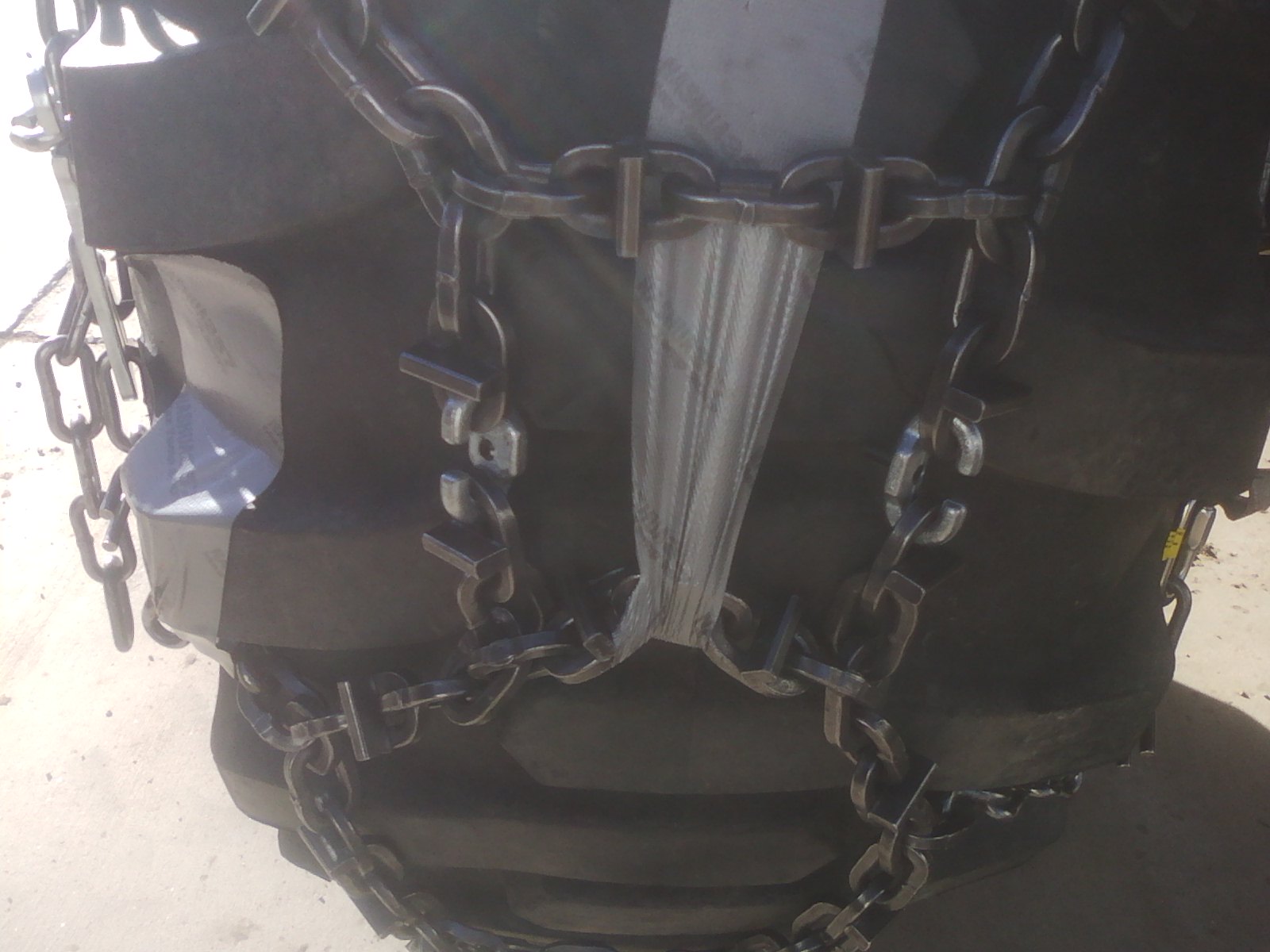

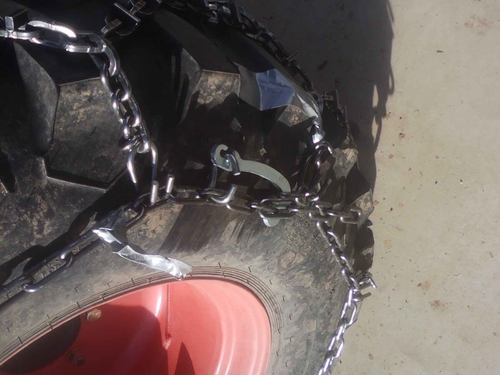

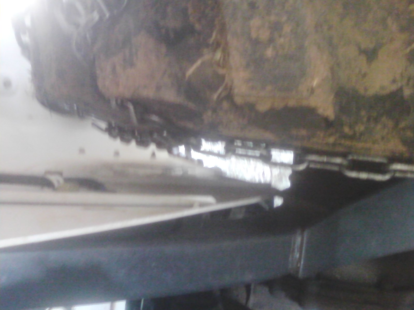

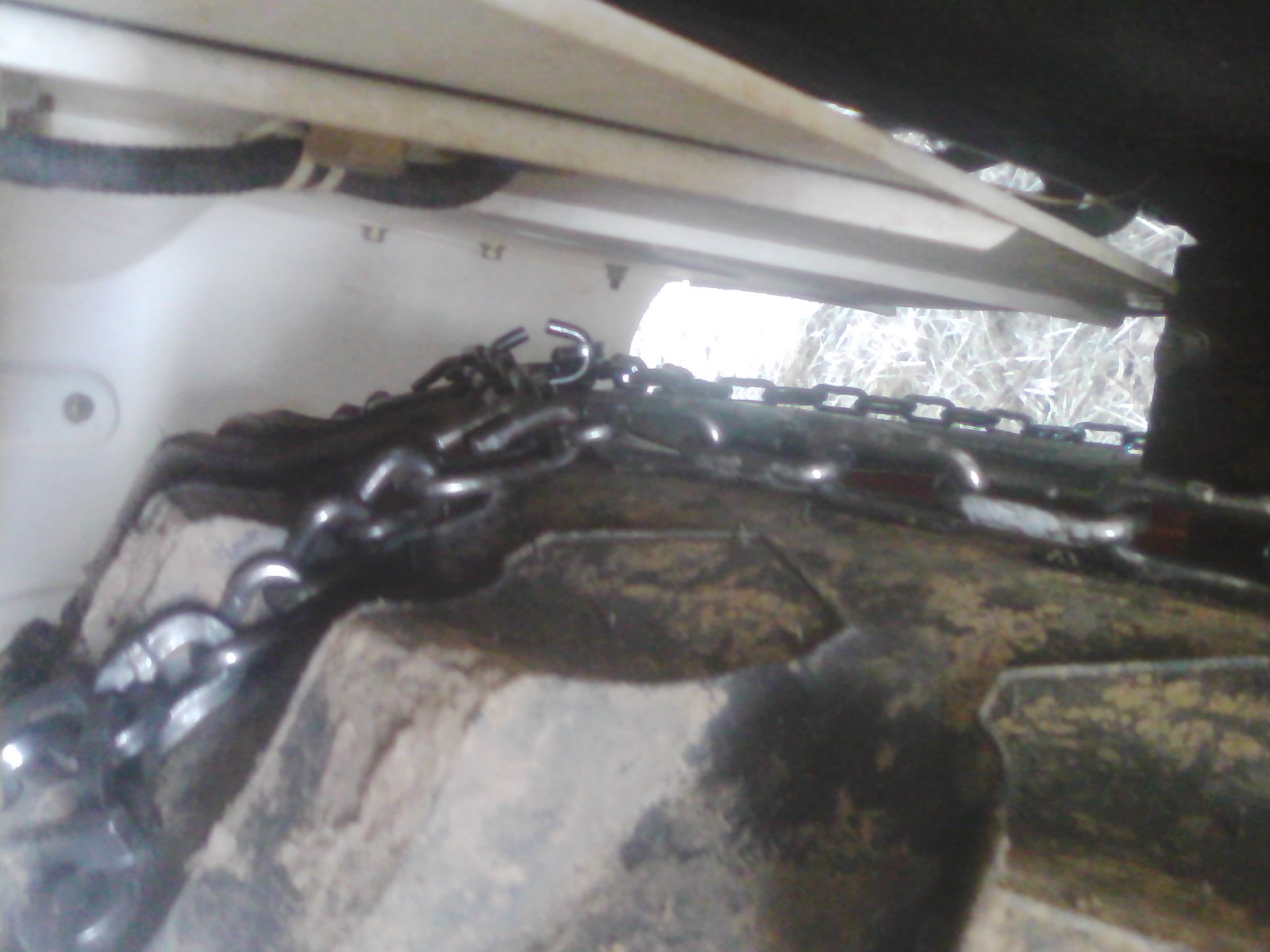

#26
Success - they fit. I have them 90% adjusted, just need to center the tensioners and trim the excess links on the inside. My son came for Turkey and I put him to work :D

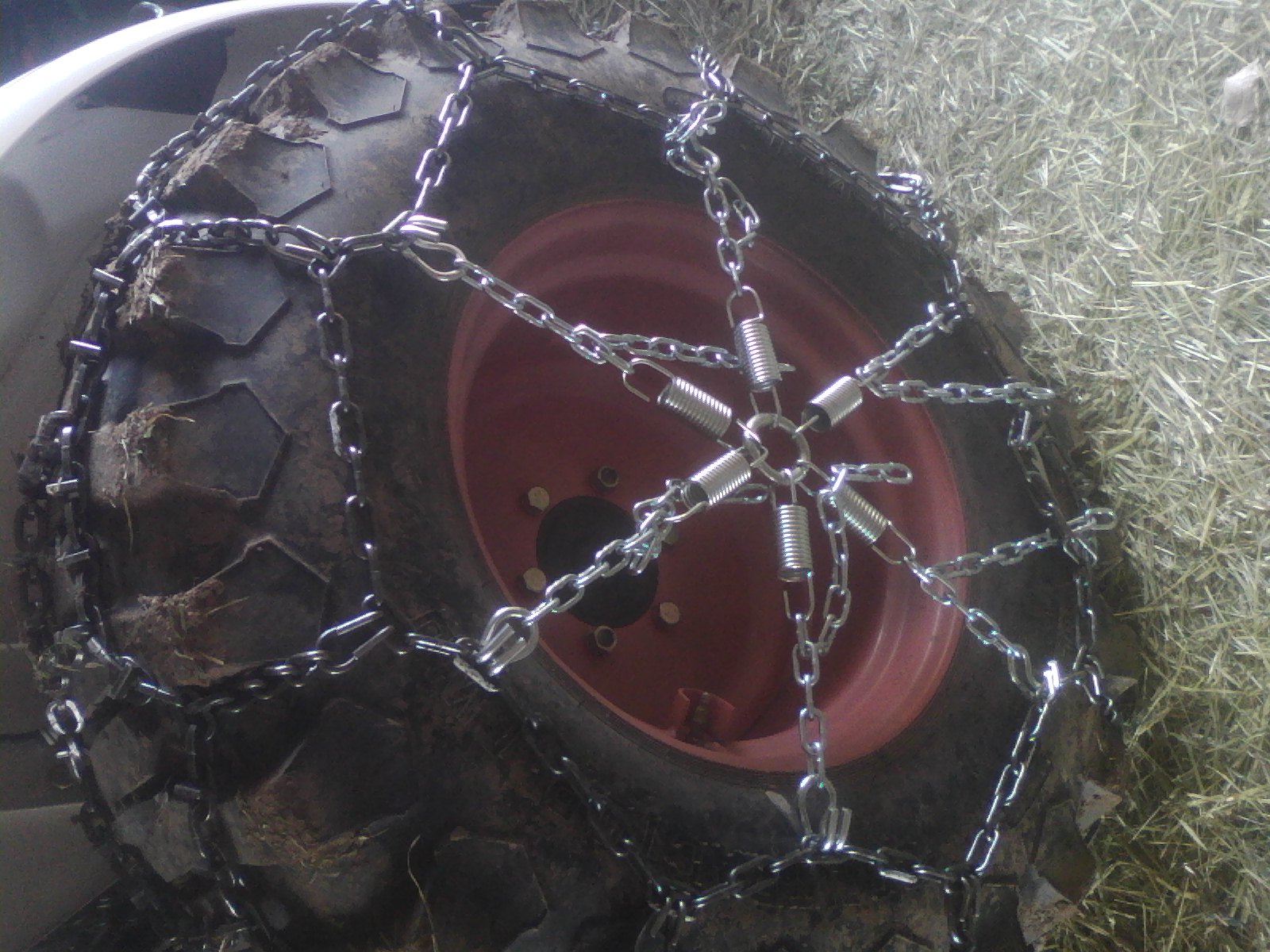

#27

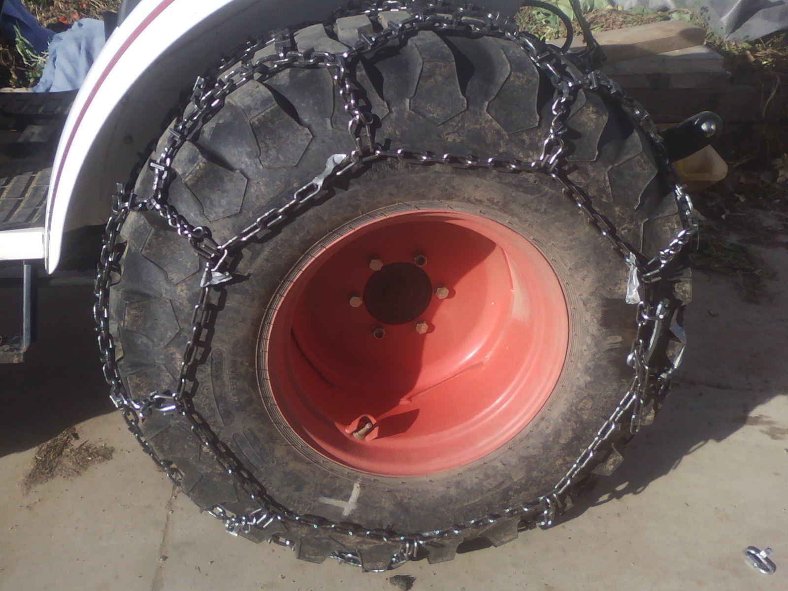

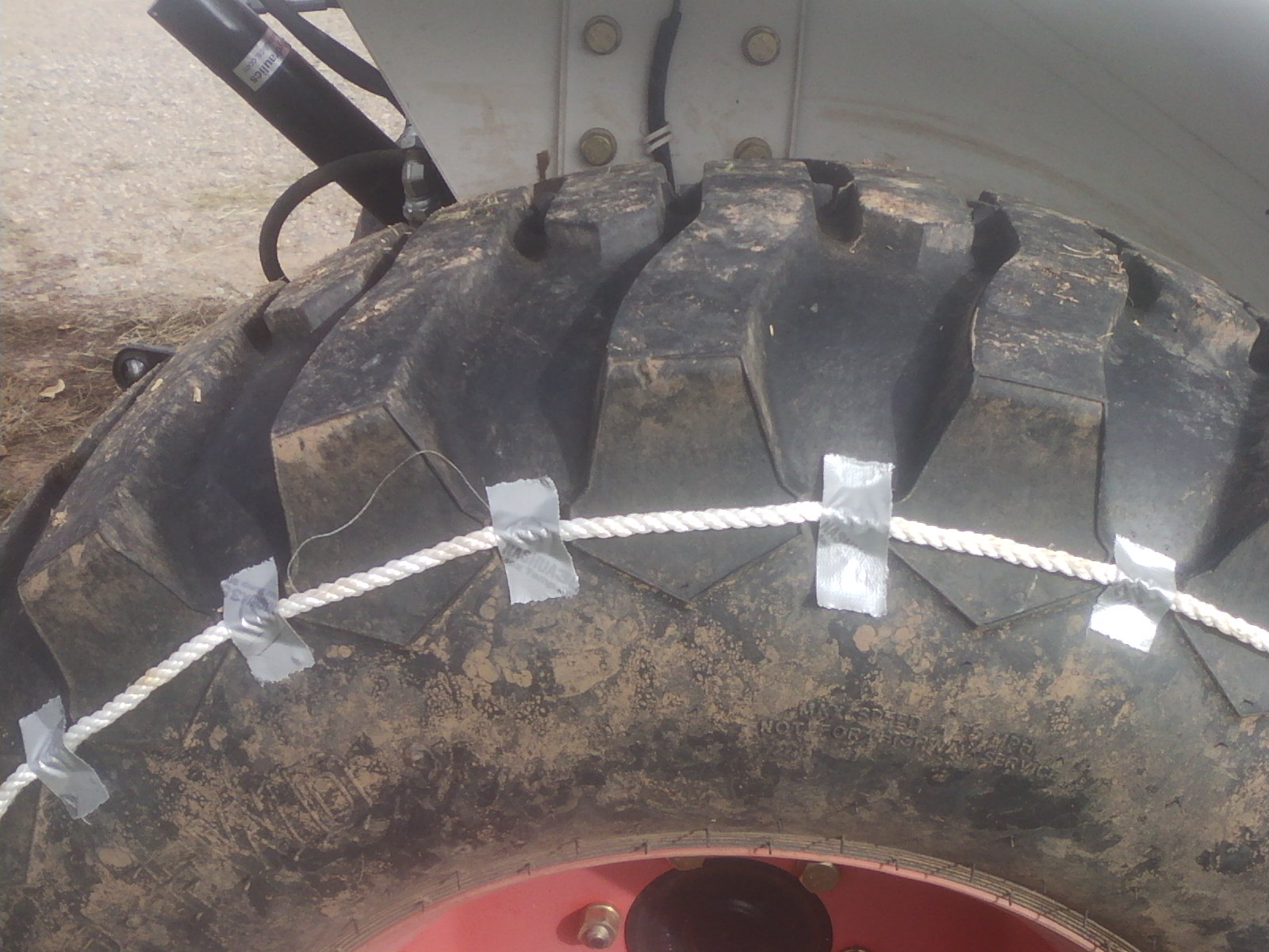

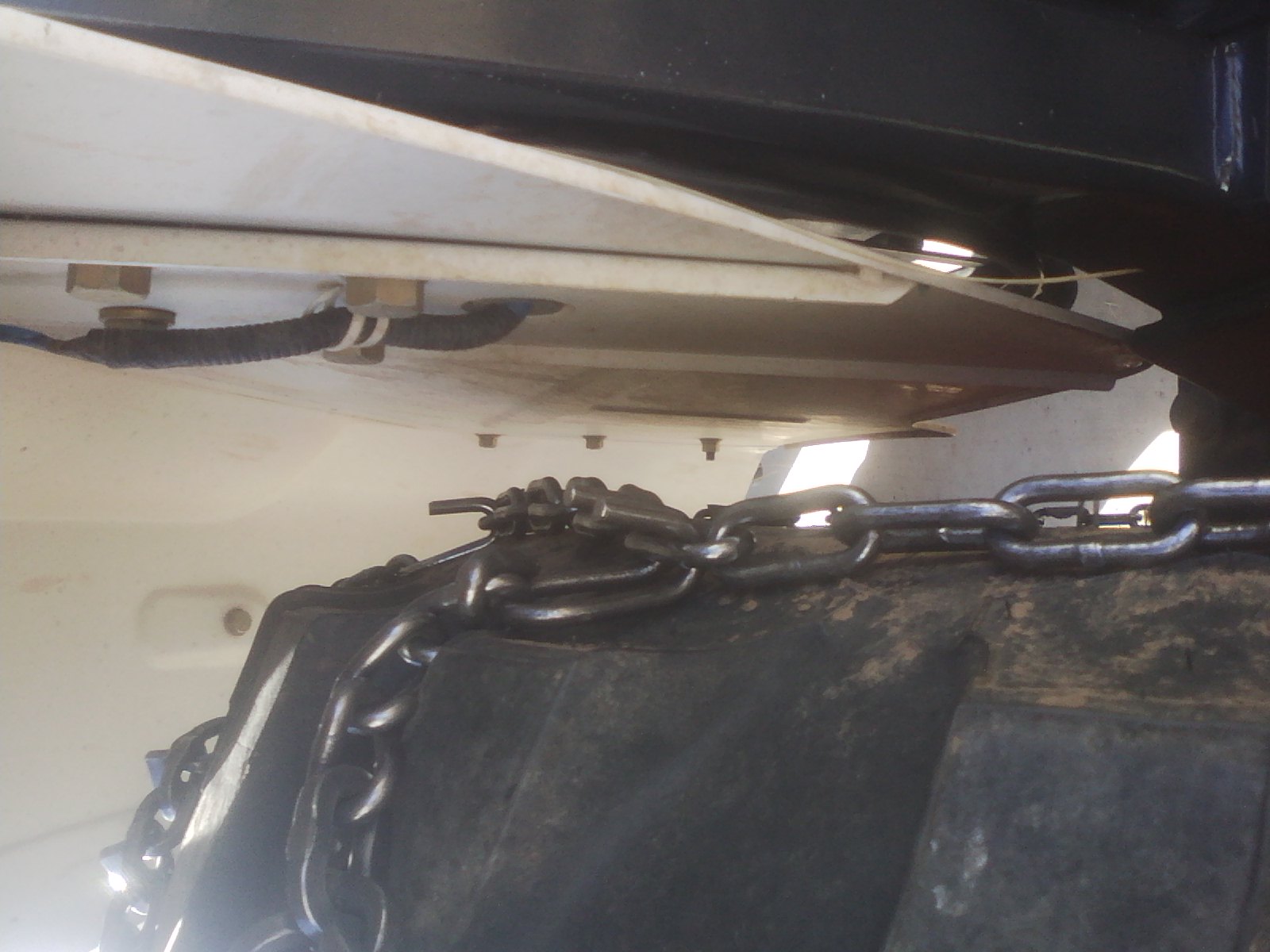

Well it done. Everything adjusted and trimmed with spring tensioners installed. Got the front on today too, just need to fill in the pattern on one side. Need some D clips from TSC

/ Chain fabrication help #28
Good job. Those look like aquiline (sp) chains with those ice bars. That tractor is unstoppable now.
