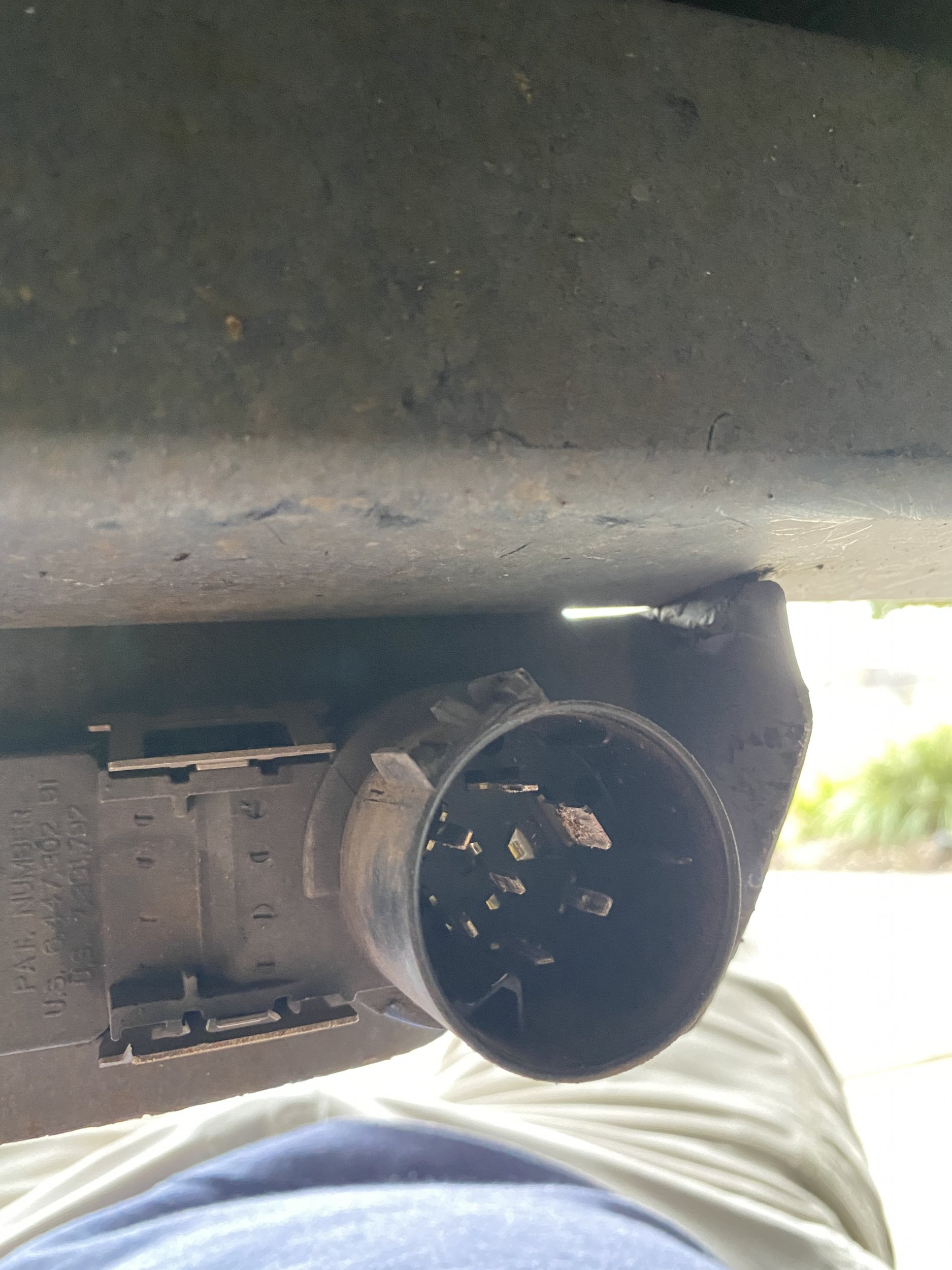

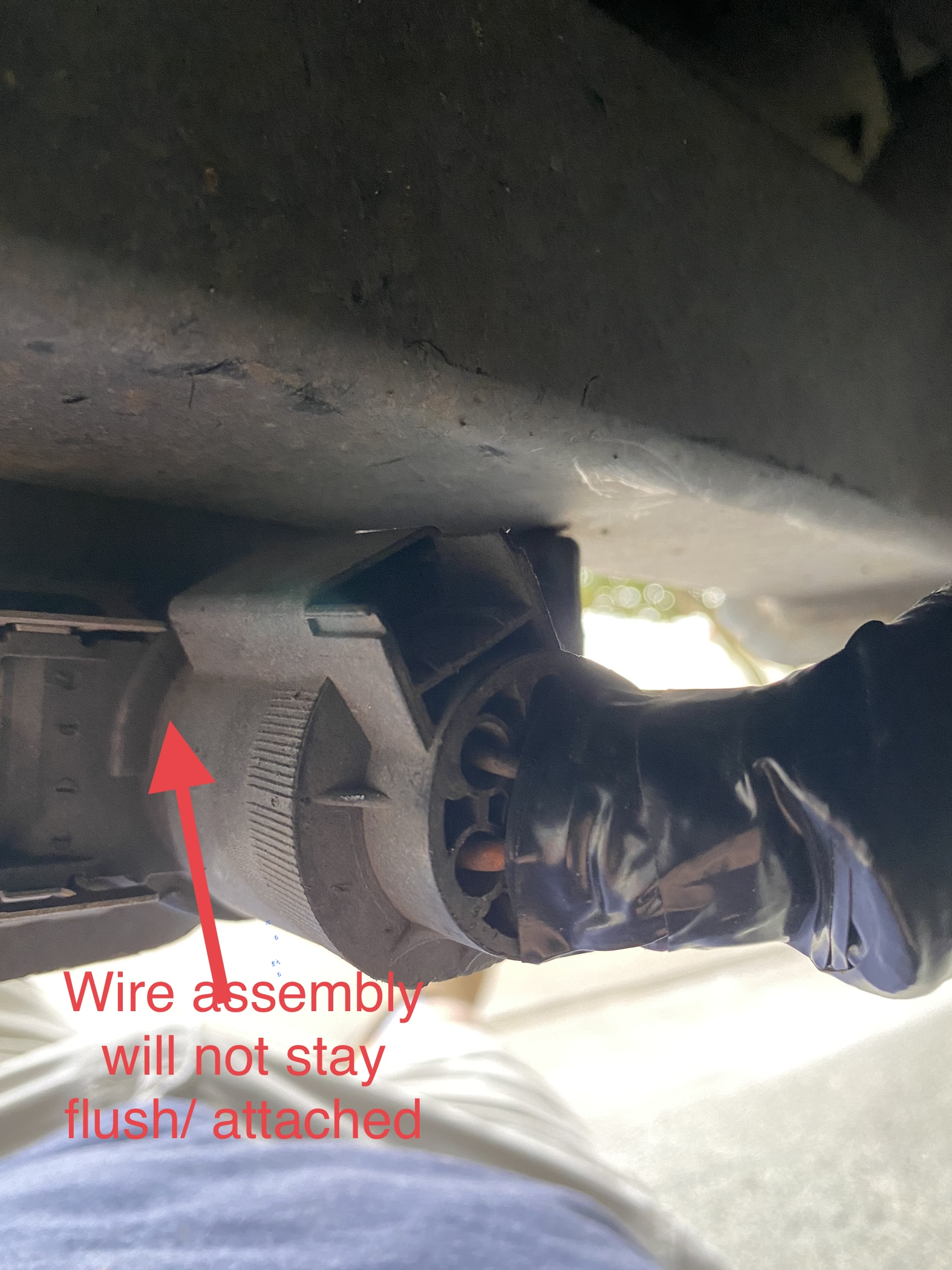

I think I found the problem
The wire assembly that comes from the electrical system will not stay engaged to the trailer adapter area. So none of the back receptacles were getting any power. When trying to attached that assembly, should it click in place or something?

It looks like to me, but I’m not any where near certain, there should be some kind of retainer or clip. I‘m looking at your second pic at about the 11 o’clock position. Sometimes there is a little red clip or some other kind of retainer.

you are missing the piece in the rectangle hole that clicks on to the socket. also, that ground pin is very corroded.
Thank you guys.
Herm, do you have a pic of the piece that I am missing and how it attaches?
I am assuming that the part that keeps the two bodies tightly together, when it went missing, it allowed moisture inside the receptacle and corroded some of the pins.
Does anyone know what is involved to replace the receptacle? Would a new receptacle have the new/missing piece?

I’ve never seen the retaining clips for sale but they could be. I’ve seen several different styles so I don’t know what yours looks like. It most likely comes with the wiring harness and not the plug in socket.
Maybe a Ford dealer can sell the retainer?

The problem is I cannot keep the wire harness head securely attached to the trailer receptacle. Furthermore, as pointed out, the grd pin seems to be oxidized, but I cannot test it anyway as is...guess I am going to have to splice on a new harness cap and replace the receptacle. Unless someone has a better solution, I believe that is where i am...
