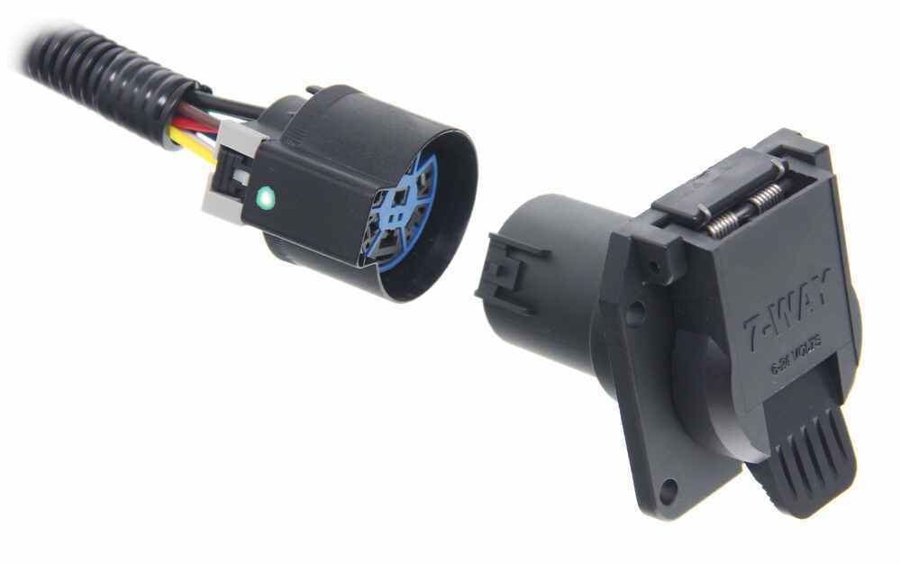

I think I found the problem
The wire assembly that comes from the electrical system will not stay engaged to the trailer adapter area. So none of the back receptacles were getting any power. When trying to attached that assembly, should it click in place or something?
Follow the bundle of wires from that receptacle plug back up to where it goes along the frame to the front of the truck. There is probably a plug connection and you can just go buy that short section.
Something like this,

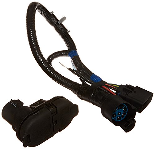

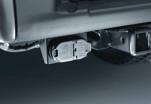

Not sure if your F150 has this type of truck connector on it...
If it does you can order the entire OEM ford kit for a little over $60.... It includes the 7way / 4way connector & the rear wire harness with retainer clip all plug & play with your F150 harness.... This would replace / repair all the damaged / corroded parts & keep it factory.
Double Check but the part numbers should be:
Ford Part # 9L3Z-15A416-A - F-150 2009-2010 TRAILER HITCH HARNESS W/O REVERSE PARK AID
Ford Part # 9L3Z-15A416-B - F-150 2009-2010 TRAILER HITCH HARNESS WITH REVERSE PARK AID
These part numbers should fit a 2014 Ford F-150 FX2, FX4, King Ranch, Lariat, Limited, Platinum, STX, XL, XLT 3.5L V6 - Gas, 3.7L V6 - Flex, 5.0L V8 - Flex, 6.2L V8 - Gas
Or if the wiring is all good and you know what you are doing you could buy just the rear female 7 pin plug (any automotive store) and reuse the existing wiring harness.

Thank you dlc..that dog will hunt…I’ll find those parts, order, install & post back w install pics / hopefully this can help someone else in the future..you guys are great !
/ Can NOT get trailer lights to work
#30
And yes, that is the exact type of trailer receptacle for my f150. Thanks again for everyone ones suggestions & help.

dlc & company,
I chatted w a Tasca customer rep and the first link [16-A] is the part. The harness has one end [rd] for trailer receptacle and other end that's rectangular and plugs in somewhere underneath the back. I asked him if he knew the length of the harness and he did not. If anyone knows, that would be great bc it will tell me in [ft/inches] how far to look from the receptacle to see when the rectangular part plugs into existing harness. This is obviously critical so no splicing is involved. Thank you very much! hope to have this ordered by end of day w all info in hand....
/ Can NOT get trailer lights to work #40
@tstex
The parts guy at Tasca is sort of correct.... I believe the harness has 5 or 6 direct connect plugs on it... (see pic below)... I believe 2 connect on the right rear & 2 on the left rear near the tail connections on the harness... The others 1 or 2 connect to the truck harness on the frame (I believe one is power & the other is for the fuses & brake controller.... but don't hold me to that)
It is not a very long harness all connections should be at the rear of the truck... when you get the new one & lay it out it is pretty straight forward. I installed one on my brothers truck yrs back... so I'm going on memory...
