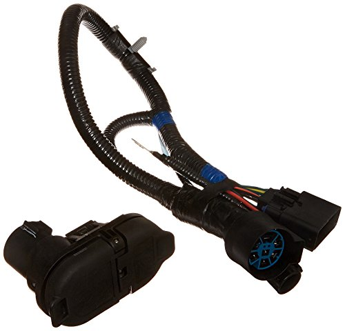

I think I found the problem
The wire assembly that comes from the electrical system will not stay engaged to the trailer adapter area. So none of the back receptacles were getting any power. When trying to attached that assembly, should it click in place or something?
Follow the bundle of wires from that receptacle plug back up to where it goes along the frame to the front of the truck. There is probably a plug connection and you can just go buy that short section.

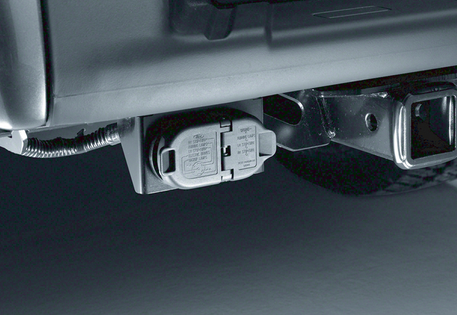

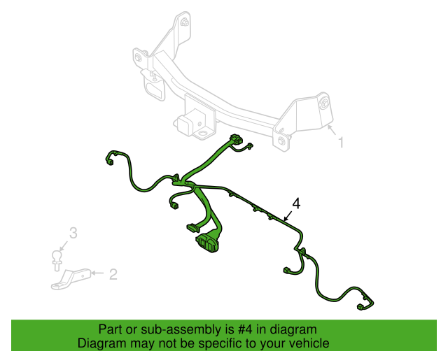

Not sure if your F150 has this type of truck connector on it...
If it does you can order the entire OEM ford kit for a little over $60.... It includes the 7way / 4way connector & the rear wire harness with retainer clip all plug & play with your F150 harness.... This would replace / repair all the damaged / corroded parts & keep it factory.
Double Check but the part numbers should be:
Ford Part # 9L3Z-15A416-A - F-150 2009-2010 TRAILER HITCH HARNESS W/O REVERSE PARK AID
Ford Part # 9L3Z-15A416-B - F-150 2009-2010 TRAILER HITCH HARNESS WITH REVERSE PARK AID
These part numbers should fit a 2014 Ford F-150 FX2, FX4, King Ranch, Lariat, Limited, Platinum, STX, XL, XLT 3.5L V6 - Gas, 3.7L V6 - Flex, 5.0L V8 - Flex, 6.2L V8 - Gas

Thank you dlc..that dog will hunt…I’ll find those parts, order, install & post back w install pics / hopefully this can help someone else in the future..you guys are great !
   / Can NOT get trailer lights to work
#30
And yes, that is the exact type of trailer receptacle for my f150. Thanks again for everyone ones suggestions & help.
