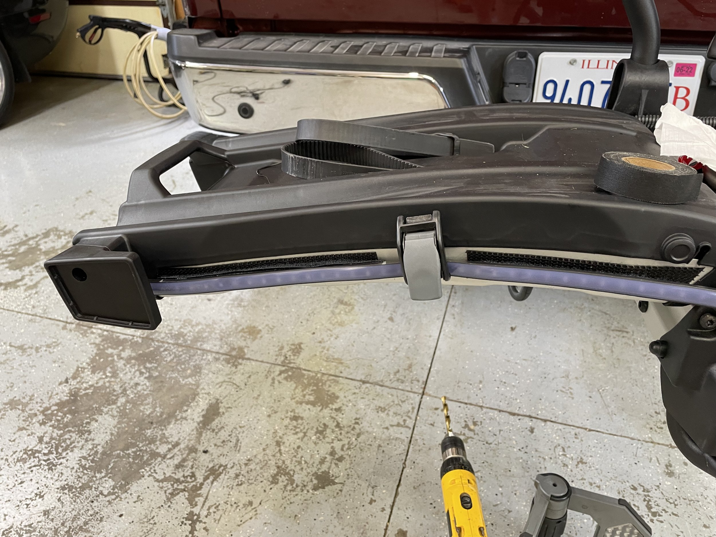

Not a great picture, it of the lights I added to a bike rack, but if you look closely you can see the trailer lights plug in to the left of the license plate. It’s that way from the factory.
