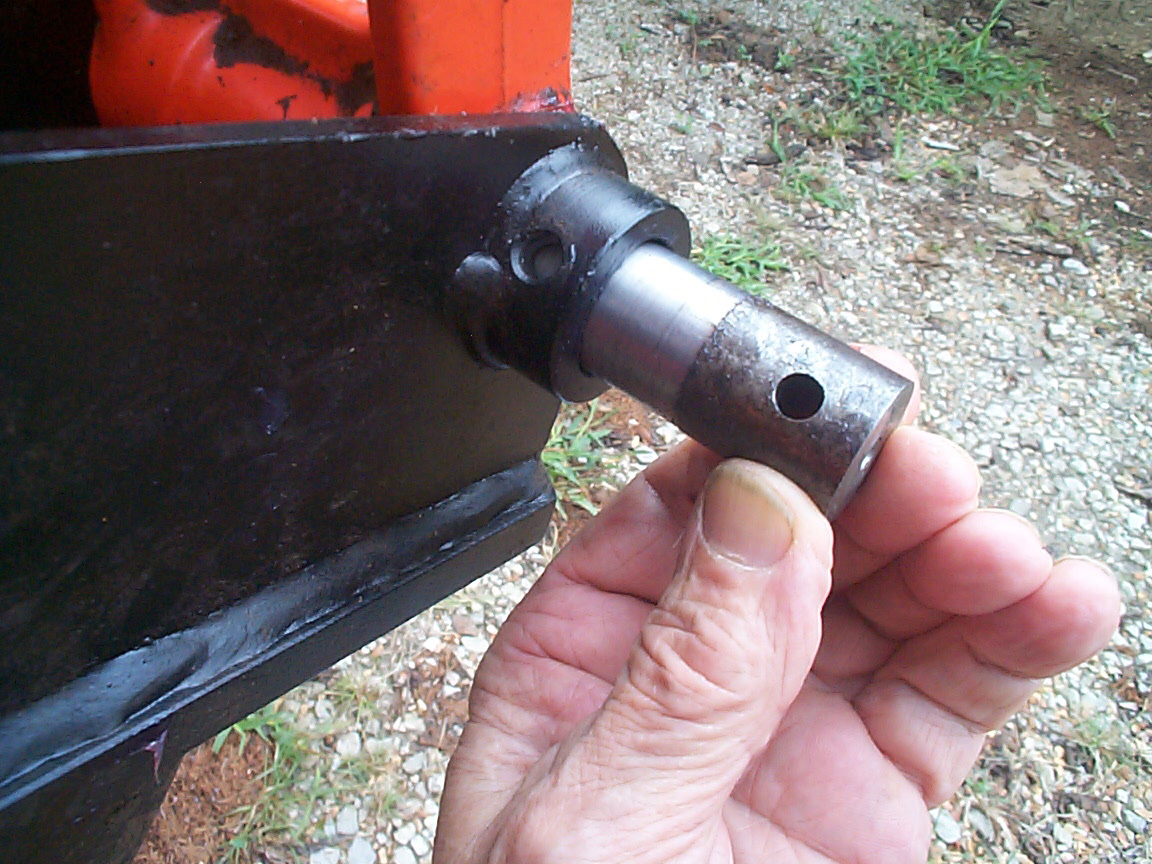

I ordered this ripper last week, & thanks to ryan08's timely information, I was able to add the pins to my order after a credit card glitch delayed my shipment.
It arrived today, & I think I was able to figure this issue out. I too was unable to get the DR pins to pass thru the Kubota pieces, so I compared the diameter of the Kubota bucket pin to the diameter of the DR pin. Turns out the DR pin is just a couple thousandths over 1", but the Kubota pin measured about .978.
Since .984 = 25mm, I think the obvious answer is that the Kubota pieces are metric, & the DR pins (& mounting holes) are SAE.
Close enough for me though, I chucked the pins up in my lathe, & whittled about .010 off to get the diameter to about .980". I left the first 1" untouched to keep the pin tight in one side of the ripper. Not sure if I will try to come up with something to bush the other hole to the new dimension, or add some .010 shim stock when mounting it. Will probably just use it without anything unless I plan on using it for a long project. Or since the pin is bolted to the ripper & rotates in the Kubota pieces, it might make sense to just deform the holes in the ripper slightly on that side.

/ BX25D backhoe ripper question #69
No need to drill both ends (you can't anyway, because the thru bolt hole will interrupt the flow on that end), you only need to drill about 2 1/4" to get past the first bushing inside the Kubota pieces. From there it opens up some, & the grease will surround the pin & flow to the other side. Of course you need to cross drill to wherever you stop to give a path out for the grease. The Kubota pin is drilled about half way, but that's not really necessary. You're also gonna want to counterbore enough to recess the fitting big enough to fit a grease coupler.
I decided not to bush the end I turned down, because the fit was not much different than on my low hour backhoe bucket, and that piece doesn't even have a boss to hold the pin, just a hole in the plate. The ripper has much more robust pin bosses. And since the pin is the correct size for the machine, nothing orange is subject to wear. Another option is to grind off the bosses on the ripper & weld on some with the 25mm ID.
For those not wanting to mess with machining pins, you might try ordering the Kubota pins that are next up on the dipper stick. They are the correct length, are retained by a thru bolt like the ripper, & already drilled for grease. Then you could either live with the slightly sloppy fit on the ripper (I suspect the guy that wrote the review on the DR website did just that), shim the bosses with some .010" brass, or tighten the fit of the bosses by deforming or replacing them. Remember the pin does not rotate in the ripper tooth. Not sure of the price of the Kubota pins though.

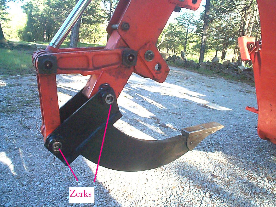

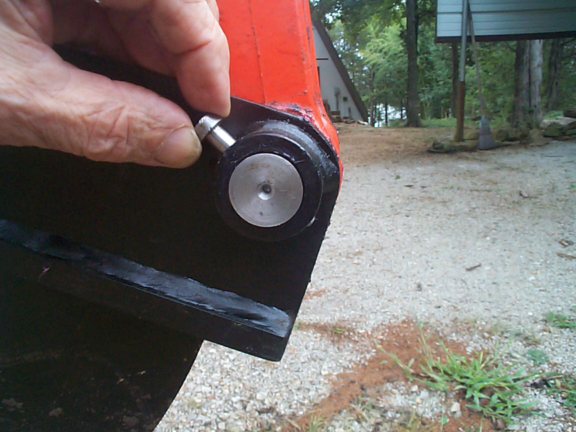

/ BX25D backhoe ripper question #75
First of all - thanks to all who contributed to this thread. I would never have guessed that the ripper attachment from a DR would exactly fit a BX25.
That said, here are some pix of the pins I machined, and installing them.
I gave the ripper a workout on a couple of stumps - WOW - what a difference from trying to use my small bucket on the backhoe.
