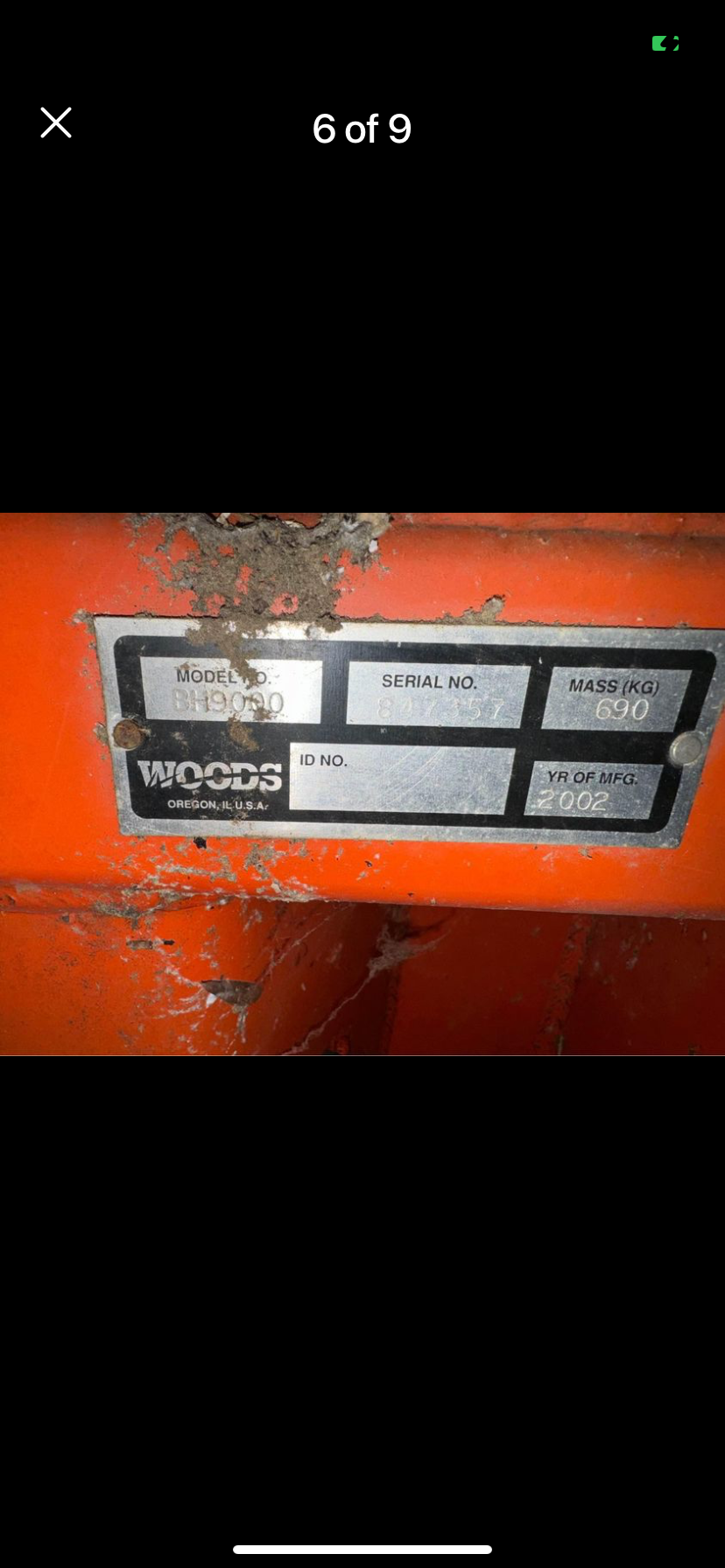

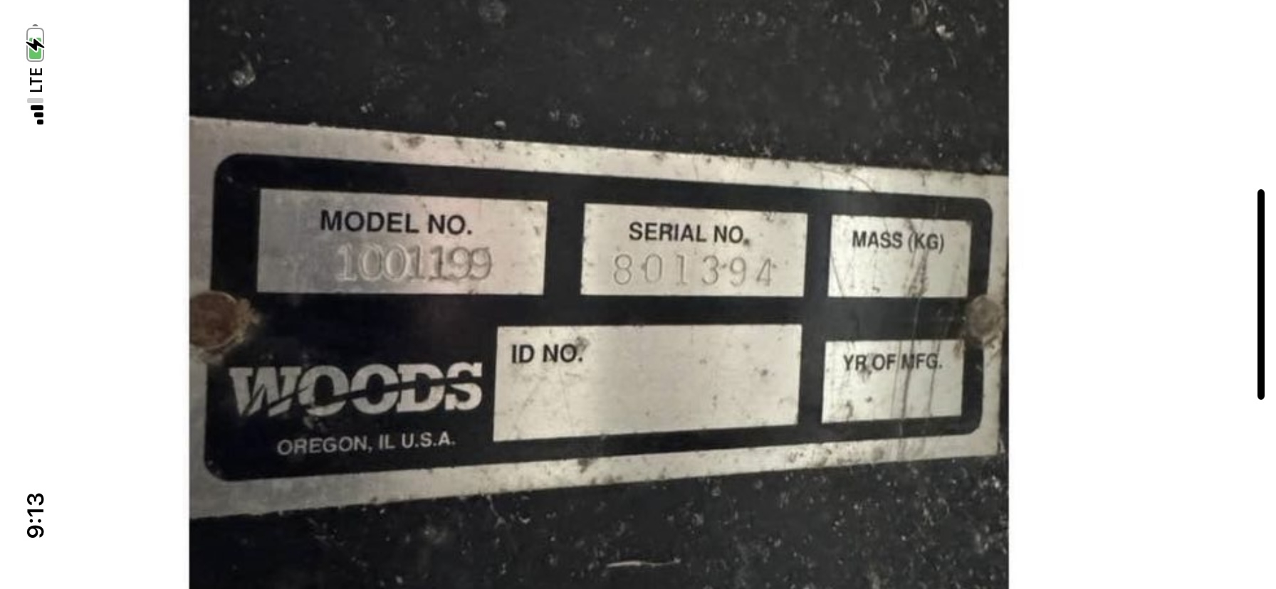

Good day to you all. I recently purchased a Kubota L3710 HST. And am thinking of buying a used, in good shape, Woods BH9000 backhoe.
The backhoe is advertised as coming off a Kubota L4310. It has a frame mount with the number 1001199 on the plate. It is a self contained unit with its own PTO pump.
The only difference is that the L4310 tractor it came off of is a cab tractor. My L3710 is not. Just open rops.
Does anyone know if this frame backhoe will definitely work on my L3710?
I believe this frame will fit all the Grand L10 series tractors. But am not positive, and am trying to be sure. And I don’t know if there is a difference in the frame for a cab tractor and rops tractor on these older units.
I appreciate any help you can give.

I'm going to guess that it will fit. The frames and mounting points should be the same on both tractors. (Note that this is a "guess".)
Do you know if the package includes ALL the parts? It's not unusual to get a subframe that doesn't include the mounting bracket(s) that bolt to the tractor. Understandably, those often get separated. There's likely a bracket that bolts to the loader mounting frame or tractor frame at the middle of the tractor. Usually a long pin goes through that bracket and the removable part of the subframe to install the backhoe.
If the subframe fits your tractor and it's reasonable, you should jump on it. They're hard to find. You're also in a good bargaining position because the subframe won't fit most tractors. But you should verify if it includes everything you need to mount it, since the brackets that bolt to the tractor often stay with the tractor. Not that you still won't want to buy it -- just so you're not surprised later.

I did ask him if he has all the mounting brackets and hardware that mounted it to the L4310 with it. And he said yes.

The L3710 and L4310 are basically the same tractor. The main difference is a slightly larger engine in the L4310, (2.2l vs 1.9l). You will be fine.

I don’t know if this applies to the l series but for the cabbed b series and kubota bh77 there is a spacer to provide additional clearance between the tractor / cab / subframe and the backhoe. Since the backhoe came off a cabbed tractor it should include those spacers but you should not need them on a rops … assuming woods flows the same concept.

You will probably need to cut and drill shim plates to fit the BH frame mounts to your chassis

Hey Hey! I called Woods and Dan with Tech Support told me that model subframe, for that model backhoe, is designed to fit my tractor. Several models from the Grand L10 series, 3010 thru 4310, including my L3710. I think I’m going to buy it.
