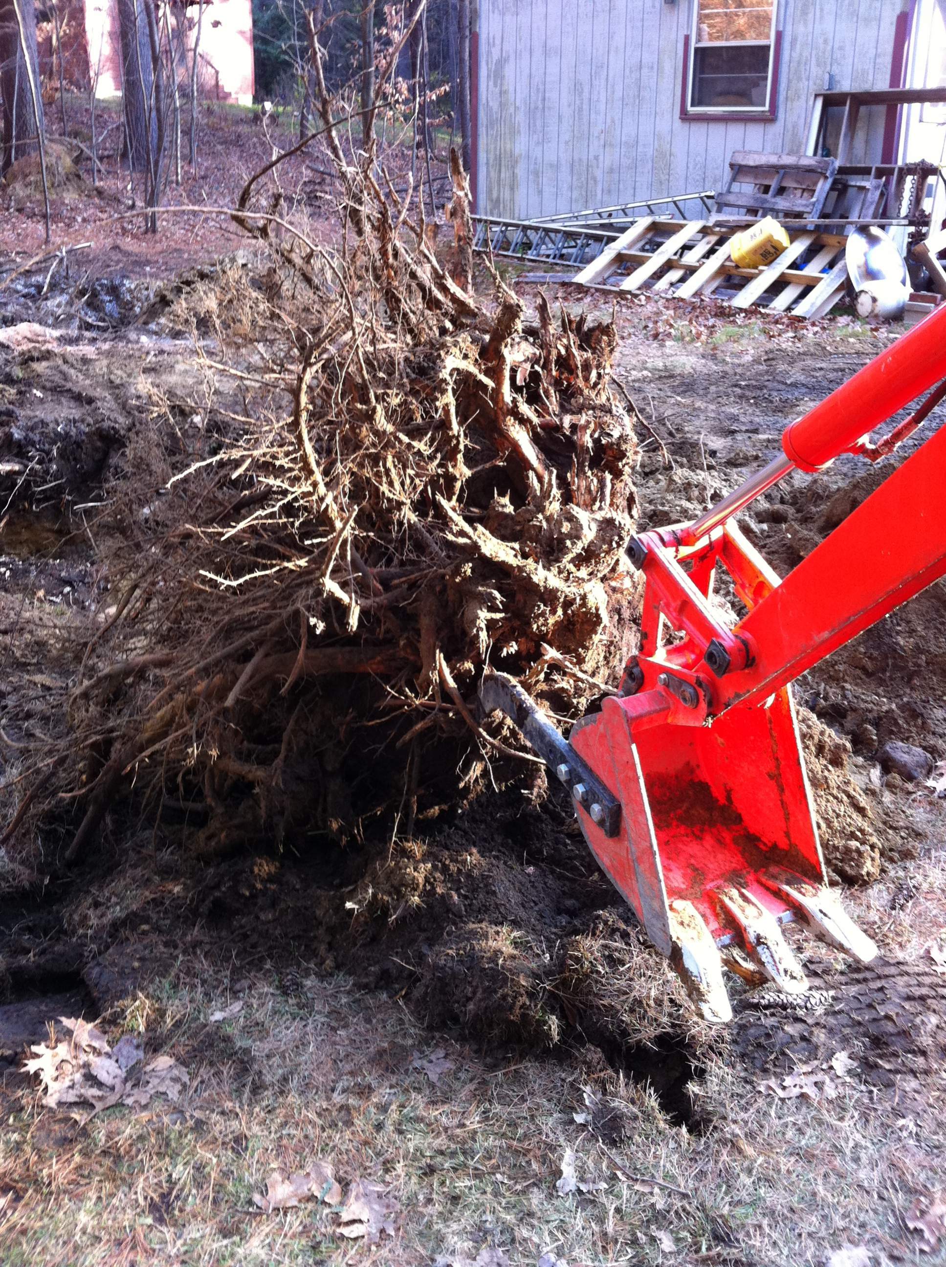

I think I recall someone from here bolted a ripper from a boxblade to the side of his backhoe bucket, & it seemed to work out pretty good.
