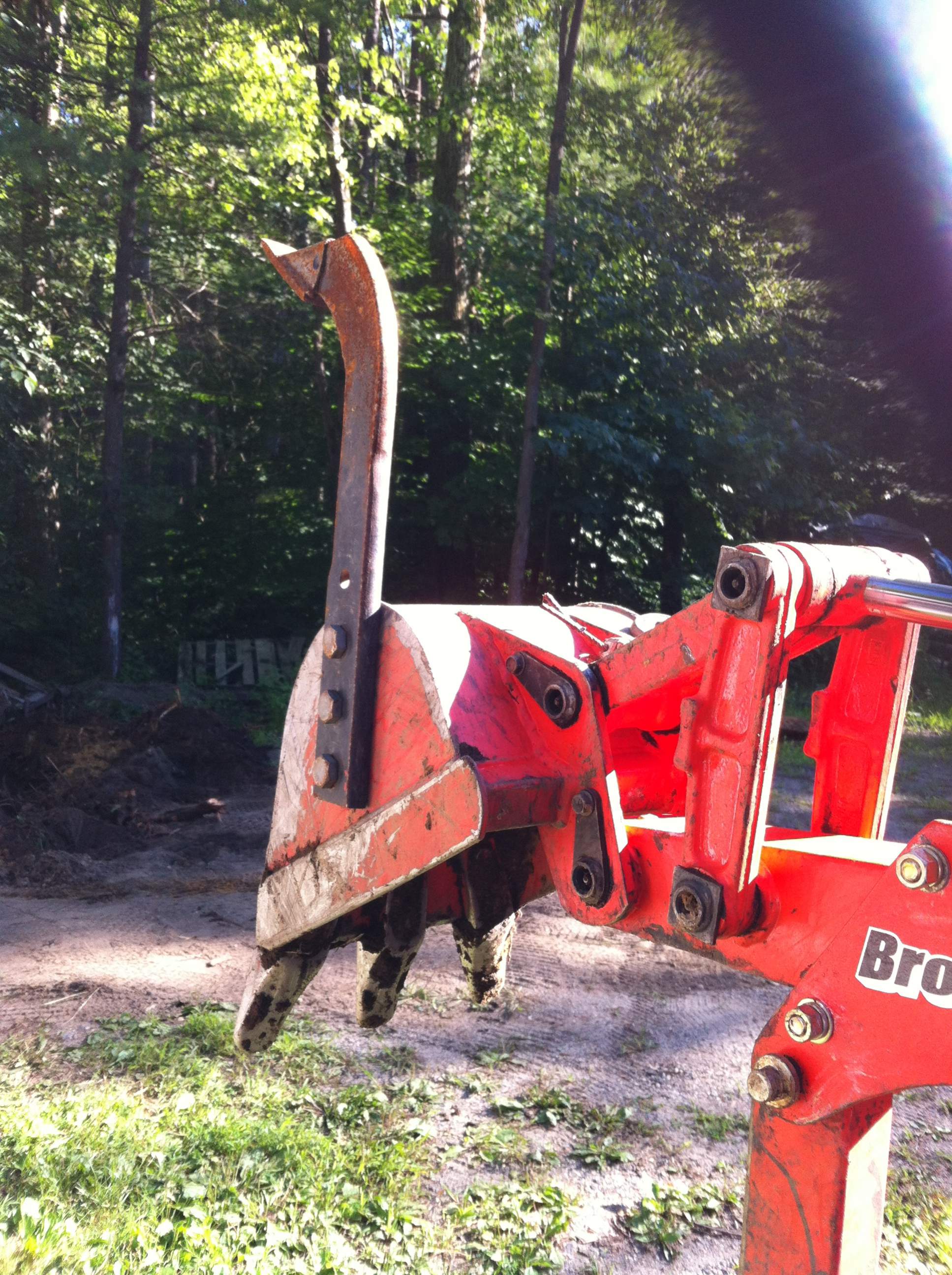

How many folks here are interested in purchasing some pins? Also, with or without the Zerk fitting? Adding the Zerk obviously increases the time to machine them, consequently the cost. Also, the type of steel can affect the price. If there is enough interest, I can come up with a price (less shipping), using some quality steel bar stock for both the pins and the holding pins.
One thing I found when making mine, the holes in the boss of the ripper had either excess paint, a burr , or were not perfectly aligned, not sure which. Simple enough, I just ran a 9/32 drill bit through to clean out the holes. I made the hole in the pin the same diameter as the ripper boss hole ( 9/32 ") , and made the holding pins a couple of thousands smaller, to assure they would fit without binding. Cleaning out the holes in the ripper boss might (or might not) be required.

I have enough of my "old stock" that I made mine out of, to make two sets. There is nothing wrong with them, The pins are just fine in my BX25 - I've ripped several stumps with no problem. I will be machining them in the next couple of days, and come up with a price.
I will make zerks in both, and fit them to my BX25 to assure they fit properly.
I'll offer one set to you, and the other to Code54, since you were the first to respond.
If cschultz and srossman still want them, I will order a 3 foot length of rod, which will be enough for those two sets. That will be the end of this project.

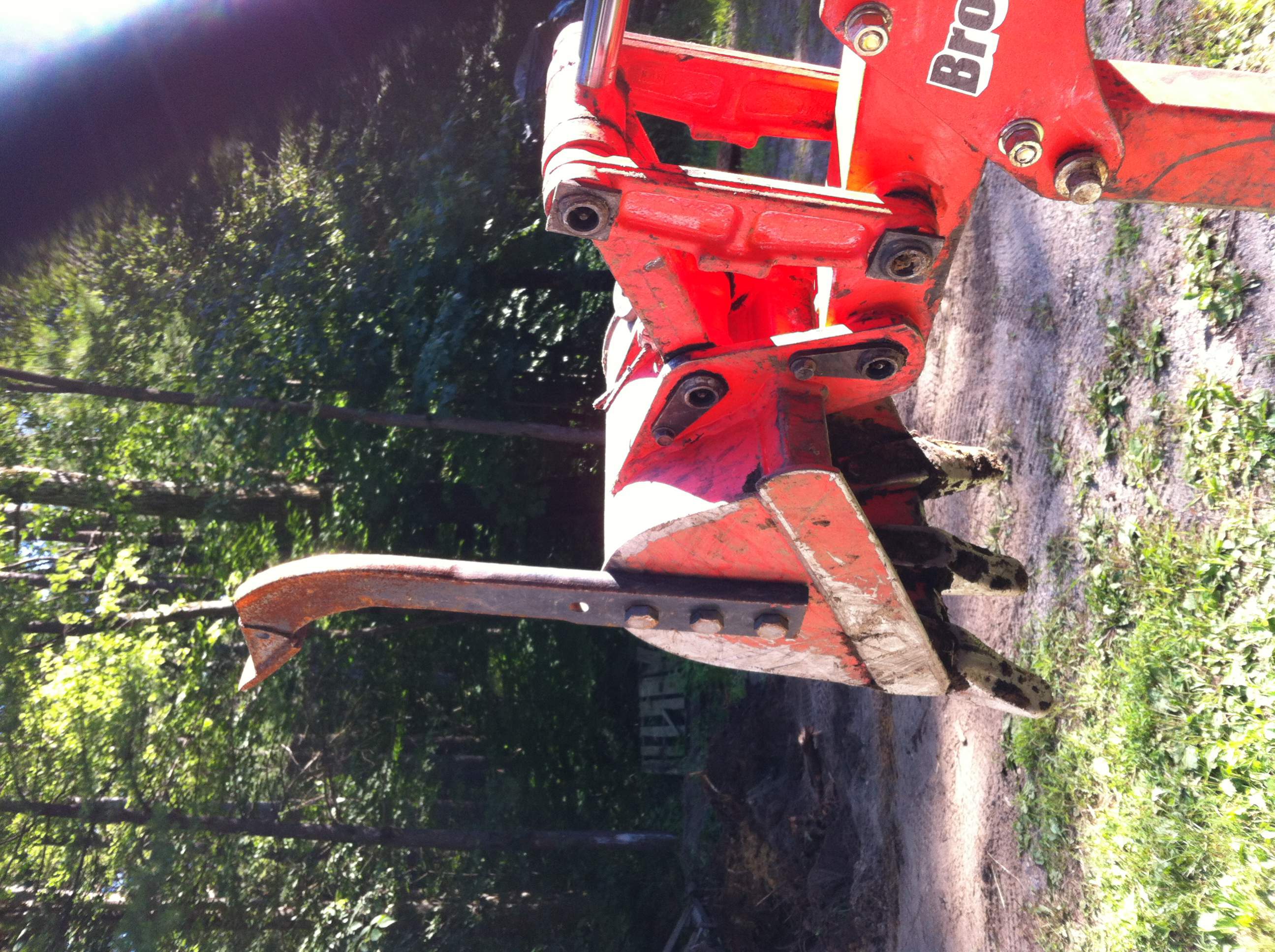

The pins on my BH77 are heat treated, hardened steel. I would not relish the thought of trying to machine them down on the lathe without annealing them first. Typical bar stock mild steel, or even AISI 4130 alloy steel which contains chromium and molybdenum, no problem . . . but I'm not sure even 4130 would hold up as well as the stuff they use for backhoe pins.
bumper
/ BX25D backhoe ripper question #96
Yeah..the reason Case and Kubota wanted $50-60 each for their pins is because they are good heat-treated metal. The pins that come from DR are only $12.00 each and you can tell they are nothing special metal-wise. I figure the lesser grade will be fine for as little as I plan to use the ripper compared to the bucket.

I checked on the longer Kubota pins and they were like $45 or 50 each. I was trying to get by on the cheap, but having no luck yet.
Ryan
By chance do you know the pin part number or which backhoe the pin is supposed to go on? For $50/pin and a substantially less cost ripper it's still a lot less expensive than the Bro-Tek model.
/ BX25D backhoe ripper question #99
75596-42610 are the pins I was looking at using. These are viewable on the Messick's parts diagram of the BT601 as part 050.
