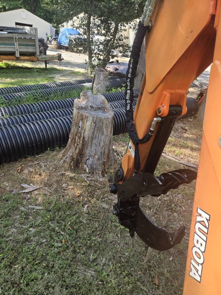

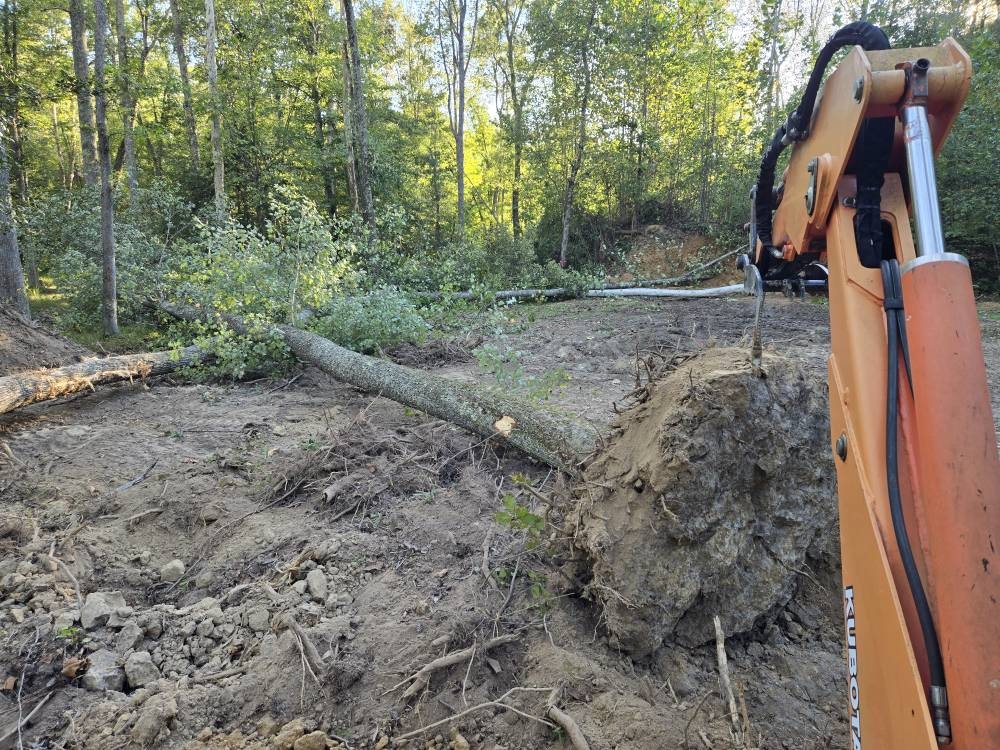

Looks like a great tool ! Lots of commercial excavation companies use rippers, not just for trees but just about anything where you need to bundle the force.
Just wondering: how many roots are left in the ground, and arent you afraid your shop foundation will settle when they rot ?
My father cut an oak at the end of the driveway when the mill in town, who brought hog feed in 50kg bags on a haywagon drawn by a 15hp Deutz, closed, and he had to order in bulk at a larger cooperation, whose trucks couldnt make the turn. Say somewhere in the 70s.
When i was a kid we layd pavers around it, so the top of the stump was flat with the pavers although it was still a hump..
In my early twenties the stump started sinking, and i paved pavers over it. Right now, theres a dimple in the street.
Off course this was a 2 feet oak stump, not some flywood roots, but i personally dont like the idea of decomposing organic material under a foundation: We always dig foundations at least 2 feet untill subsoil, though at my brother in laws house, on an old river arm, they dug 6 feet before finding subsoil without organic matter. Though we live in a river delta, no hard place in miles around

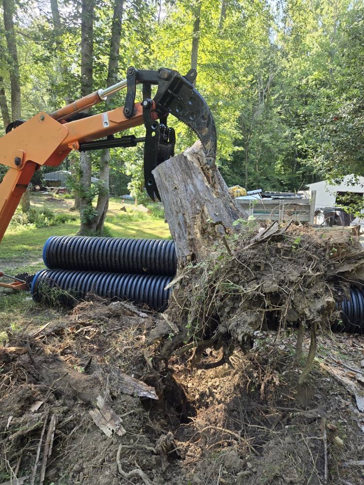

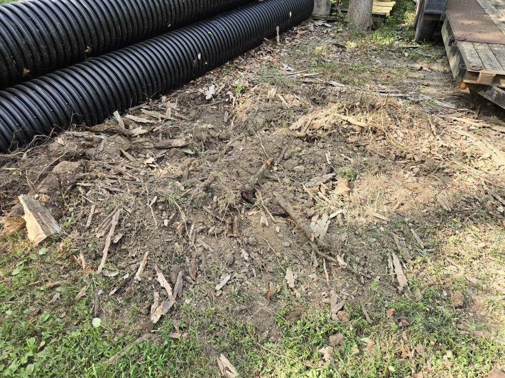

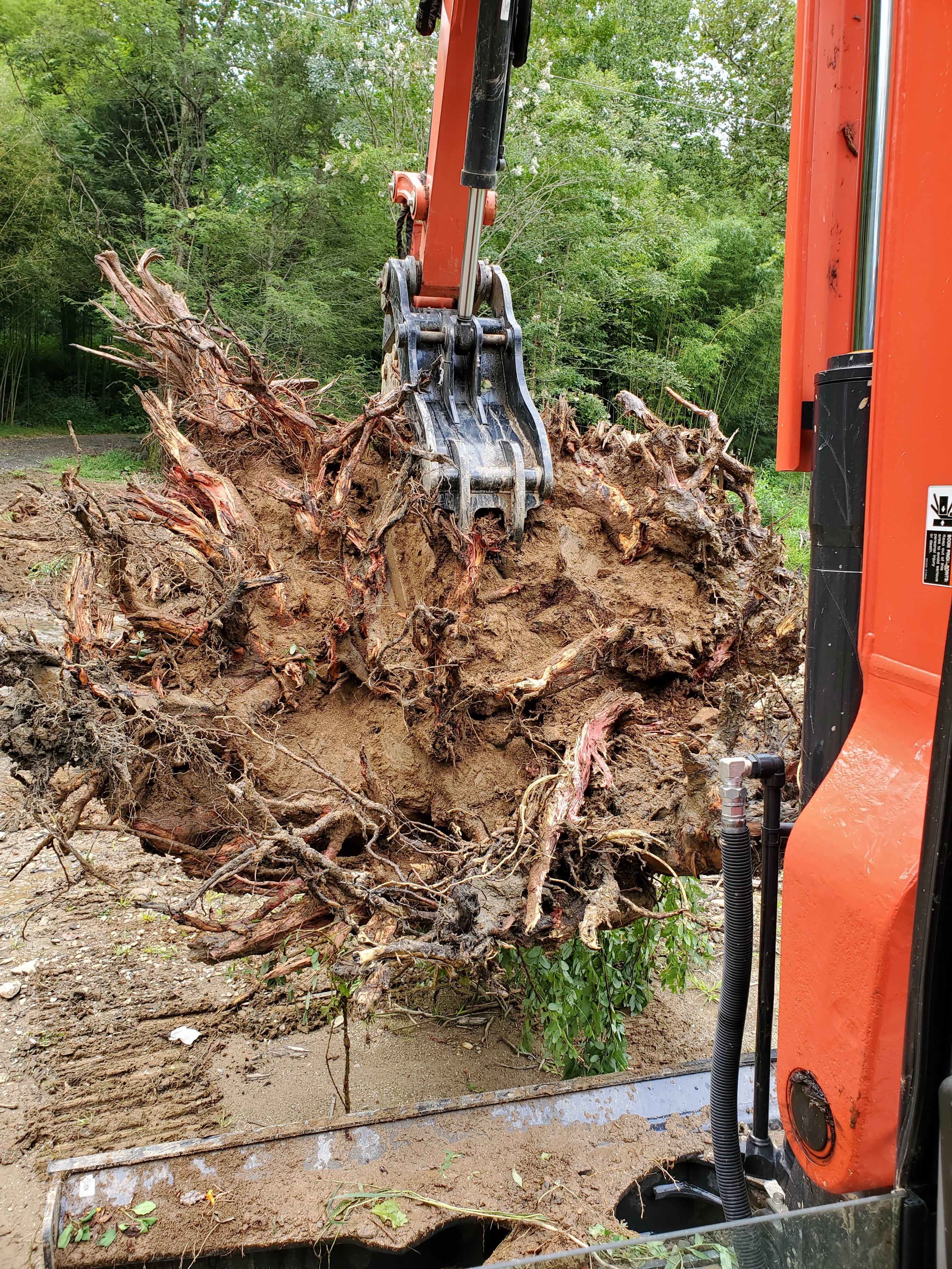

Minimal roots are left, I will still be grading down slightly which will remove most of the other roots.
The footers will still be 16in depth. Most of the roots will pull up while removing them.
As you can see, the rootballs are pretty complete.

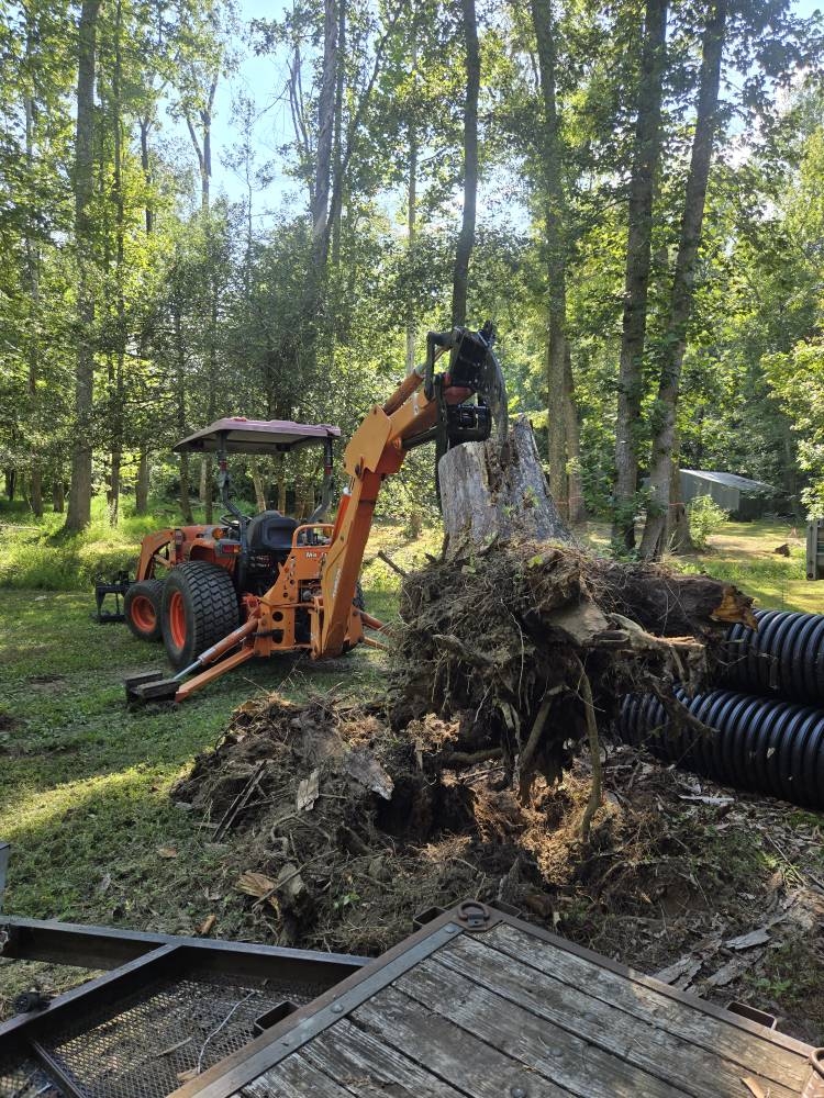

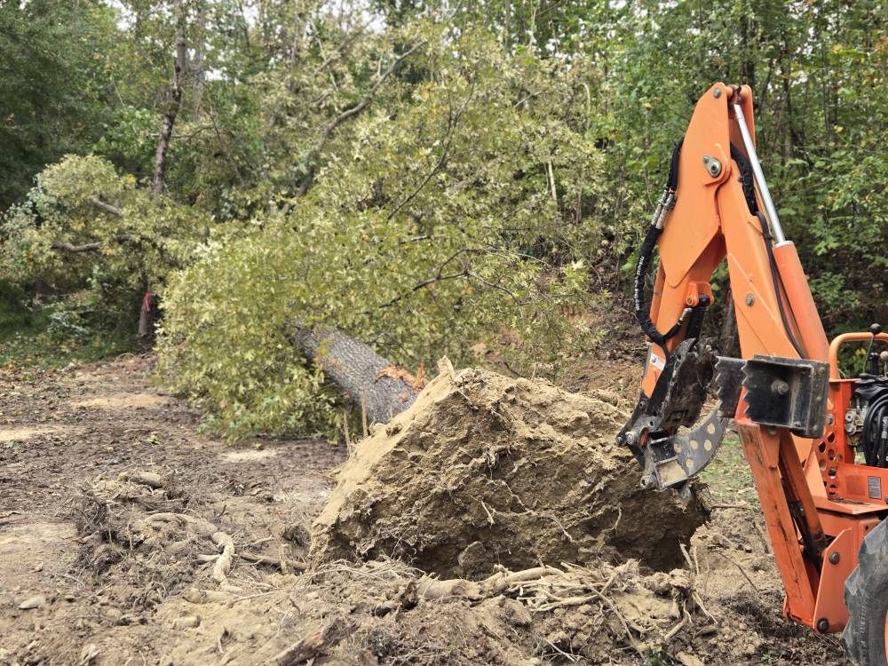

Thank you, that means a lot coming from someone of your fab skills!
They really allow a smaller backhoe do bigger work quicker when it comes to stumps, and less ground disturbance.
This is a 28" red oak I just took down, took maybe 1hr to get it down. Root ball had about 2yrds of soil attached to it! Had to use the ripper to knock enough of the dirt off just so I could roll the stump oit of the hole.

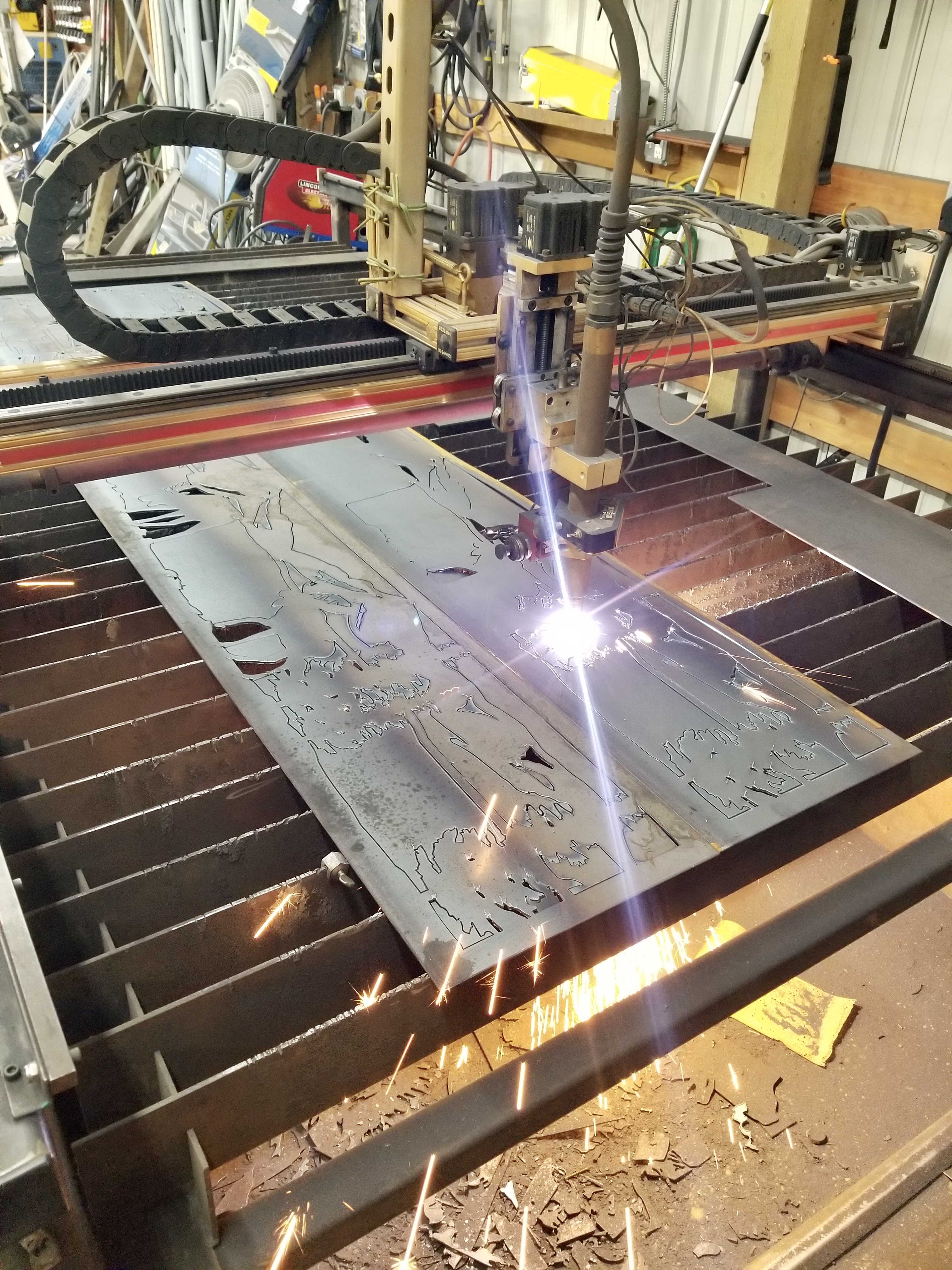

I have a number of fab projects I still want to do, I just haven't had time to complete them.
The ripper and thumb were moved to the top of the list due to needing them for clearing the land of my new shop build.

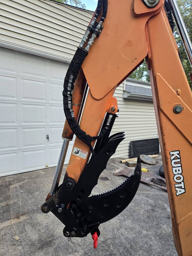

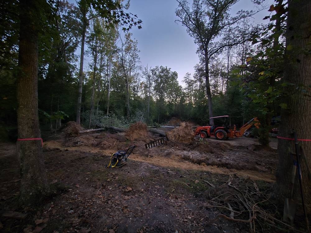

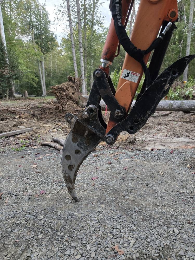

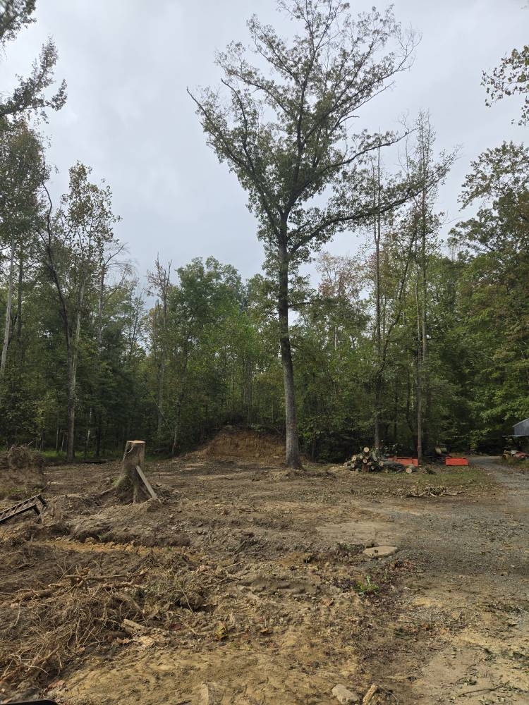

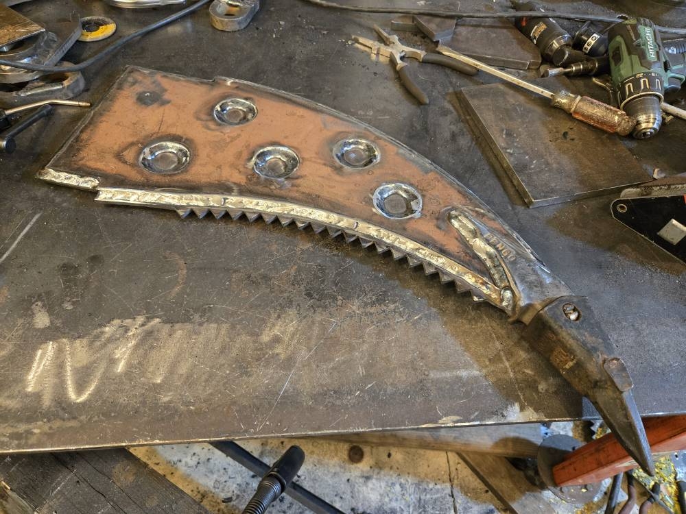

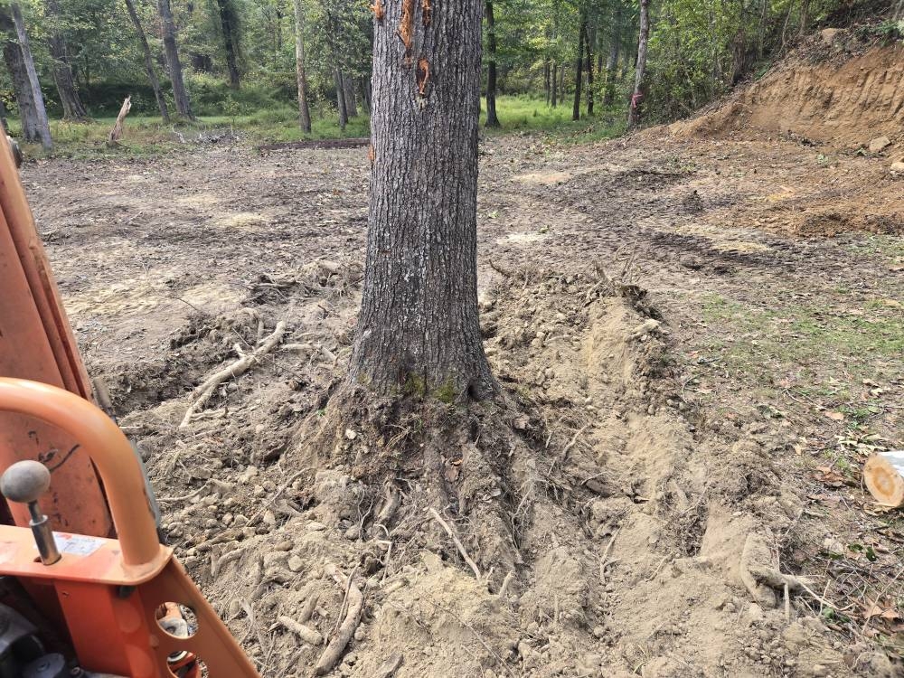

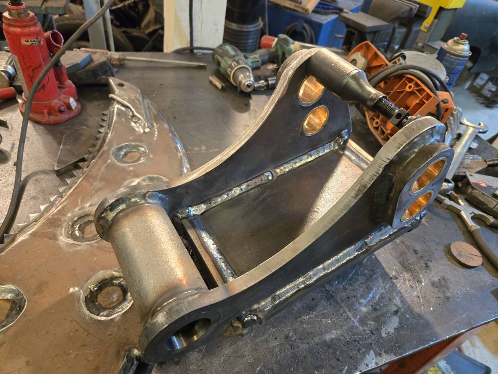

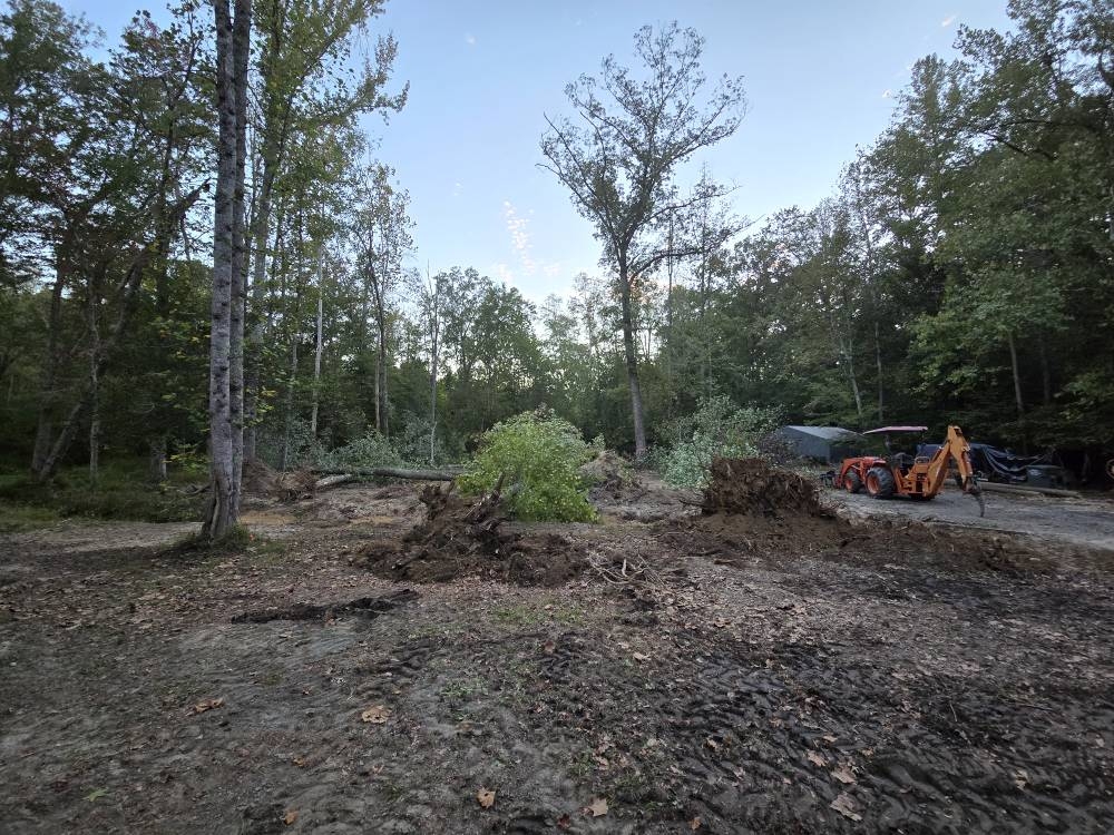

Update on the ripper.
I am clearing for a new shop and have a number of trees to take down and some old stumps to remove, it has been working great ripping the roots out so i can push the trees over.
I have about 8 trees left, one is a large red oak that'll probably put up a fight.
Notes on it so far:
I'm really glad I used Hardox for the shank, it's taking a beating and only shows minimal wear so far. I'm really glad I went with a replaceable point, the amount of wear on it already makes me think it was a good idea.
Overall I'm very happy with its performance and don't think there is anything on the design I would change after using it for about 12hrs.View attachment 4189540View attachment 4189541View attachment 4189542

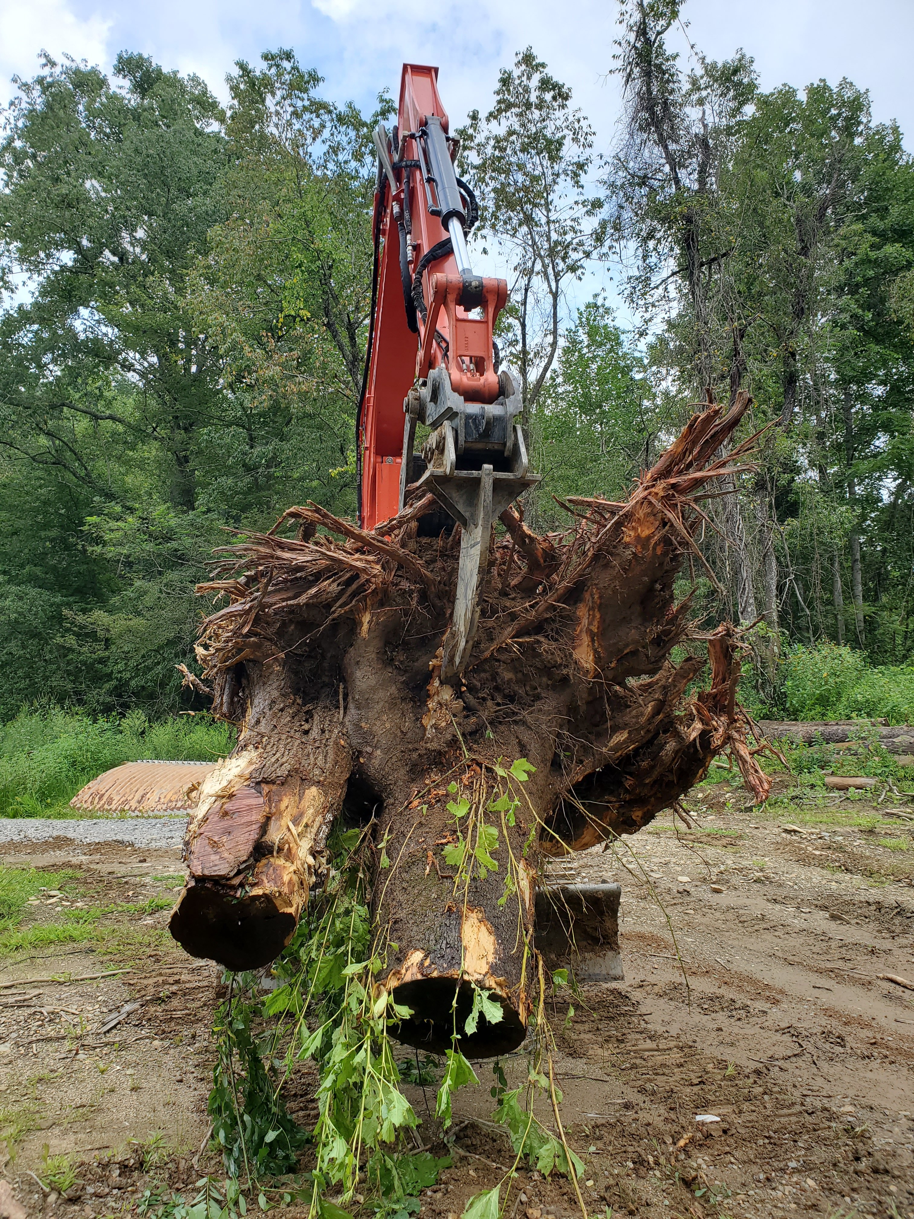

Doug,
I run a KX40 root/ frost ripper with a 3/4" shank and 26" long on a M59 with no problems. Laminating three 1/4" thick slabs by continuous weld up the working and back edges will prevent wedging something between the laminations and spreading them. Your L48 and my M59 do not have enough curl power to bend a 3/4" thick blade.
I also have a 1" thick root/ frost ripper on my LX80 ( 20K Lb machine ) and have never had issues
Have fun removing stumps. Its the only way to work. Second pic is M59 pulling a oak stump
