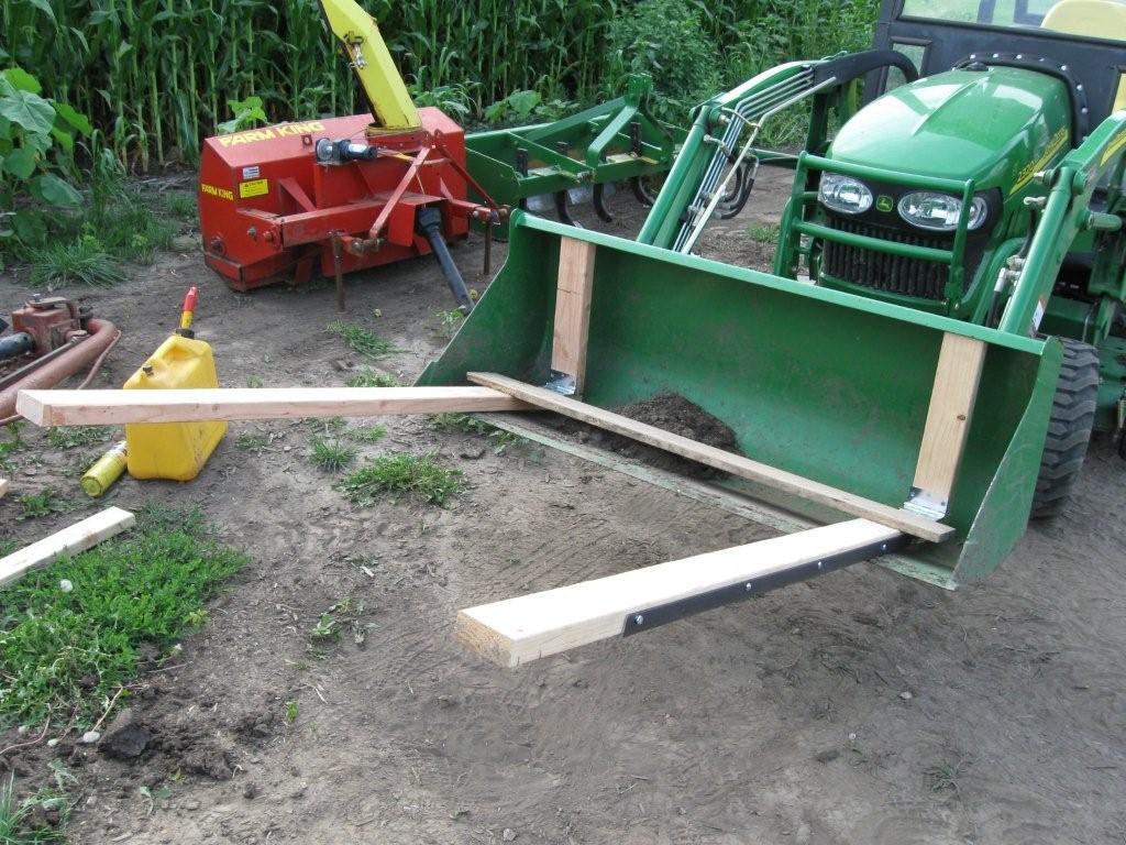

Nice job on figuring out how to put those panels on by yourself. I like the guide/restraint at the end of your lifting tool to keep a wayward panel in place should the wind kick up.

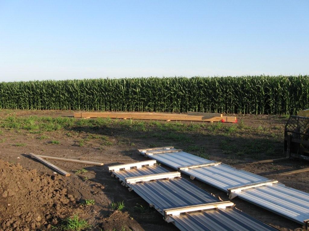

The steel sheets are all up on the roof and screwed down completely now. I put about 1/2 of them up on Saturday, almost finished yesterday, had to put the last piece up tonight.
The putter-upper worked great. I ended up abandoning the vice grip on a rope. Instead, I would position the 'upper just off to the side of the spot I intended the sheet to go into. Then from a ladder at the eave, I'd pull/push/slide the panel off of the 'upper and onto the roof. Once on, I could slide it over to get the overlap rib lined up. I would line up the bottom end, and screw the sheet to the eave fascia board. Then I'd climp up at the peak from inside the shed and screw down the top to a couple purlins. Once the panel was secure, I'd climb out onto the roof, staying on the last fully screwed sheet, and work my way back to the bottom, fastening the new sheet the rest of the way down, then climb down off of the eave ladder.
The Cleary kit came with nails for the roof steel, but I decided on screws mostly to save my arm/wrist from pounding that many nails. I picked up 1.5" pole barn screws from Menards in their "Emerald Green" color. Those screws looked nearly the same color as the Fabral screws that came for the Cleary "Evergreen" wainscot. Turns out, the Menards screws and the Fabral screws are made by the same company. Not sure they'd 100% match on a wall where you'll stare at them all day, but for a roof, they're darn close.

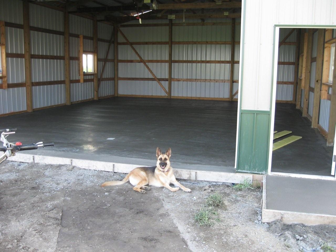

Starting to actually become a shop...
Long time since the last posts. Back in early August, I was finally able to get a crew in to pour the floor in my new shop. Prior to that, I had a lot of lot grading to do back in the sping, lawn seeding, and in July I trenched in some drainage tile under the shop floor pad including a stub for a floor drain. Turned out well, now working on getting the lights and outlets wired.
/ Building a Shop #153
Is that concrete on the lower panel? Unless you washed it off right away I have the feeling that it is there to stay!!! Nice watchdog too.

#158
Nice watchdog too.
Not sure she's much of a watchdog, but she's pretty good at laying down and looking exhausted after a hard day of watching me work!
