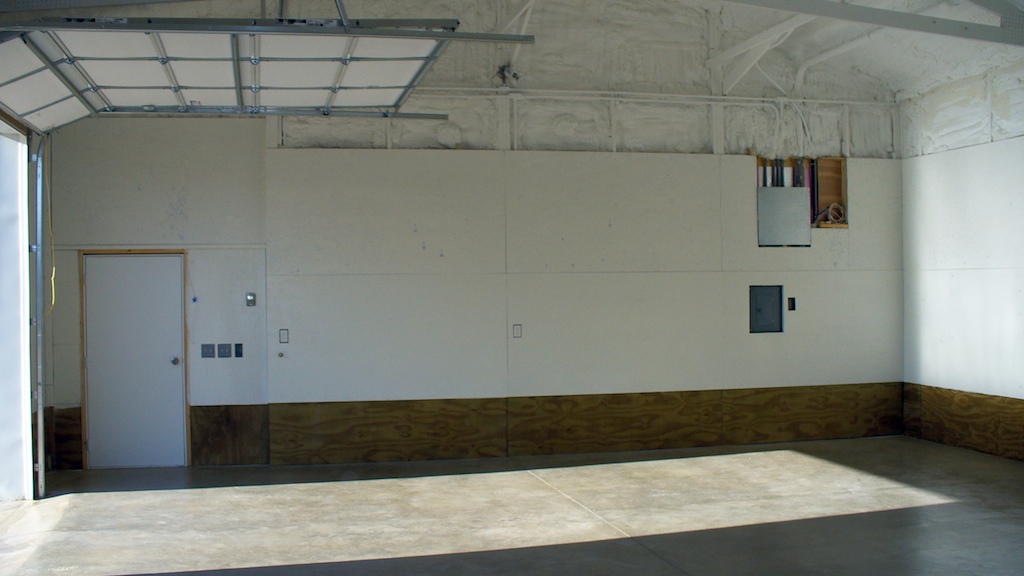

/ Building a Shop #165
Painting the OSB makes a _huge_ difference in how bright the room is. In this shot, the bottom panels are 3/4 plywood (so I could screw stuff into them), and the top panels are OSB. You can see a few places where the ink on the OSB bled through the paint a little, I did not prime the OSB. Overall, a big win and fairly easy to do :thumbsup:.
I also painted the exposed foam insulation so it would not degrade with light, that's what you see at the top. This also helped with the brightness.
Pete
/ Building a Shop #166
Pete
What's the deal with the ridge vents and spray foam? Did you plan on spray foam when you went with the vents?
I want to know because I'm trying to decide if I want to go with spray foam on mine (yet to be built) or not. I've been condisdering the following for the wall (outside to the inside): Metal,1.5" foam board, nailers, wet sprayed Cellulose, nailers, acustic metal (I'm thinking the holes in the accustic metal would allow for better drying). For the Ceiling I'm thinking vented with conventionally blown in cellulose. However, I'm also considering spray foam and would not vent the roof.
On the walls I may just put the nailers on their side between the posts on 16" centers (2x6 laid flat) and go with foam on the outside and fiberglass on the inside.
