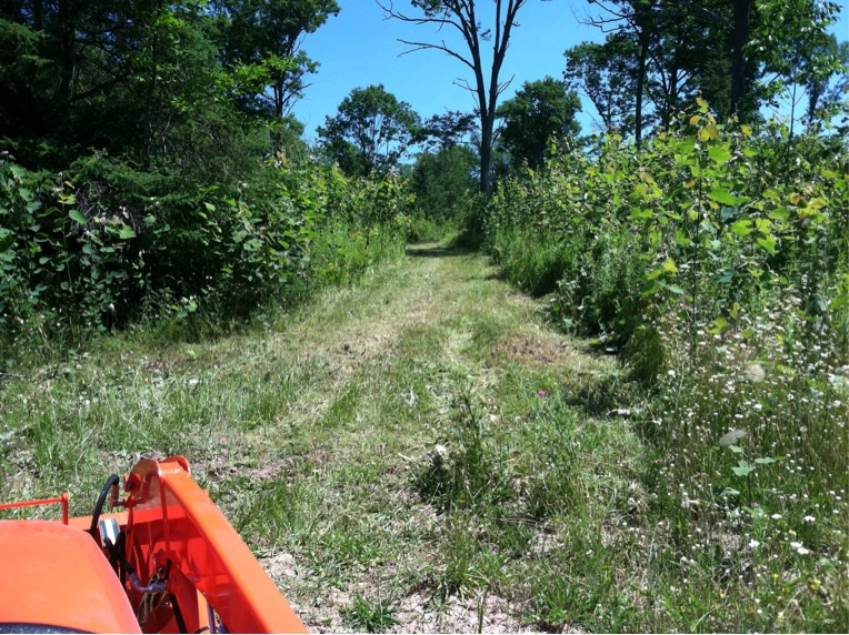

Here is what my new B2320 did today with a 4' Landpride hog, think model 1248?
