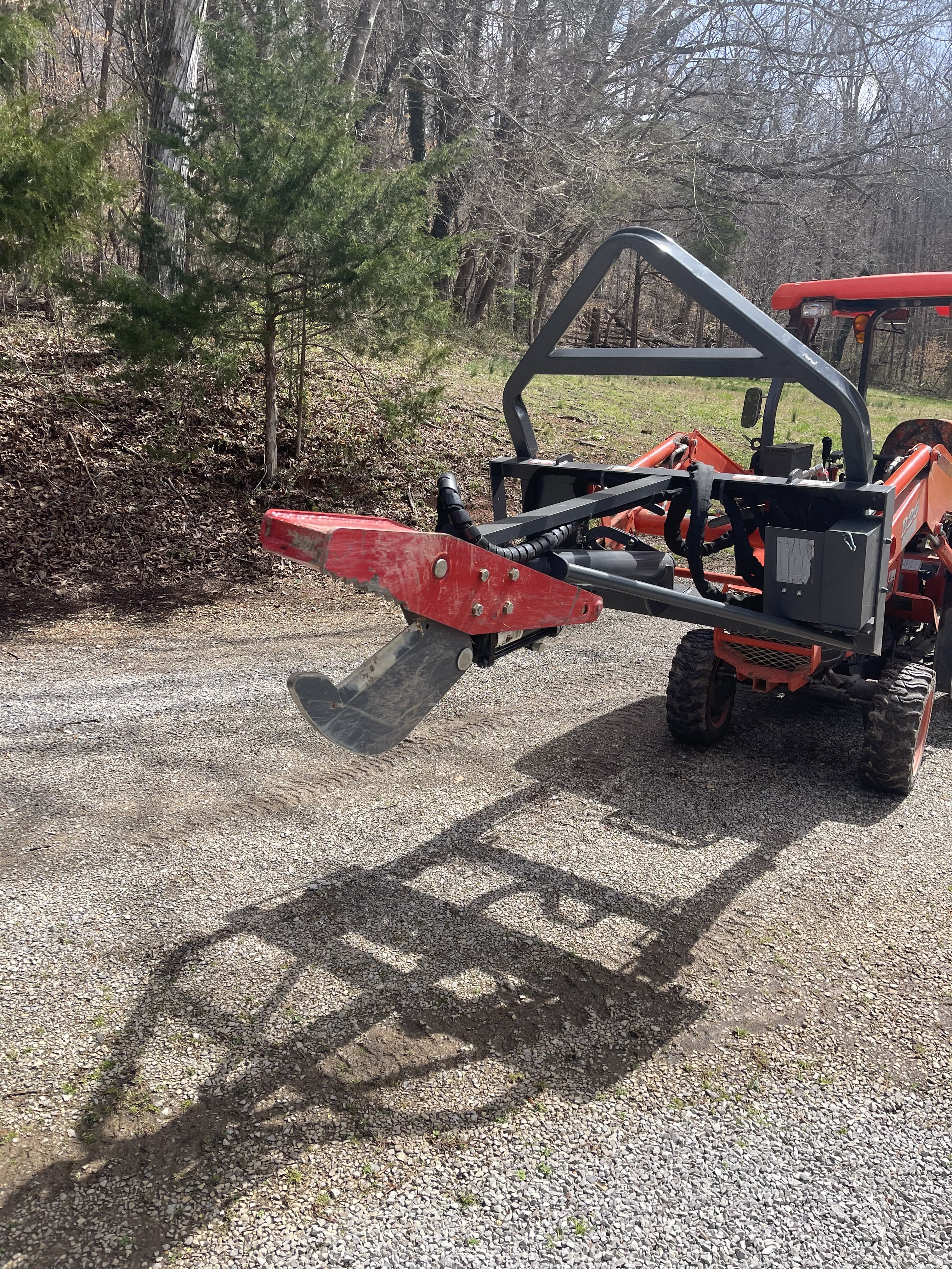

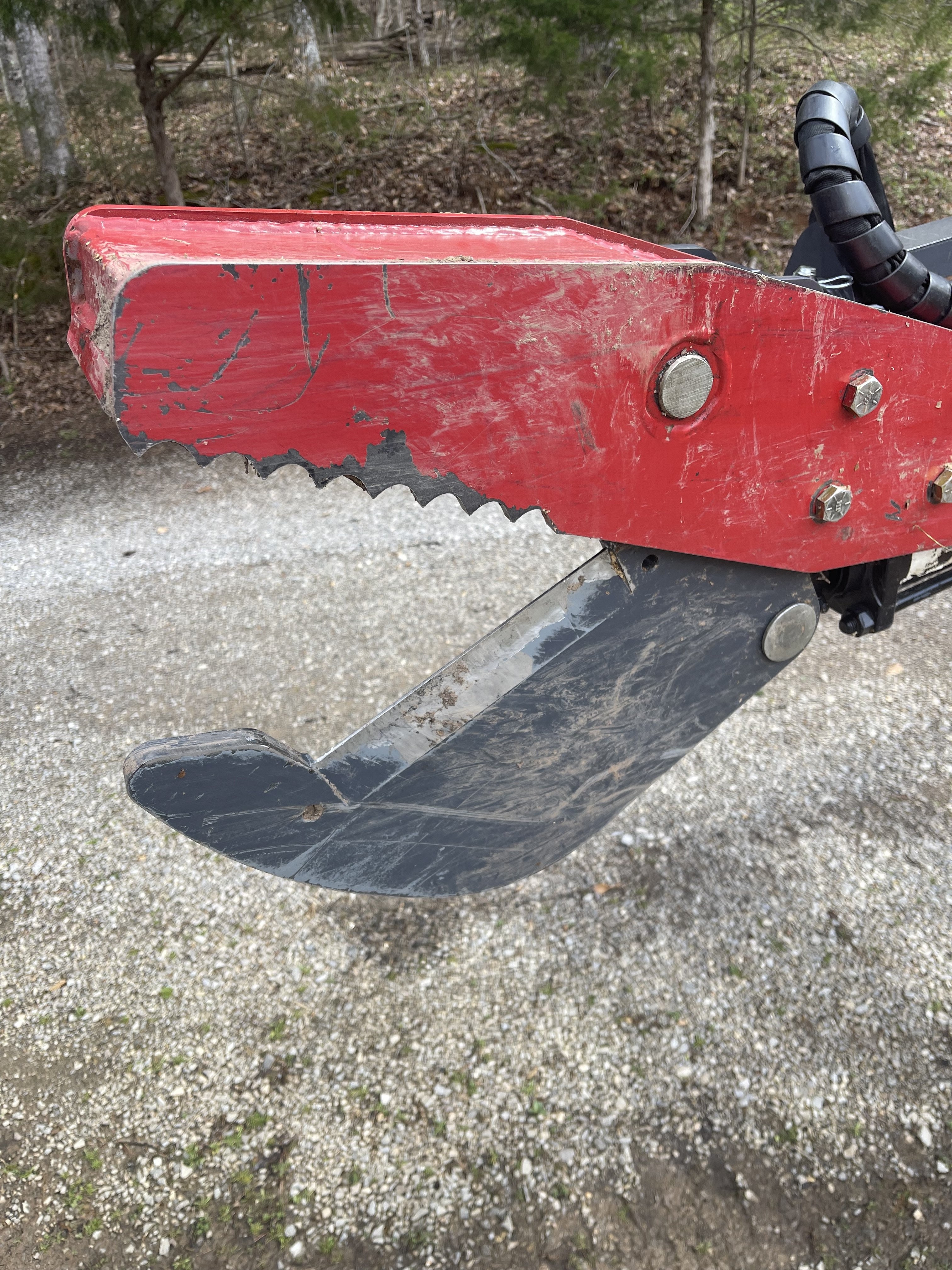

Use to clear by hand but labor intensive. Have several attachments for tractor to help. No one attachment does it all.
Danuser Intimdator. Not only to pull up trees but reach up and tear off limbs.

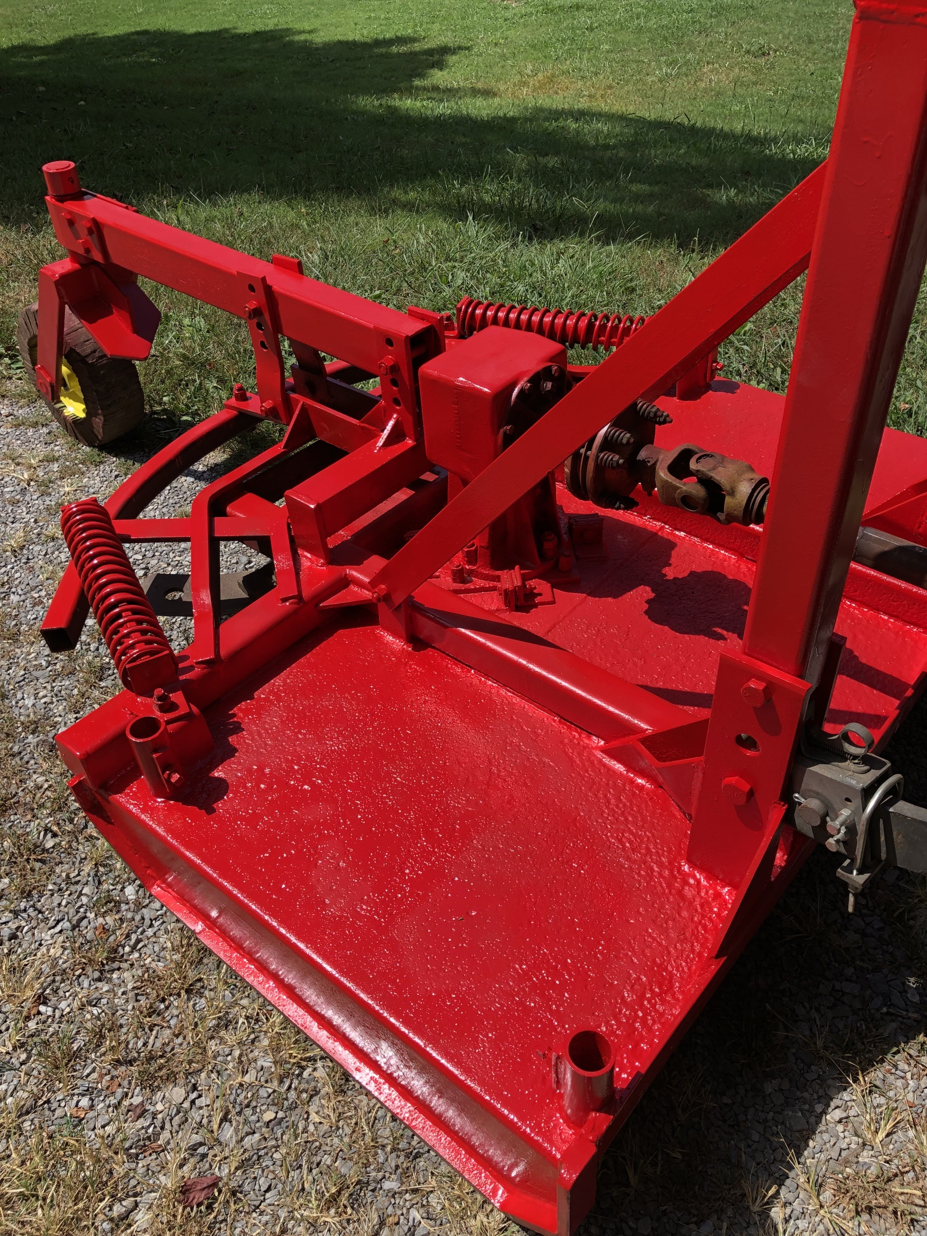

Brown tree cutter. 5’ model is all my 45hp PTO tractor can handle.

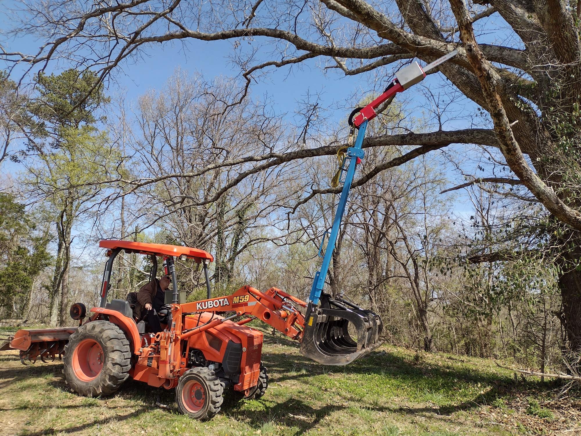

This spring bought a Precision Manufacturing Miniclip. This is a game changer. Works on smaller B26 CUT or much better on the M59. Extendable boom, rotating head, 7” cut capacity. Been easy to cut back boarders, roads and fences. Have cut and hauled off 100tons of trees and limbs in the past couple of weeks. Flush cutting at the ground should be able to maintain with rough cutter.
All these generate large amounts of debris. Grapple helps moving and hauling. Both tractors are HST which is very helpful for maneuvering.

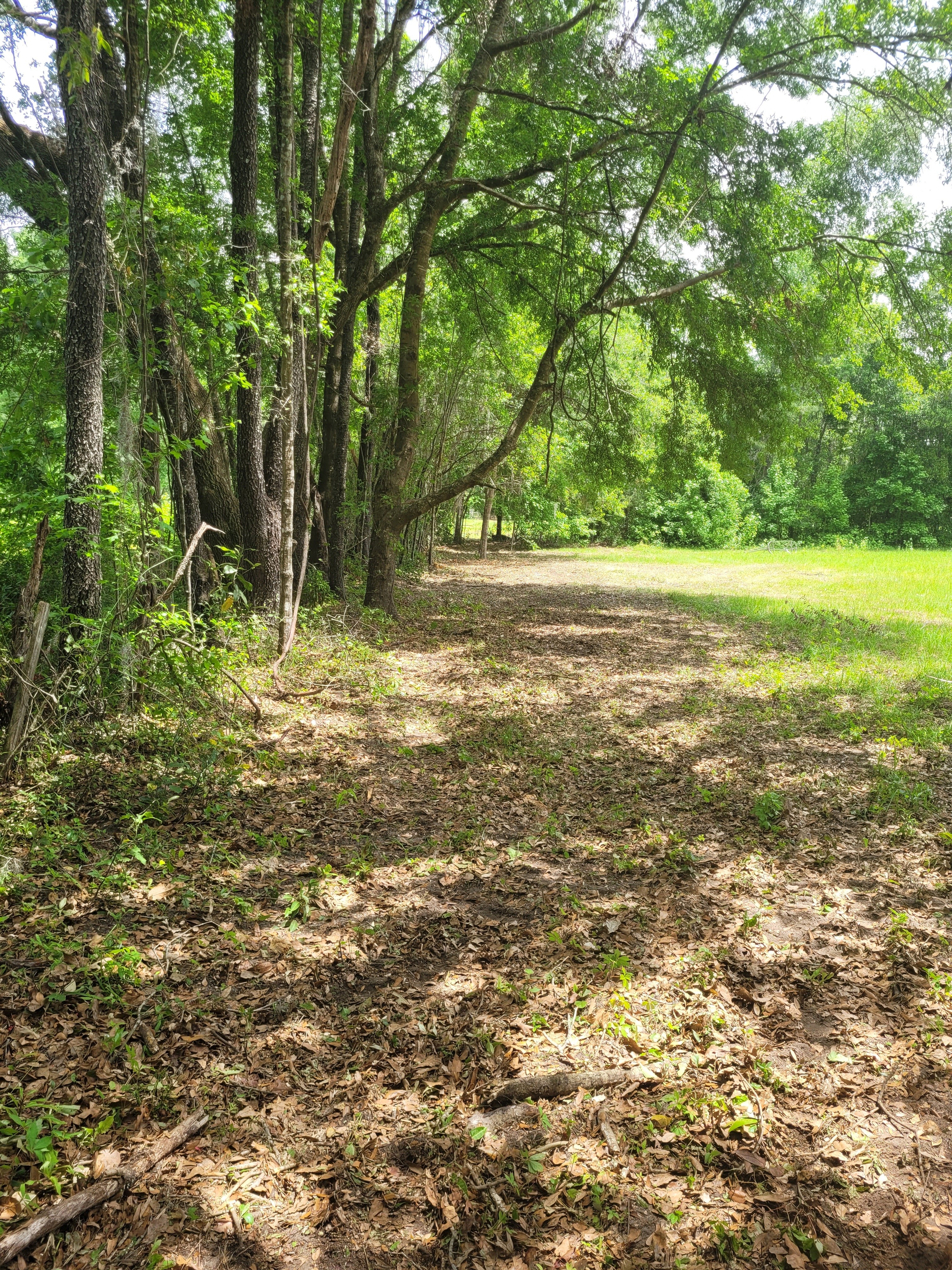

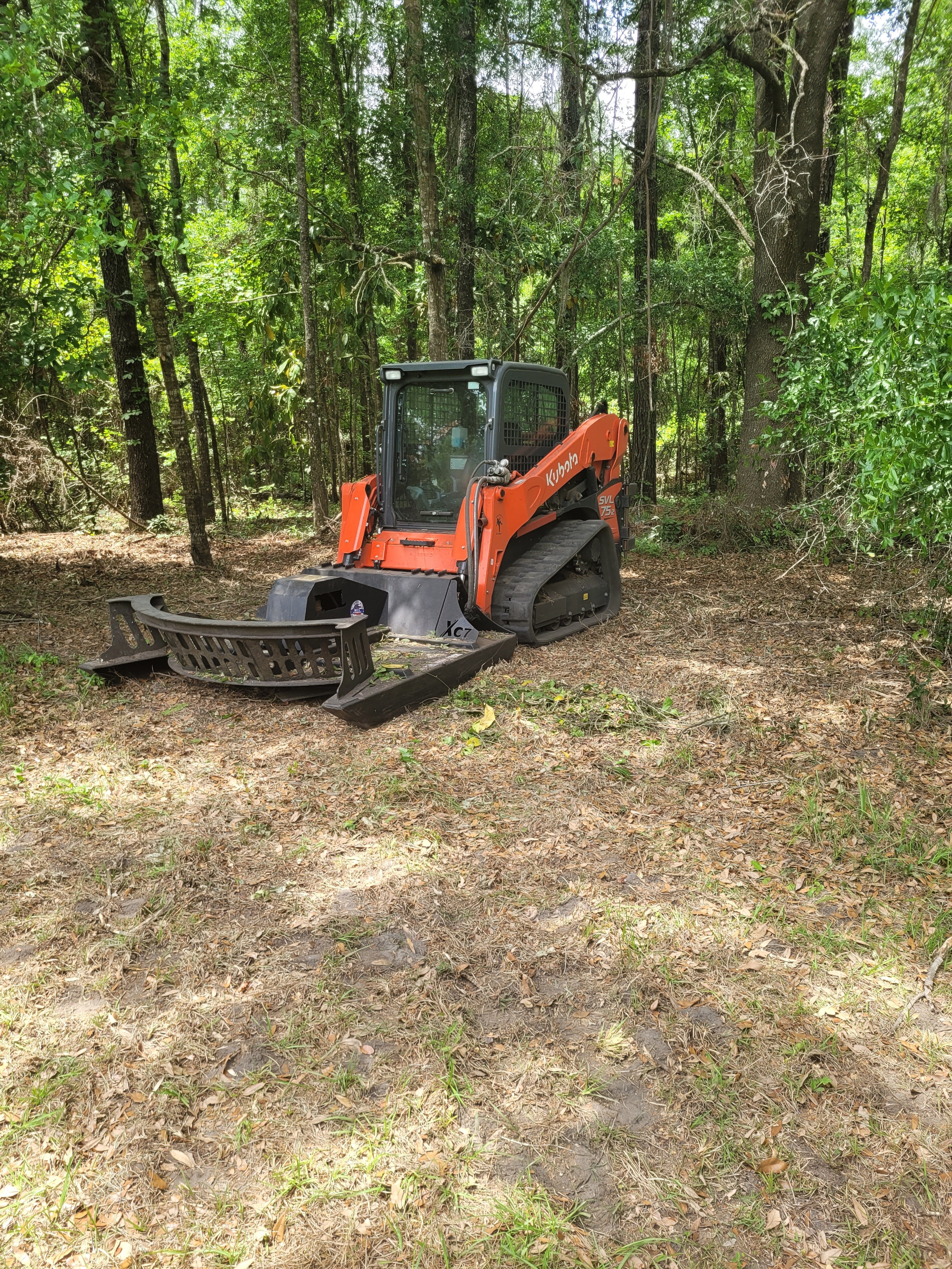

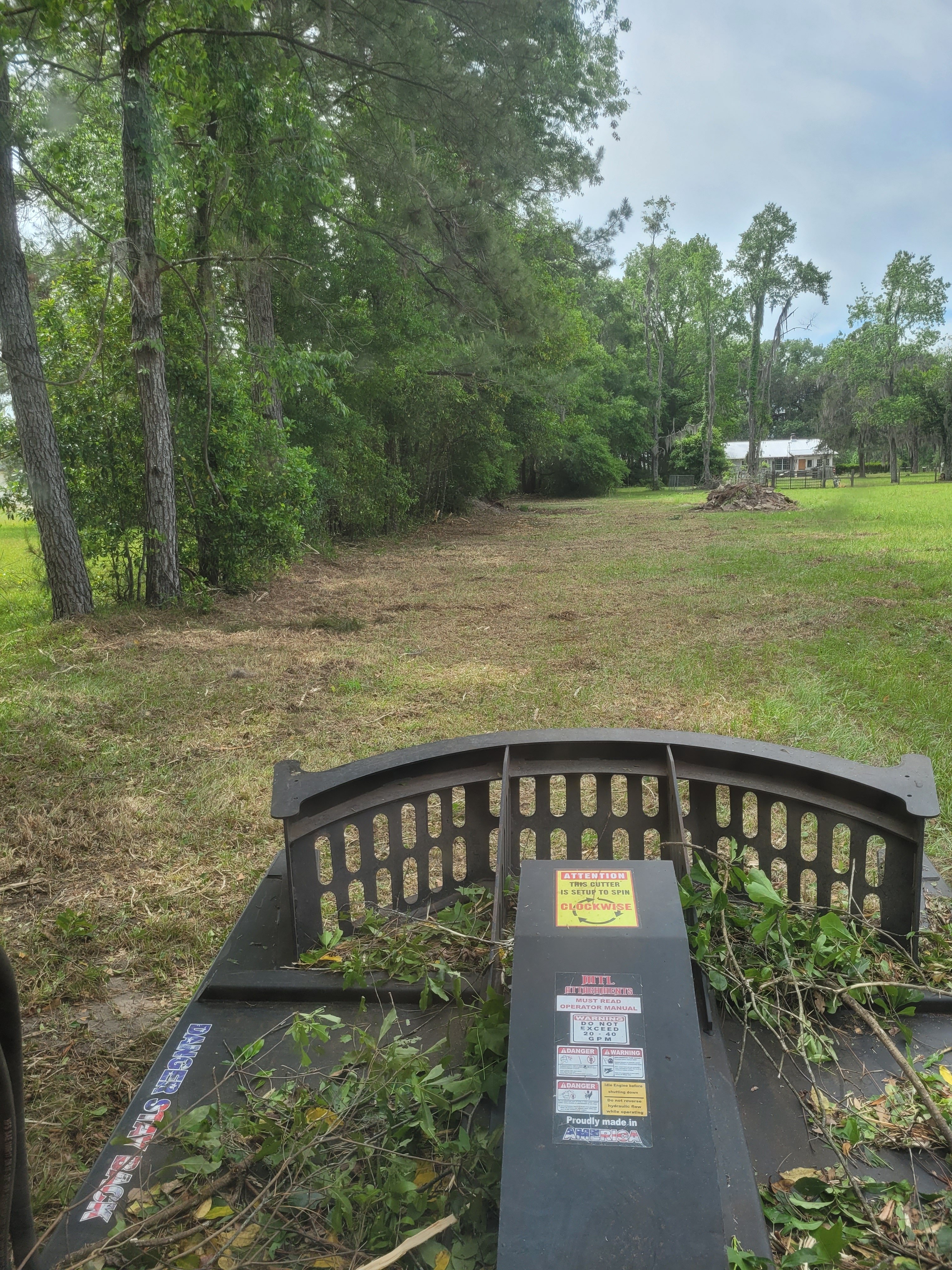

I use my forestry mower on my skidsteer, just did this job this morning for a customer, he is having a new fence built and needed the property line cleared, I can cut stuff about 10' off the ground.

I use my forestry mower on my skidsteer, just did this job this morning for a customer, he is having a new fence built and needed the property line cleared, I can cut stuff about 10' off the ground.View attachment 3318904View attachment 3318905View attachment 3318906
Appreciate the information. I was watching a YouTube on one of these, but it was unclear whether you could run one of those off the ground. Clearly, you can and do. Do you know the ballpark price for one?
I gave right at $7k for this one but it has carbide teeth on the bottom of the blade carrier to help with mulching and I got it with a big piston hi flow motor, so they can be had cheaper, this one is an MTL and it has been flawless, Rut Manufacturing makes good stuff as well as many other brands. Look up MTL brushcutters that will get you started.

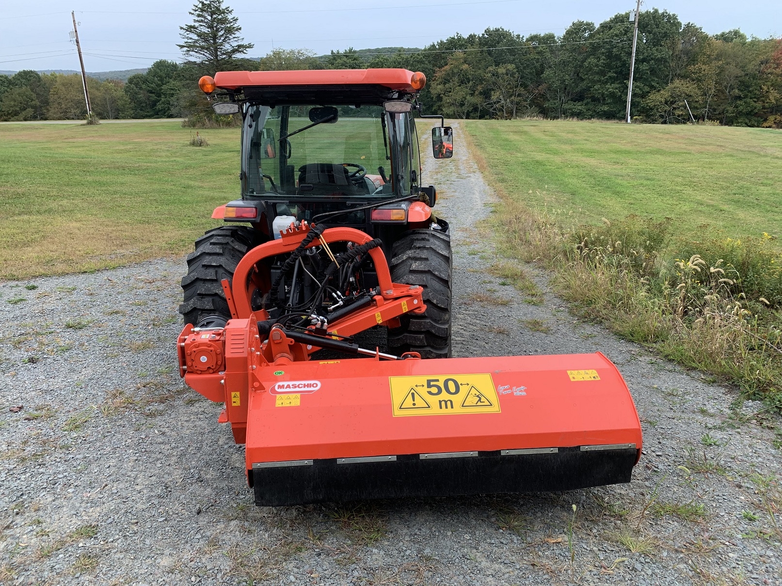

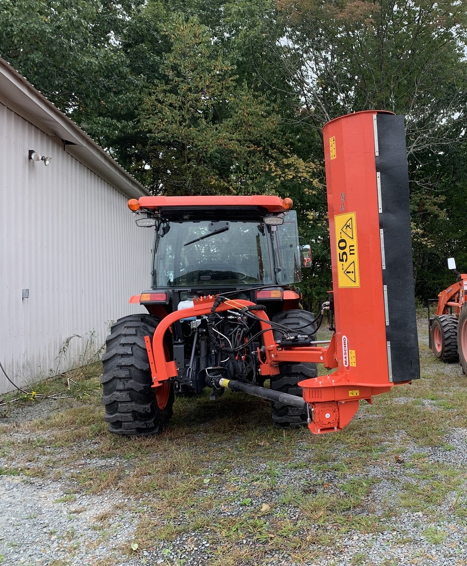

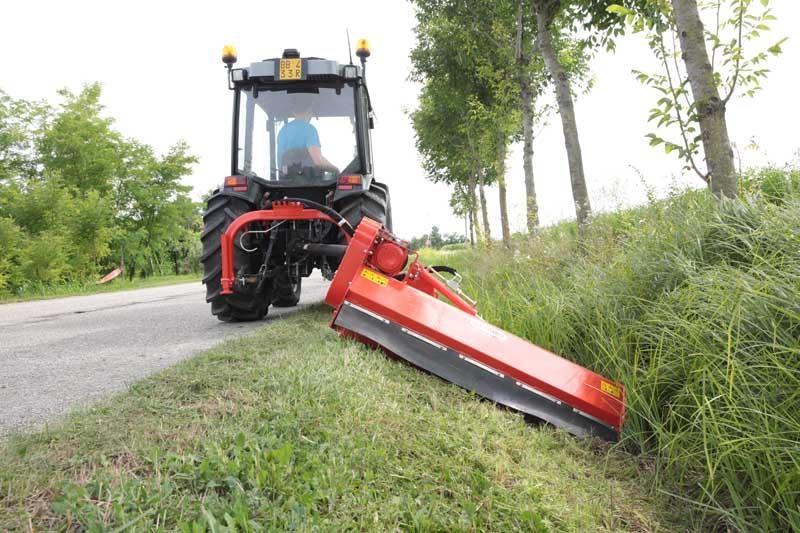

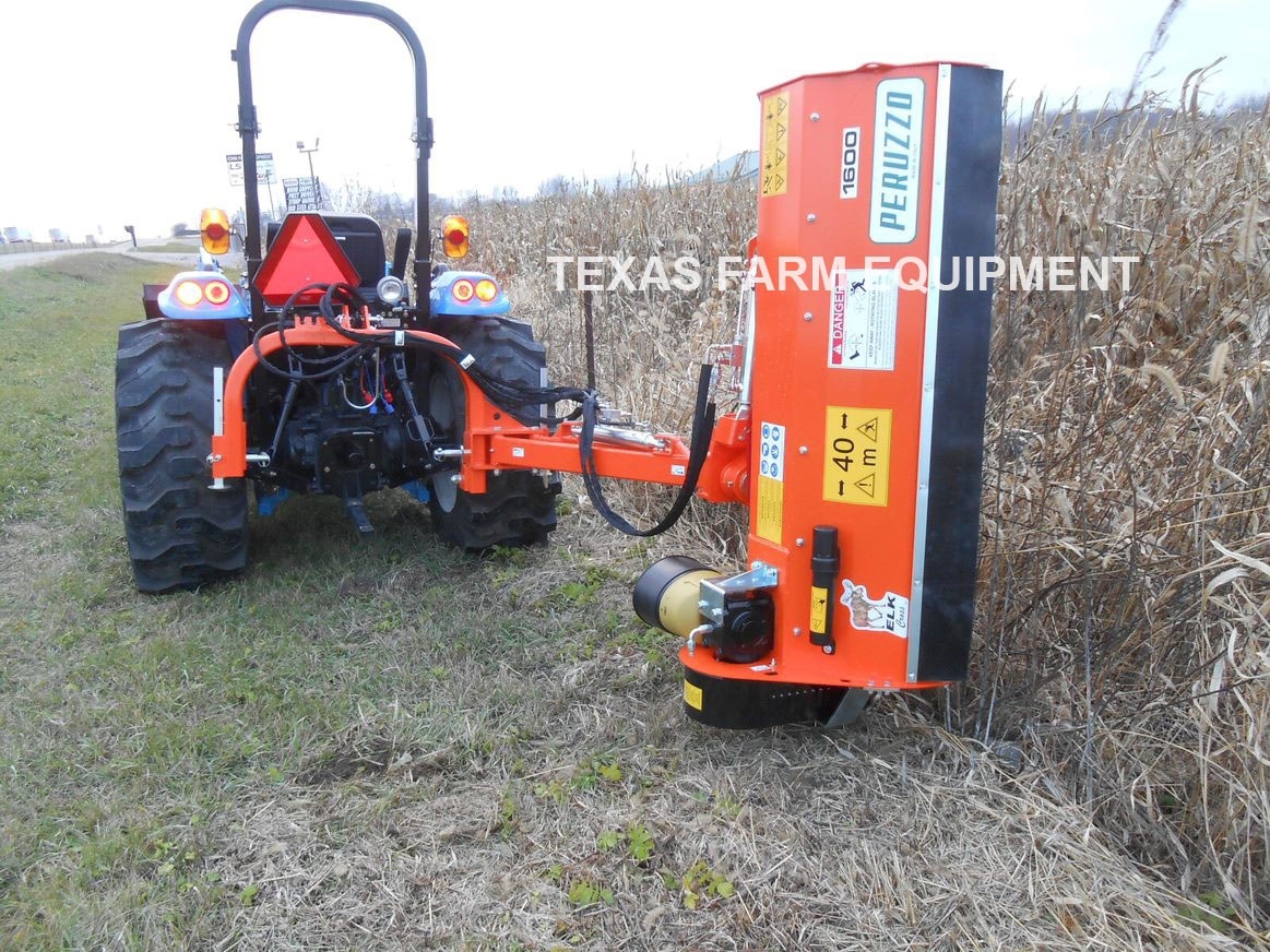

Offset flail mower. Tilts up 90 deg and down 60 deg.
   / Advice on tractor/skid steer to keep field edges clear #16
+1 on the offset flail.
Unless it's in danger of falling, I don't bother cutting anything the cab will clear. The flail, set at 90 degrees, cuts & mulches anything up to 4" in diameter and up to 8' off the ground
The flail does double duty along tree lines since the offset will get into hard to reach spots
It's also great for mowing ditches. One of the most useful implements I own.

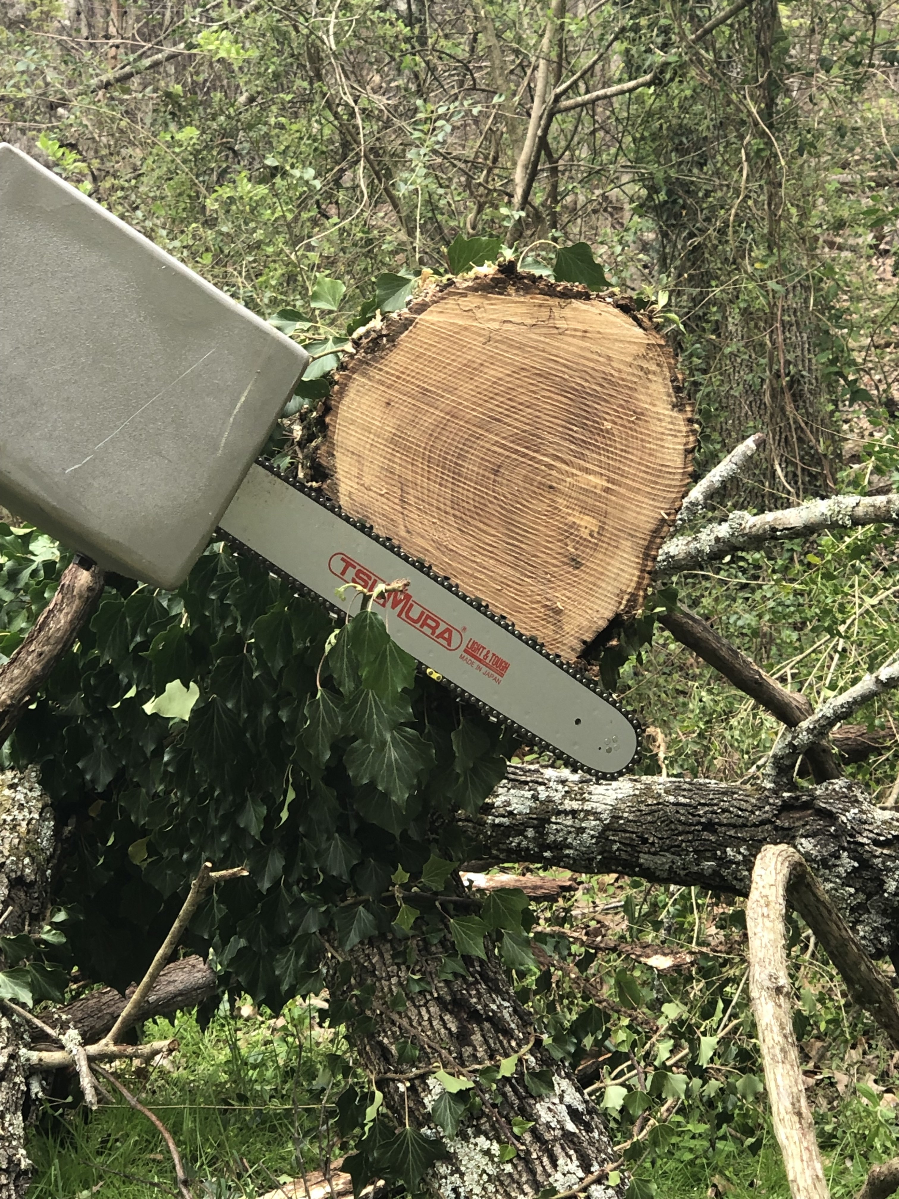

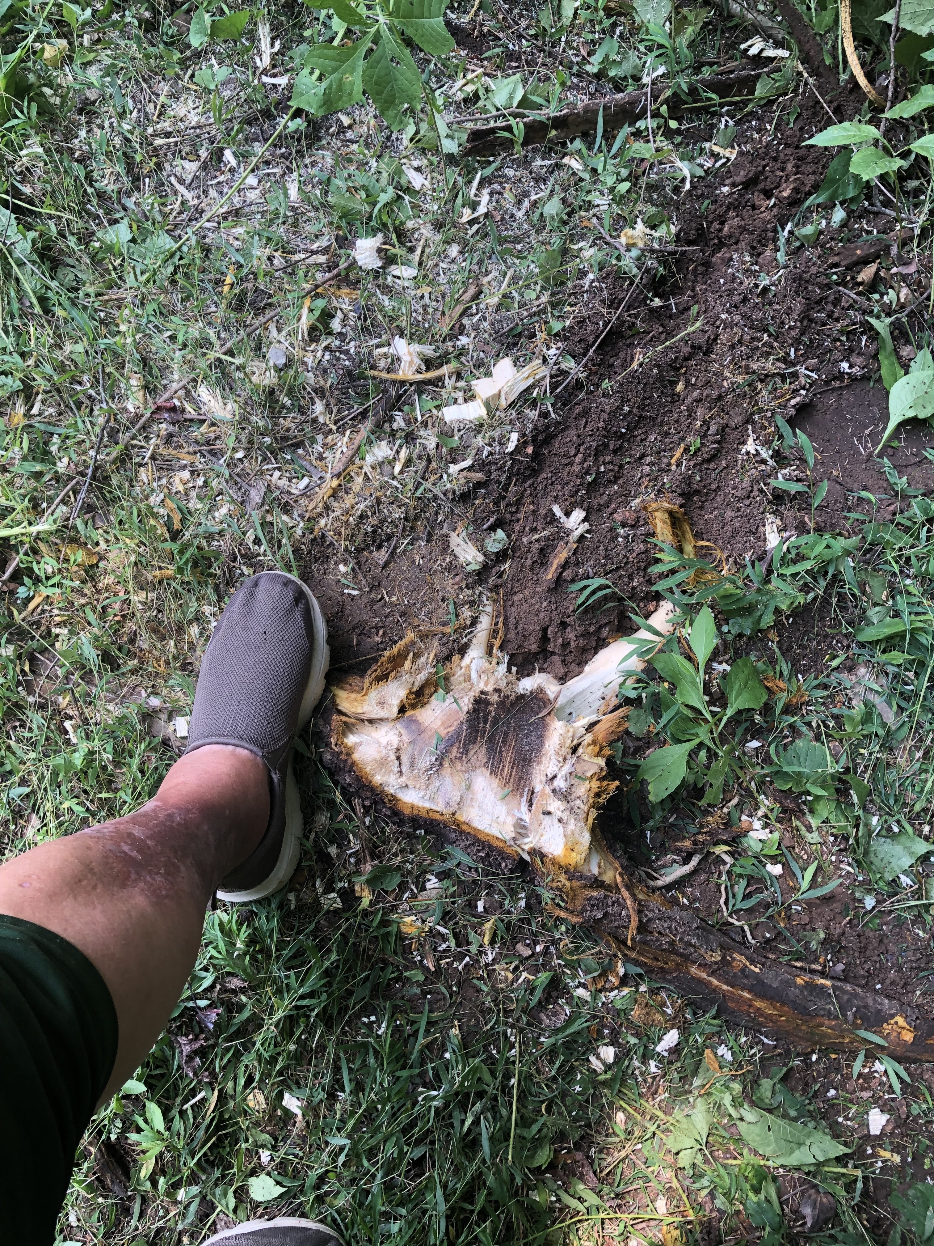

Spent another half day between rain showers using the Miniclip to cutting dozens of trees. Cutting some 4-10’ above the ground because of their diameter. Will push those stems out later. Sectioning the tall stems to be moved by grapple. Same areas are occupied with huge grape vines. Being able to cut the trees, bushes and vines without getting off the tractor is a blessing. Can reach up about 19’ but most cutting is below 12’. Controlled cutting at idle can watch, hear, react is a significant safety factor in a high hazard job.
Miniclip is not cheap. Nothing for this type of work is. Paid $4,500 for it new, never used. still strapped to original shipping pallet. Original owner paid $9,300 delivered couple of years ago. He bought all new high end tractor, trailer, equipment to build a mountain side oasis. Overturned tractor, shattered hip changed those plans. He decided that type of work wasn’t for him.

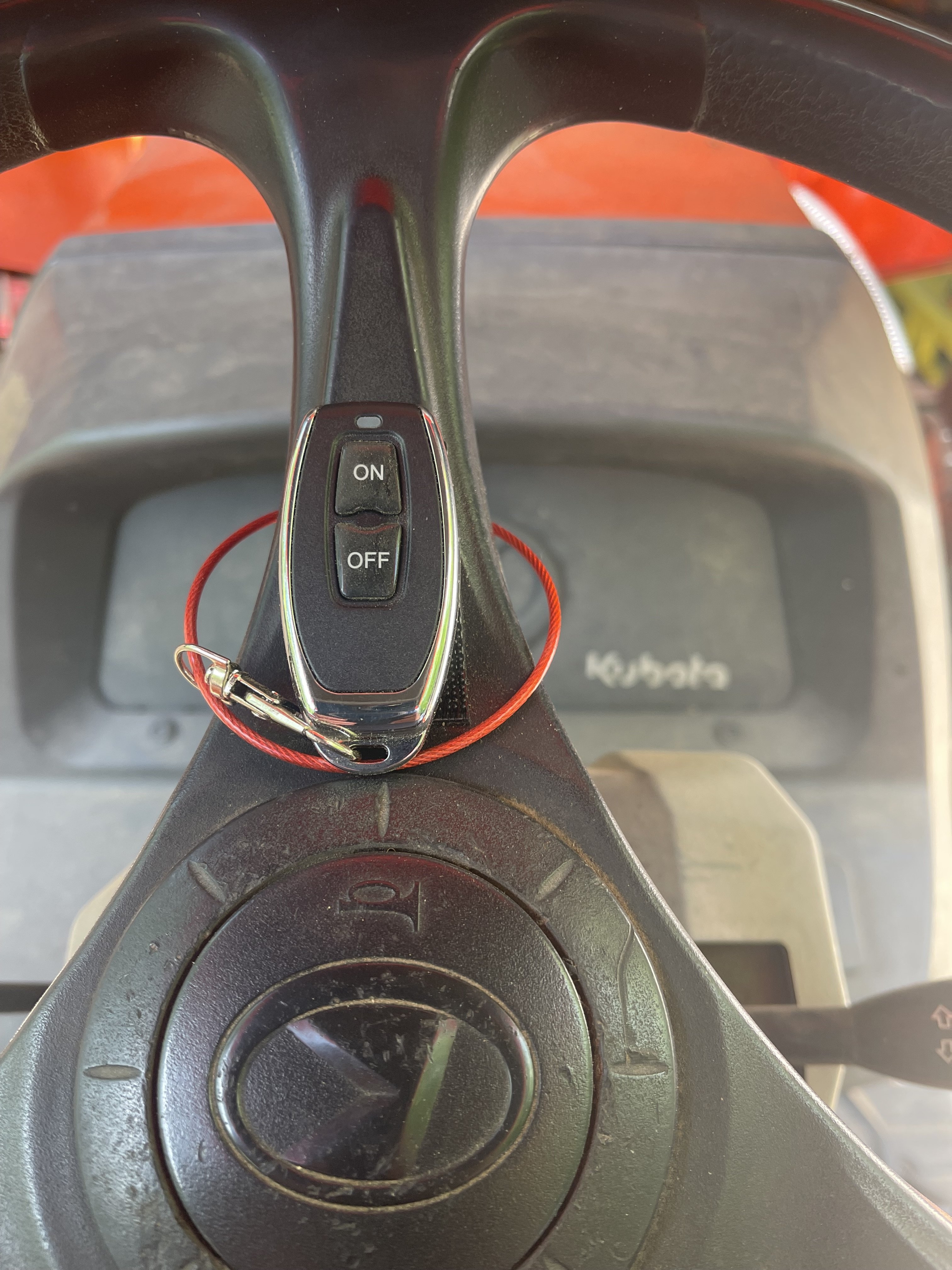

Battery and remote control was ruined. Able to replace and use Dewalt batteries for under $60. Remote switches 3rd function from cutting to rotation of cutter head.
