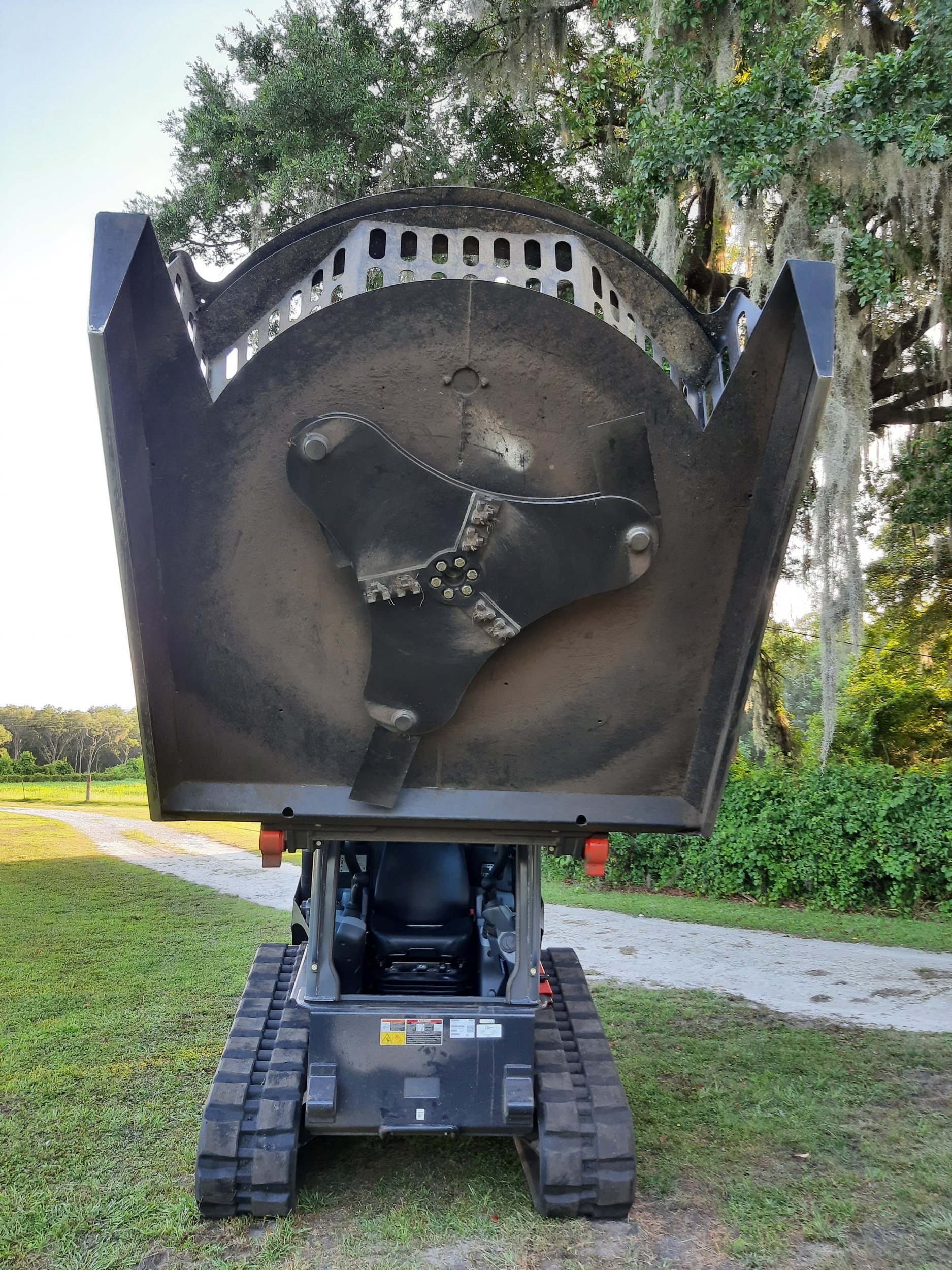

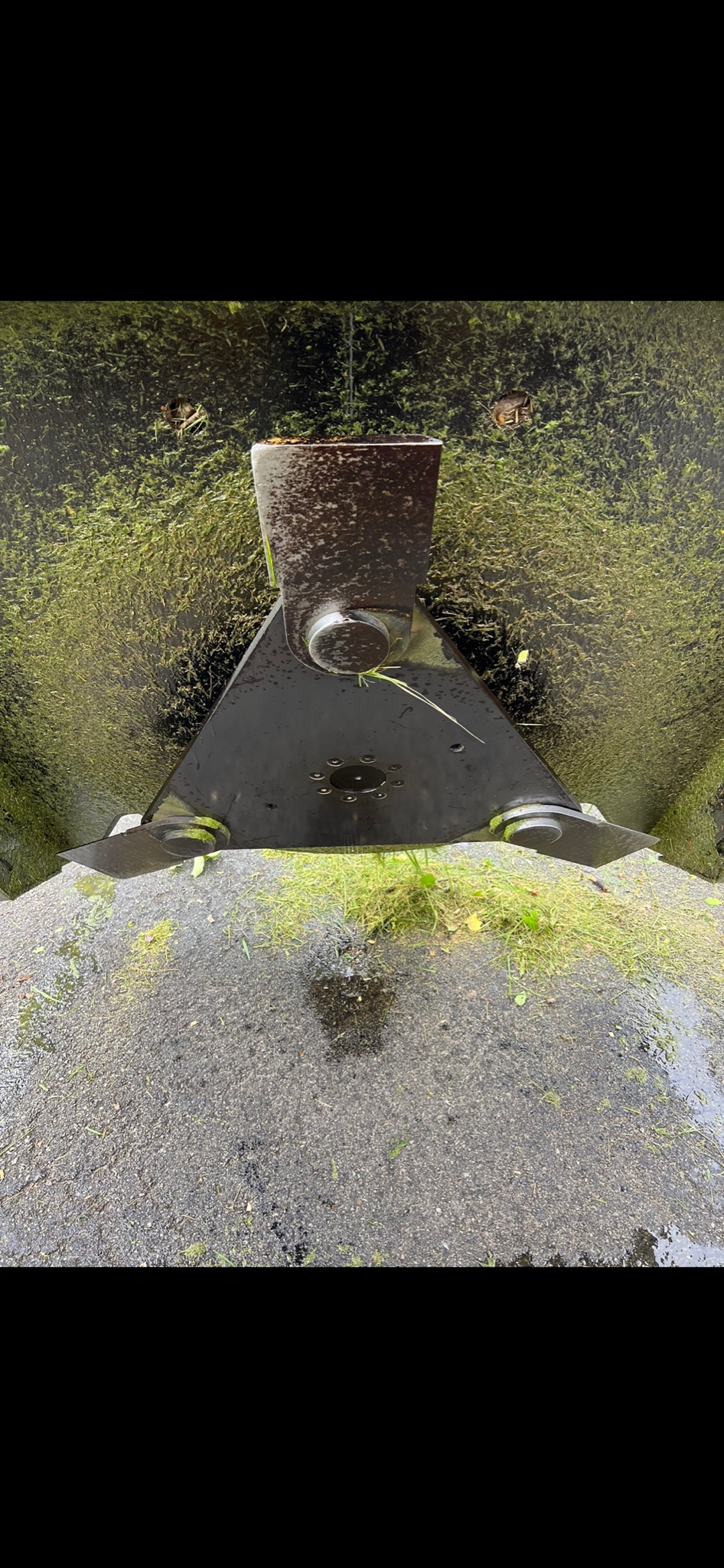

I really like your MTL cutter. That cutterhead makes a lot of sense.
It has been really good for me and I put it places that make me cringe sometimes, but that is what it is designed to do, I have been cleaning up around an old slaughter house last week and today and I can't tell you how many concrete blocks and steel and re-bar that i found, but it hasn't missed a beat, this is one of those places that no one would put a mulcher as it would definately ruin some teeth.

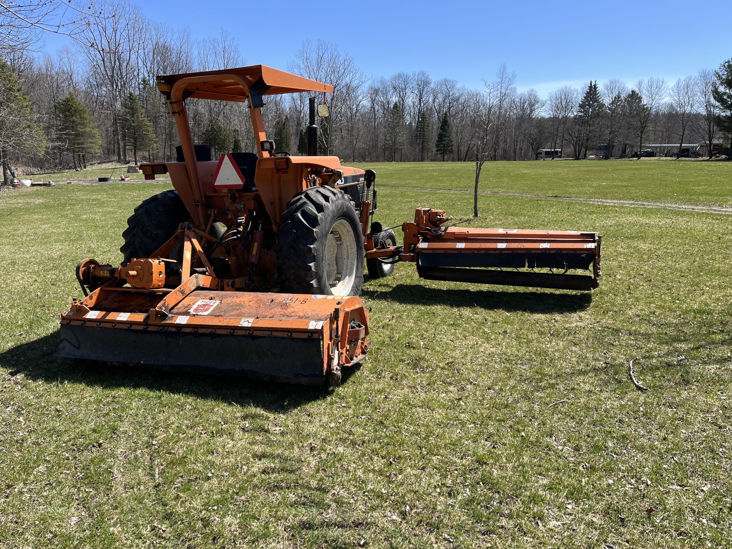

I clear trail edges using a side flail. I have found that drum flail mowers are much more versatile than rotary brush cutters and overall much easier on the tractor. I like that I only need to drive along the trail to mow the edge, as opposed to having to angle into the edge of the trail with a front or rear rotary cutter. This is not only faster, but doesn't tear up the trail. This flail mower is 7-foot long and combined with the lift arm allows me to stand the mower up vertically to cut back tree overhangs as high as 9-foot. Of course, combined with the rear offset flail, I can quickly mow the trail and edge simultaneously.
I would like to see some more pictures of that rig, particularly the one on the side of the tractor to see how you fabbed it up, looks like it would be very efficient for trail mowing, pond edges,etc.
