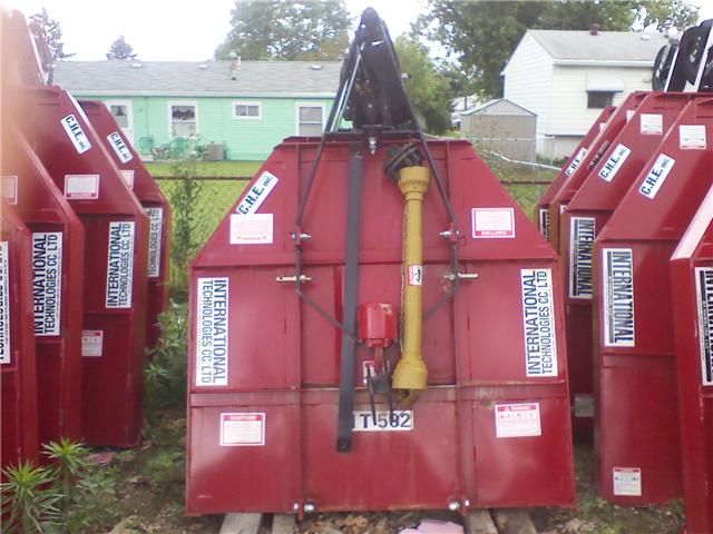

Besides brands previously mentioned by Beppington and Triple R,I would also look at Hawkline(previously the International not IH ).I'd get a 5'-er,and run from Queen Krutter(just there standard b-hogs). :D

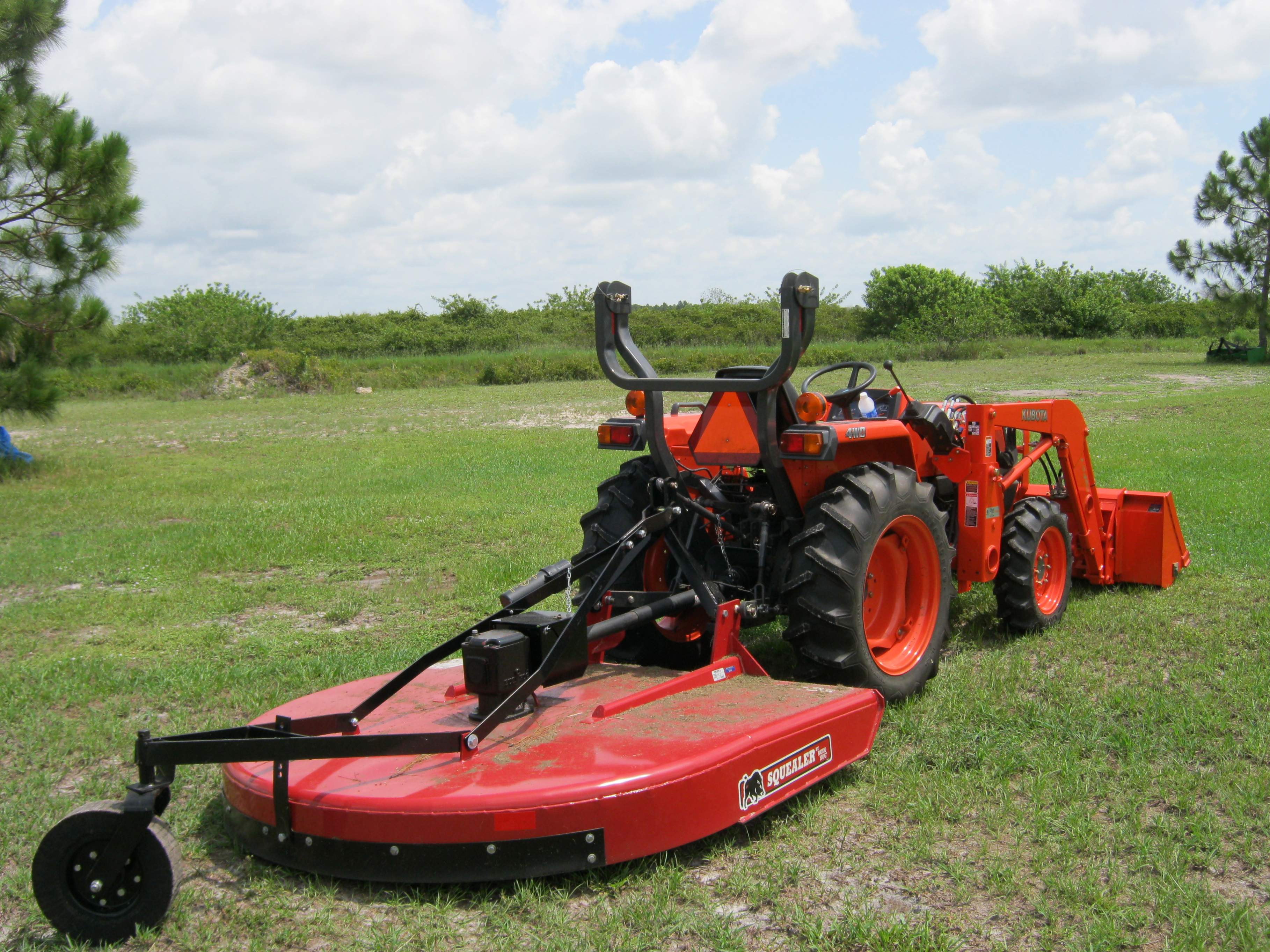

I use a 48" Bush Hog rotary cutter on my B2620. Actually, I wanted a 42" since most of what I do with mine is around the edges of fields, etc. and I am backing under things almost as much as actually mowing. I wouldn't want more than my 4' mower on any of the small B size tractors, or anything smaller, but that is just me. Now a neighbor has a BX23, and he uses a 4' mower, and likes it. He also mows for money, and a lot more than I do. There is a sliding stop under the fender of the small B's with the 1/4 inching that limits the down travel, and I usually only use that for my rotary cutter, but to be honest, with the kind of mowing I do, I can't really tell you how well it maintains that position. There have been times when I wish that I had bought a finish mower instead, but I do hit "stuff" backing into some places so I guess I'm just as well off with what I have. You do have to cut higher than I would like sometimes on rough ground just to keep the front from digging in on corners, and mowing around "stuff" in places where the contour changes often.
