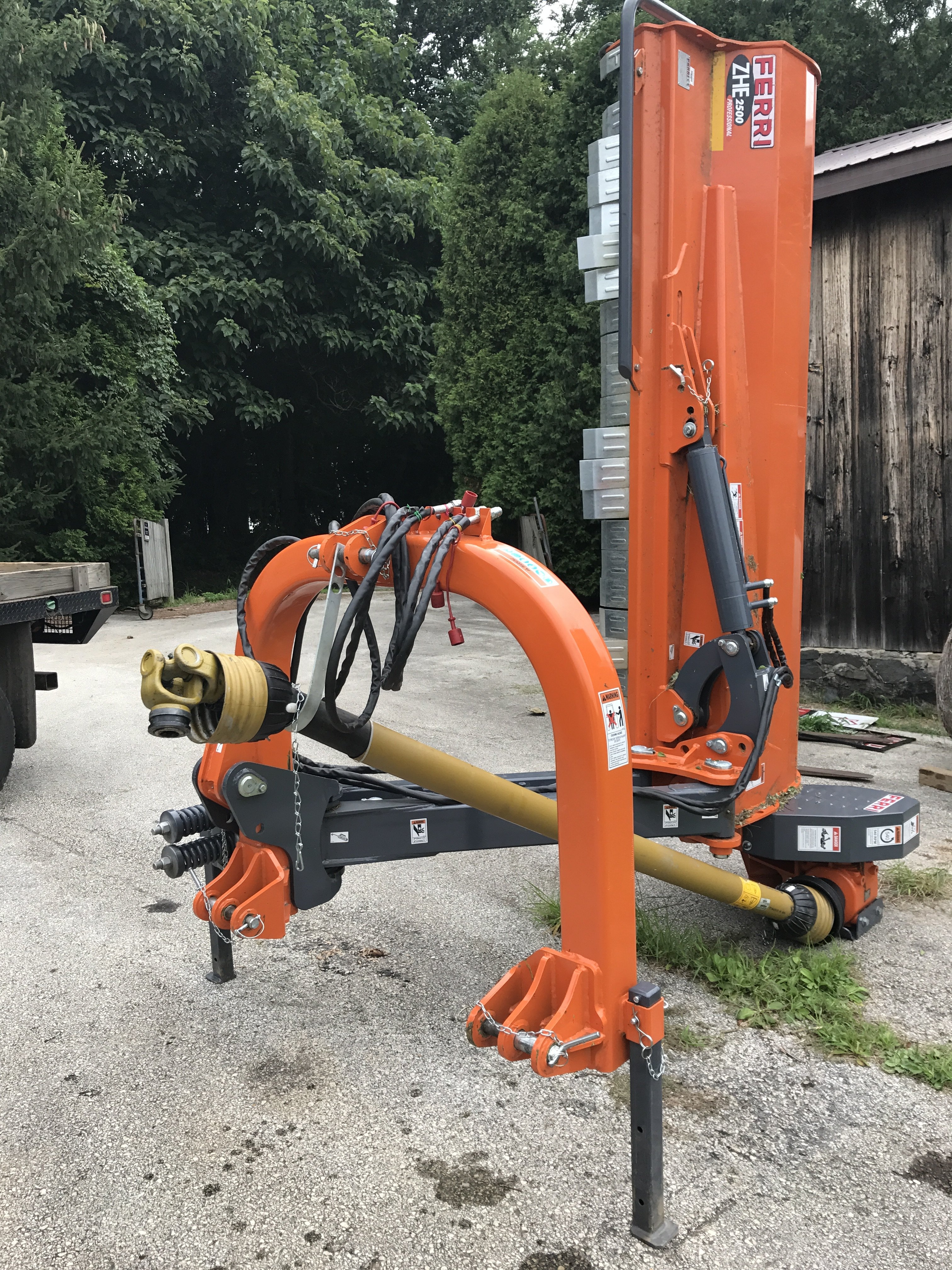

I ran this Ferri hydraulic offset for a few years. It was a large, heavy mower and didnt really do what I thought it would do. It was excellent quality and heavy duty, but it threw the tractor around like a rag doll at times and the reach I thought it would have never seemed to be quite enough. I used it for a few years, then sold it.

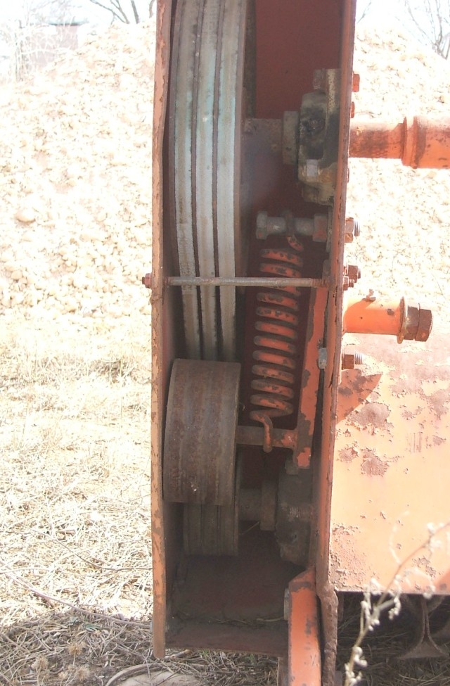

The spindle on my Barracuda is over-driven by at least 2.5 times, perhaps more--I've never measured it. This is a picture of the drive belts before I replaced the bushings on the tension arm so it does run straight now. Way down at the bottom is the driven pulley.
