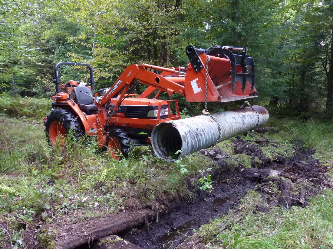

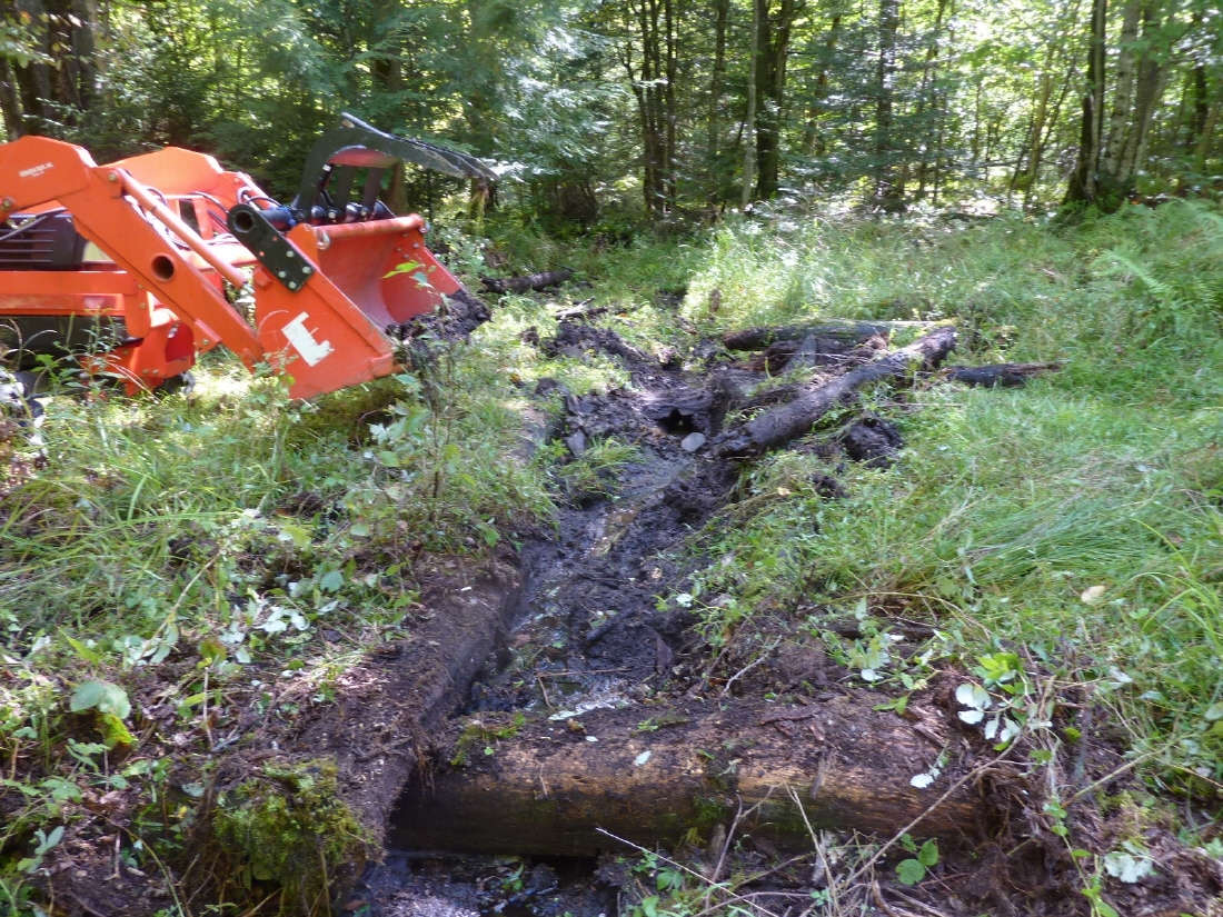

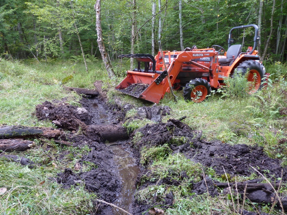

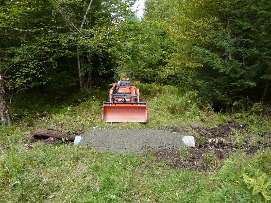

I replaced a failed logging bridge at the outlet of a swamp with a culvert. It was doable but not that easy.
Pull out old bridge and dig a culvert trough in the muck.
Set Culvert

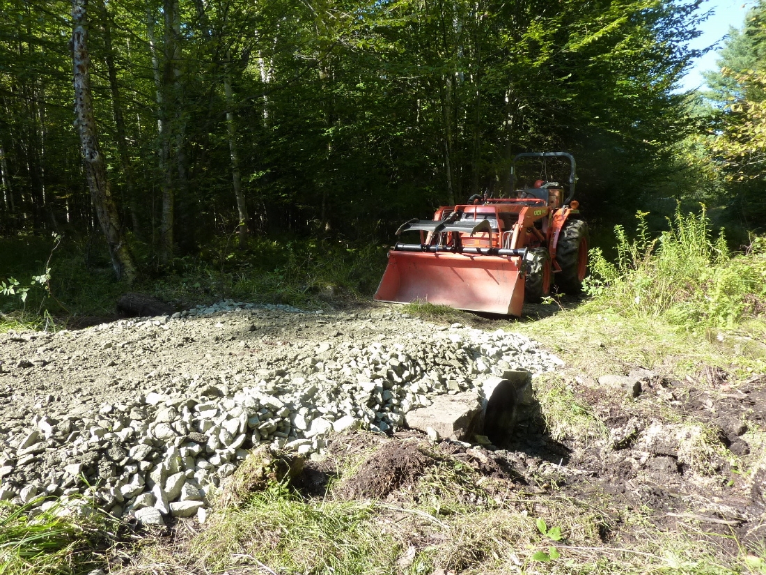

Cover and cushion with 3/4" gravel.

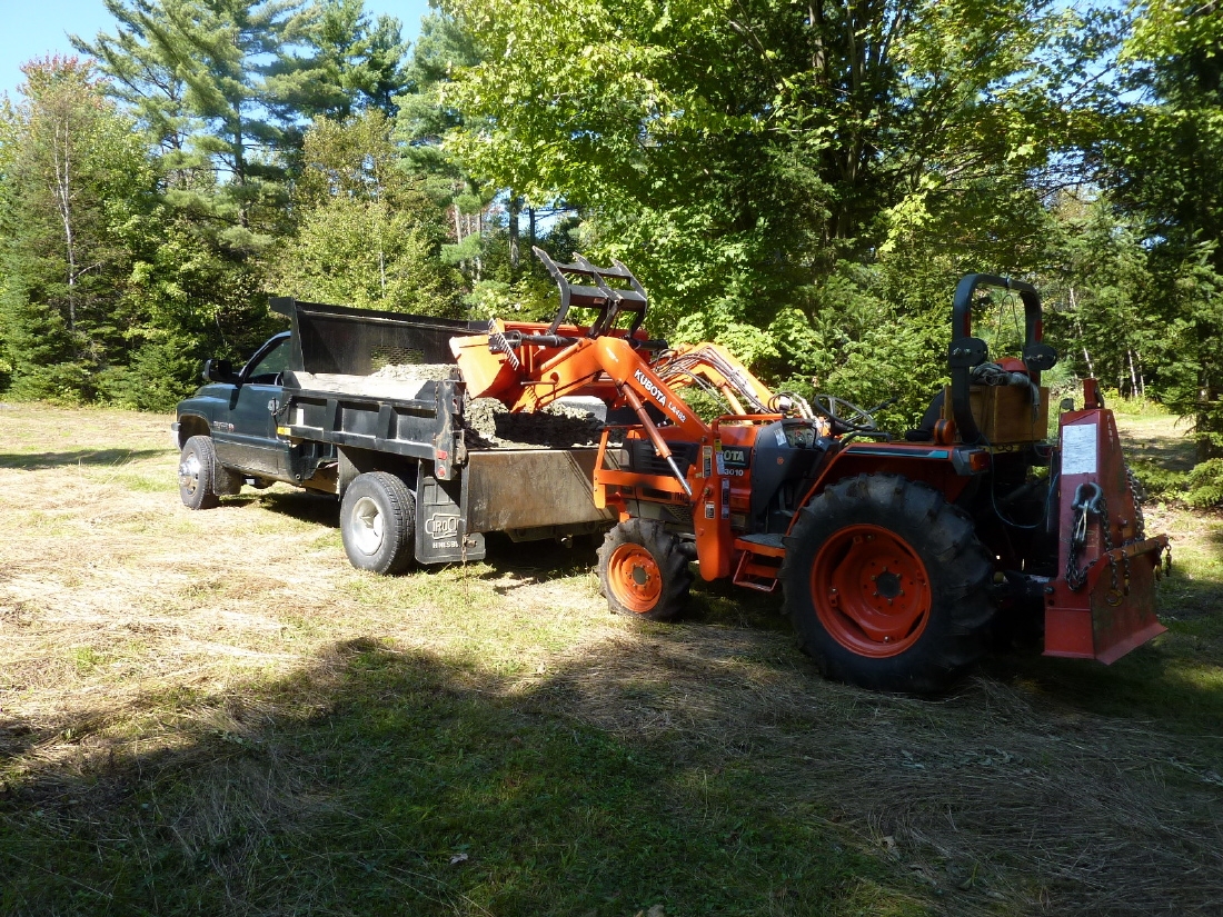

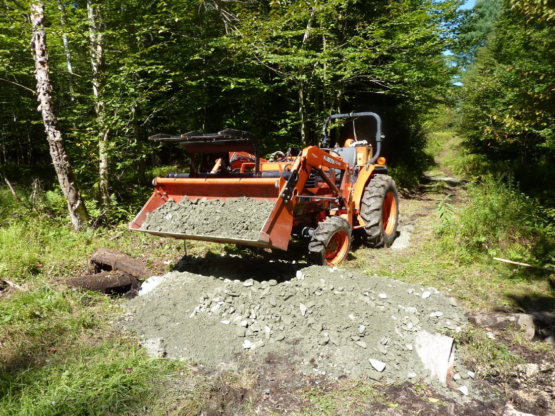

Bring gravel one bucket at a time 1/4 mile down skidder road from closest landing.
Beef up culvert covering and trail with 3-1/2" road base.
gg
