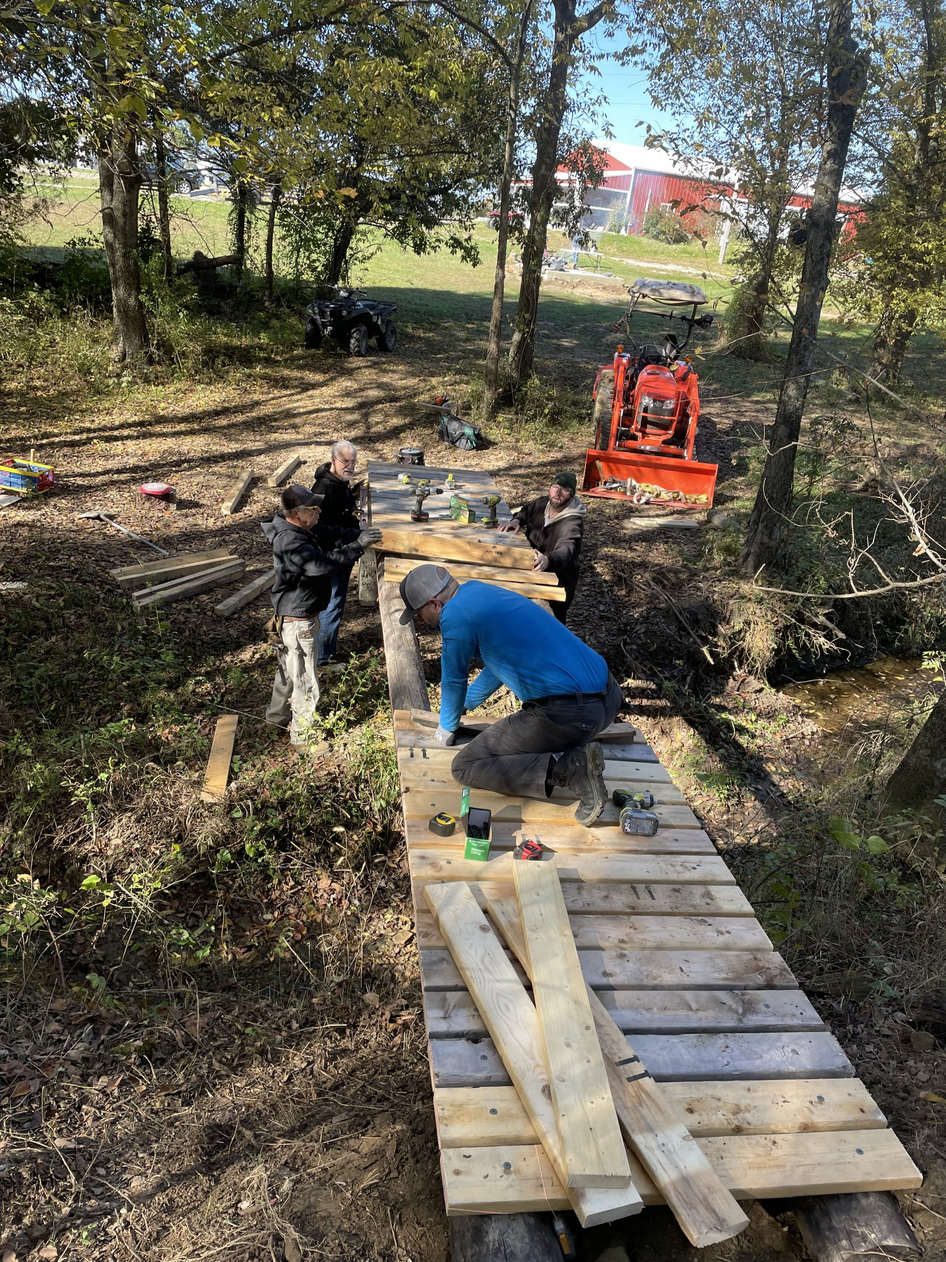

I like doorman63's suggestion of utility poles. They'll support a lot of weight, and will likely outlast you before they rot, unlike the fir.
As far as center support (should you go that route), how big is the stream at its highest? A strong current or high level is going to put a lot of stress on those supports unless they're well anchored.
For the center of the stream and possible supports, the water will not go much higher than the picture. I picked this spot because the water will rarely even get close to the bridge itself and usually will be halfway or less up to the bridge itself.

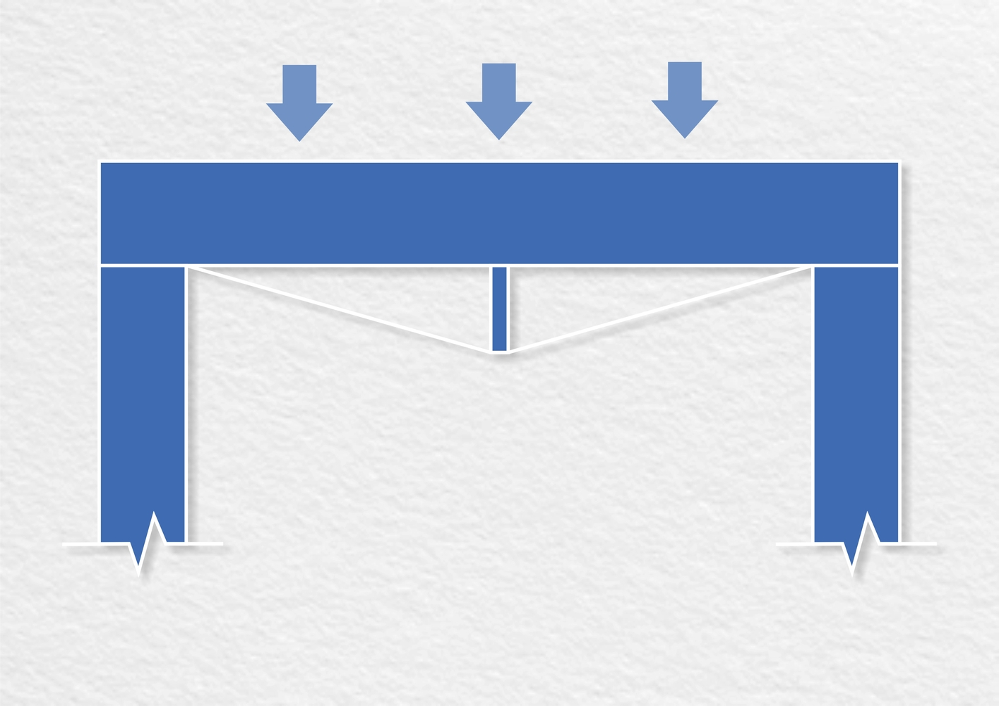

An inverted king post bridge design will add strength, even if the post is 1 foot. More is better if you can keep it out of the water.

I’ve considered doing something similar with 1/4 or 3/8 aircraft cable and 2 short pieces of tube steel if the bounce is too much. I have most of the materials on hand.

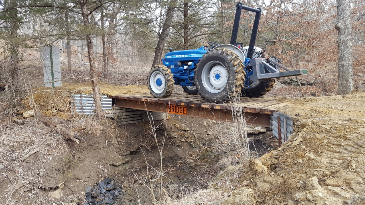

Used an old tank as a culvert over a seasonal creek bridging a ravine on my up north property. I found tank in the woods cut both ends off it left a few inches around the ends of plates to add rigidity I think I posted a picture of it when I towed it up north, anyways worked great driving ATVs snowmobiles and a sxs over until my stubborn confidence took over and I partially crushed in the side when I attempted to drive my 10k lb skid steer over it.
