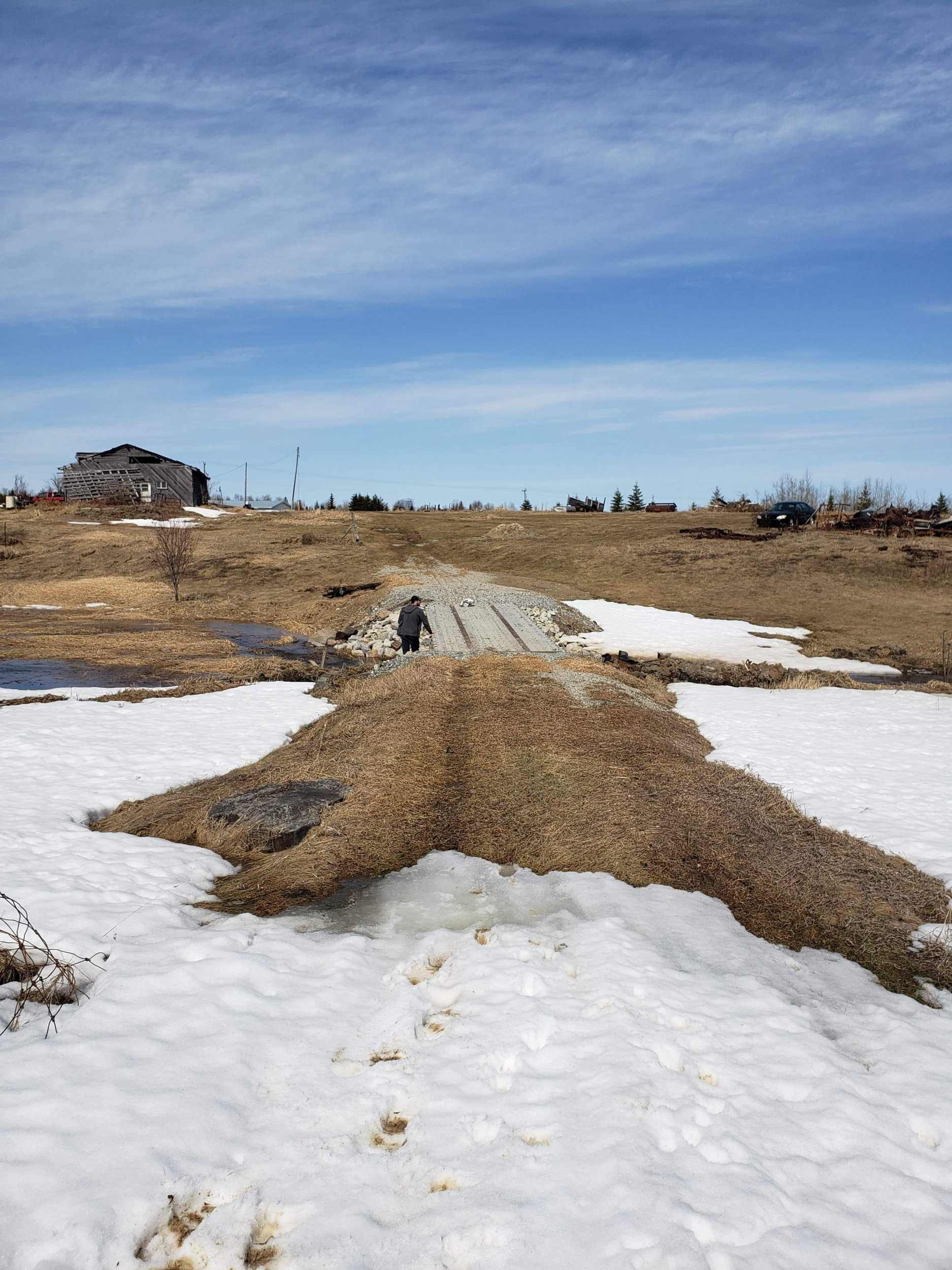

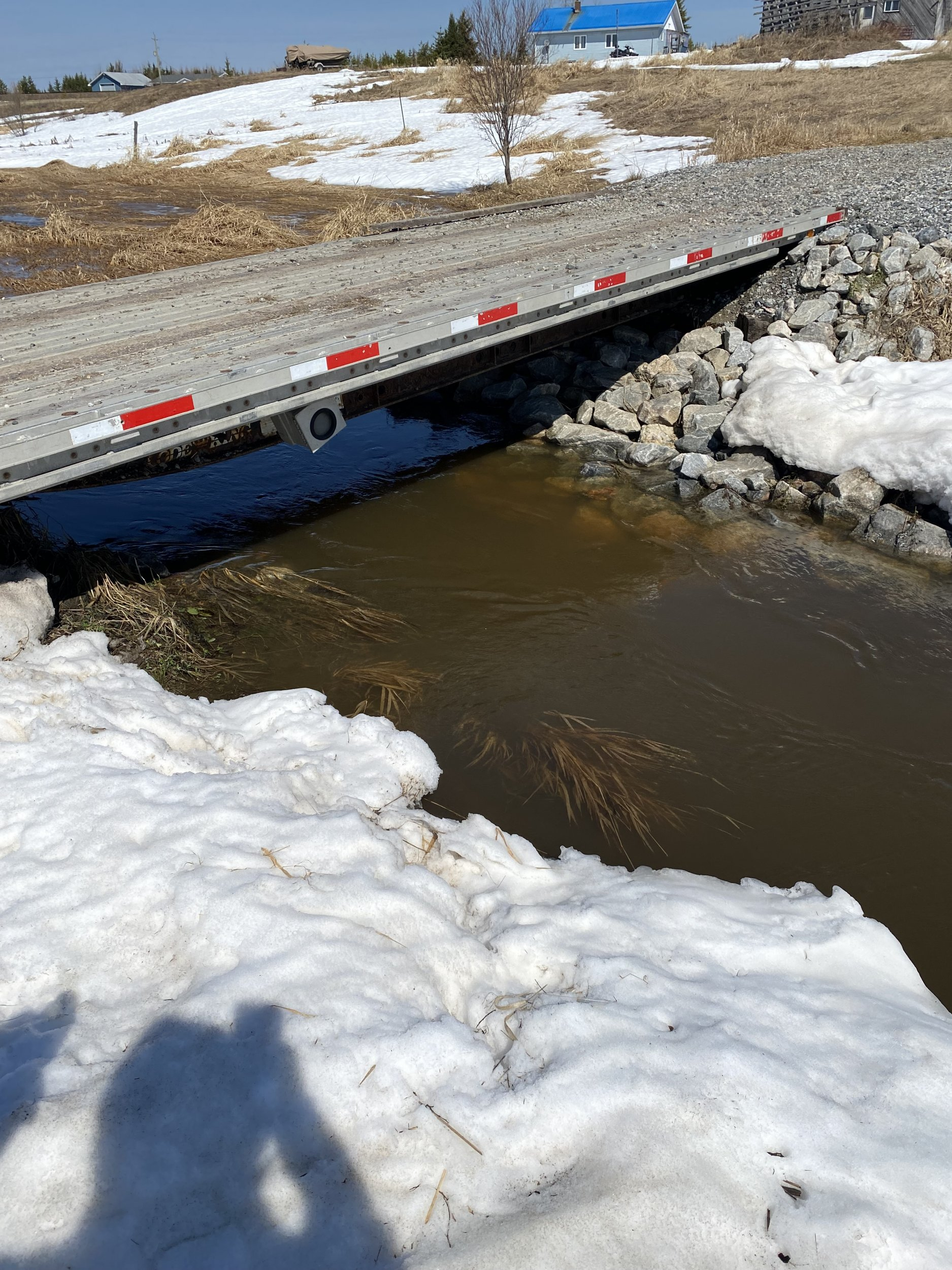

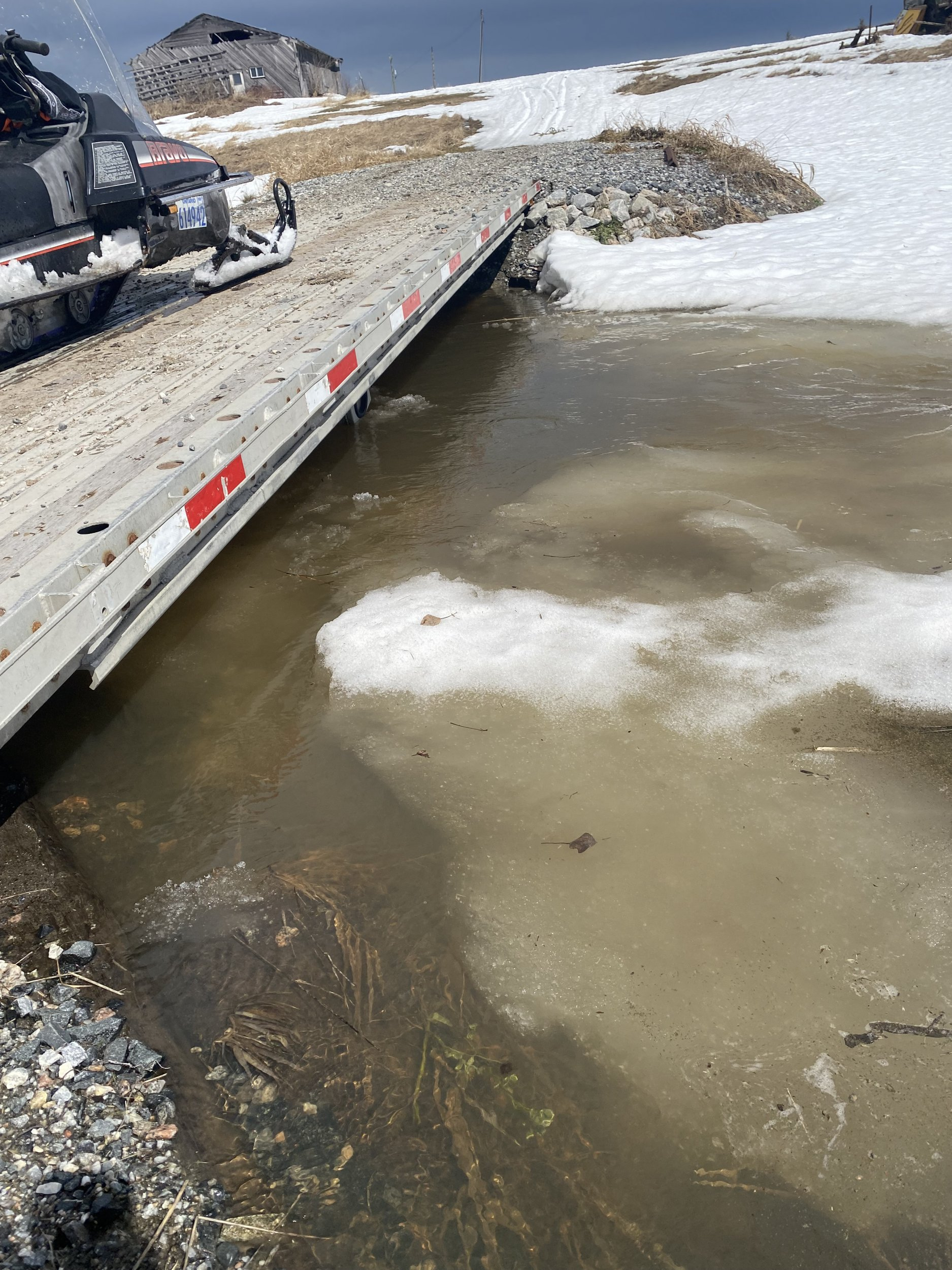

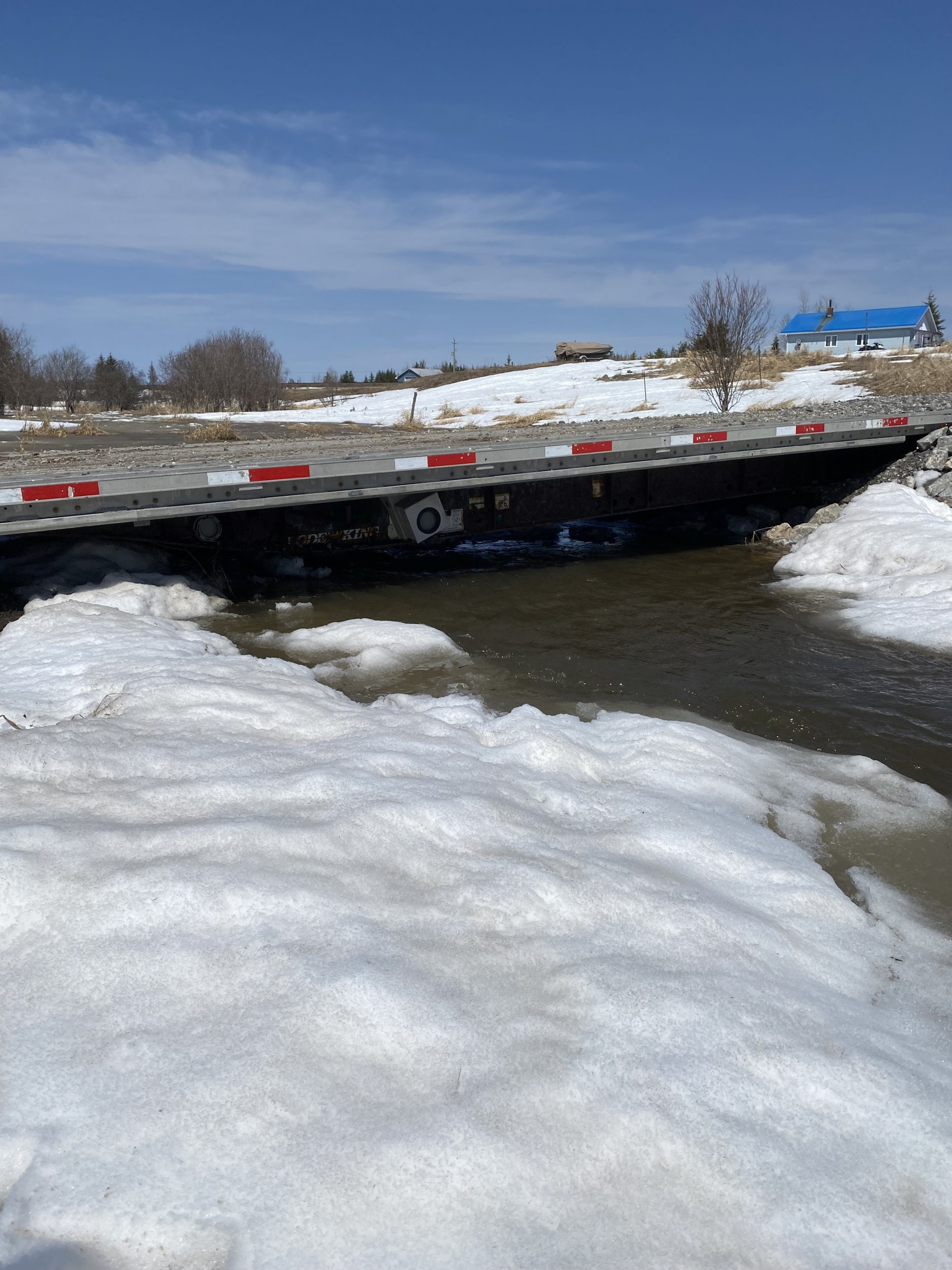

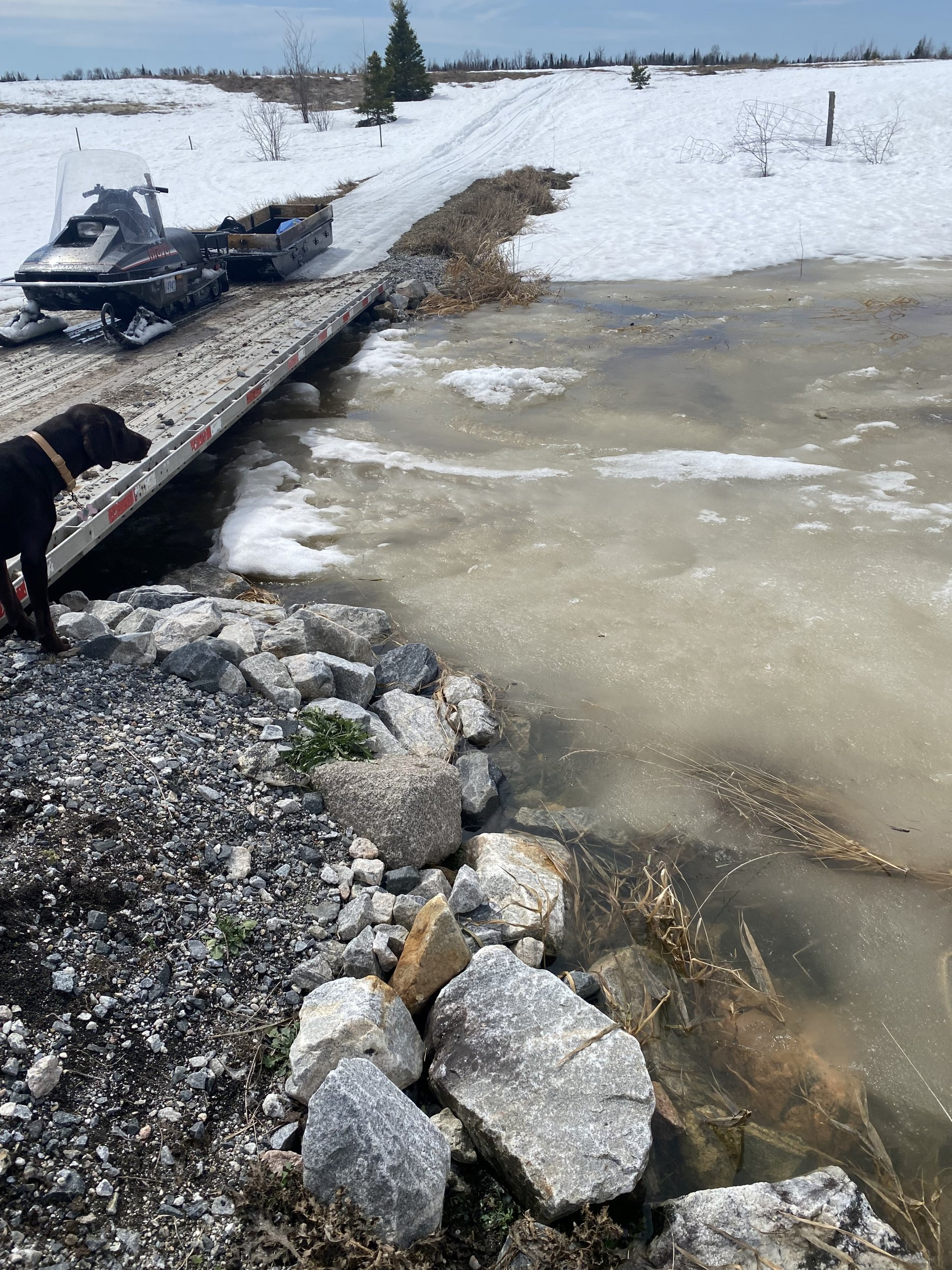

ha I see nice ... I really scored on this trailer since the cross members was completely refurbish two years before it was take off the road so it is in good shape and no cracks as far as I can tell and I did look pretty good ... it was taken off the road because of the rust on the axels and lifting legs up front. The brakes and wiring needed to be done as well so they just retired it. I haven't had issue being slippery yet, there is a piece of 2x6 imbedded in the deck probably for traction I am now realizing but I do take my time crossing on it since its not very wide, its also well level but thanks for the heads up I will keep that in mind.
/ bridge construction on a budget
#25

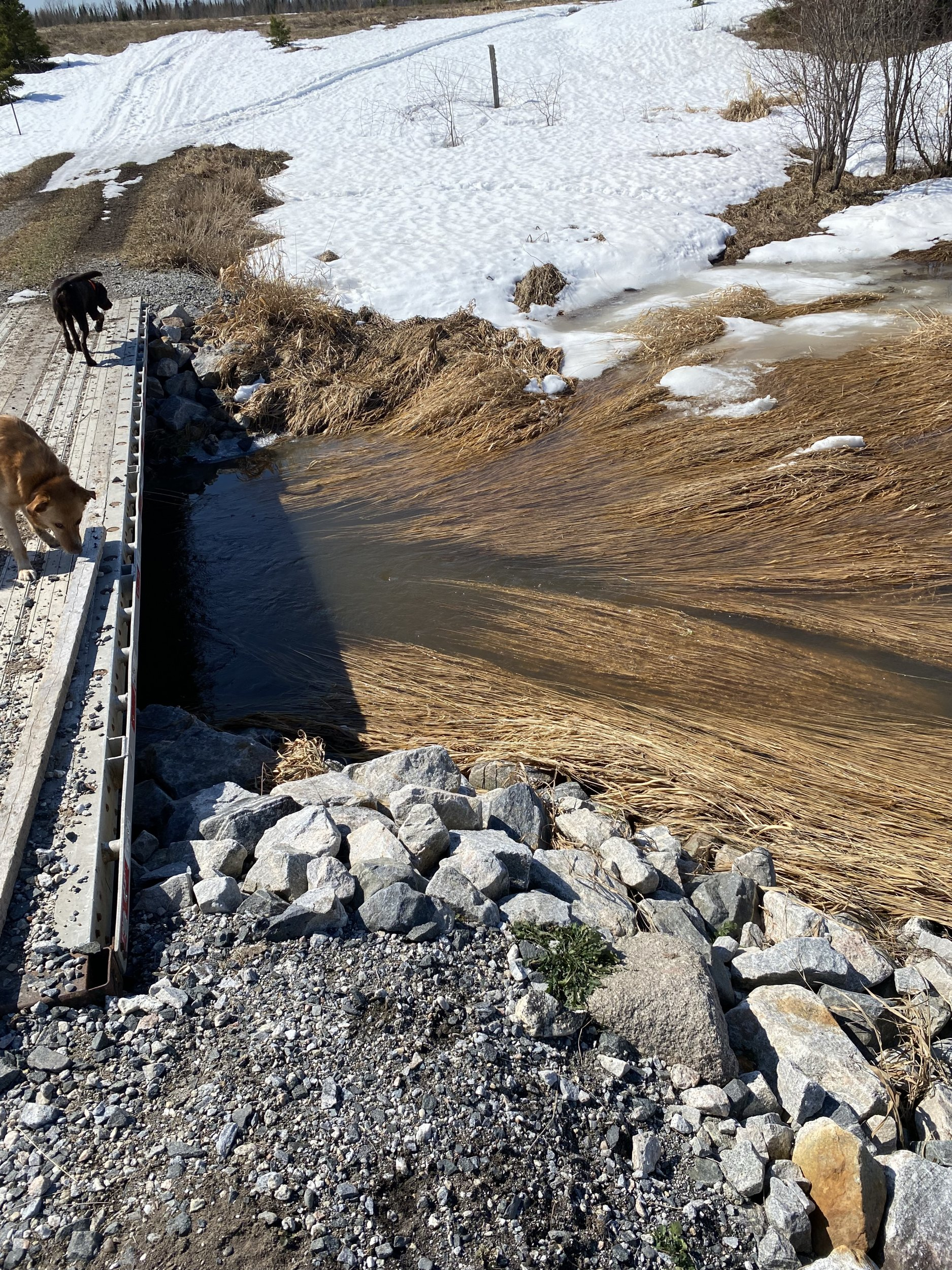

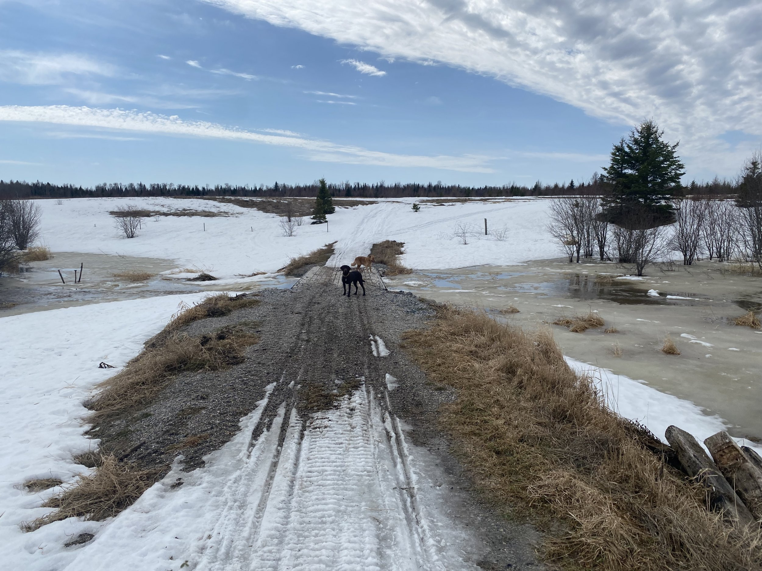

well i am happy i got that many rocks and glad it is has high as it is … all the snow melted in 5 days it dissolved crazy fast this year.
