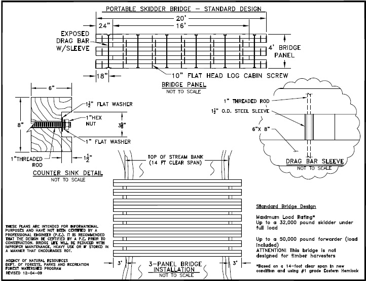

Have you seen the simple design used for skidder bridges. These are for 30,000 lb loads so can be scaled down for your use. They are 4' panels for mobility. I plan on making one using this concept 8' wide using 6x6's spaced with 2x4's.

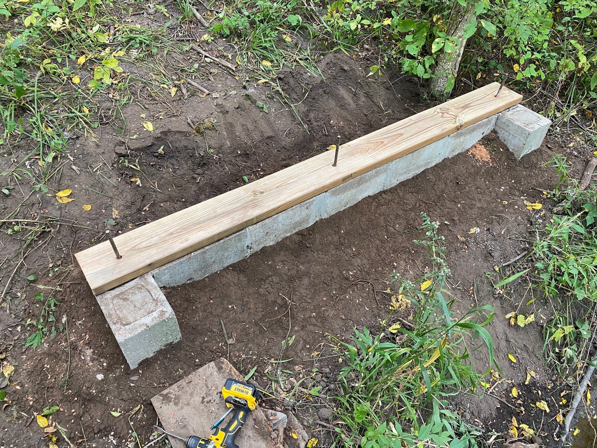

I would do 4, here is 3.
Masonry is ideal at each end.
Hey I recognize that footing! :) Such a fun project.
I pretty much just used what I had around, spare CMU blocks, 3 course high on each side. Has held up very well so far.
I only had 3 telephone poles, really wish I had 4 or 5 underneath my decking. But thankfully my decking is double-layered, old-school treated 2x6s that should last a nice long time.
What is the weight and how does it get moved?
