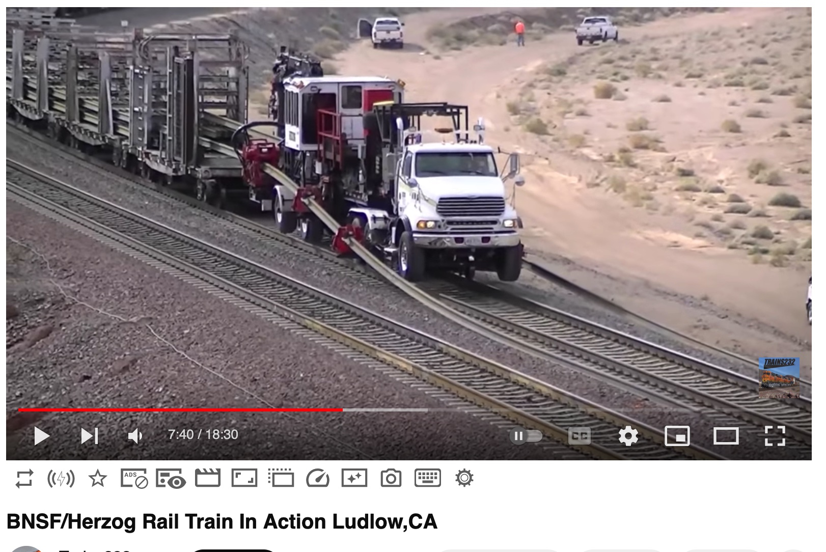

I would look for a company that builds or installs precast concrete buildings. They will have some flawed pieces 20-40' long. Probably best to get them to deliver one. You should ask them about stress, but I have found they are fine for cars and pickups.
Also, I remember my dad built farm bridges with old railroad rails with rough sawed 2x10s bolted across them. Kind of springy, I never saw one fail.
   / UPDATE on DIY bridge (long post) #36
I have walkover bridge like that not sure I would trust my truck on it. The 40' rails are springy just walking across.
   / UPDATE on DIY bridge (long post) #37
Railroad rails are probably designed to span a gap of not more than about 2 feet.
