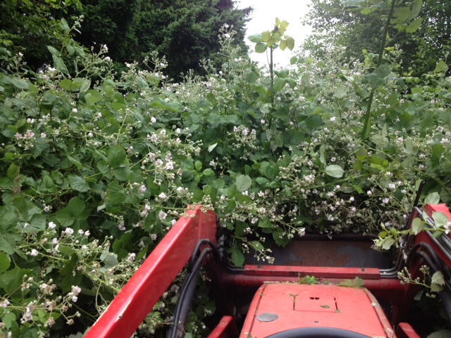

Hey all,
I am working on a job that requires the removal of some very overgrown blackberry bushes (probably over 10 years worth of growth)... I have part of it done but the hard part is still coming up. My tractor a brush hog do a pretty good job but now I am getting into some growth that includes some small trees and there is an old building in there (I have already worked around two sides of that).. Also I don't know what is in the bushes and after 1 front flat tire, not sure I want to put my tractor into the unknown. There is probably about an acre or so left. You can see the the pictures what I am working against (and being pretty effective for the most part). I have a MF 1240 (about 30 hp) and a 5 foot mower (just to help with the sizes of the picture)... I have already spent about 6 hours over there to get about 1/2 of the area cleared. The current way I am doing it is to drive through it first, then mow it after knocking down the bush and checking for hidden suprises...
I know in the future I will need to come back and keep it mowed down but the initial clearing is the hard part.. :^)
I thought maybe there would be some other options. Maybe renting something would be more effective at knocking all this down..
My initial thoughts came up with two options:
1. Rent an small excavator with a mower and work my way through it (Kabota 161). Could use the front blade and a bucket to clear out things I was not able to mow down.
2. Rent a dozer and just run it all over and push into a big pile (maybe they could burn it later).
He is willing to pay for the rental of the equipment and my hourly rate to get job done. Plus there is a few stumps up by the house he would like taken out..
Does anyone have any suggestions? Which option would you go with to clean up the area?
Thanks

I use one of these on my tractor to clear blackberry bushes.....works great.
BXpanded Piranha Tooth Bar
With the building you describe and the unknown.....the dozer is probably your best option.
/ Blackberring clearing #3
I would say a dozer and make sure all the roots are gone.
/ Blackberring clearing #4
No doubt a dozer would work, but we used a tracked skid loader on growth like that last year in combination with our tractors. My son is pretty good with a skid steer or excavator but has no experience with a dozer nor do I.
We could have done it with just our tractors, but flats are a real hazard in some of that stuff, we still managed to get one.
So nobody thinks one of the fail type brush mowers (that can take down small trees) on a excavator would be a good fit for this job? I first thought a dozer would be the key but wonder if chopping it up with a mower would be better and easier to clean up.
Thanks for everyone thoughts!
Tim
/ Blackberring clearing #7
Tim
May be, I just have no experience with one and we piled ours up into brush piles that we can burn or leave for wildlife cover.

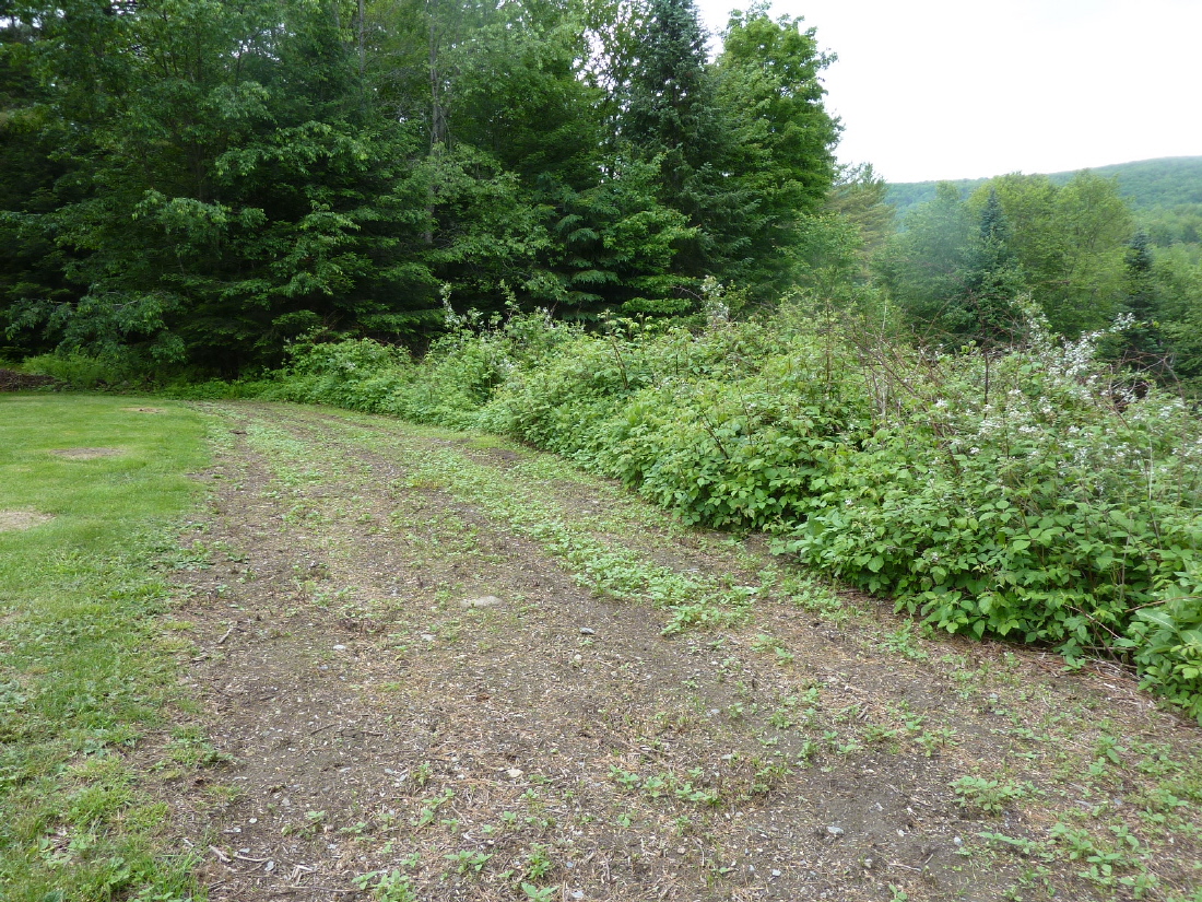

I did a similar black berry job, but much smaller, earlier this spring. My wife wanted to push back our black berry jungle a little to give her more room around her blue berries. I have a small dozer. I ran the dozer back and forth thru the berries to chop them up with the dozer tracks. Didn't use the dozer blade at all. Then I ran my tractor and land plane thru the area to even things a little and get some of the roots out and also to collect up the debris w/o collecting to much dirt. It is tough to get all the roots out so they don't grow back so I don't even try. I have found that if you just keep mowing the area when you mow the lawn the black berries will disappear and it will fill in with grass. I should put some grass seed on this to make it grass in quicker but haven't got around to it yet. This is how it looks now after about 6 weeks and you can see my debris pile is pretty clean.
Maybe this wiil help.

Thanks all for the replies and ideas! I also discussed this with a friend of mine who owns some larger equipment.. He recommended the Dozer route.. The one aspect I did not think of was that with the Dozer and a brush rake you can push all the vines and other stuff into a pile and get the ground clear of that stuff.. (that would make him happy) I will recommend to him that we need to plant some field grass to help keep the weeds at bay (along with keeping it mowed a couple of times a summer). The small excavator would work but with the unknowns in the bushes the Dozer would be less likely to damage... :^)
I checked on rentals around here and can get a Dozer and rake for about $305 plus delivery and fuel for a day, 8 hours of run time. Plus I will charge the operators (me) expense.
I will try to take pictures and post them when I get it done for everyone. Probably will not get to it until July...
Tim
