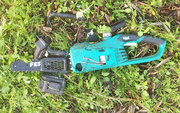

I got a Kobalt 40v one time from a local for 10 bucks and tore apart to figure out why it didnt work. 2019
She was like new but got hot and melted. No clue what the last owner did as there was no bar chain. But could only imagine.
Some folks just shouldn't own any chainsaws gas, batt, corded.
Good side
Bad side. Noticed mounted into plastic type stuff. When get hots it had melted.
Most of the little cooling fins were knocked off when it came loose. I pulled the rest to check it out closer.
Trying to learn to work on these seem to be mostly switches go out.

Used a dremel to remove the left behind plastic and then cleaned the contacts.
