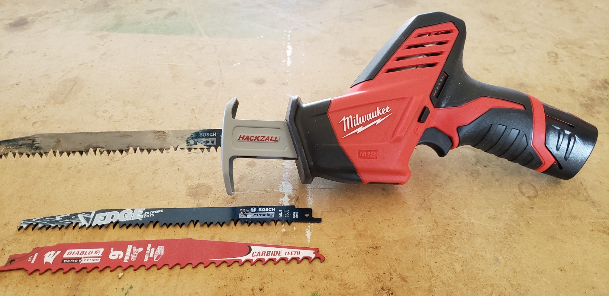

For small jobs, or when you don't want to clean a chainsaw after every use, a good pruning blade like this Bosch RP95 in any reciprocating saw will do a lot of work, fast.

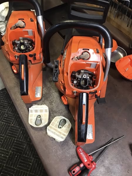

You didnt see my fix for that without going aftermarket set up? Posted in my junk chainsaws thread. Years ago.
I havent had fines get by in years. Just a o-ring in filter and use grease at base mount.
Also the free muffler mod. Take that dang restriction pipe out of muffler under deflector. Open front of deflector.
Then take out cross in intake. Smooth areas to flow. The one on 490 shown too was before I smooth it out.
All this stuff shows gains on dyno by guy in my group.

Looking back I'm pretty sure that's where I got the O-ring and grease setup from (I believe you used a Husky 272 ring? - actually I probably got it from one of your posts on the arborsite - the junk chainsaw thread is long :D but same same). I did a similar kit on my 620P - probably also on your recommend :D
Haven't done the muffler mod yet.. I should get on that..Even though I'm pretty happy with the saw as is it certainly wouldn't hurt it any to let it run a bit more open.

Yep used a 272 then. But found one that fits hair better now in SAE.
I thought I posted all of that info there too. As I even made one and showed diameters etc.
That little muffler mod lets them out cut a NE 346 muffler modded too.
Dont feel as strong etc or as rev as the 346 sounds. But it made the cuts faster with same chains.
Plus side. Echo much lighter. Husky smoother due to coil spring AV.
