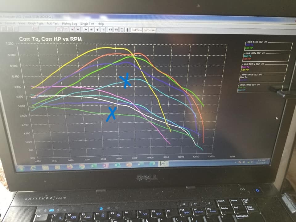

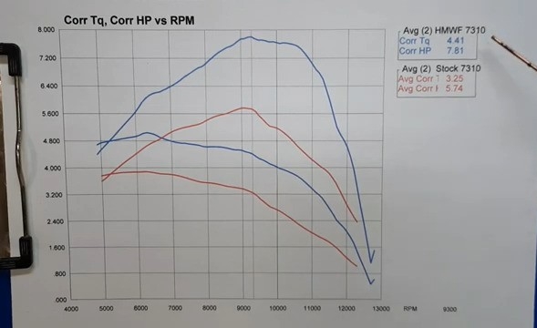

Dyno run of all the saws together. The blue X marks the echo 7310 how it compared to rest of saws in class for HP and TQ.
It was lowest in both.

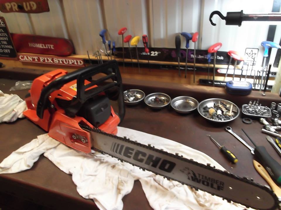

And yet, it has a 5 year warranty and is plenty capable for my large Burr Oakes. Not the fastest, not the lightest, but a fine saw for me. Expensive I’ll grant you, but I'm happy with it. BTW, the oiler has no issues with a 32” Bar.

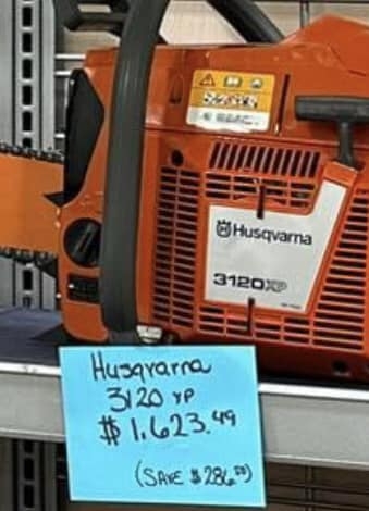

Personally I am not a Husky fan either.. Even though my 24" bar and chain would fit any of the models you listed, but would have to go with the 3120XP due to my 36" being .404 if I wanted to keep using my current bar and chain.

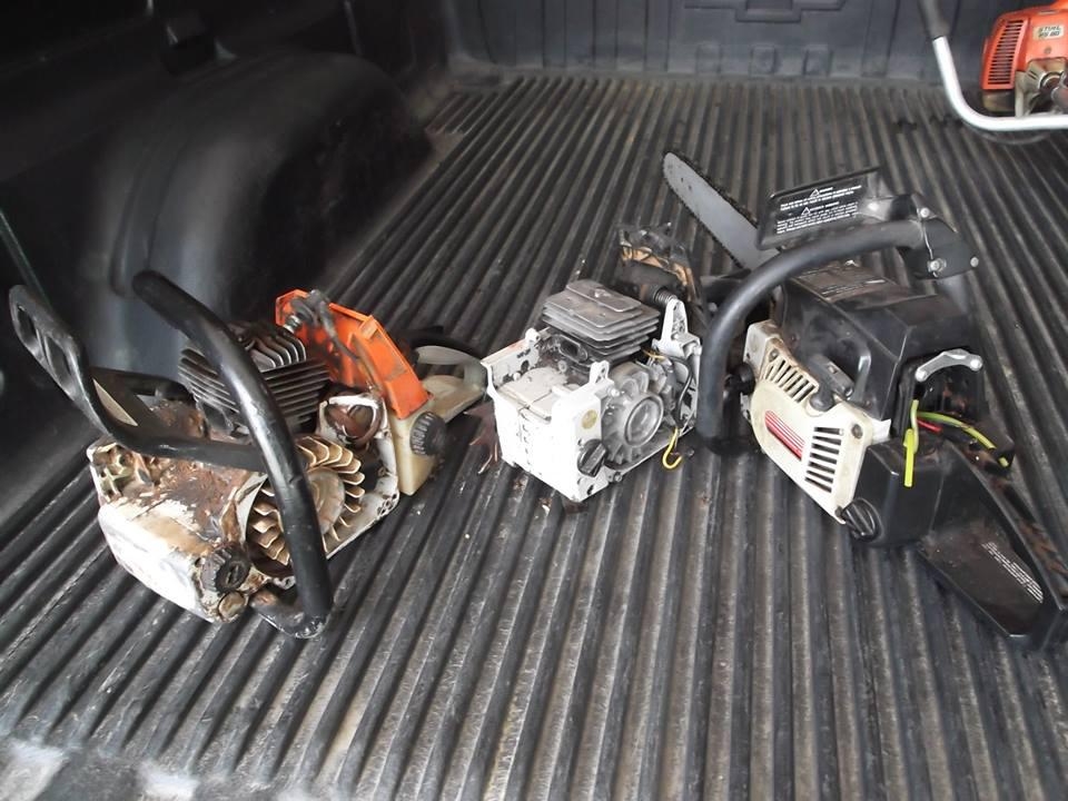

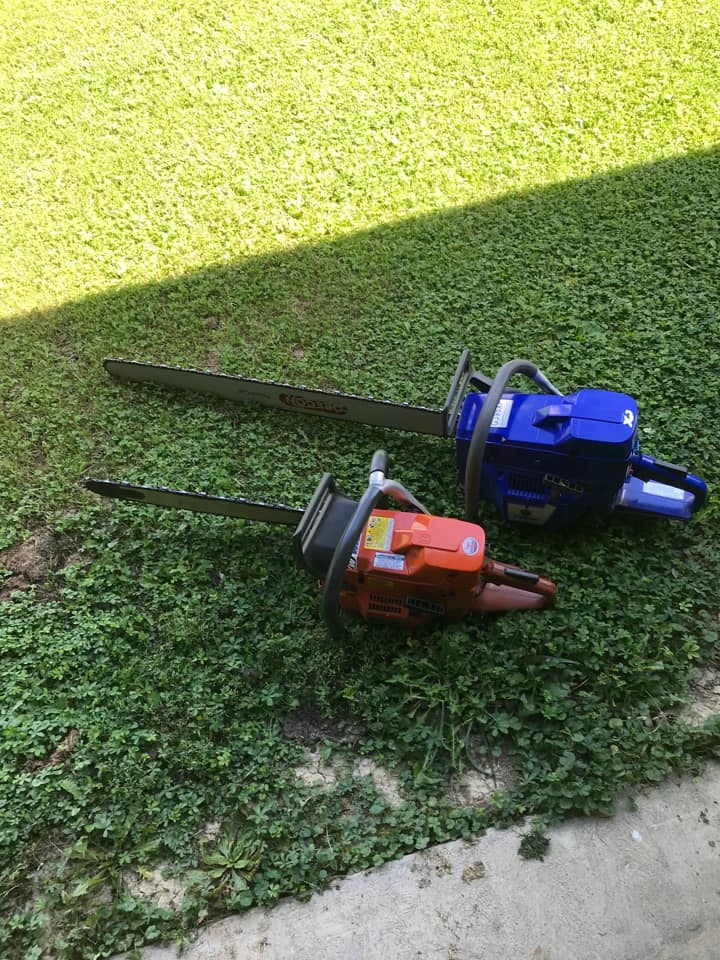

That's about what I paid for my 660's and 880, all three slightly used and bought from 2009-?2014?.
Around here, a used 066/660 starts at $600 but there aren't very many of them. At that price, plan on having to do a fair amount of work on the saw before you run it much. At the very least, it would need all new seals and boots. Most of the 90cc saws around here were bought by a farmer or firewood cutter who thought they needed a pretty big saw. There are noticeably more used Stihl and Husquvarna saws in the 70cc class around here, but they bring a noticeably higher price. The logging industry mainly does hardwoods around here, and they seem to favor the lighter 70cc stuff over the heavier 90cc machines.

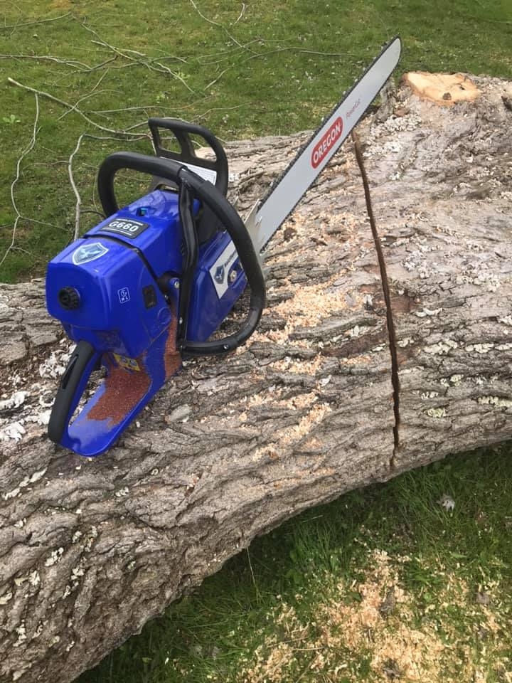

Truth be told, I actually bought my G660 because in 2021 you couldn't find a 70cc-90cc saw in running condition anywhere. I had dropped an oak in my back yard that measured about 7' across at ground level. I have an 064 that I was using at the time. I wasn't paying enough attention and it started running a little lean on me (may have an air leak), and it smoked the top end. I needed a big saw and I needed it pretty quick. The G660 was at my door in 2 days for about what it would cost if I rebuilt the 064 myself. I still need to rebuild the 064, it's a good saw.
Something worth noting, when you get to a 32" bar (or longer), its worth considering a semi or full skip chain to provide more room for chip clearance.
