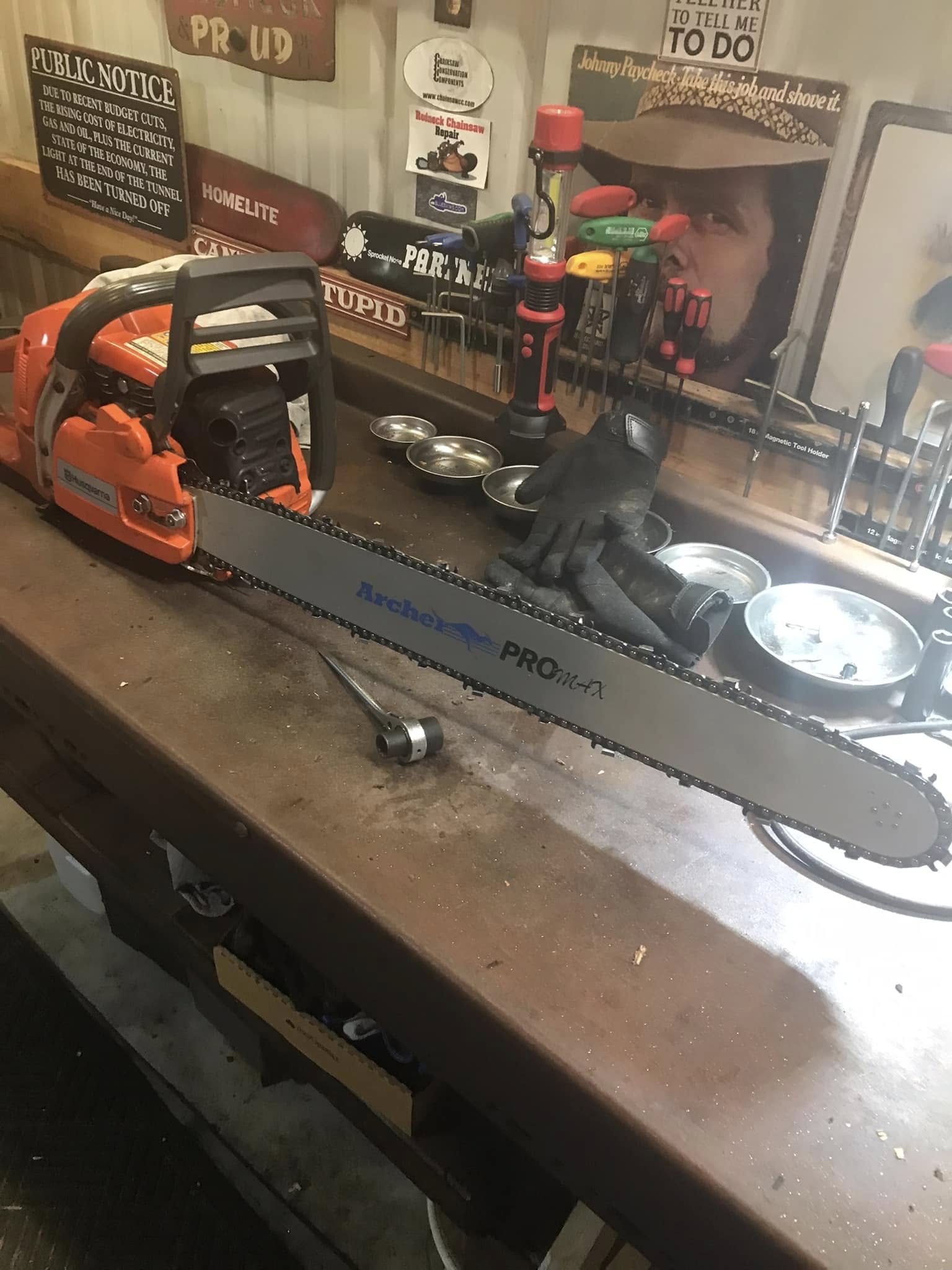

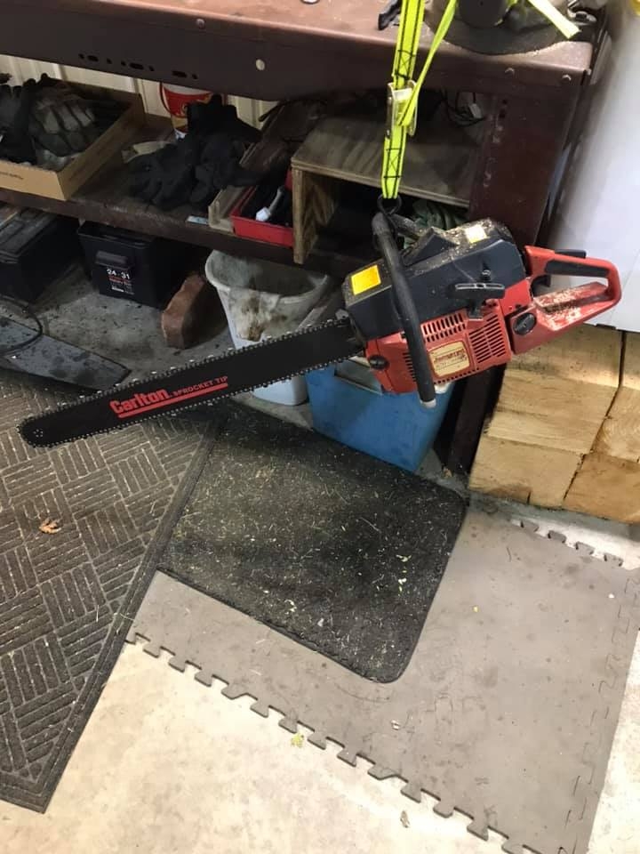

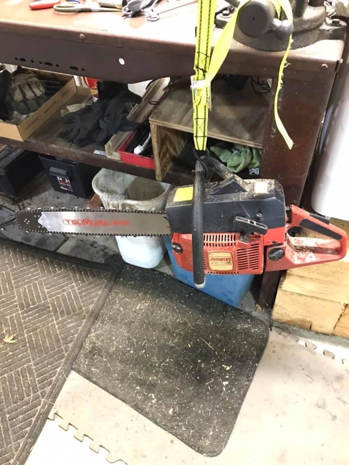

I didnt like how my 670 champ handled with a 28" on it. Then I went back to 20".
But just to show the balance differences.

Same happens using 24" as I am doing that now with my ported 359. Back to 20". But 24" there if and when needed.
