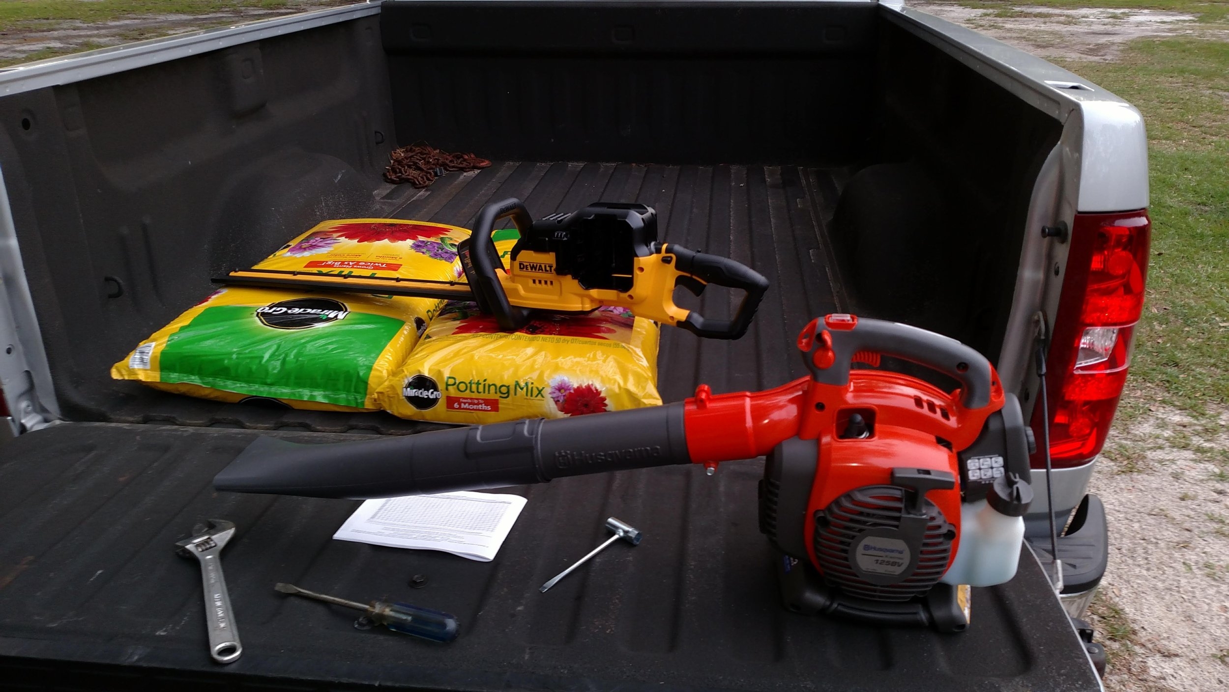

2 years ago, I purchased a DeWalt 20V saw with a 12" bar. It was a little short for what I needed so I replaced it with an Oregon 14" bar and Oregon chain. It worked perfectly.
Last year, I bought another DeWalt 20V saw, this time an 18" model. I do a lot of cutting on the ground and got sick of re-sharpening chains so I bought an Oregon compatible 3/8 pitch, .050 gauge carbide chain. It also worked perfectly.
I can't speak for other brands, but DeWalt cordless saws use standard Oregon bars & chains.
BTW, That same carbide chain I bought also fits Echo CS3400 and CS3450 saws but I'm not sure about the DSC-5000.

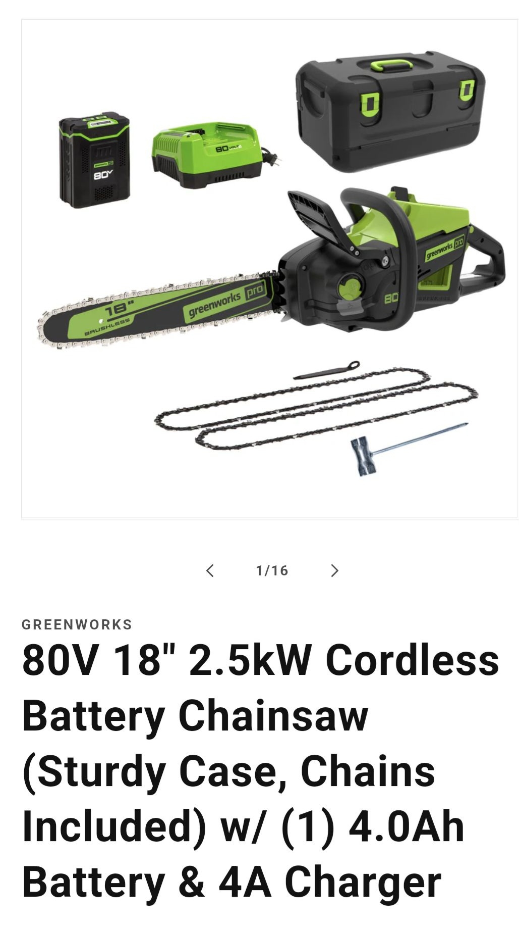

I used my 80V Greenworks last two days a lot. Three heaping truckloads of white pine branches and two more yet. I bought a Greenworks 80V weekeater from Walmart because it included battery & charger, less expensive than just a battery. So I have a spare for saw & charge one as I use one.

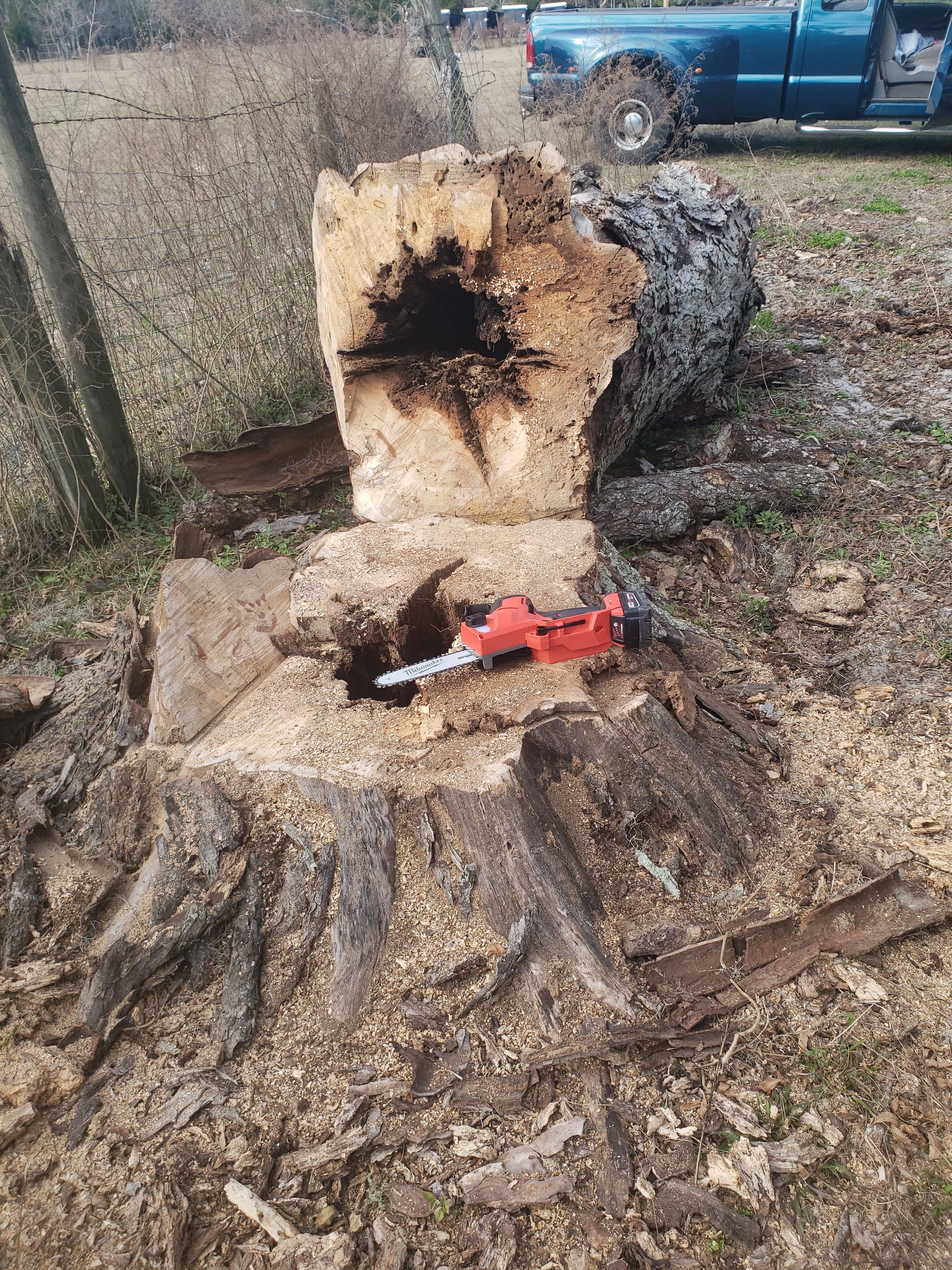

I just got one to keep on the tractor to cut limbs and other small items when I am bushhogging. A Milwaukee...
