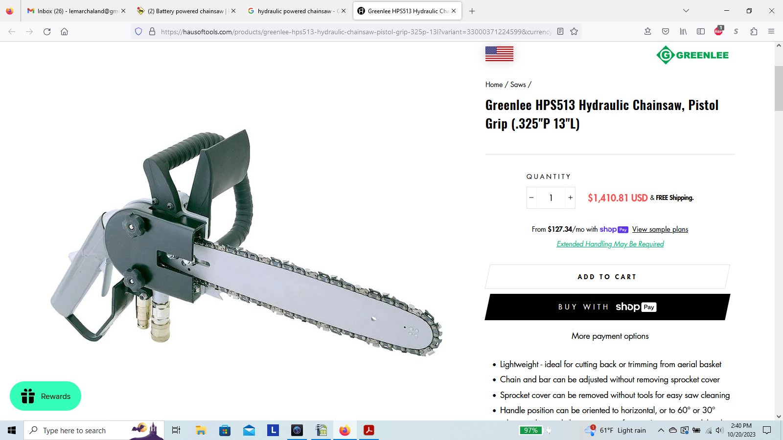

Or go whole hog and get a;
Have you ever used one of these? I can't imagine wanting to spend $1400, to have the privilege of dragging heavy and awkward hydraulic hoses around with my saw. :rolleyes: Heck, that's beyond MS-660 money!
/ Battery powered chainsaw #585
Ran one a few years ago working with a fellow with a wood processor, used the hydraulic saw to prep the logs for the processor.
It had a lot of power the hoses could be a royal pain till you got used to throwing them back good as you moved around.
His processor was hydraulic powered off a stationary engine with multiple stacked hydraulic pumps driving of the crankshaft of a 4 cylinder car engine with a fairly quiet exhaust system. He would sharpen all of his chains at night and just swap out chains during the day. If the bark had a lot of dirt embedded in it I go through 6-8 chains in a day to stay ahead of him with the processor and the older fellow with the loader bring logs to me. And I just keep the table of the processor loaded. Several tandem axle dump truck loads per day cut and split.
