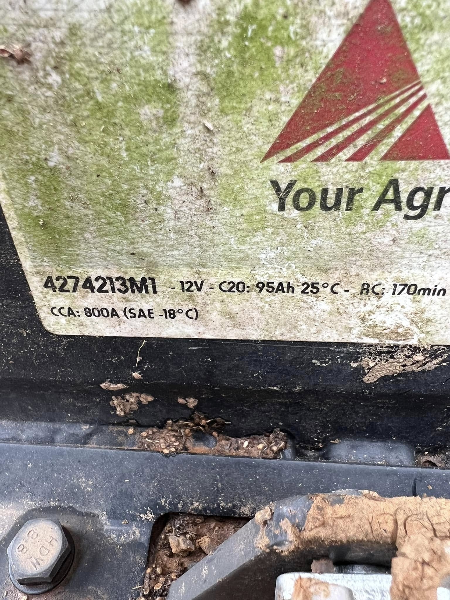

I just tried to start my tractor and the battery is dead. I ran it for over four hours a few days ago, and really expected it to fire up.
Volt meter read ten point six five volts on the terminals. I didn’t disconnect anything.
For some reason when I use numbers, it changes to something weird
This is a new battery? 10.6 typically means a cell has died inside. but based on your comments of needing to charge it out of the gate, I have some concerns there might be a parasitic load dropping it. do you have a dc clamp on meter, or a meter with a amp rating?
your going to have to determine if the battery is bad or if you have some kind of draw on the unit. this is easy with a sg meter or you can measure with the individual cells, but I am bit reluctant to tell people how to do that

My suggestion is to charge it up right away and keep it charged until you use the tractor. Disconnect the battery after you use the tractor and then see if you can wait a few days before trying to start it. If it's dead again, you will know the battery is the problem. Do you have another car or truck you can try swapping batteries with? I'm having similar problems with my old truck. It can go more than a month or even two ,with no problem. Other times it might be dead after four or five days. Being lazy, I just put it on a maintainer when parked. One day I will look for a parasitic draw but assume it's intermittent. I'm only using it to carry my snowmobile about once a week.
The battery from my truck must have had a dead cell (10.6v) too and charging it had the numbers all over the place. I had a spare red top optima that has been in the truck for a few years now while I wait to get a replacement. Unhook the battery and charge it to 12.8v + then let it sit for a couple days. It should hold voltage....if not, take it back.
Four hours is not long enough to fully charge a completely discharged battery.
But it's hard on the alternator to try doing it that way.
