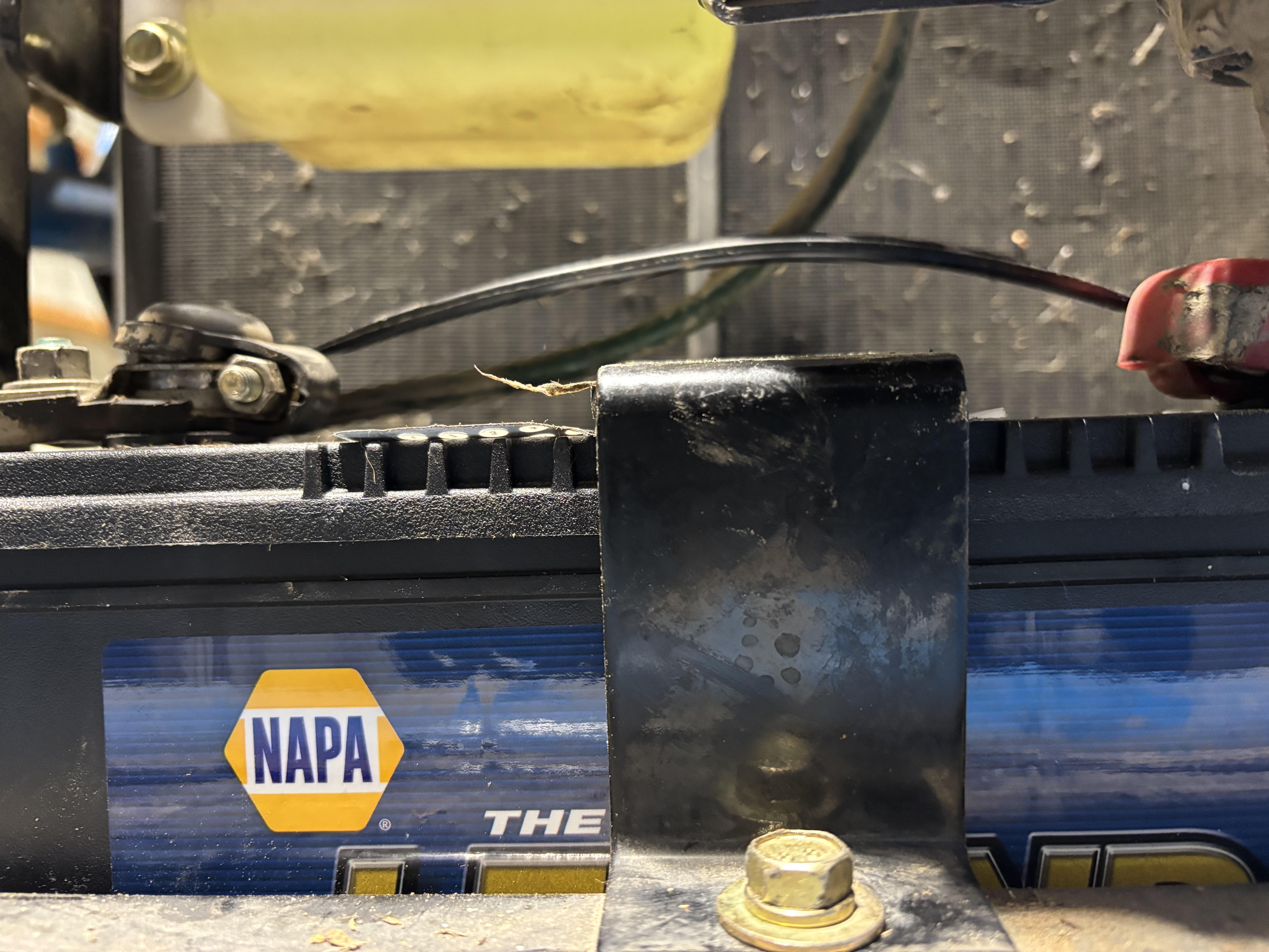

Thought I'd join the crowd. When doing PM, my CCA was down to 275. Used a Napa 7534R. Like a glove. Now changing the fuel filter didn't go as well....
