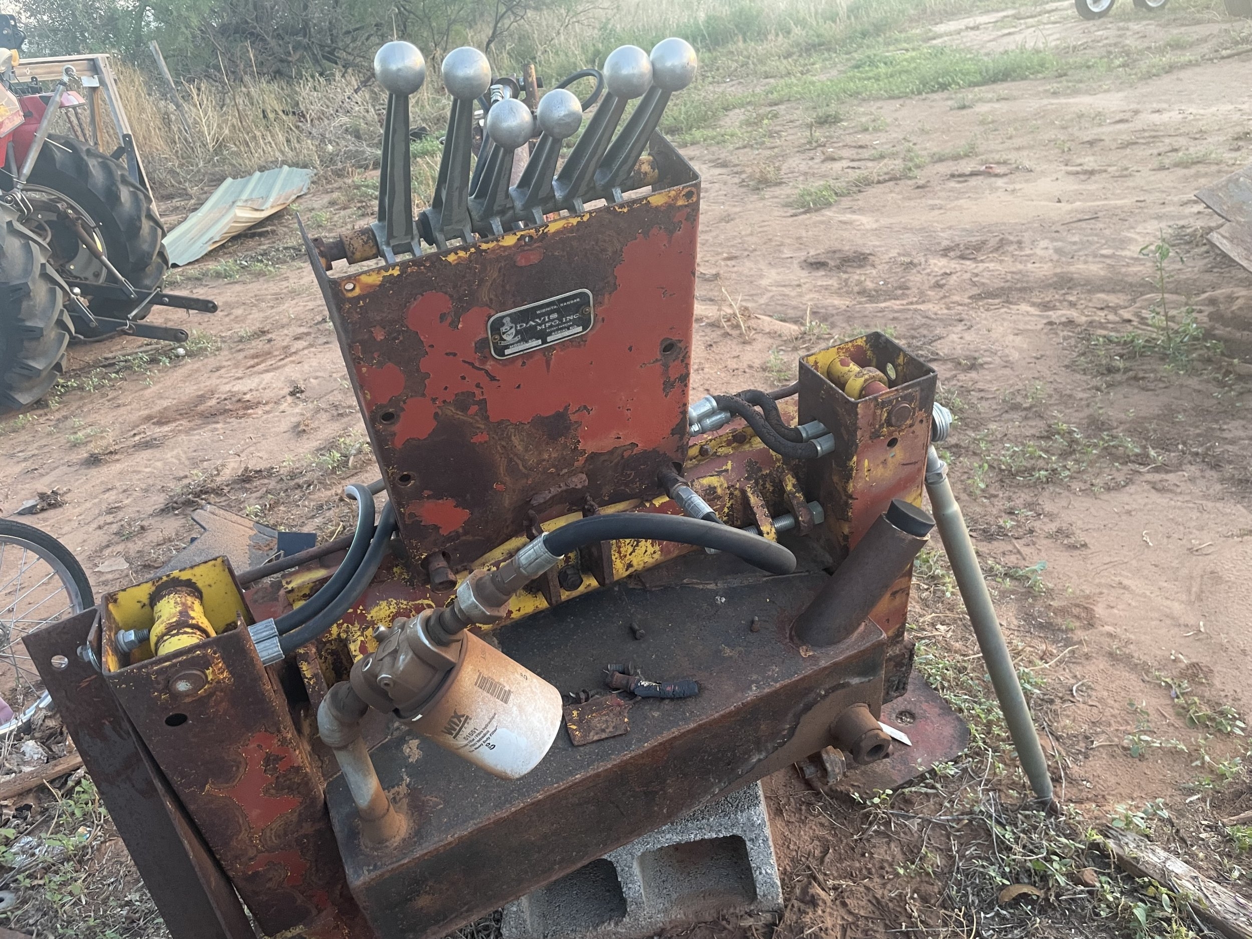

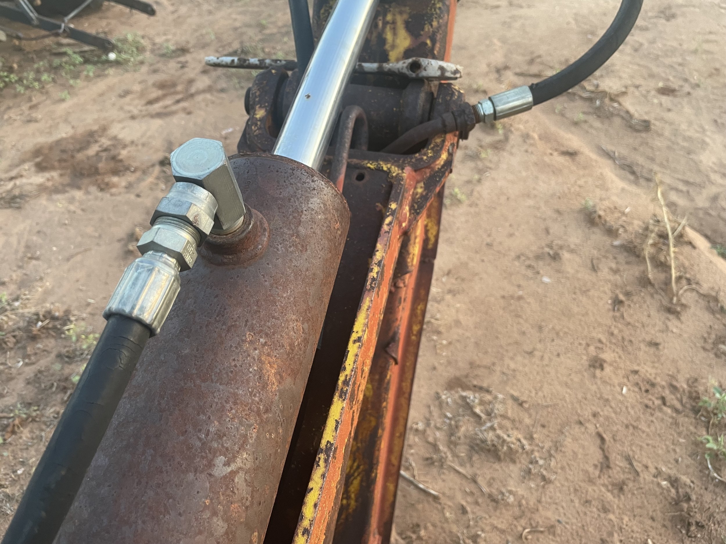

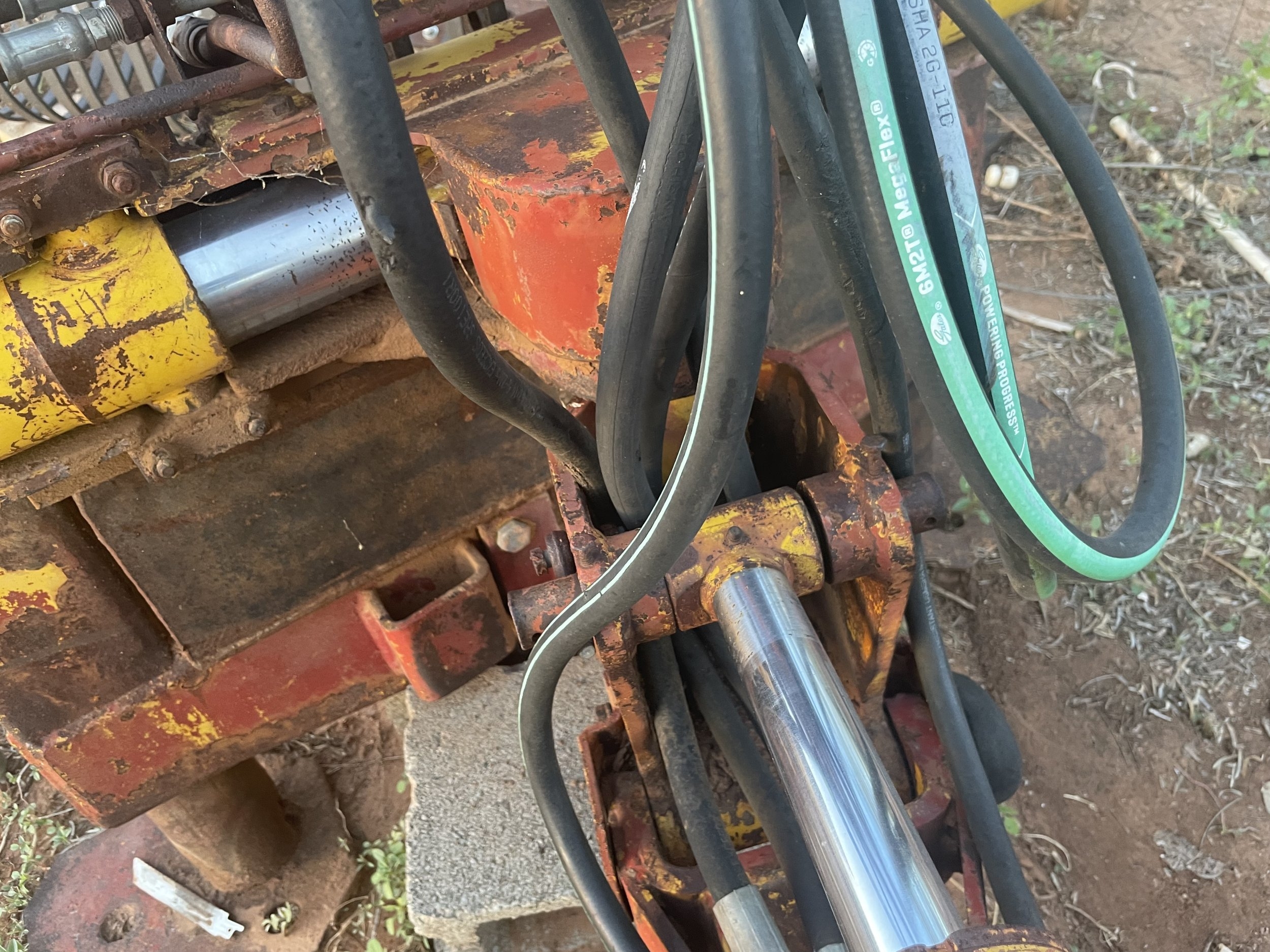

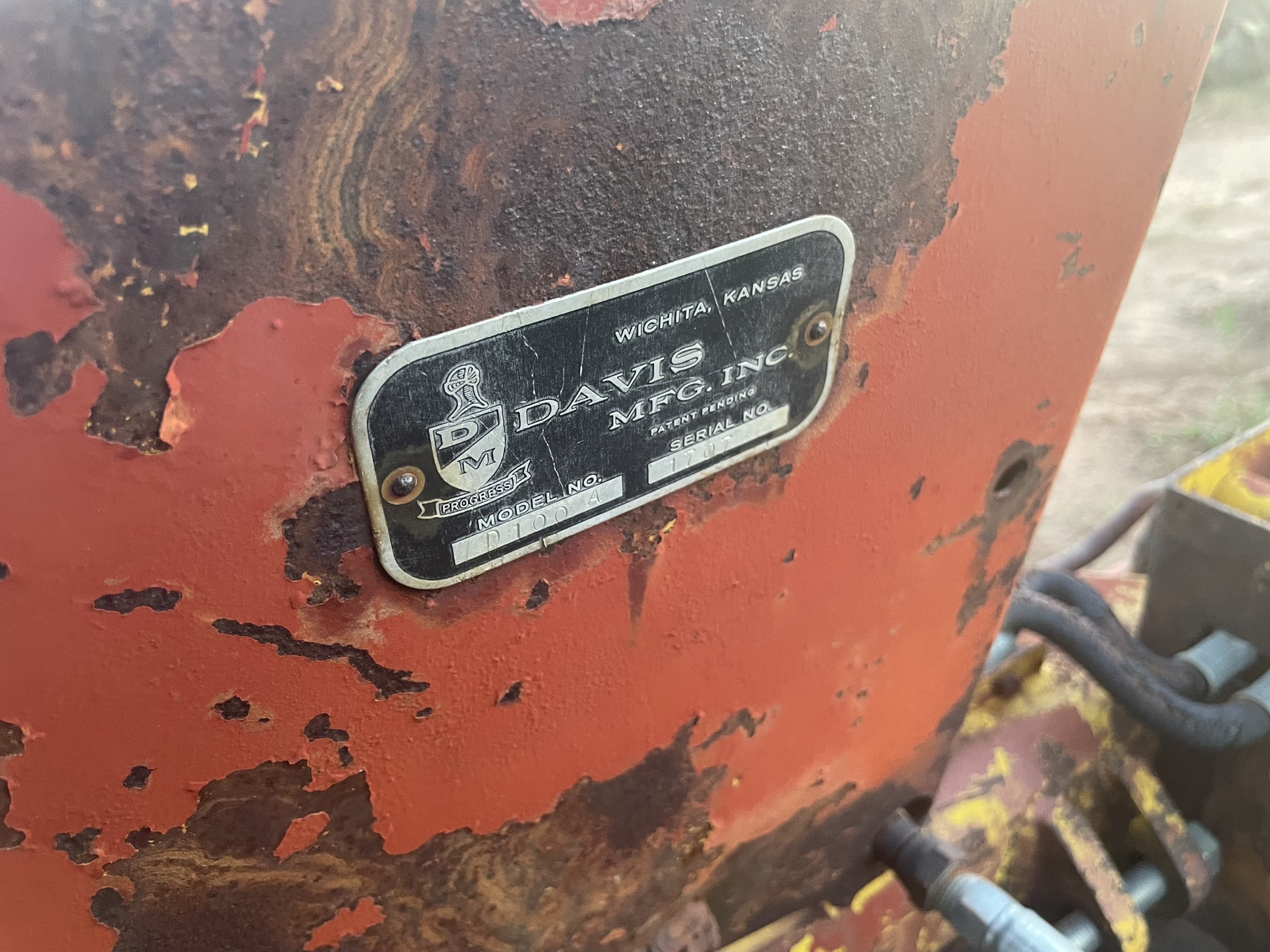

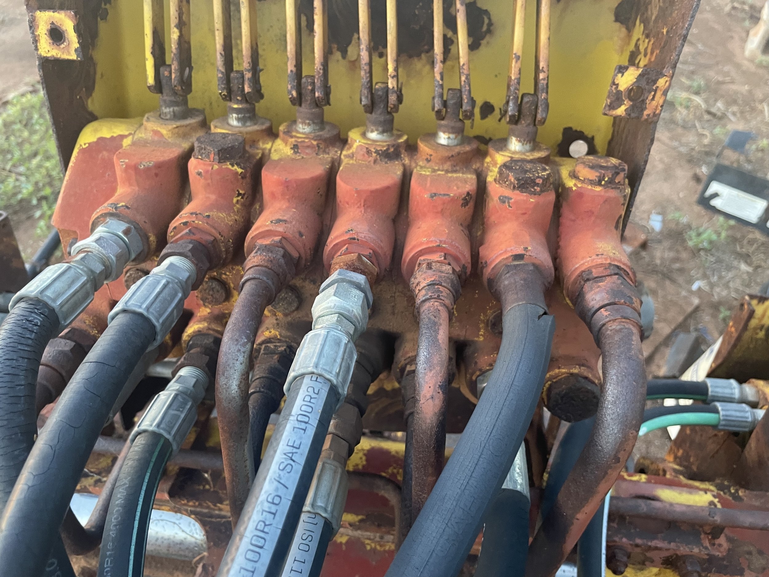

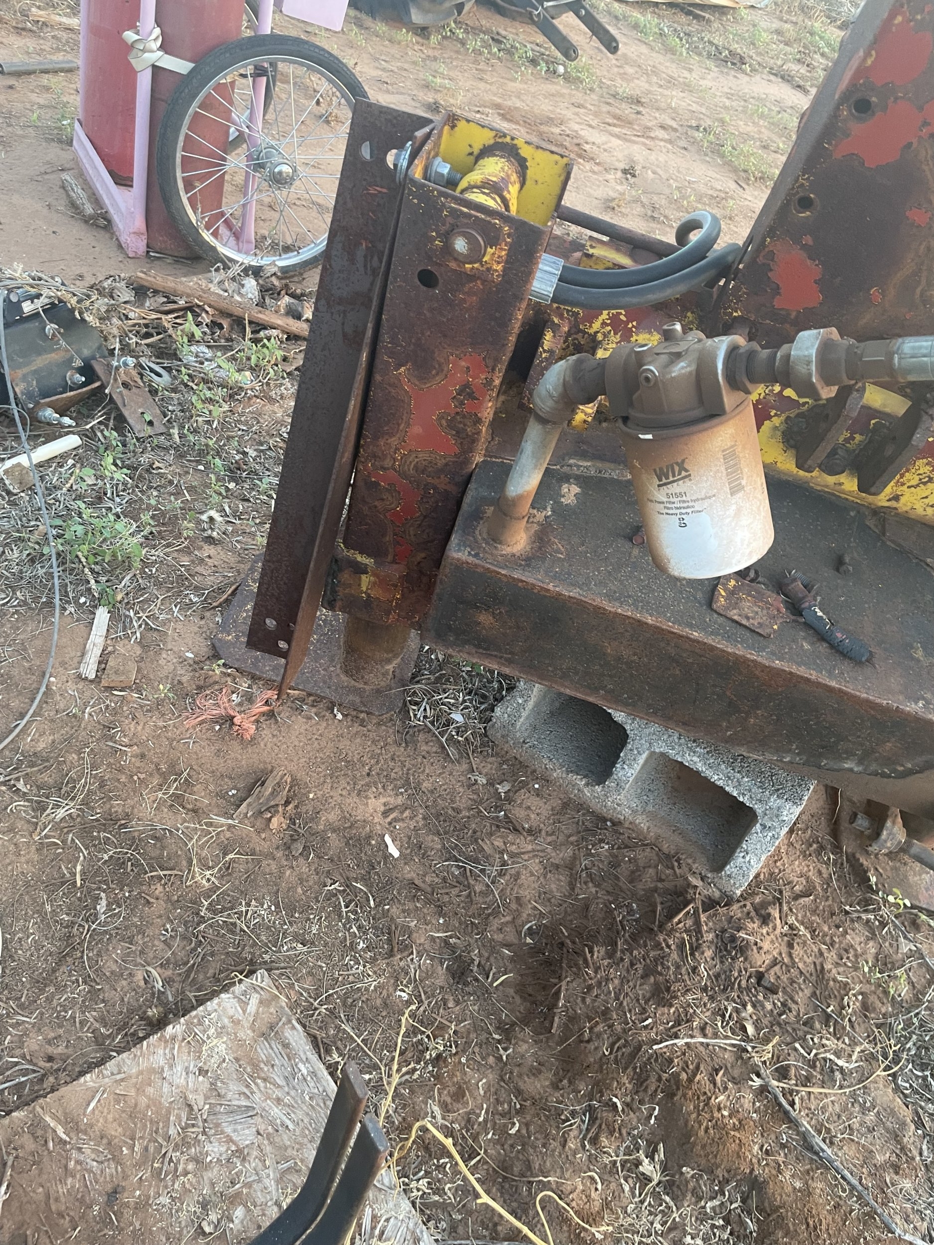

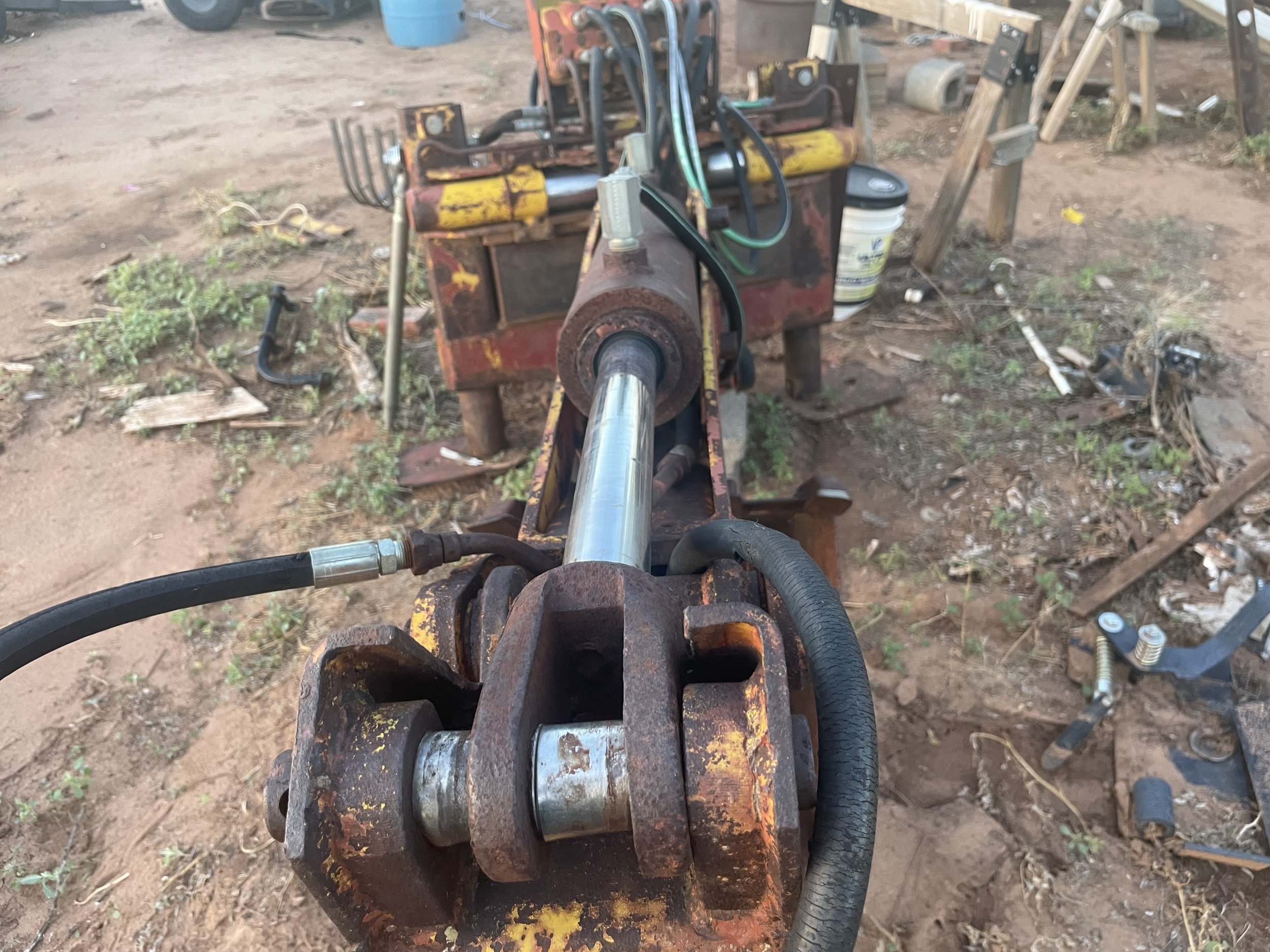

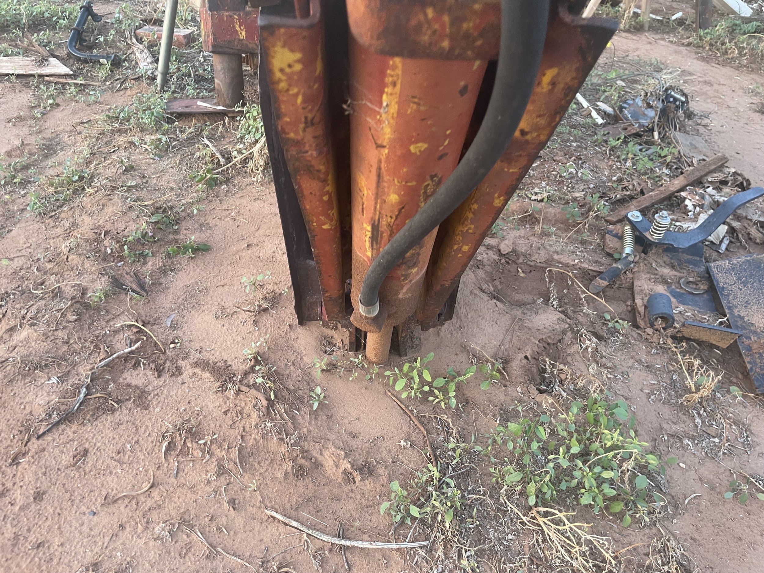

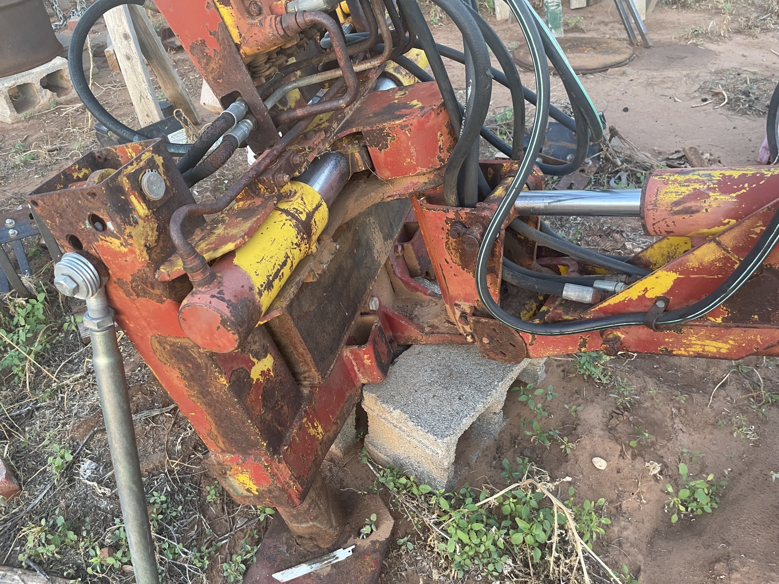

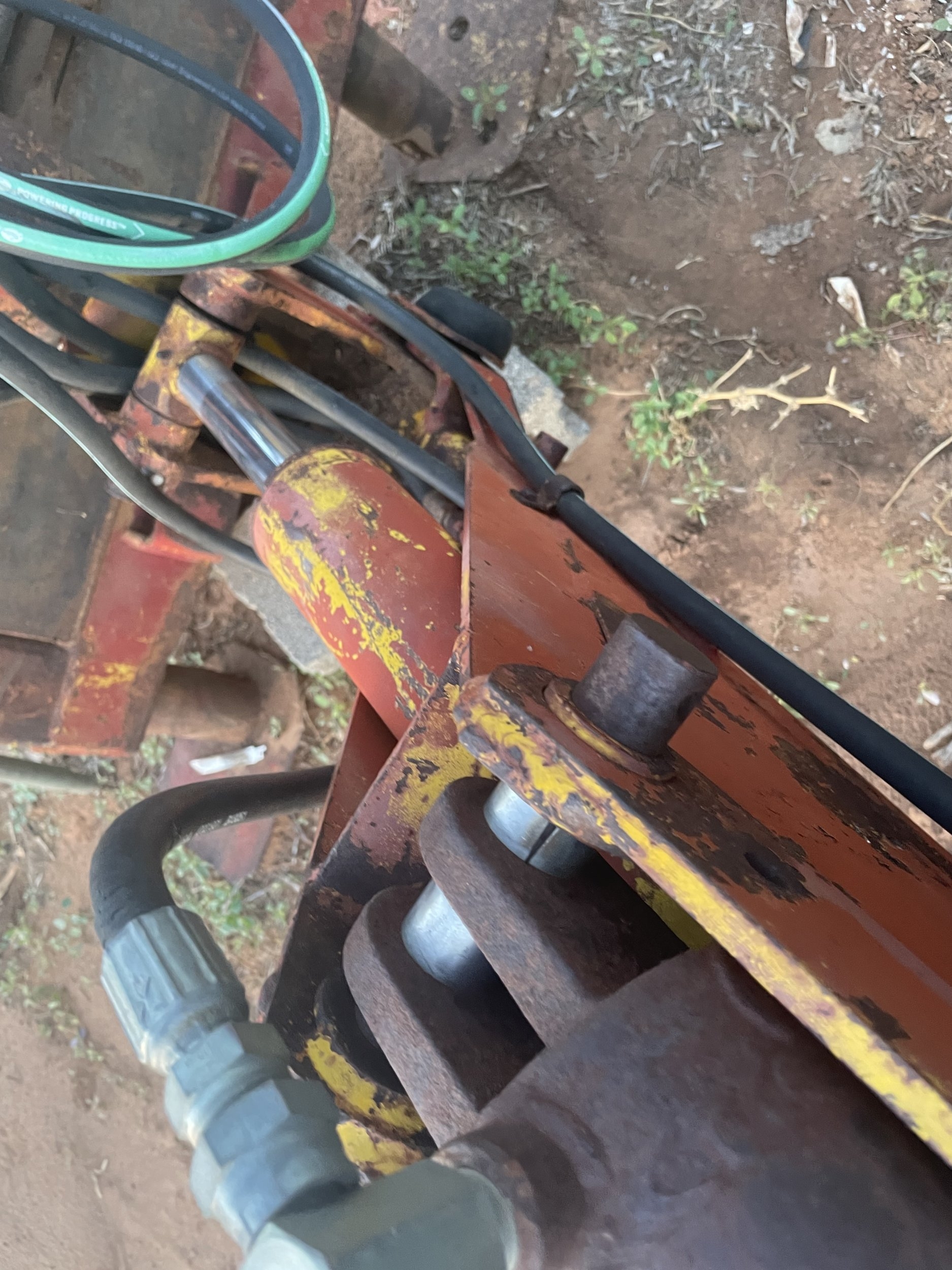

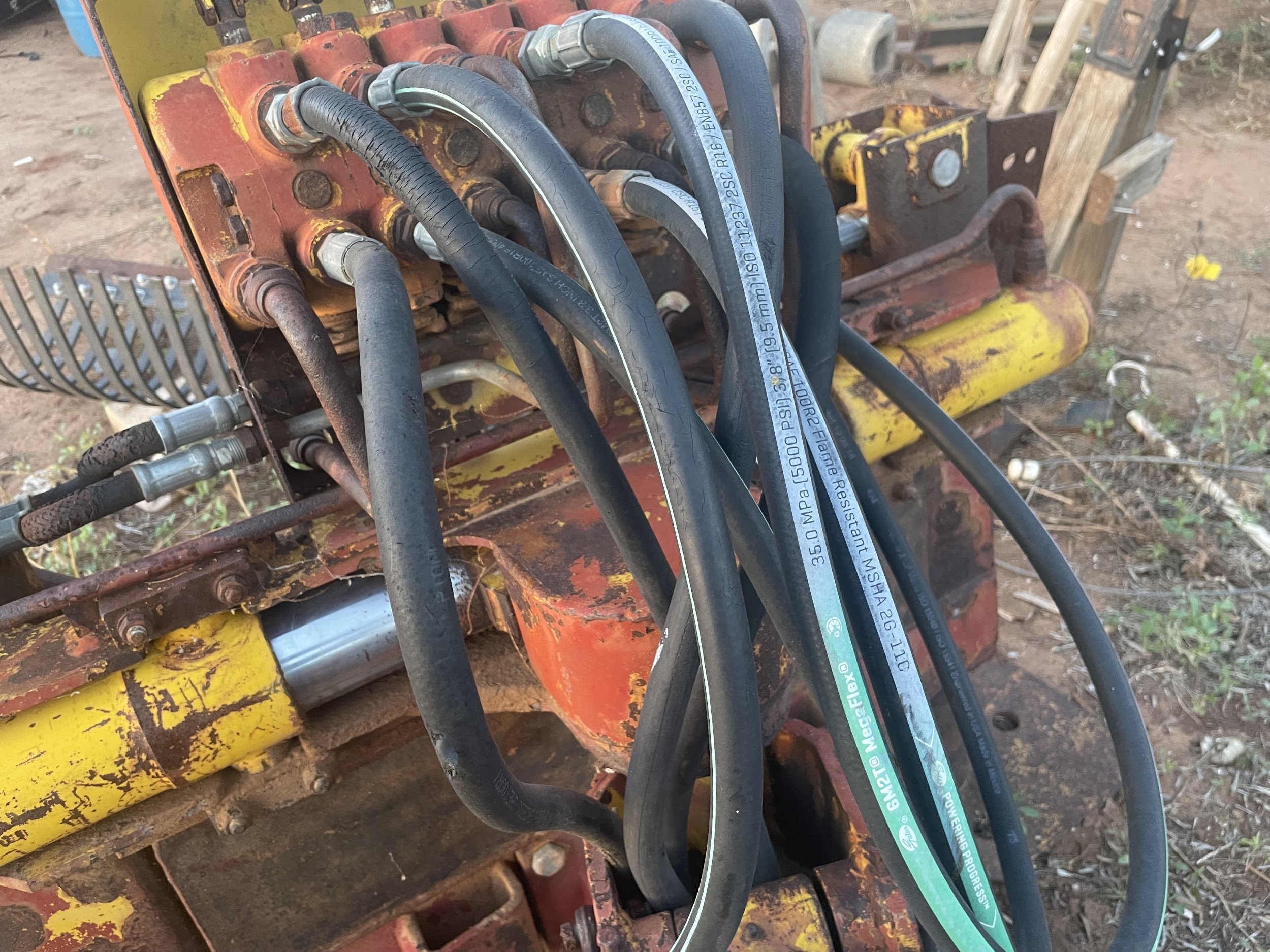

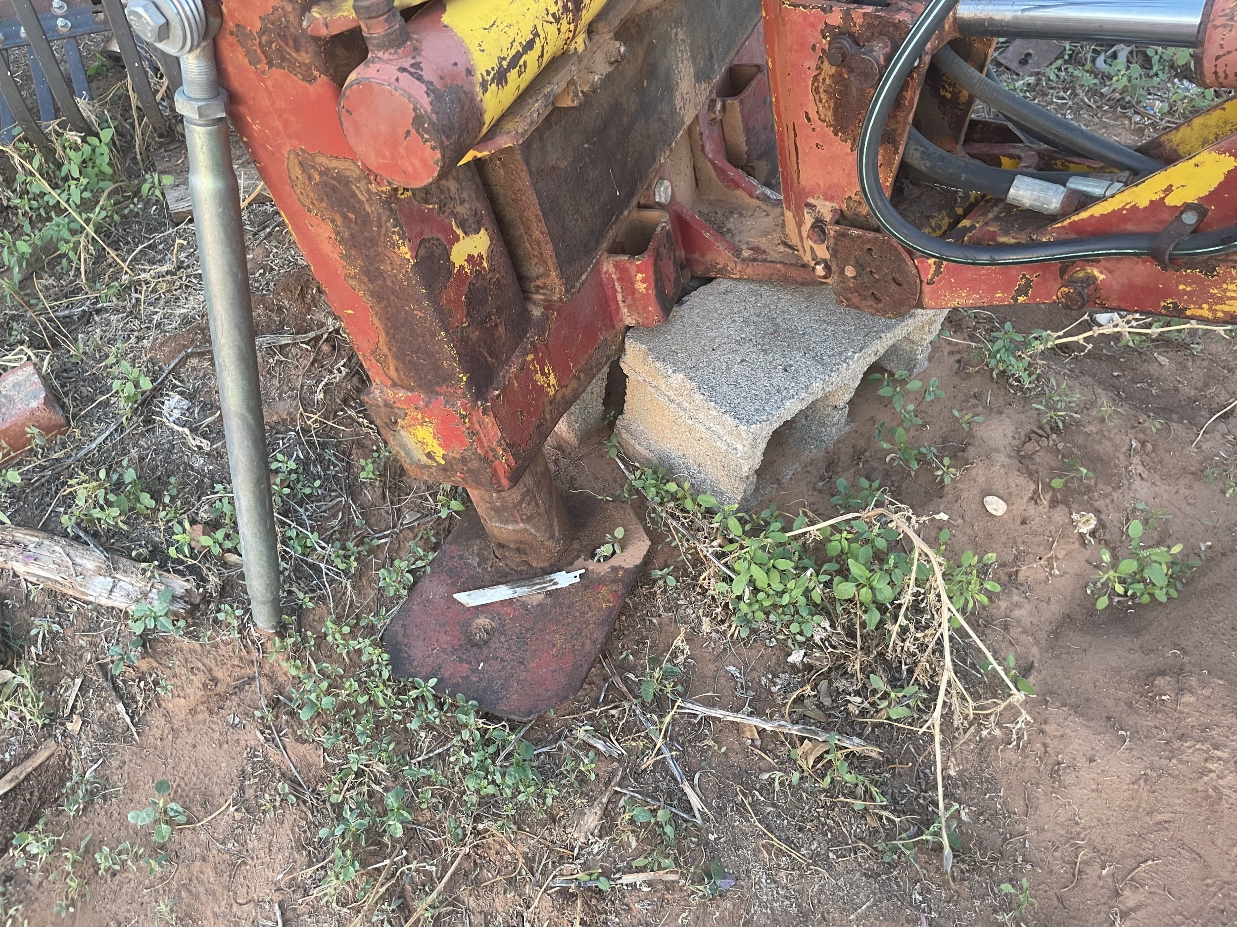

I have a Davis 100A but it is too heavy for my 2910i Branson , and for several years I read forums, etc. to come up with plans to set it on a trailer like a car hauler, the little backhoe only digs about 6’ to 8’ but it beats digging by hand when you’re 72 years old. backhoe has its own pump to attach to pto, I will try to upload some pictures.

More pictures of Davis 100a trencher/backhoe

I am looking at putting this on trailer so that stabilizers are lowered to ground and attach trencher to trailer , and attached to tractor to stabilize trailer. All ideas welcome.

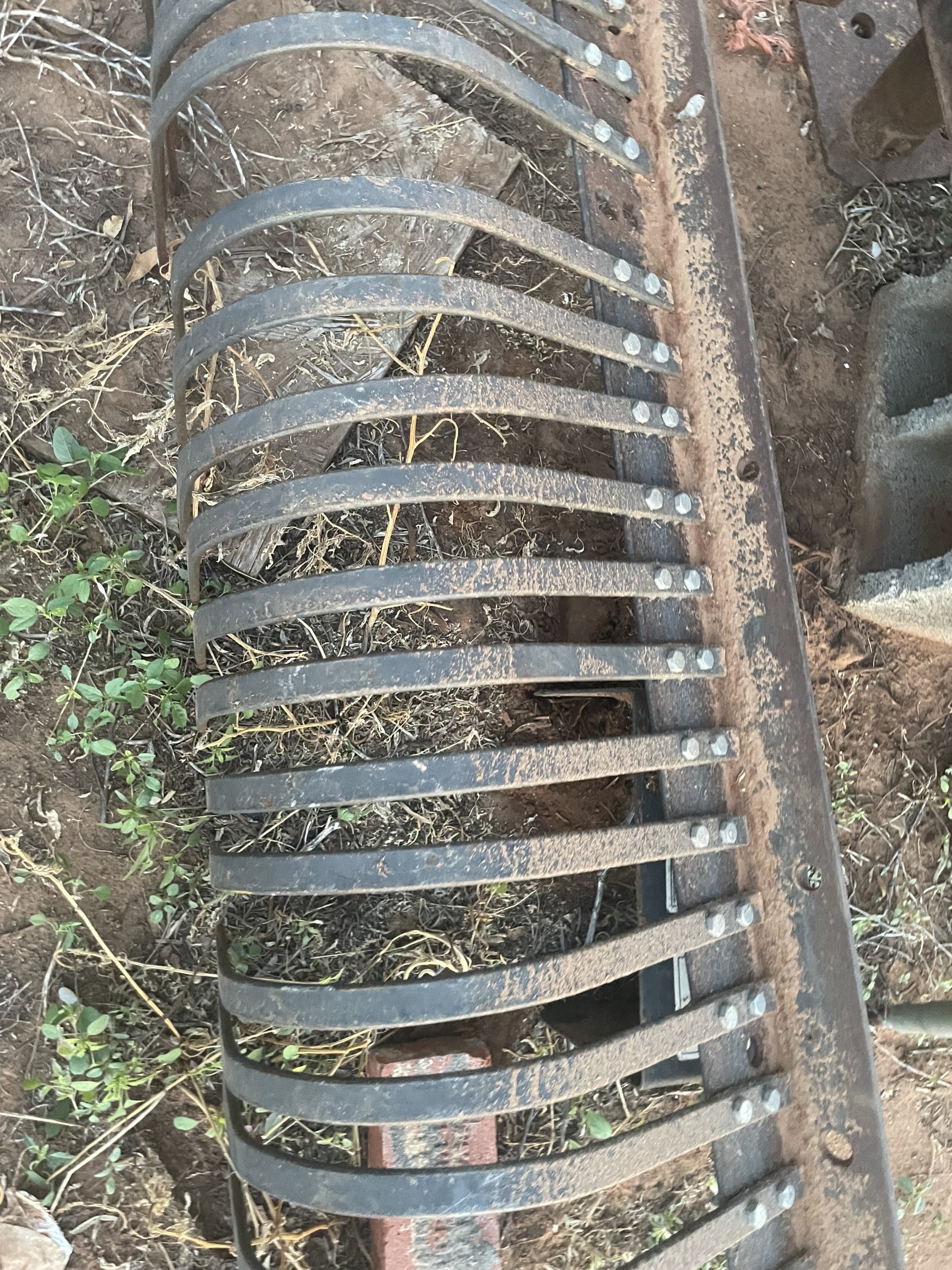

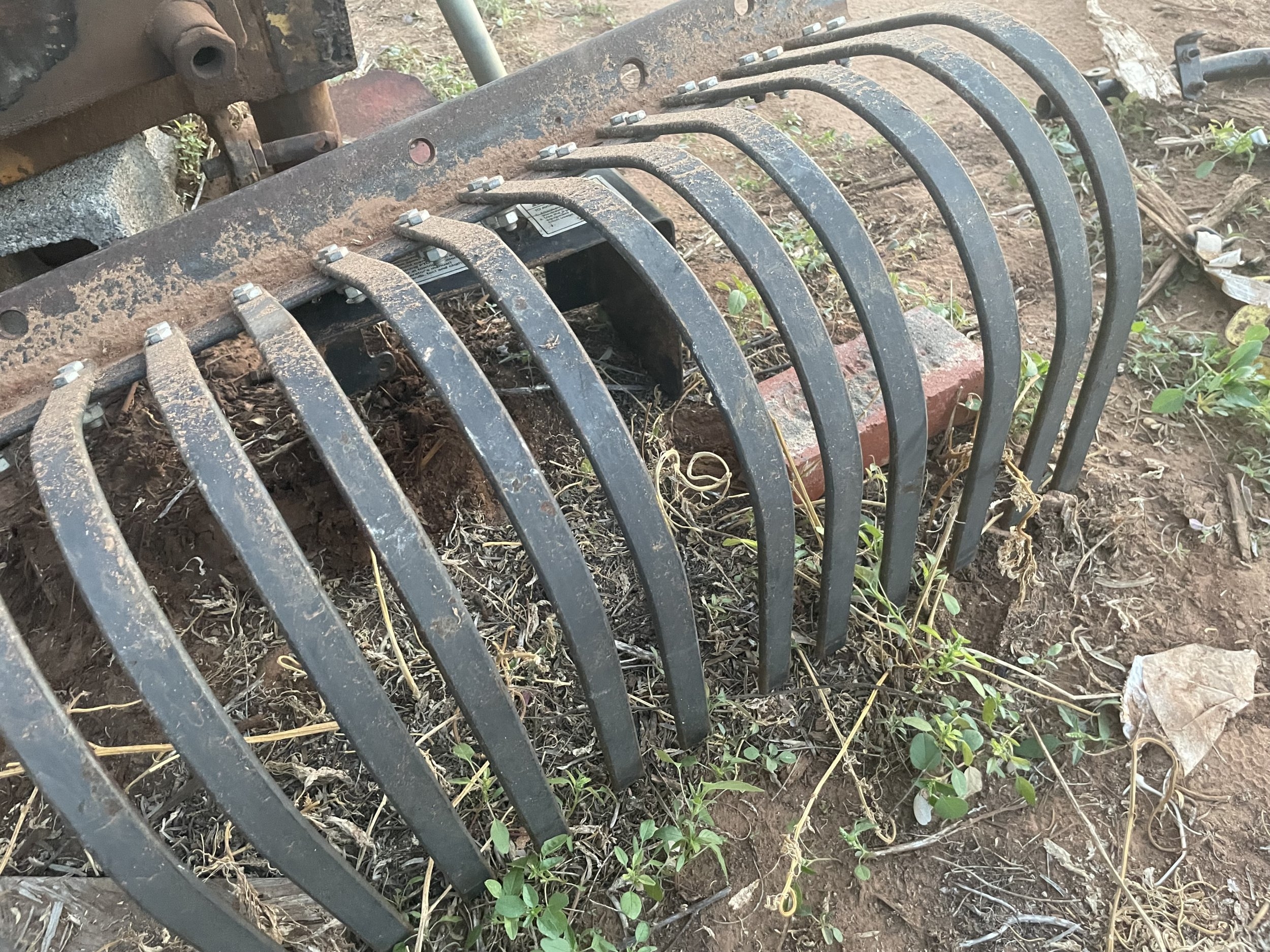

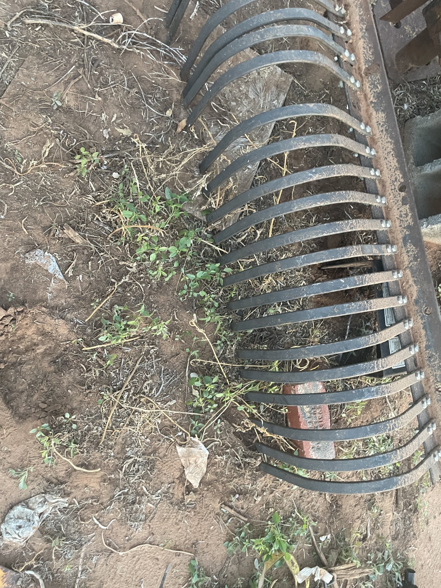

Oh I have loader with The Thumb by Green’s Machine, I. have moved a lot with this set up, it will pickup a single pice of tin. I am in process of making a landscape rake, I need a piece of 2” square tubing about 6’ long,to finish assembling .loading some pictures. I used 3”x4” and pretty thick angle Iron, 56” long -.21 -2 hole tines made with 5160 steel spaced 1” apart, bought 3 point tractor stabilizer/trailer hitch from eBay for $40, to put on bar , I bought tines for $ 2.50 each about 3 years ago, today they are $10.00 each. Will post pictures when complete. I hope it will function for what I need.Again all ideas welcome.
