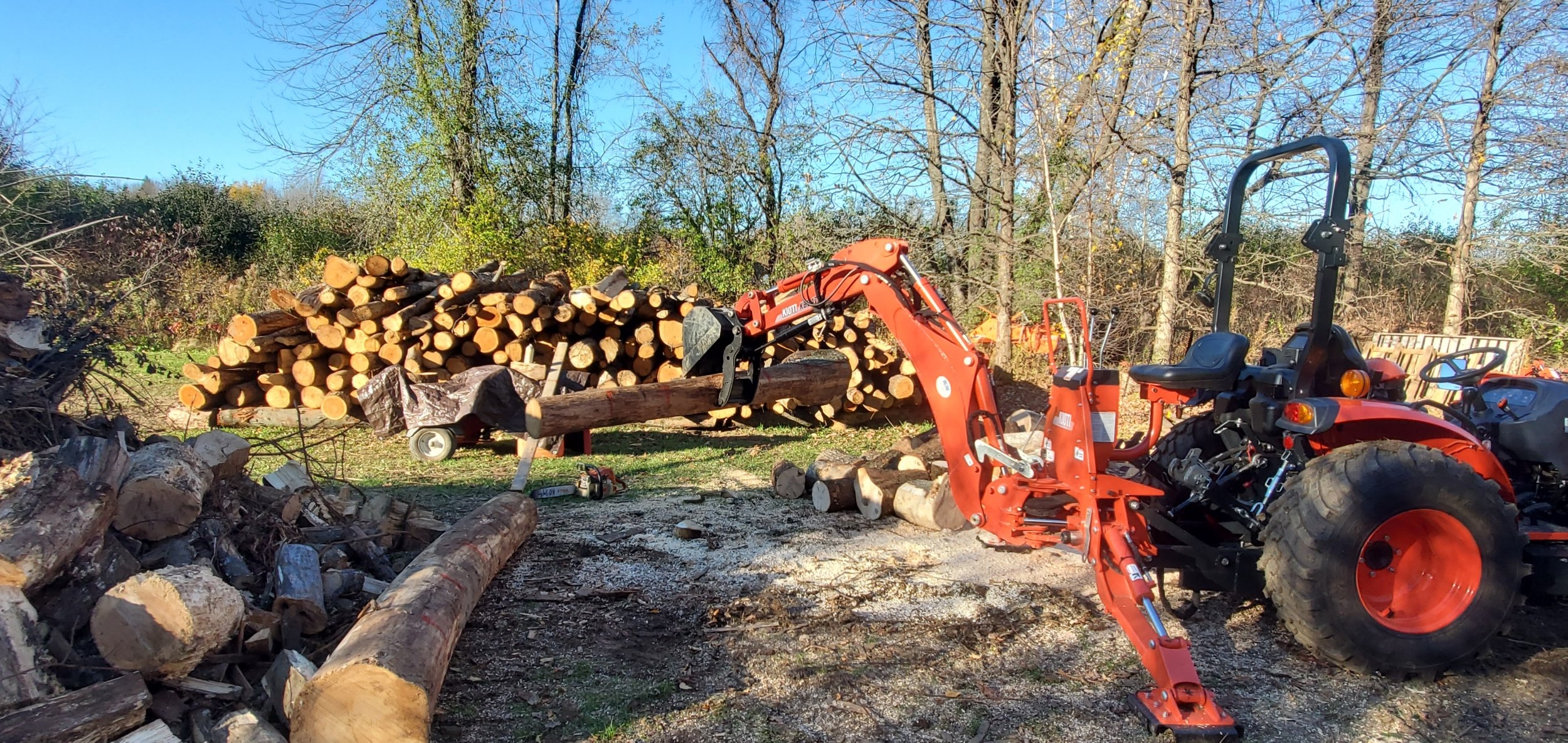

I have just under 6 acres, gravel driveways, mature woods, etc. I have a 30HP Kioti CK30 with a backhoe etc. The tractor is a champ, I am amazed at the trees I can lift and drag with it. If I can't,then I can after using a good quality chainsaw! I did clear a bit of land a few years ago for a garden, but just hired in a crew to push the trees down, that is a job for a large loader, nothing I will own for my property. While I did have some trenching projects that more than paid for the backhoe in the past (french drains all around the house down to a pond we have, plus ran water and conduit for power out away from the house, most of the time (years at a time) the backhoe just sits. Renting a dedicated unit may well make more sense most of the time. What I use most is my bucket, box blade, rake, but one of the most used are just chains to pull logs and pull out small trees. I did pick up a tiller, but have yet to mount it (I need to cut it's driveshaft this week) for the garden I cleared, and I have an auger to put up fence poles. If I were to get a different piece of gear instead of the tractor, it would probably be something more like a Bobcat, as it has most of the same implements available. WIth having trees get something that will get through your property. My tractor "fits" what I have. I do have a pond and at some time in the future I will need to muck it out. That will also be a job to rent something far bigger than I would want to own, some sort of extension bucket or large excavator that can reach in far enough (I don't want to breach my damn to clean it). A tractor day to day is the best tool for me. Some implements are available for rent, and that is the best approach for many odd jobs that come up rarely, or until I need them more regularly (like the tiller).

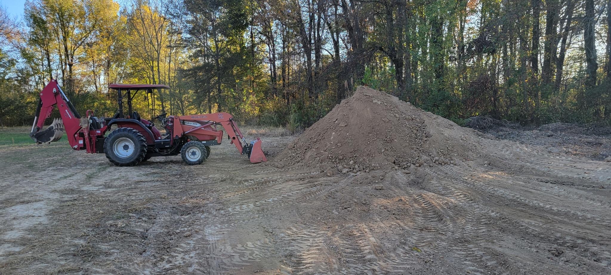

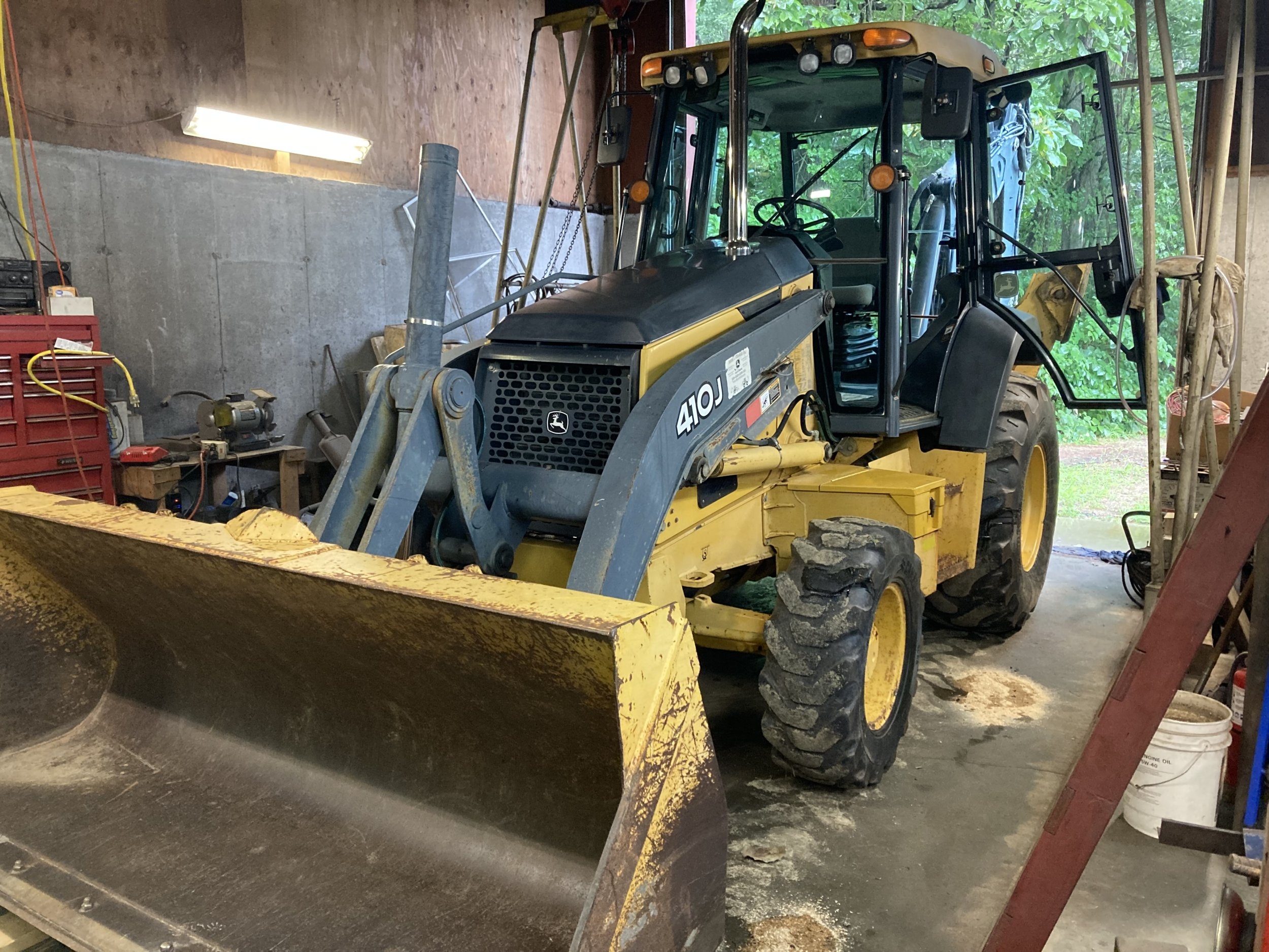

On our farm, we have a bunch of tractors and equipment to do all the things and chores that need to be done. From digging holes and trenches, to handling material (we have a small screening plant to make screened loam), to just whatever. The best thing we have for digging holes and trenches is our mini excavator, but the problem with that is it takes forever for the mini to get to the further reaches of the farm. If you're just digging one hole or pulling one stump, that's a lot of wasted time crawling along. The only other thing we have with a hoe on it is our 1953 Ford Jubilee. While we still use it occasionally and it does the job, the hoe is slow and a little on the weak side.
So that left me with a decision: do I buy a tractor large enough to have a capable loader and backhoe attachment...or just buy a yellow backhoe and be done with it?
I ended up buying a 2007 John Deere 410J with relatively low hours. Its loader outclasses even the upgraded loader on my MF 4707, and the backhoe is a beast. Plus, I get a nice cab with heat and A/C and don't have to climb out of the tractor to use the backhoe, I just swivel around and go to work.
One option I looked hard at was the Kubota M62. The downsides to that were:
A. You almost have to buy new because there aren't many used ones for sale and they are all going for nearly what a new model goes for.
B. No cab.
C. The loader on the M62 is only slightly more capable than the loader on my 4707. I didn't want to spend big bucks to only "slightly" improve on the loader.

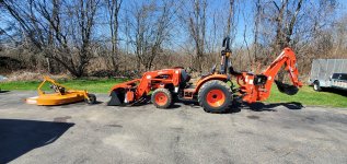

I have a similar scenario (except for snow). I got a BX23…with FEL and BH. Also got an underbelly 60” mower and 4’ Tiller.
I have been pleased with the FEL and BH. However, the “chore” of removing the BH to use the mower, not to mention me putting the mower on successfully, resulted in my selling the mower. It was really time consuming and difficult. I am sure I would have gotten faster, but I felt that as I got older, it would be more challenging. And to have a tractor sitting there with the mower attached, and not wanting to take the mower off (and really the FEL) to put the BH on would really undermine the usefulness of the TLB. So I got rid of the mower while it was still practically new.
But I am about to do the same thing with the tiller also for the same reason. And I am ok with just having a TLB. The tractor is useful and works well for lots of jobs…planting trees, moving mulch, digging ditches, etc.

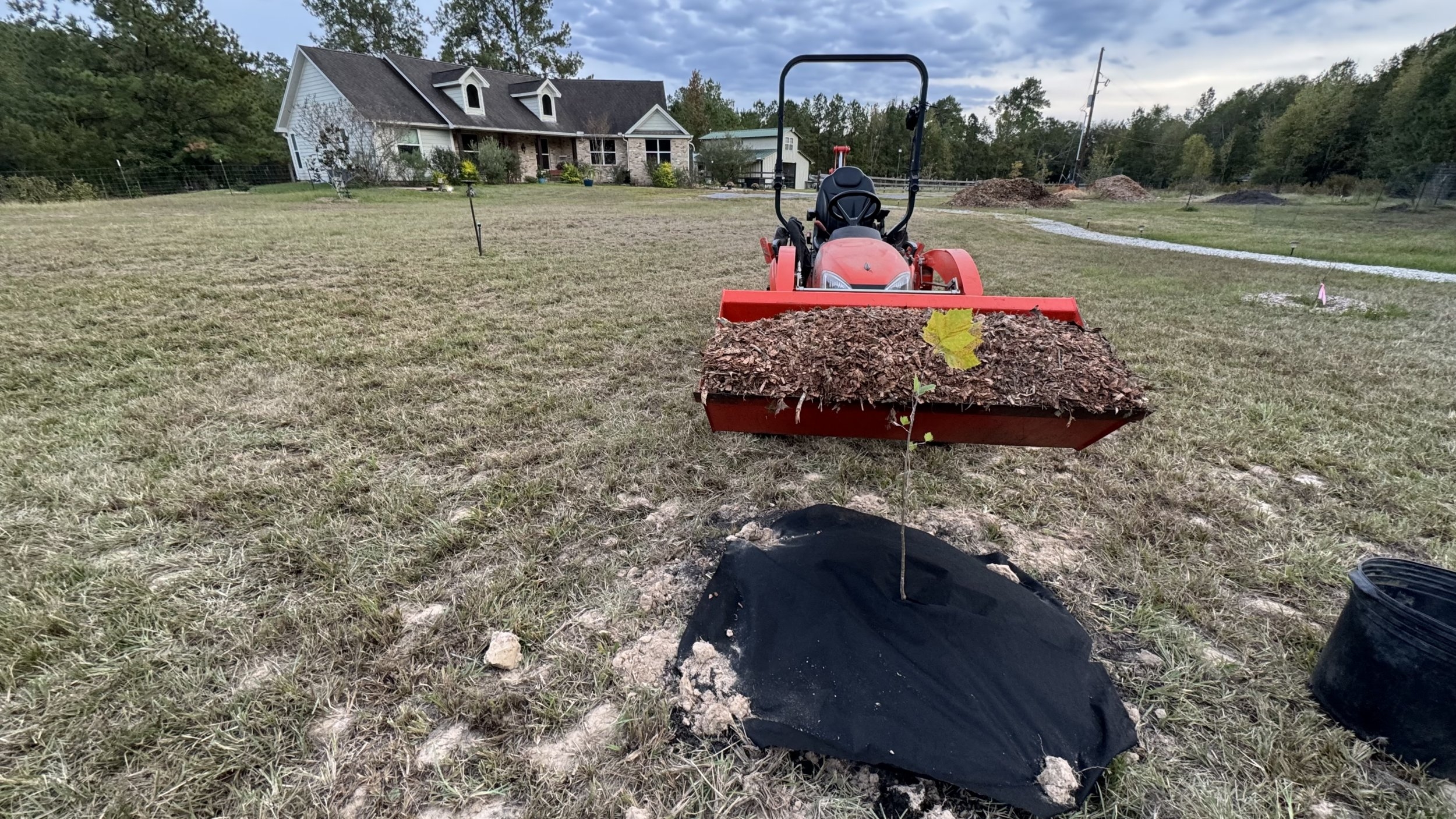

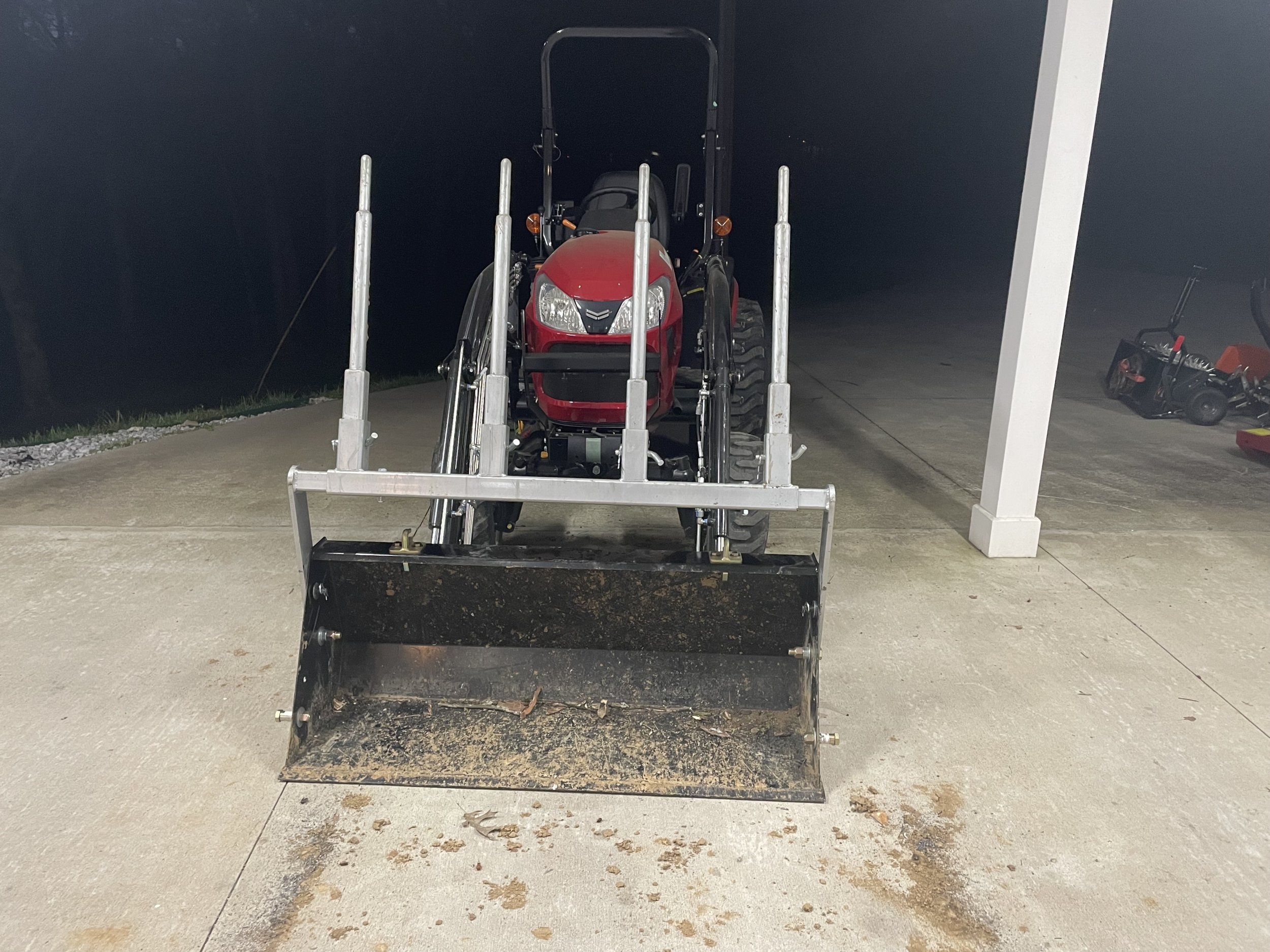

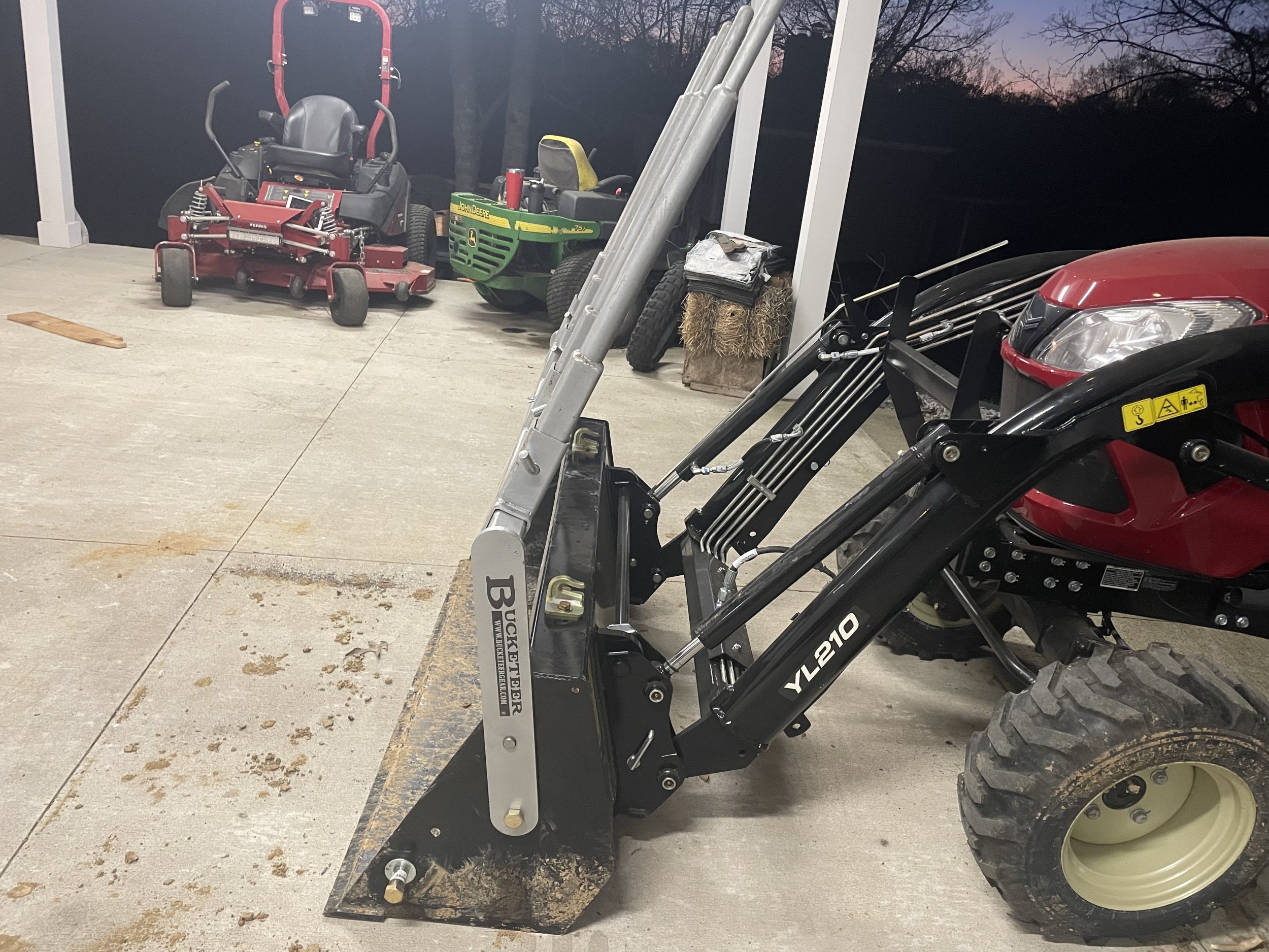

Friend advised me "I own a 200 acres and wouldn't buy one...rent it the handful of times you need one...way better to get other attachments you will use"...he was 100% right. They're 30%+ cost of most compact tractors and I might/could have used it a few times, but not anything I regularly need and a PIA to R&R.
My 2 cents...save your money...I have 15 acres of woods and it's not necessary for me. I would add pallet forks or a "Bucketeer" (I have a Bucketeer) as a "poor man's grapple"...most useful attachment I have. Way cheaper than a real grapple and easier to switch to...no third function, etc...with 6 acres? Unless you're digging trenches for the next decade likely not a good investment.
