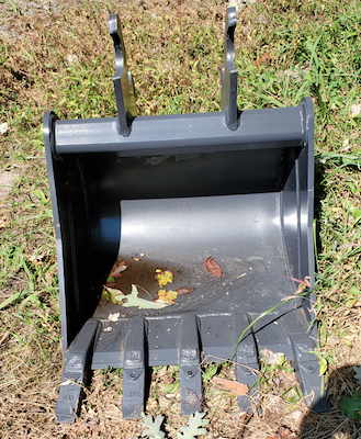

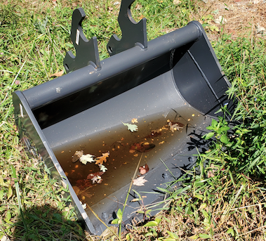

A full-size backhoe is probably going to beat the 5 ton mini at that job for the simple reason the bucket is twice if not 3 times as big. It’s hard to overcome that loss. If you put something more comparable in its weight class like a 80 or 120 hoe the excavator will win. The 5 ton mini vs a M59 and the mini will do the job twice as fast. Here’s my full size Deere backhoe buckets vs my KX40 bucket. I have a 3 foot bucket for the mini that’s not pictured but you can see how much deeper the backhoe bucket is.
/ Backhoe Vs. 12000 LB Mini EX #30
4570man,
Left to R in your post, based on tooth count looks like 12", 12" 24" ( that has been playing with wet concrete ), and a 30" ( the Deere ). Not a fair comparison if your comparing the 30" to the shallow 24". I cant find struck volume for the 30" Deere but my guess is 6 cubic feet.
I run KX series quick attach buckets on the the M59. Pic of 24" (L) with struck volume 3.9 cubic feet and 30" struck of 5.9 cubic feet. The 24" below looks much deeper than the 5 tooth bucket in your reply.
/ Backhoe Vs. 12000 LB Mini EX #32
4570man,
View attachment 762677 View attachment 762678
I have a 12” , 24” and 36” for both machines. The Deere 24” and the Kubota 36 is missing from the picture. I actually don’t have a Kubota 12” anymore. I sold it and bought a 18”. My Kubota buckets are the same depth as yours. The full-size backhoe buckets dwarfs them by that much. I mean it’s not surprising when you consider how much bigger the backhoe is. I don’t have the backhoe anymore either. I sold it and bought a full size excavator.
