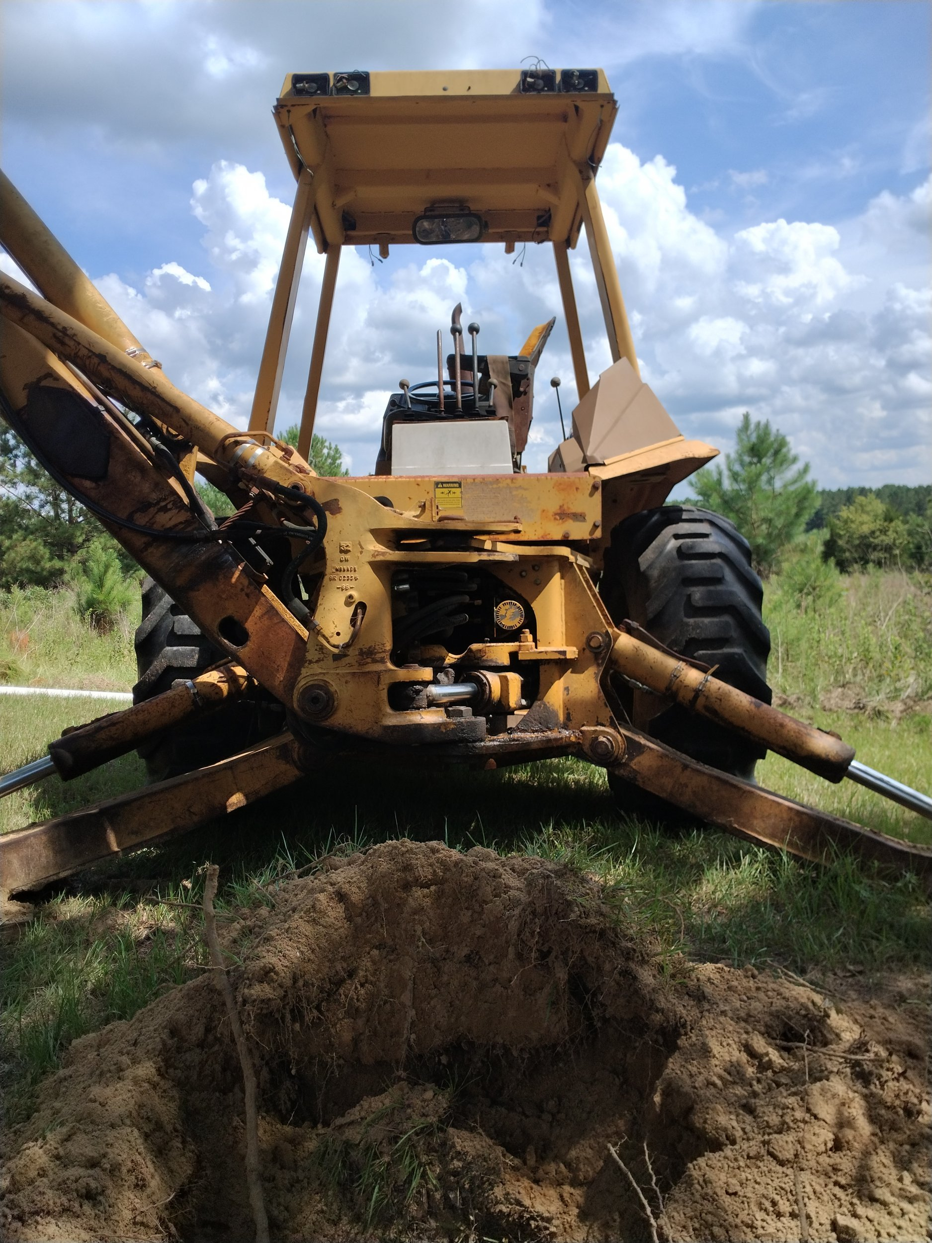

I'd go with the excavator and skid steer. I just finished a job with a back hoe they had. I consider it a dinosaur compared to what is out there today. Backhoes were fine when that was all that was out there. Just like big dozers, a trackhoe and a skid steer will clear land. Plus you can pick up and drop stumps to get the dirt off so they'll burn easy. Dig a pit to burn them in. I just don't see any need for backhoes and dozers, unless you just want one.
