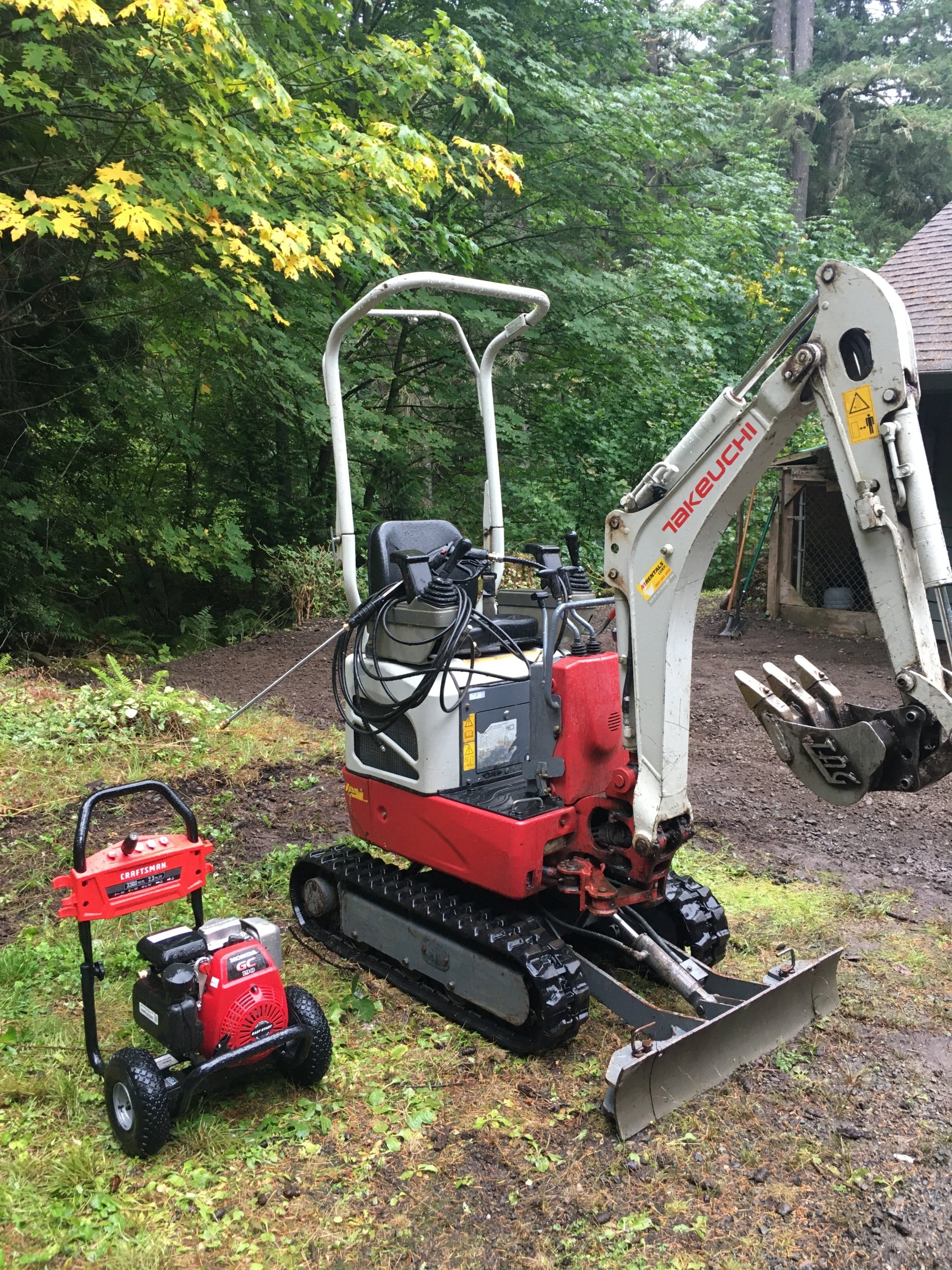

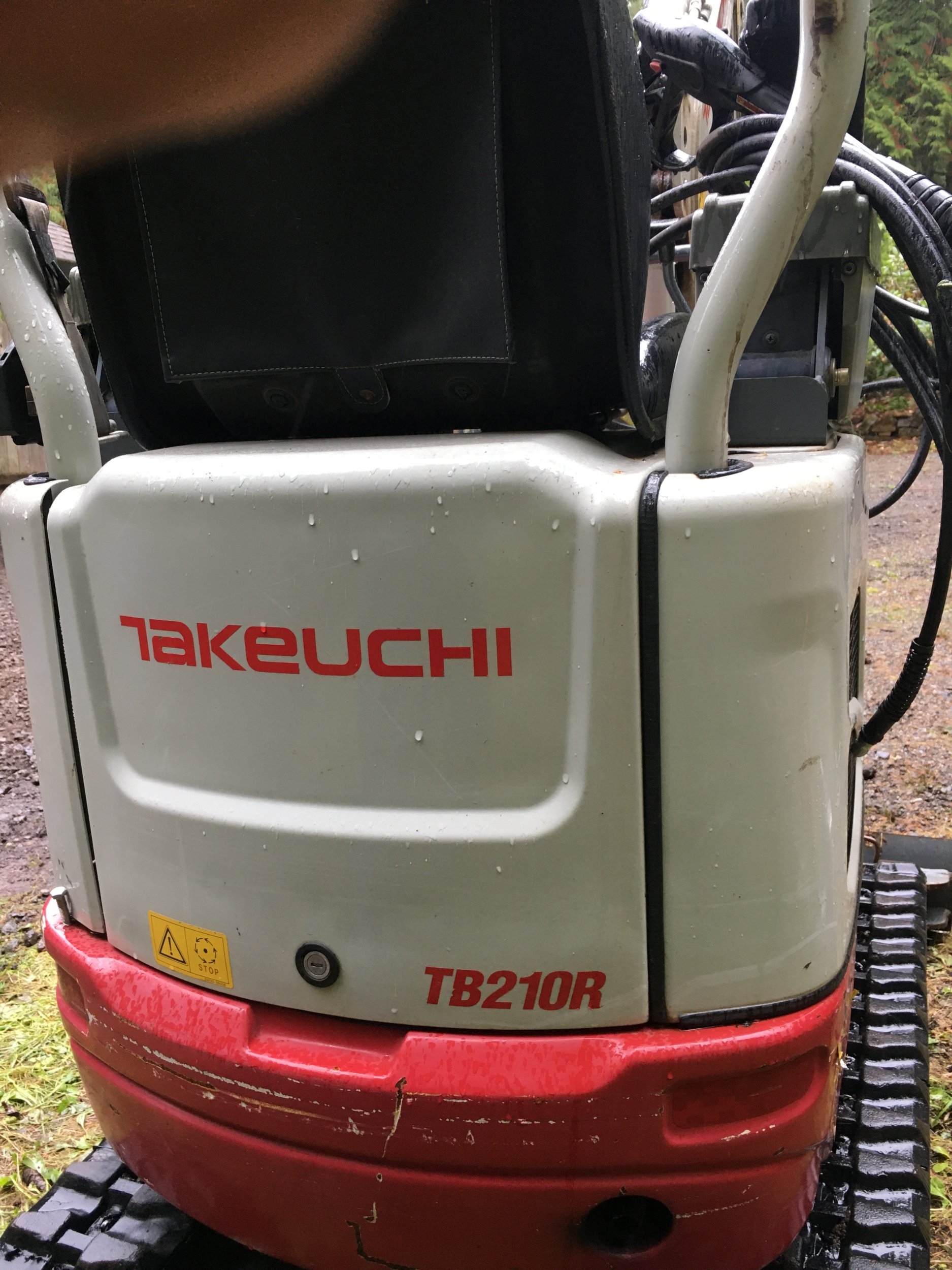

I have a BH77 on my L3700SU. .. It beats the shovel.. I has a older 6K hour KX121 that ran and worked well, But sold it .. I missed having a MiniX and bought a new E35 Bobcat. It's nice but not as strong as the 121 was. A mini is much much faster at digging anything than a backhoe. You will find all kinds of things to do with it once you have one.
