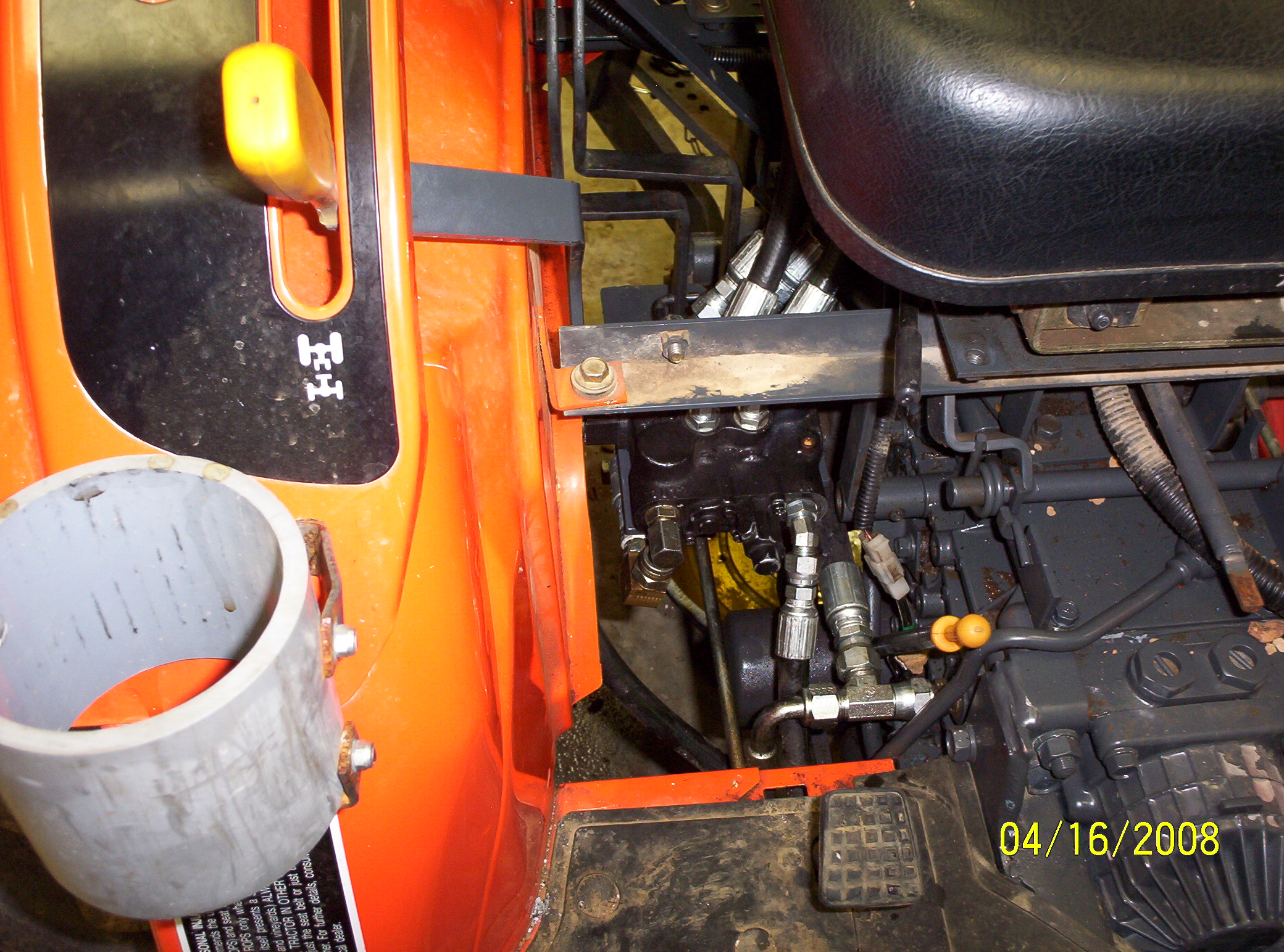

I've been looking high and low and can't seem to find a way to put a 2 or 3 spool rear hydraulic set-up on my 7800. My dealer says only a one spool set-up is available. I'd like to do it as "factory installed" as is possible. Can anyone offer some suggestions?

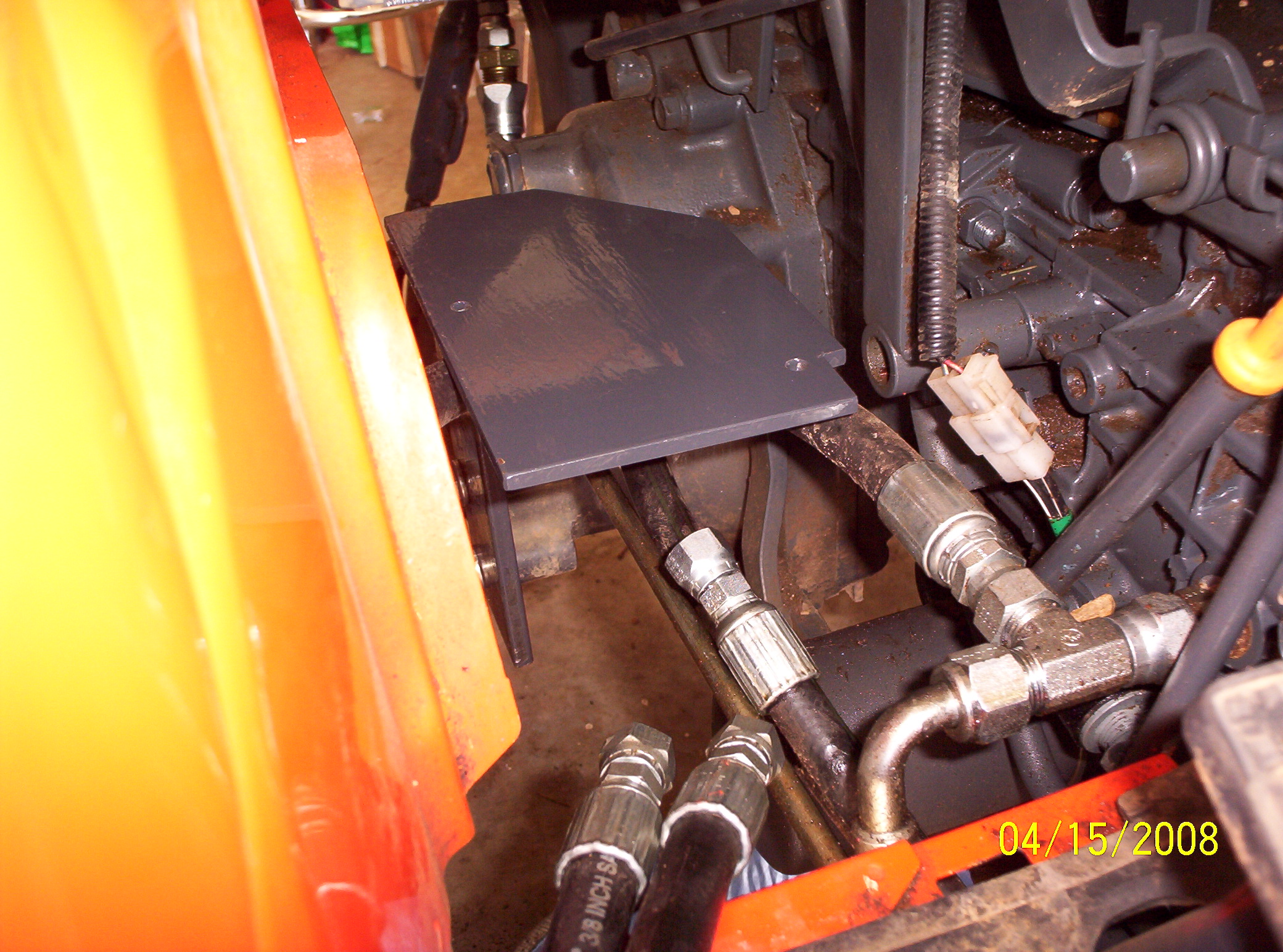

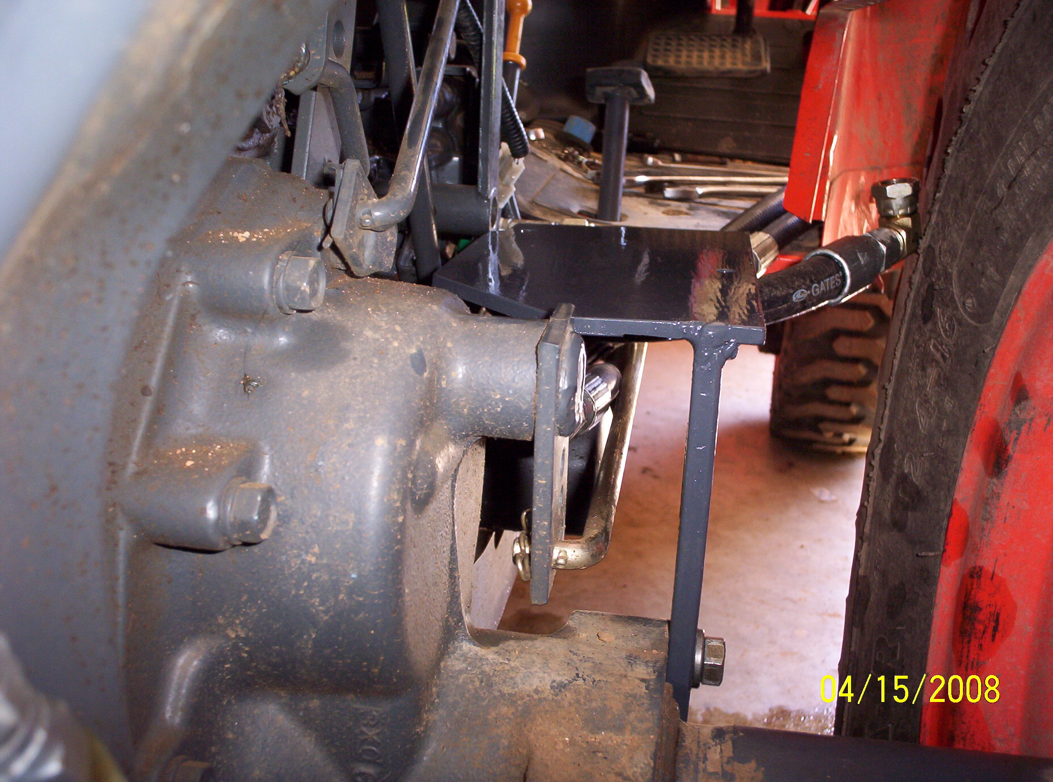

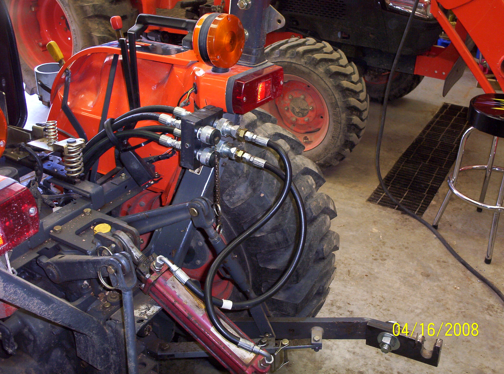

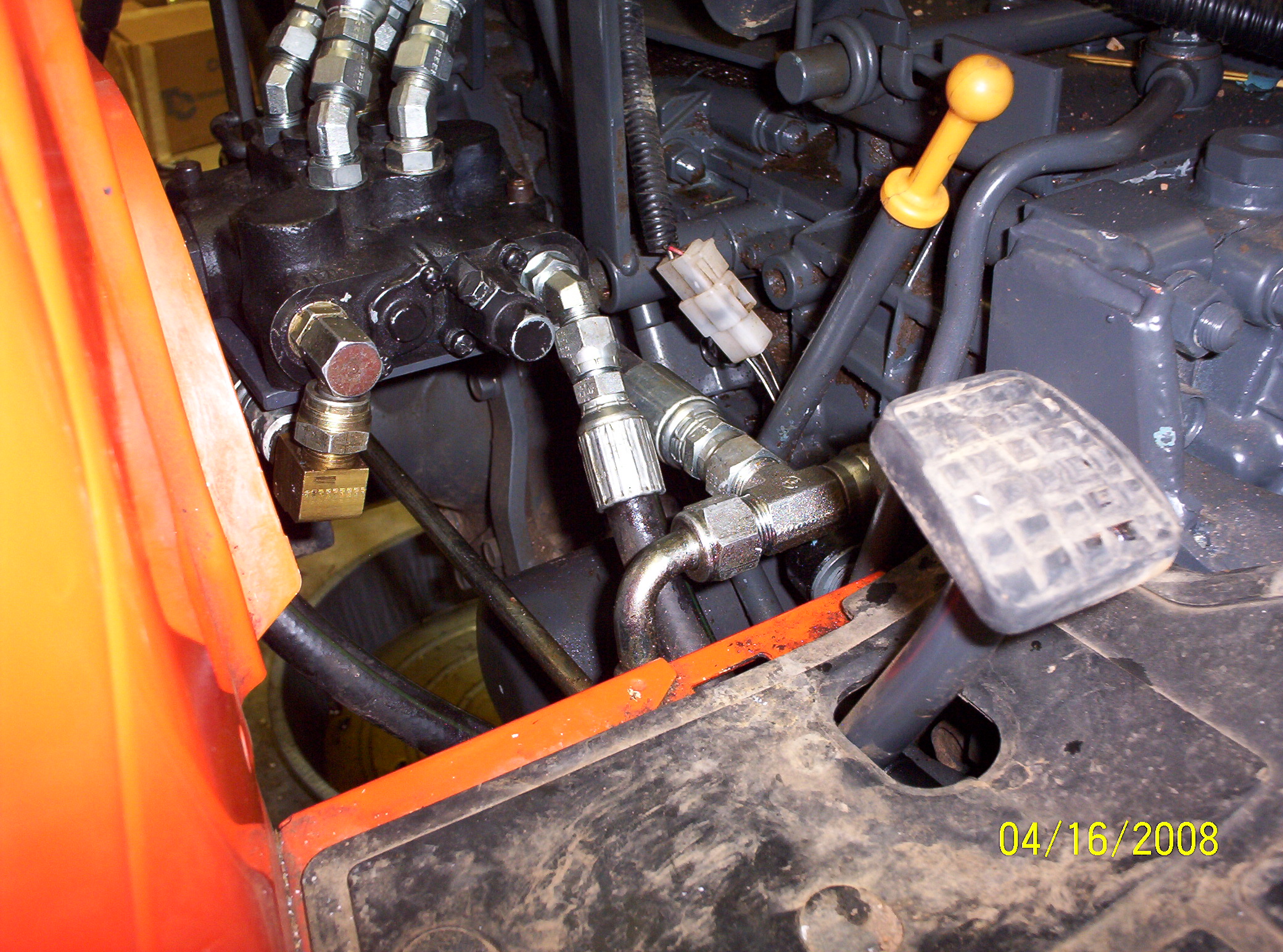

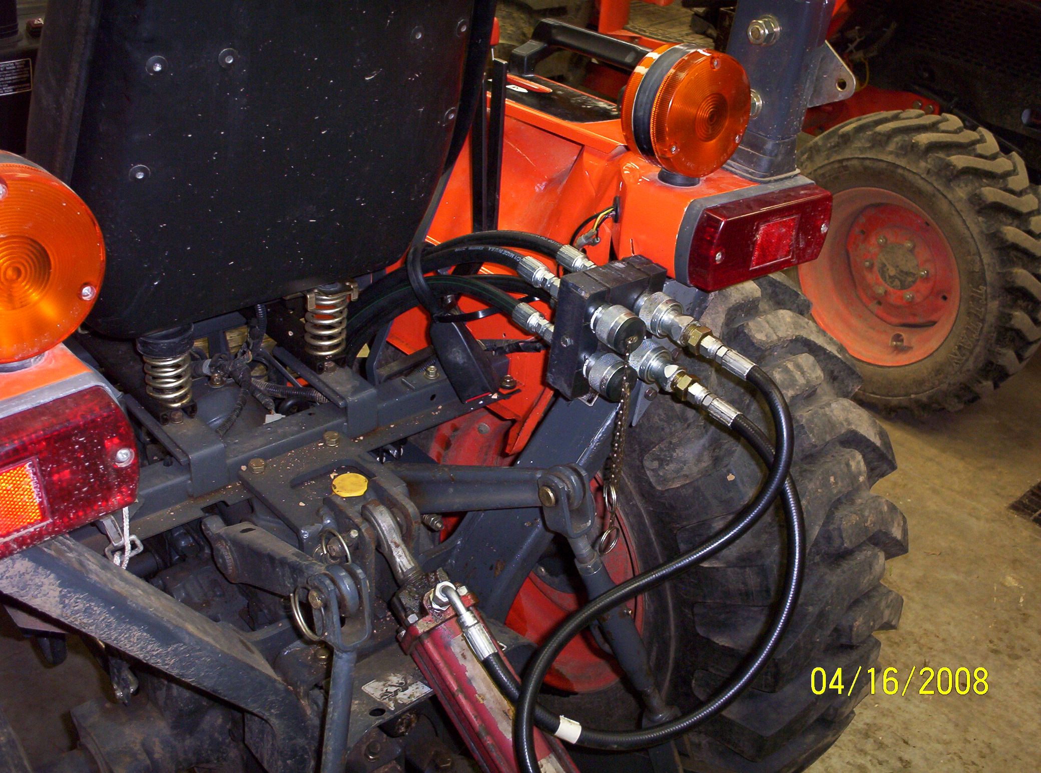

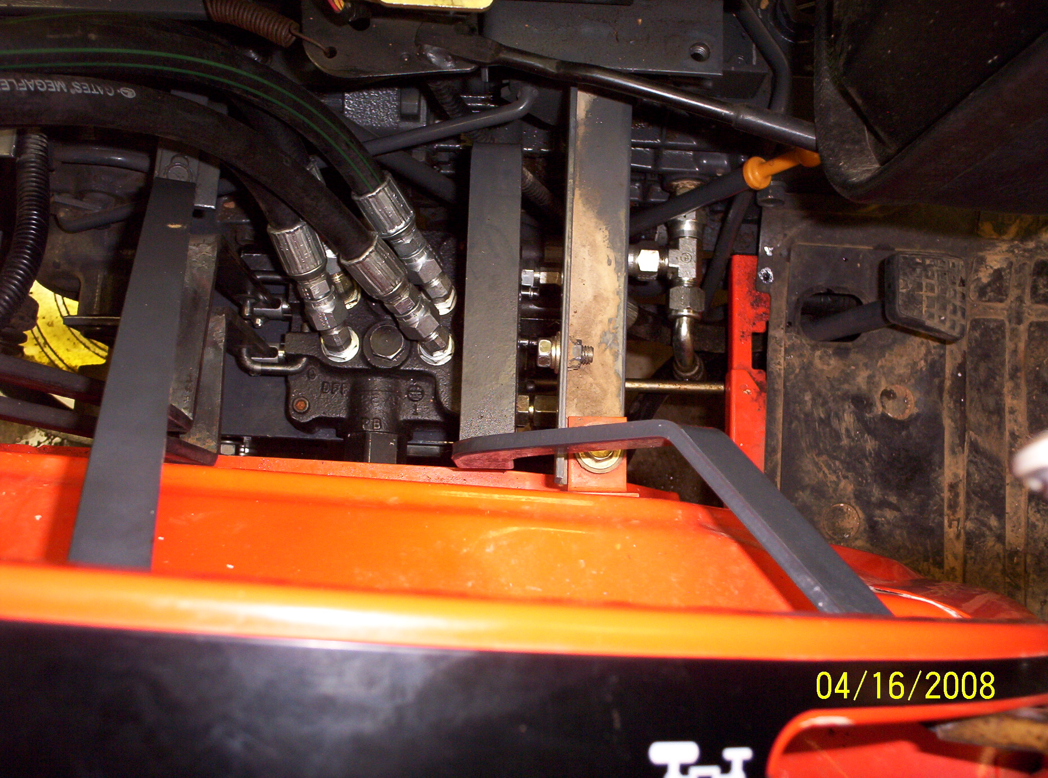

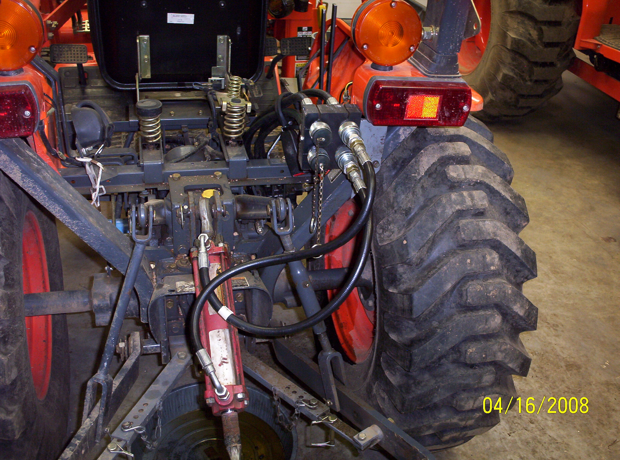

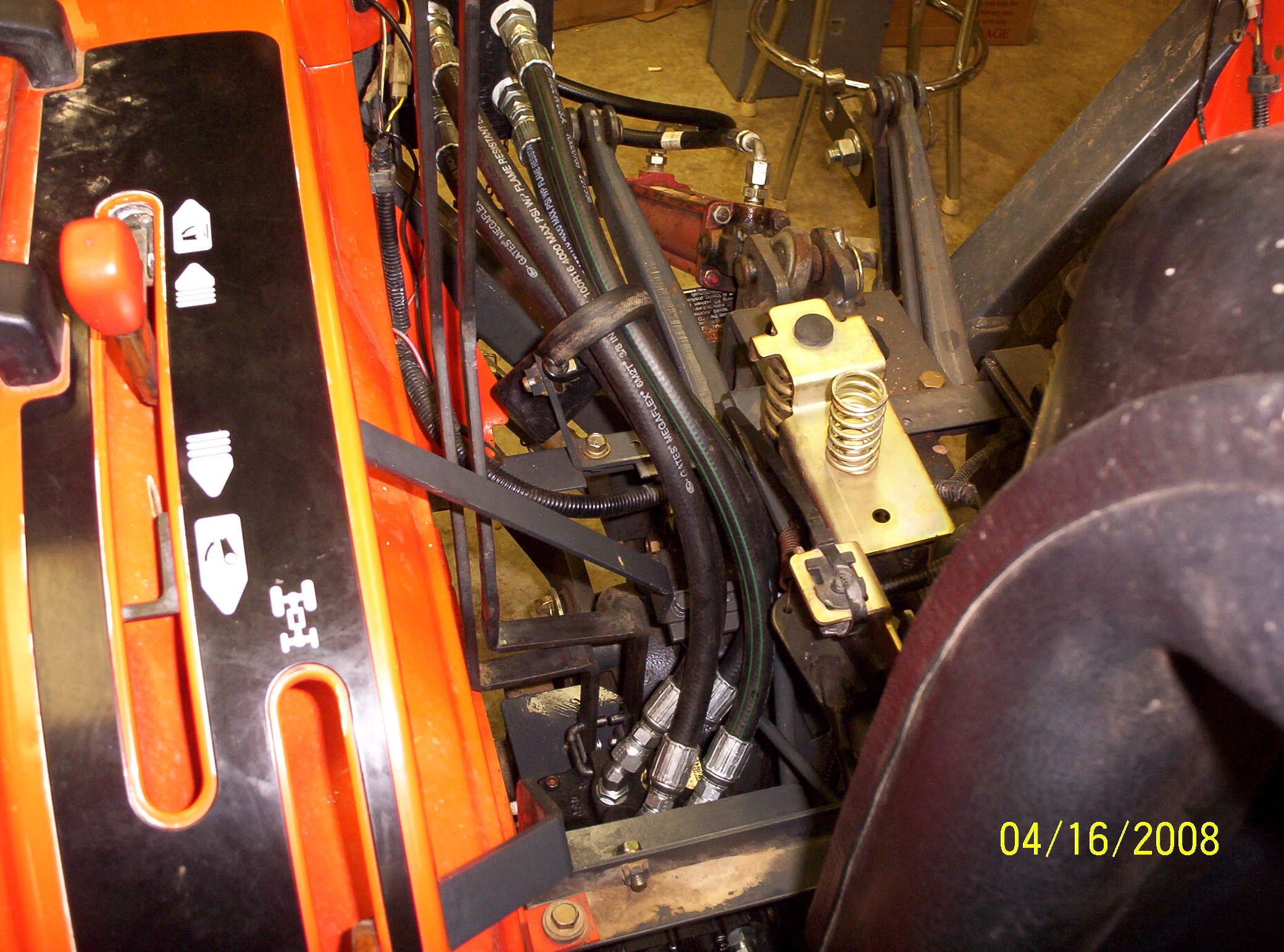

If you can get to my photos? I have a clean setup. The hoses are on the most part hidden and there is room for a small 3 spool valve, but you have to make you own levers and mounting bracket. I think I have just over $100.00 in mine and have 2 spools.

While I'm no expert... if you can have one spool. you can have a dozen. It's all about the physical space that the valve would use. The B7800 has a power beyond port that is fairly easy to use.

Kubota sells a rear remote kit for the B7800 that can have 1,2 or 3 spools. You order the base unit (1 spool) and add up to 2 additional spools if you wish.

Highrpms, I well post what I have.
