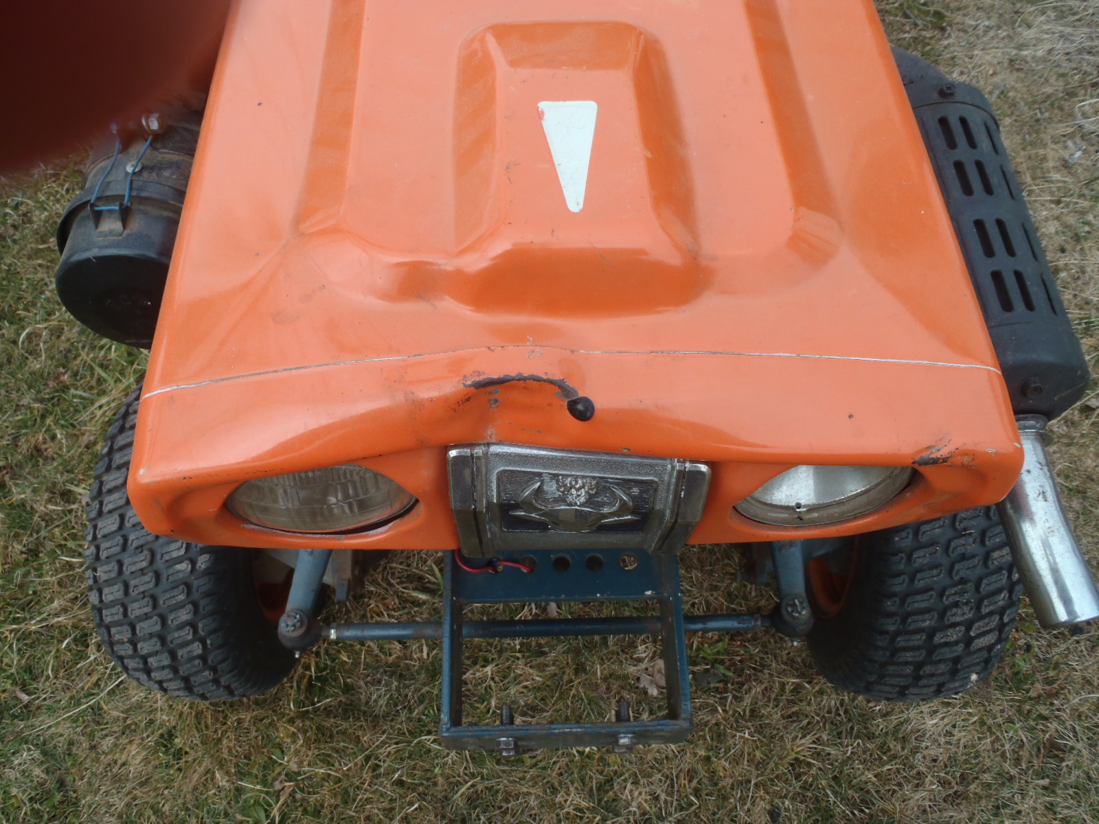

If you want to keep the stock appearance then you only have one option.
If you want functional, then you could cut off the front of the hood where the headlights mount and have a shop fab and mig on a flat front. Then you could mount in some rectangular headlights and still put the bull emblem in the middle. I think that could look pretty neat. I almost wish mine was more dinged in the front (ha! too late to trade) to do something like that. The OEM headlights I read are kinda weak. I am trying to figure out what to do with mine. I would like to put more powerful lights in, using a relay with direct link to battery of course. Finding some replacement that will fit the 4 inch opening is a challenge.
Meanwhile I built a front grill pictured below. That radiator was too exposed for me - my boys seem to run into everything when they 'tractor'. I did not put any expanded metal on the front of this one (unlike all others) since wanted to be able to reach in and clean the radiator front. It looks a little awkward, but then so does anyone over 6 ft sitting on this little machine - but that gives it some of its appeal to me.
That's pretty cool. How do you open the hood? As for the headlights, I've wondered if I could fit some 12volt LED spotlights in there. My son's LED Maglight is really bright but the wrong voltage.

Here's a picture - think I can knock that out? Doesn't have to be perfect:
Yea, it can be straightened and filled like mine or as has been suggested new sheet metal formed and welded over it. I have been giving some thought to using aluminum to form a new front and cutting a sheet to cover the top center which is wavy. Original may have to change to custom before its finished.

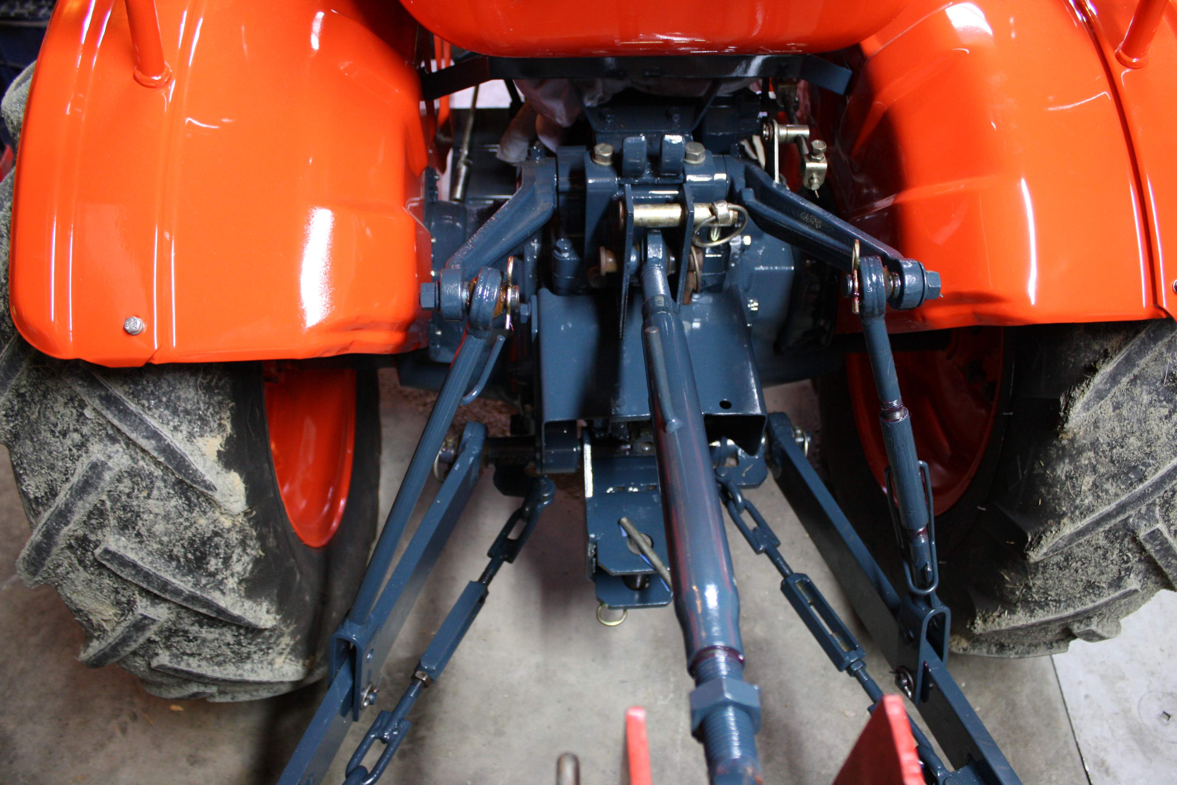

Spring came too soon and time is getting away from me. I am still working on the restore and using the tractor at the same time. Just lack the hood and front wheels now. Began body work on the hood tonight since I got rained out from plowing with the TC40. I have aerated the yard with the B7100 using my 3 pt aerator that I built from a pull behind model. It can be used with the tongue for tow behind also. I have used the tractor enough to confirm that it isn't charging. The Dynamo is putting out 20v ac at half throttle but I am only getting 4v dc out of the rectifier. Have run it about 2 hrs and the battery dropped from 12.49v to 12.30 volts. Also have to replace the Hr meter which doesn't work. Looked on Ebay for rear hubs but everybody seems to be sold out at the moment. Both of mine have been broken and welded and no attempt was made to true them so I have rear wheel wobble. Seems as though the battery has been shorted out on the hood at some point as evidenced by the burnt area. I wonder if this could have fried the rectifier? I made a battery hold down since the Kubota one was long gone. And you may notice that I will be needing a seat cover also.

/ B7100 Restore Project Has Begun #97
Are you going to put new ag tires to finish the restoration?
Looks good
