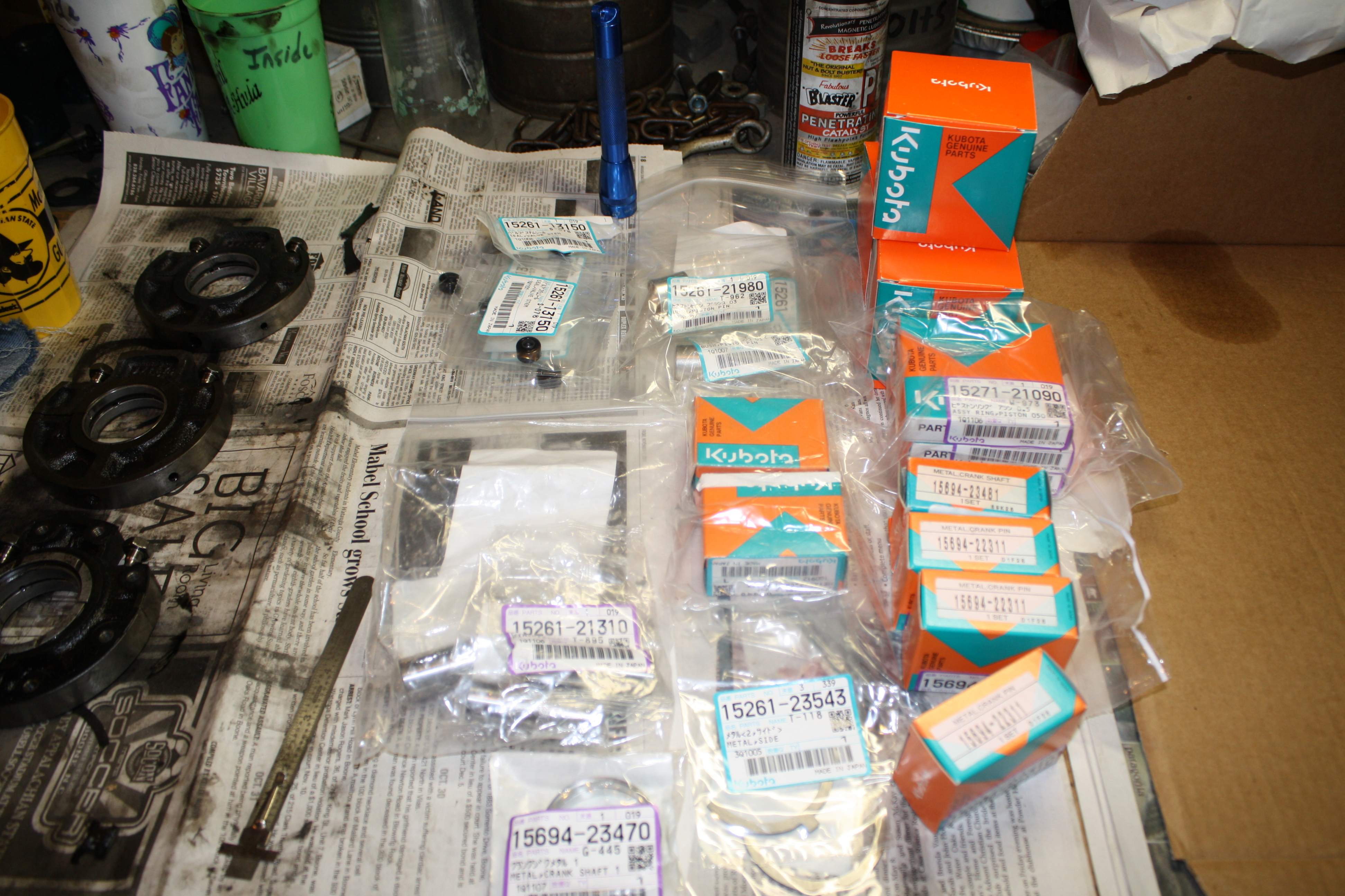

Got my head, block, and crank to the machine shop yesterday. Good news so far. The cylinders are good for a .5mm bore and the crank will just get a polish. Ordered 675.00 worth of parts from Messicks just to get the machine work going and put the bottom end back together. Thankfully I obtained this tractor very cheap on a NC sealed bid so I have a lot of room to spend before I exceed the value. Hopefully I will have a like new tractor for the same money that I would have paid retail for one then had to make repairs. As for the wheel weights, the tractor has front and rear factory weights. With the FEL being plenty of weight for the front I am considering not using the fronts if the restore continues. The tires have never been loaded with fluid so my wheels should be in good condition. Spent 4 hours washing engine parts spic and span to prepare for a restore paint job as I re assemble. Will have to get the engine going before I will know what else needs repair besides the charging system which was the reason for the tractor being taken out of service.

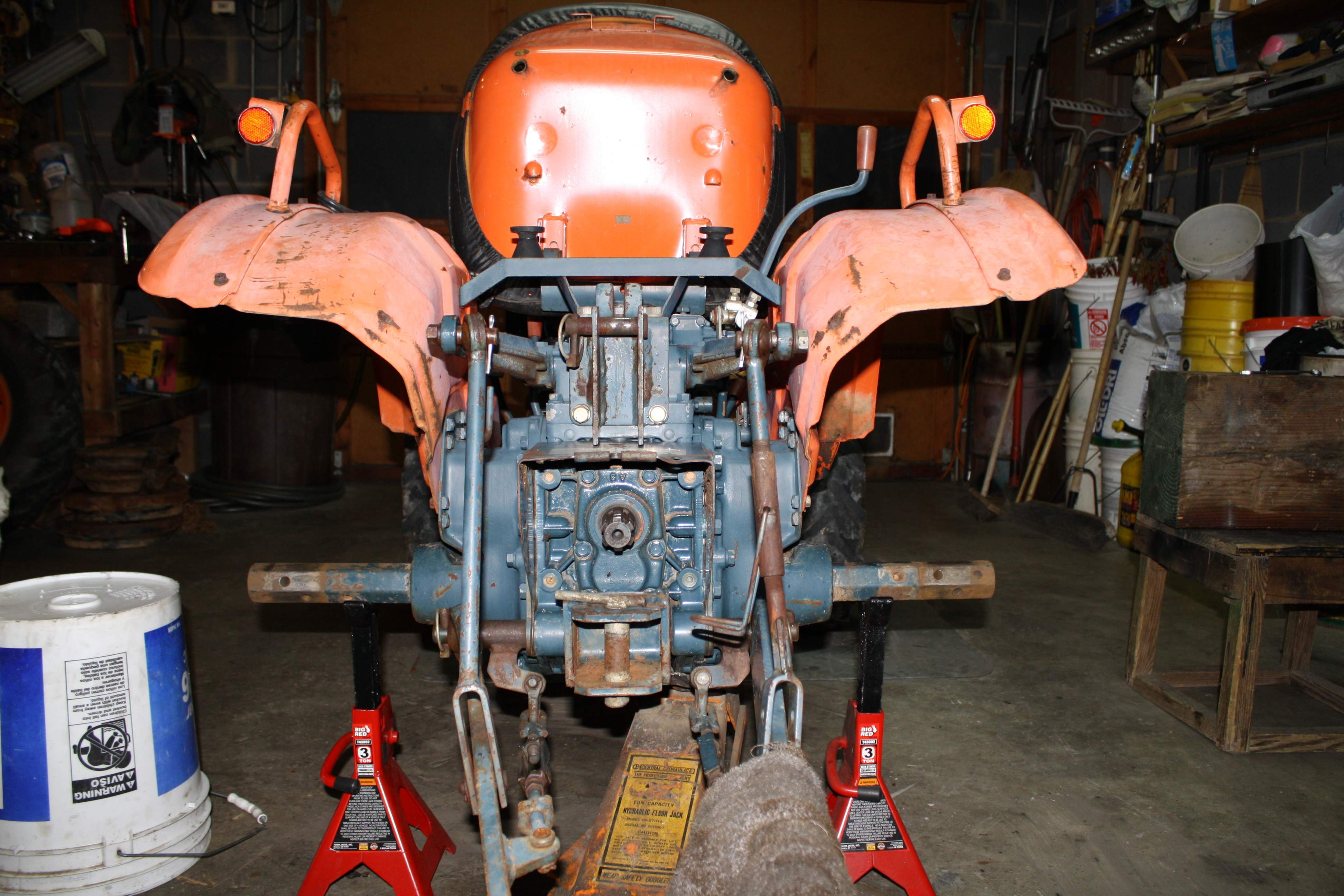

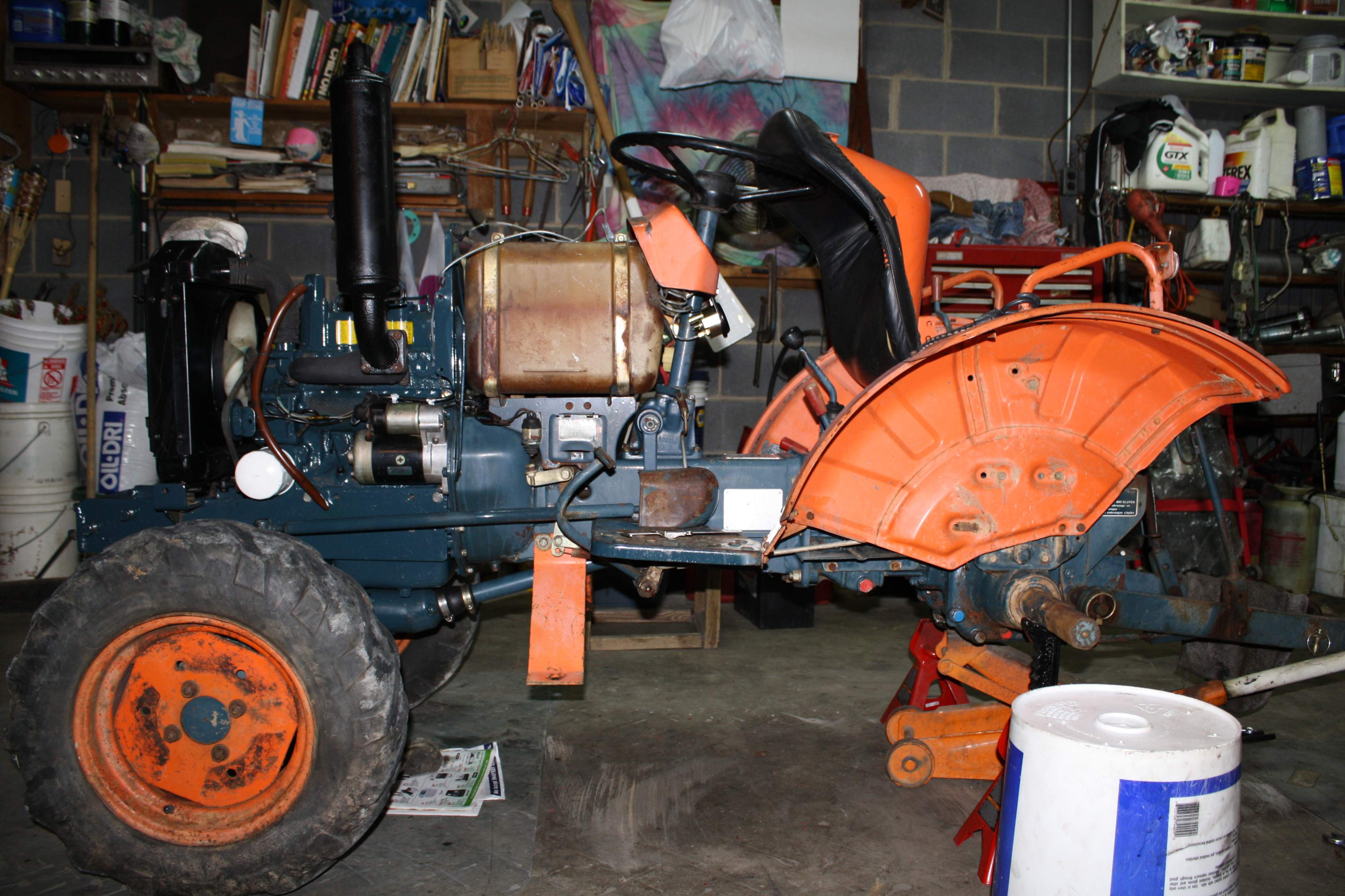

Anyway, have another engine being delivered on tuesday so I will do some investigating and put best one in. Separated the back end of the tractor today (working from back to front). Found bad U-joint for 4x4 shaft I will replace. Hydrostat linkage was misaligned preventing it from returning to neutral position (been that way for years obviously) which I will fix and improve on the original design. Tomorrow will separate the bell housing from engine and see what exciting things I can find there.

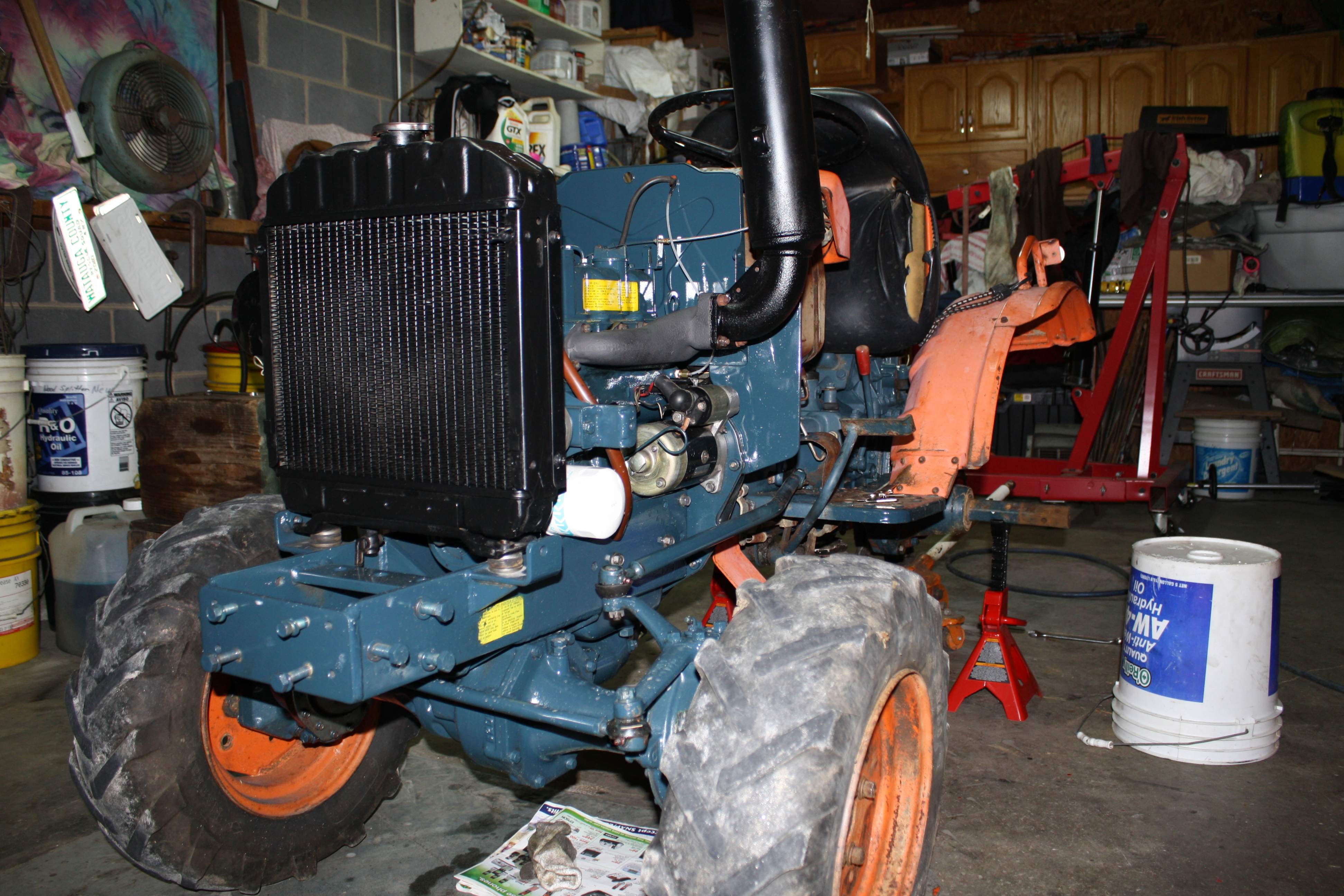

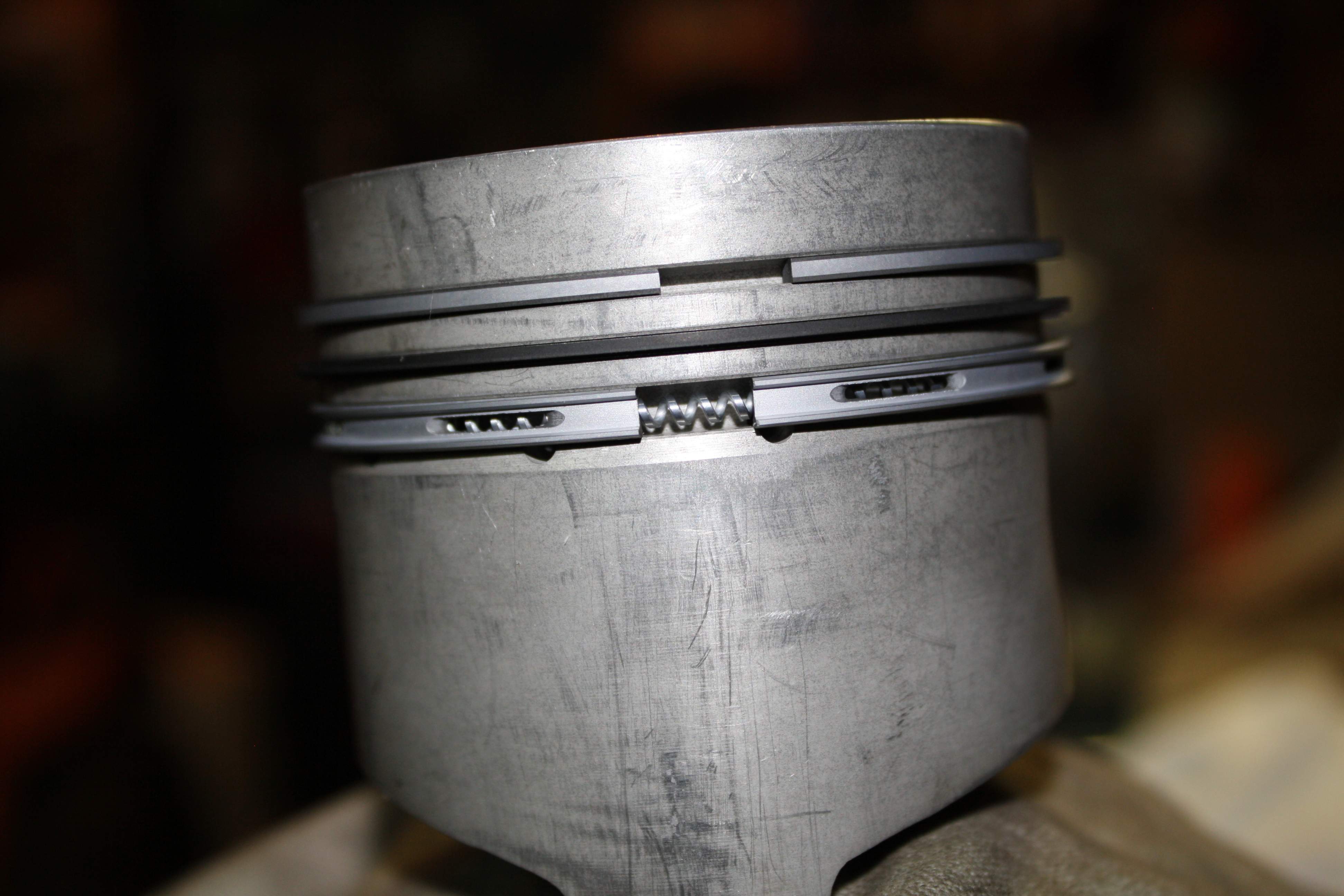

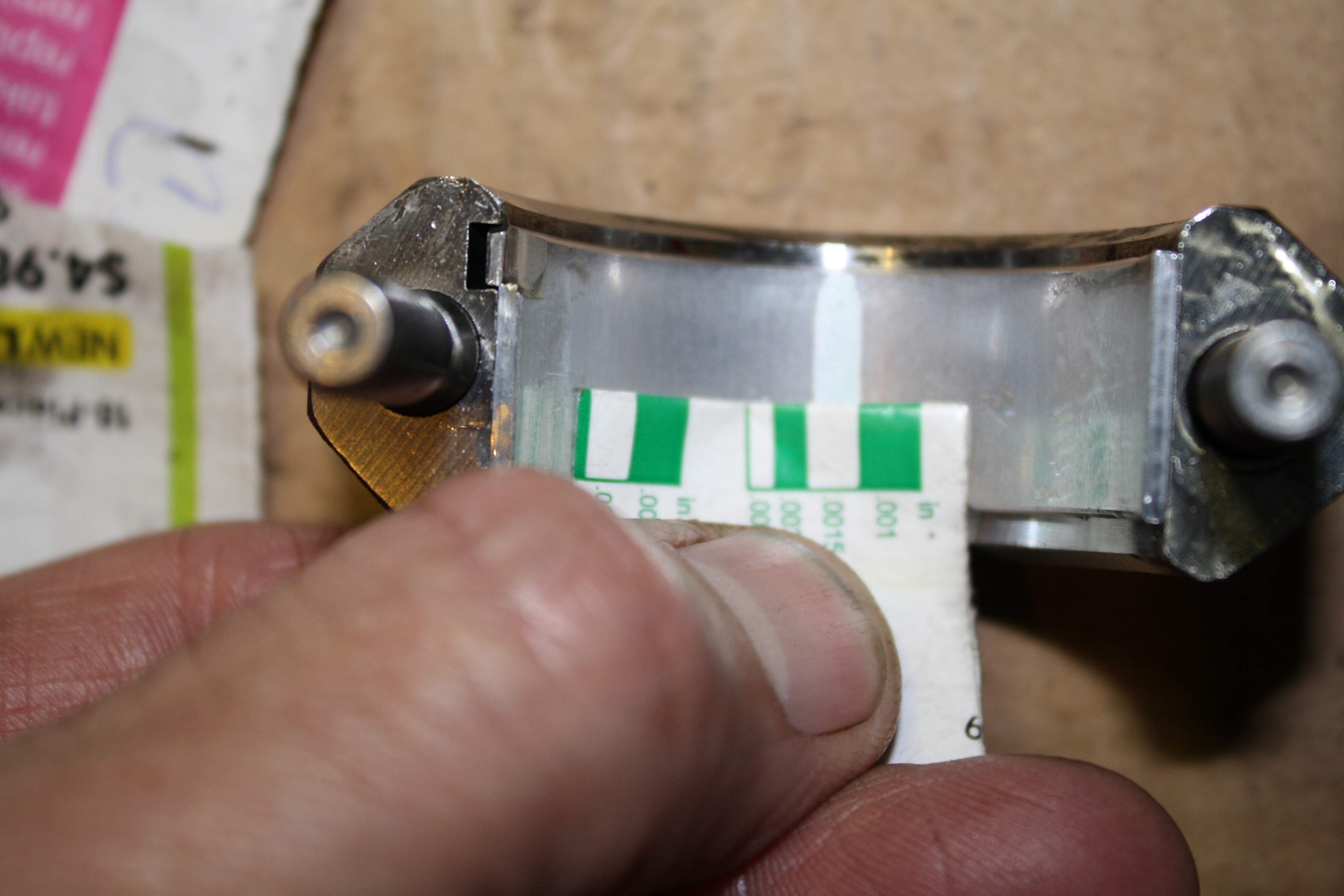

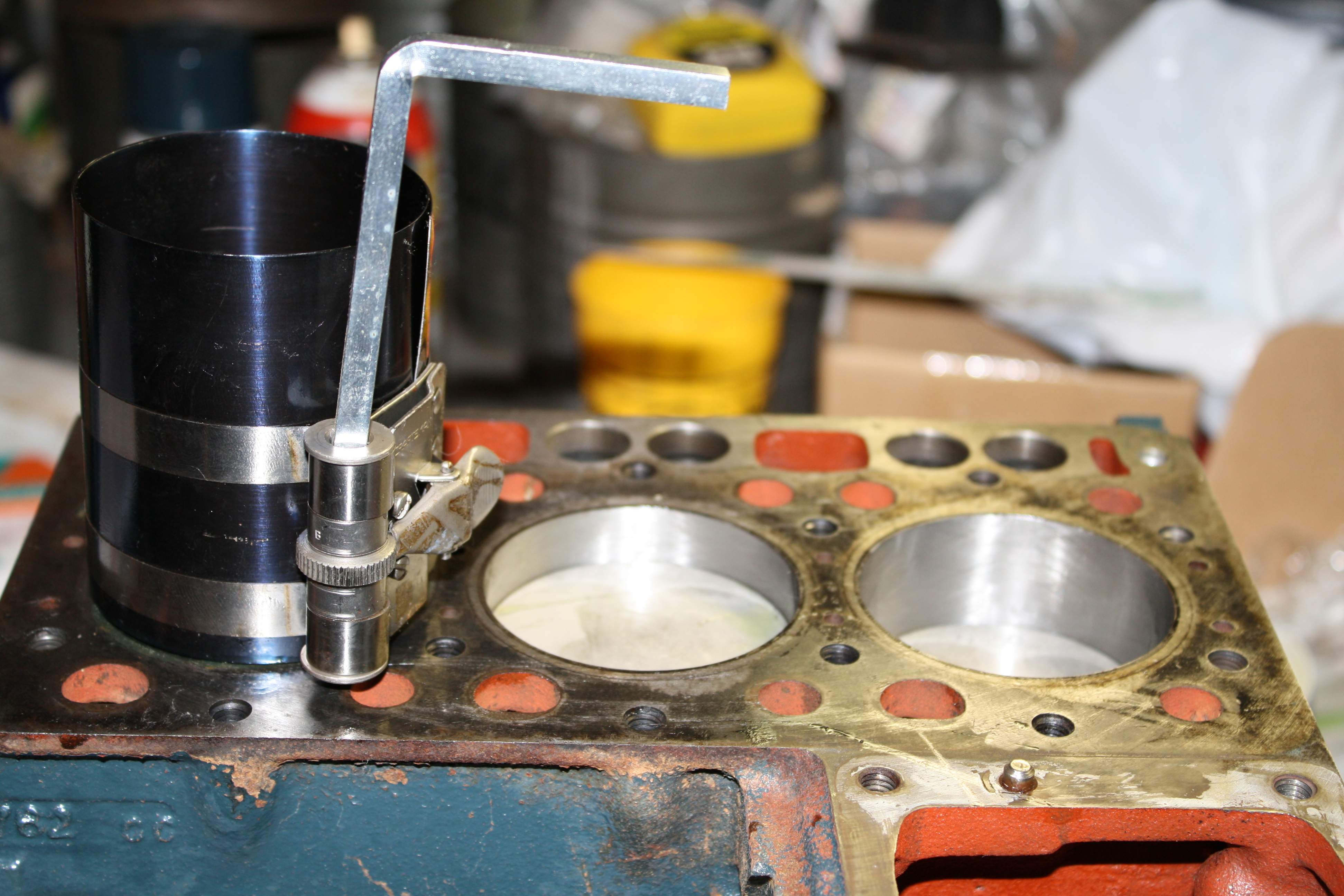

Picked up my pieces from the machine shop on Wed. and got to work. Checked piston skirt and ring end gaps and got the pistons installed. Bearing clearances all checked good. Got the bottom end together by Wed. night. Started early Thur. morning and finished the reassembly and painting. Bolted it up Thur. night. Rolled the front axle and frame into place Fri. morning and made all of the hookups. Fired it up Fri. night. Posted video of the fire up after bleeding the fuel system but the audio did not load so there is no sound. It purrs like a kitten. 40 PSI oil pressure reading on the manual gauge that I installed. Took it out on Saturday to begin the break-in. Now I can find out what kind of shape the tractor is in. Gear noise is more than I like to hear in 4th and 5th gears and is worse in 4wd. Lift works good but leaks down if left up for an extended time. Rear hubs are worn which I already was aware of but didn't know how it would affect the tractors performance. IMG_2130.jpg

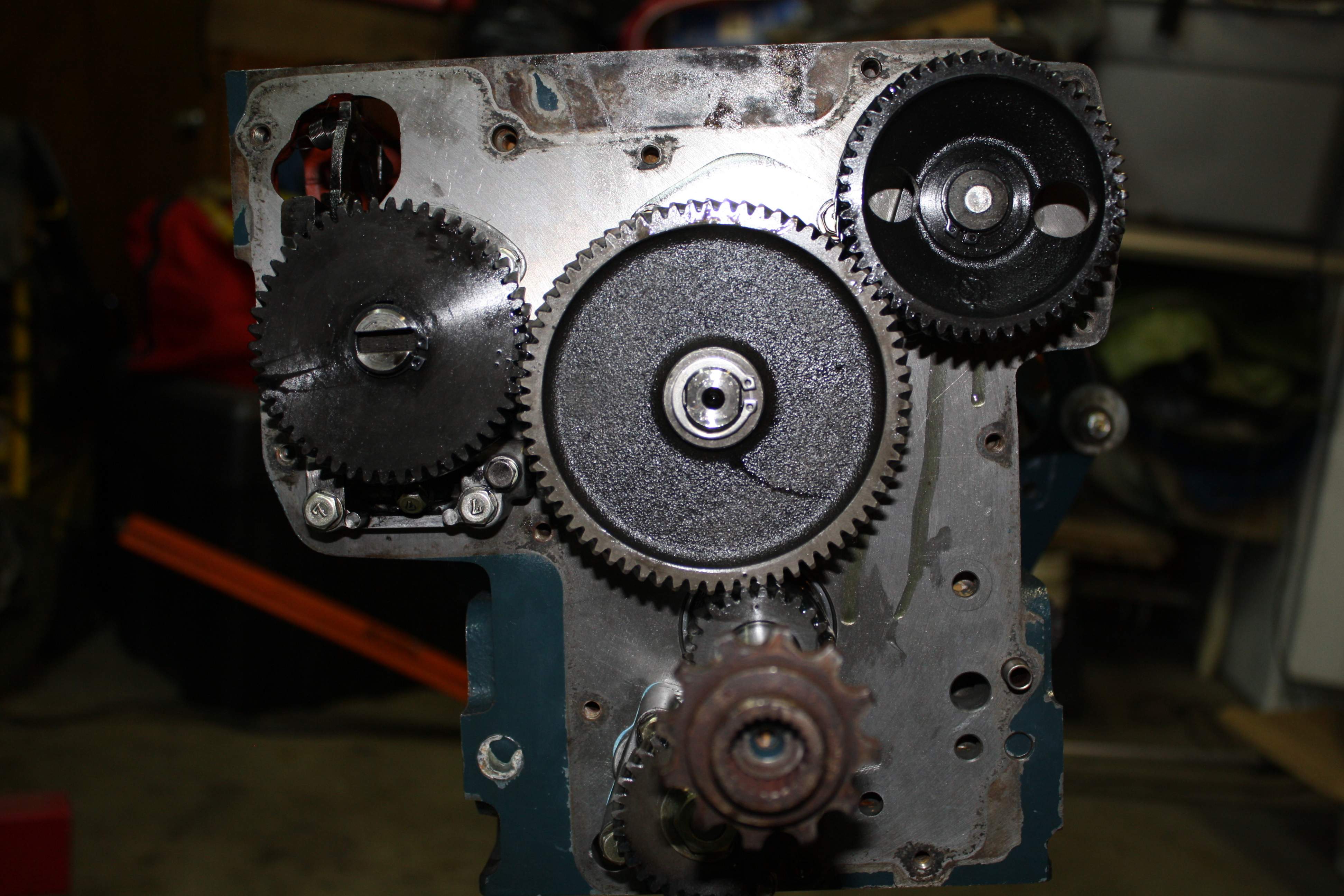

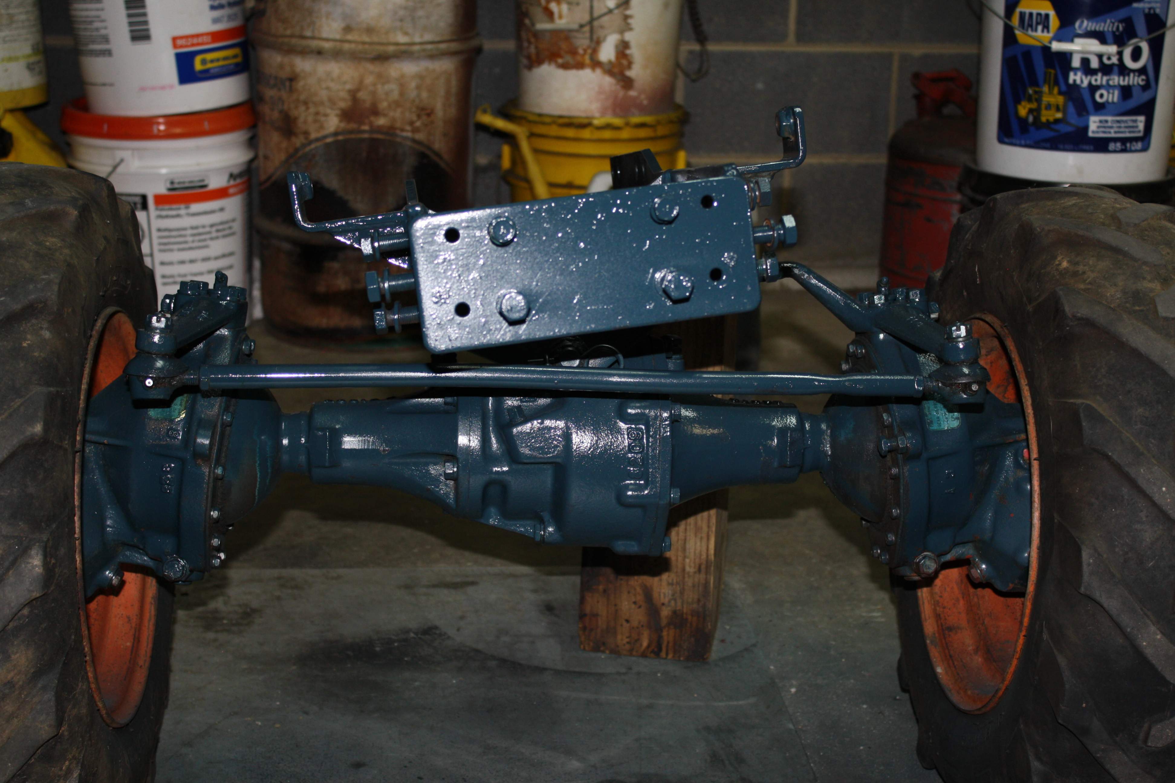

Now comes the rest of the restore. Going to break it apart and inspect the gears to try and locate the source of the noise.IMG_2169.jpg

WOW! that is a gorgeous engine. There is no greater satisfaction than rebuilding an engine and having it fire right up and "purr like a kitten". Not everybody can do that and you've got to give yourself a lot of credit. I like the pictures. I can almost smell the oil and feel the plastigauge! I hope I am as lucky as you are skilled when I get to heating up the glow plugs for the 1st time!
Ugh. Sorry about the gear noise. The rear is a little more daunting for me because I know its all about replacing not rebuilding. A full line of bearing separators and a little hydraulic press can be worth their weight. Hopefully you can find a simple "junkyard problem" = "one bad dog with a broken tooth".
Did you have any metal on the sump screens?
