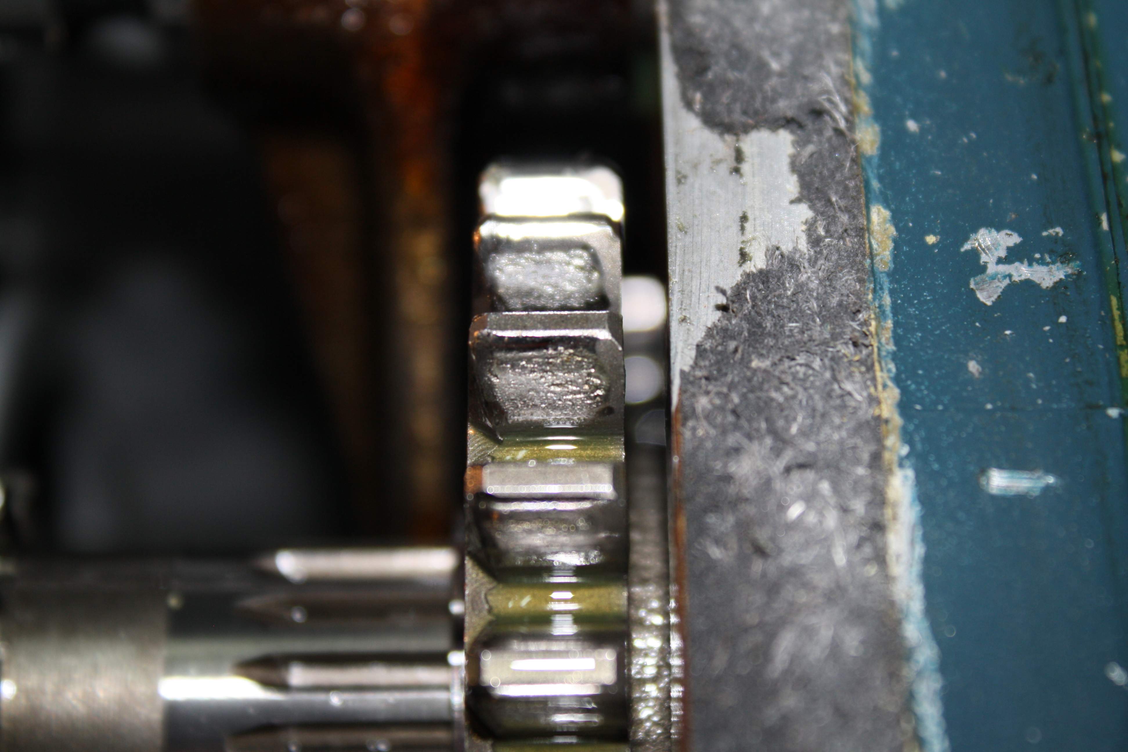

I have two videos, one while the last of the air was bleeding from the injection system and another after it smoothed out but I am having trouble getting the audio to transfer from my HTC phone to the computer. Will continue to work on getting audio. The tractor is stripped bare now and the gear boxes are open so it will be a while before it will be running again. Found four worn gears in the trans. last night. Lots of thin metal shavings in the sump screen. Will be breaking it in half and doing a trans rebuild now. Haven't priced any parts yet or checked availability. Kinda dreading to find out the prices after the shock of engine parts buying. Looking for the best quality and lowest priced rear axle hubs too if anyone has any suggestions.

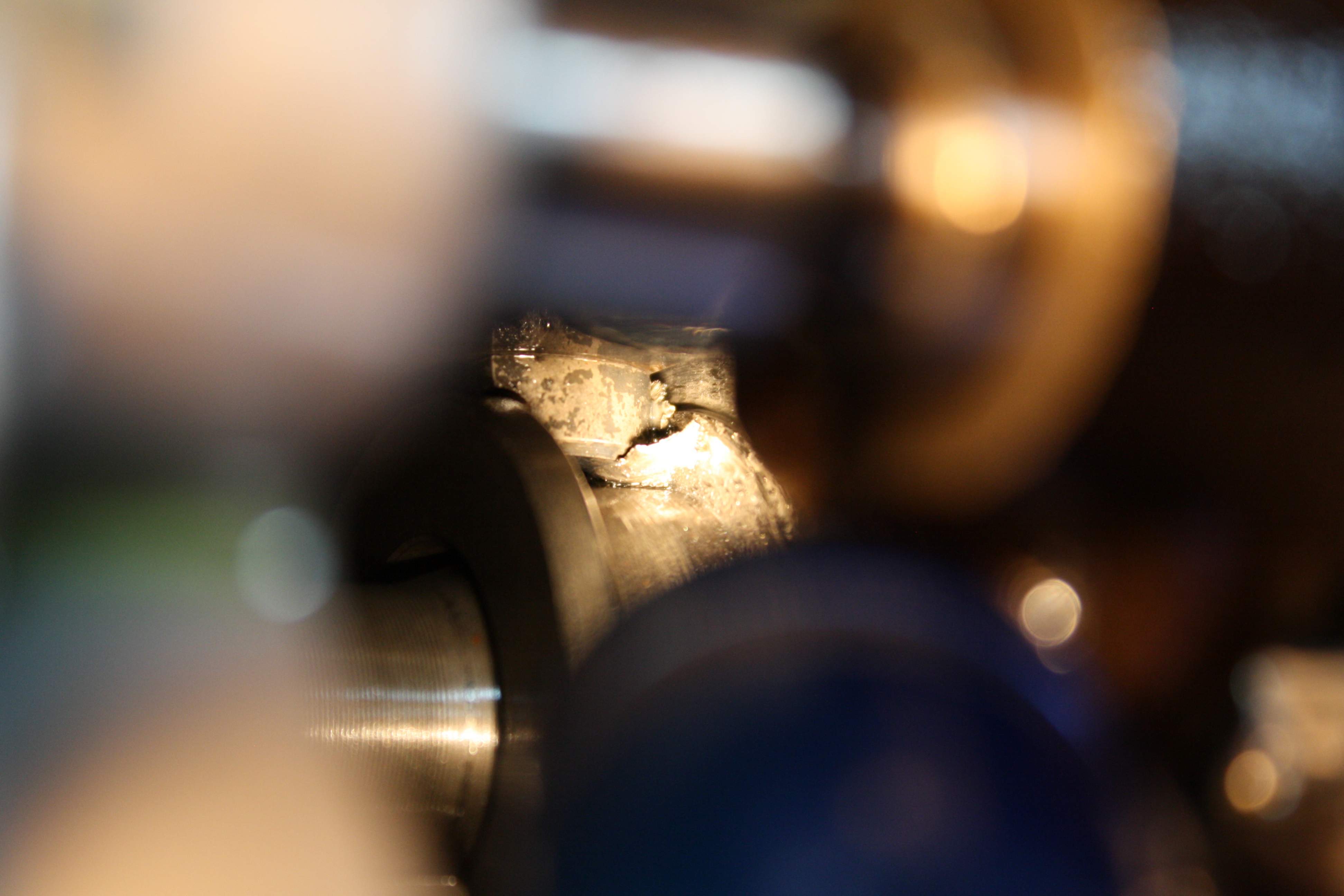

You might want to take a close look at the front frame extension before things go back together. I found mine was cracked in half, the front axle was wobbling around. Cleaned and up welded all better now. Check the front axle tube assembly as the crack progressed the axle tube bushing showed extensive wear.

I checked mine very close as I was cleaning and painting it. No sign of stress or cracks. The center pin has some front to back play but no side to side so I elected to wait and work on that later after the major repairs are finished. I had read a thread on TBN about a broken front B7100 frame a while back and that gave me insite to check mine real close while it was down. That may have been your thread that I checked out. Thanks for the information.

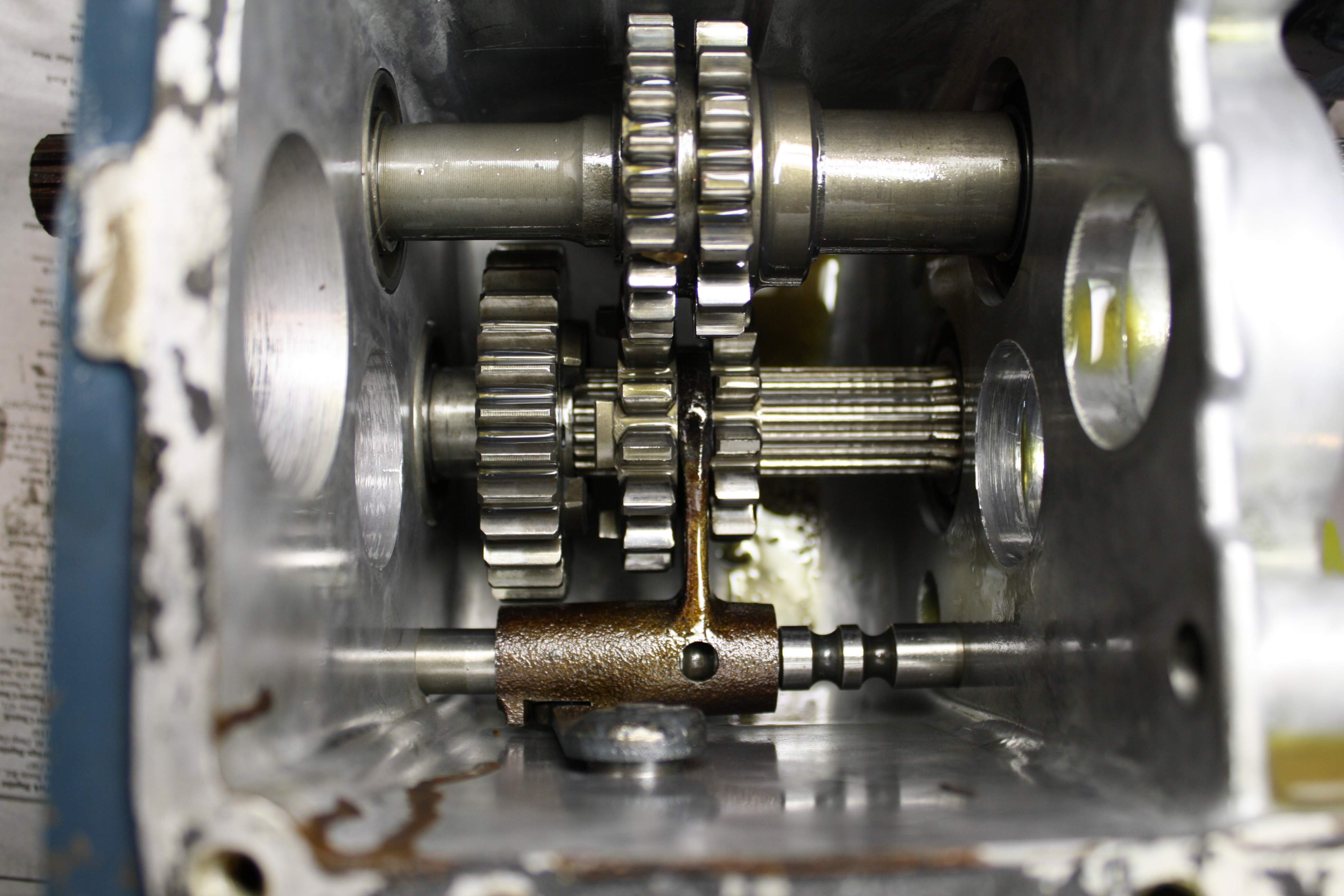

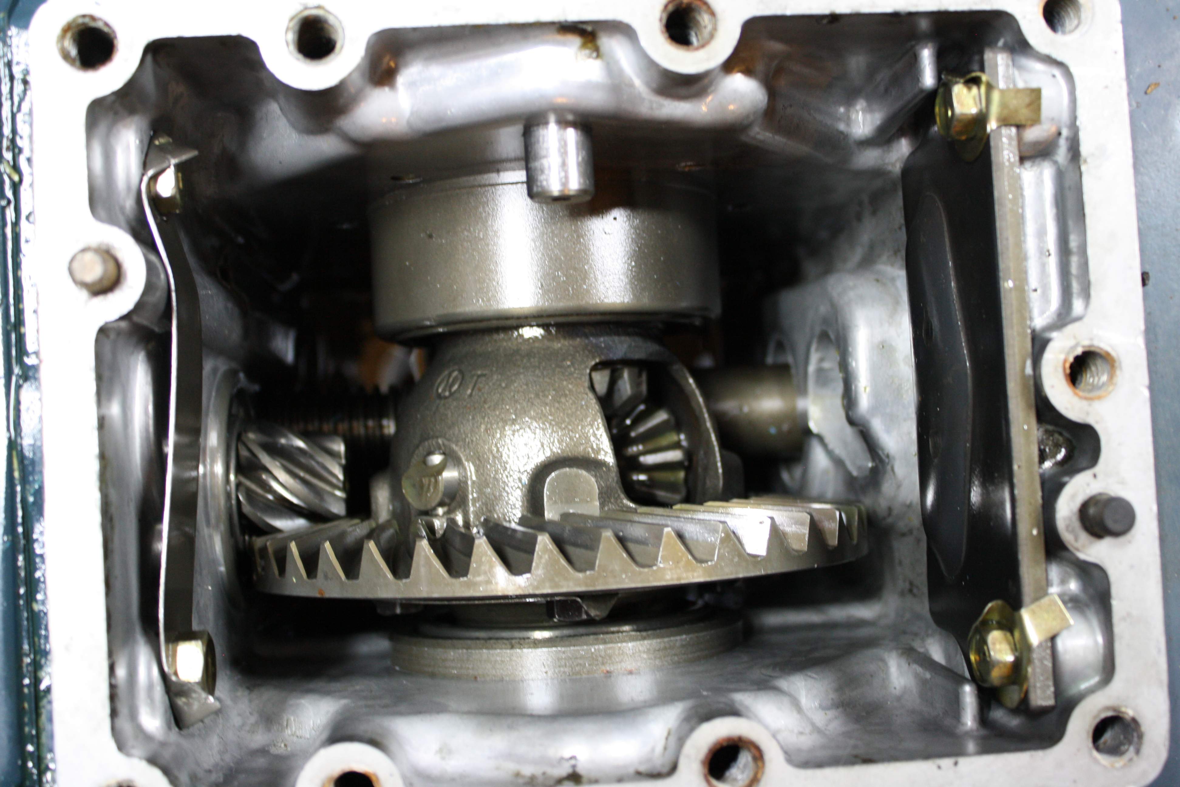

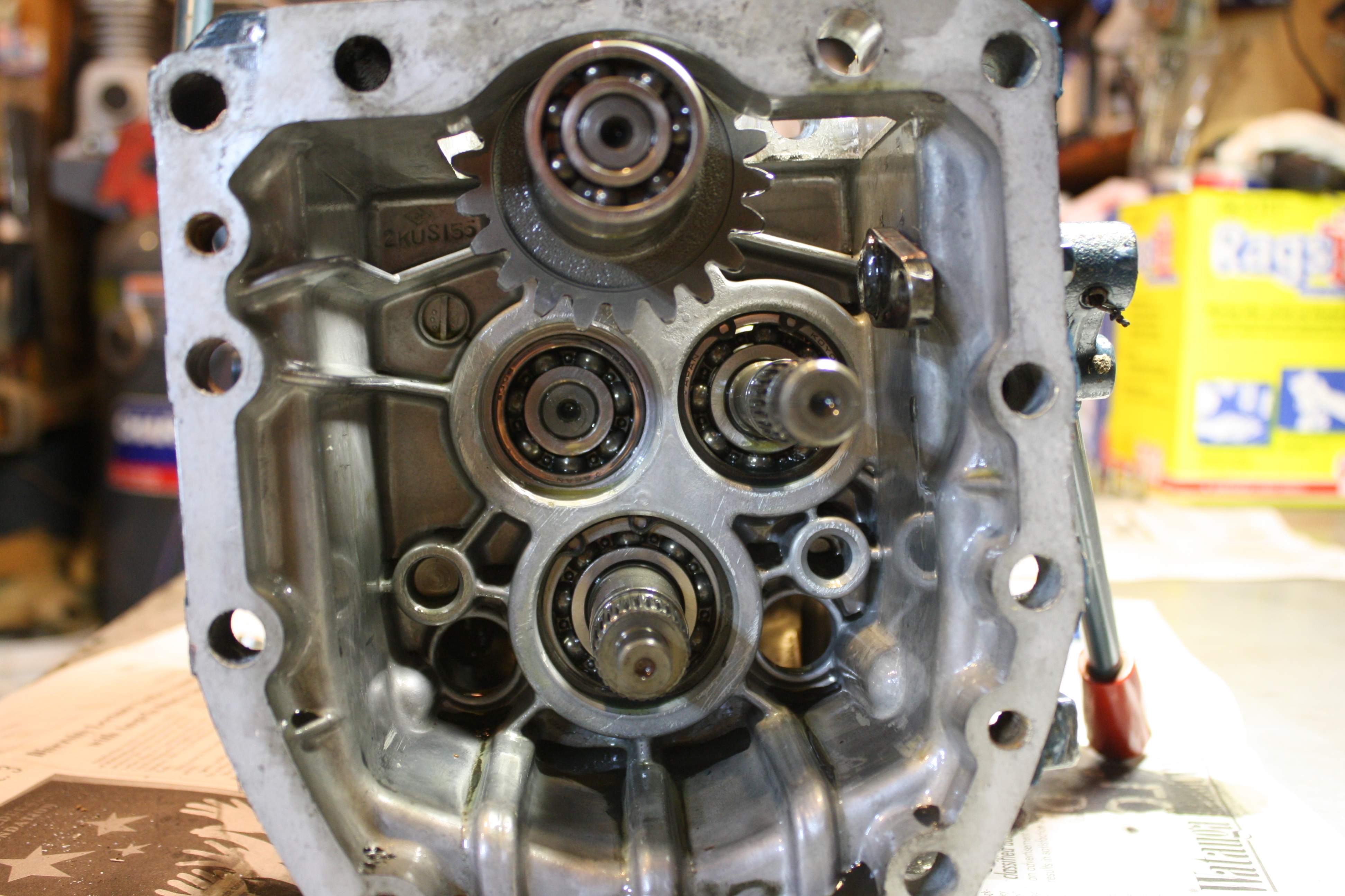

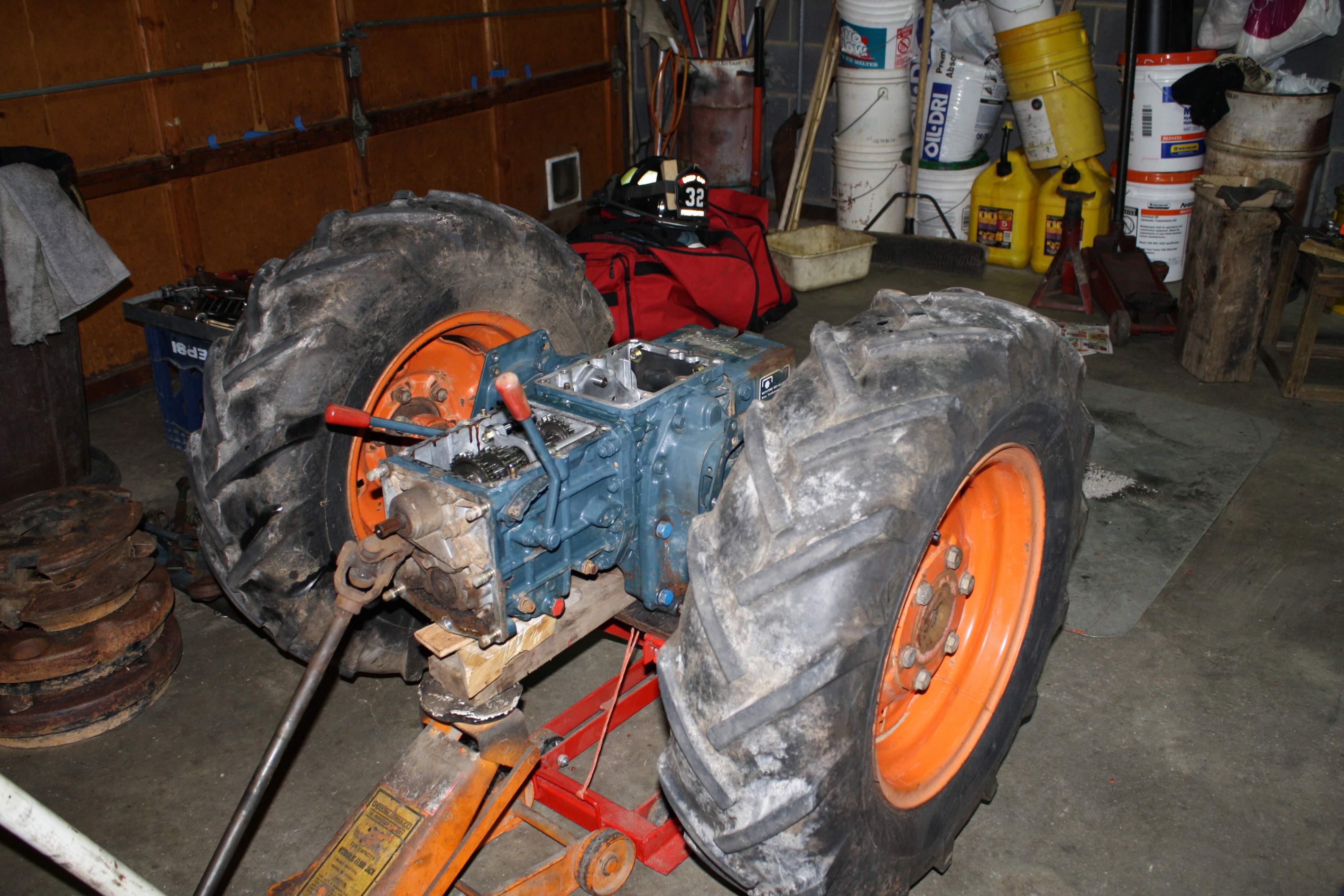

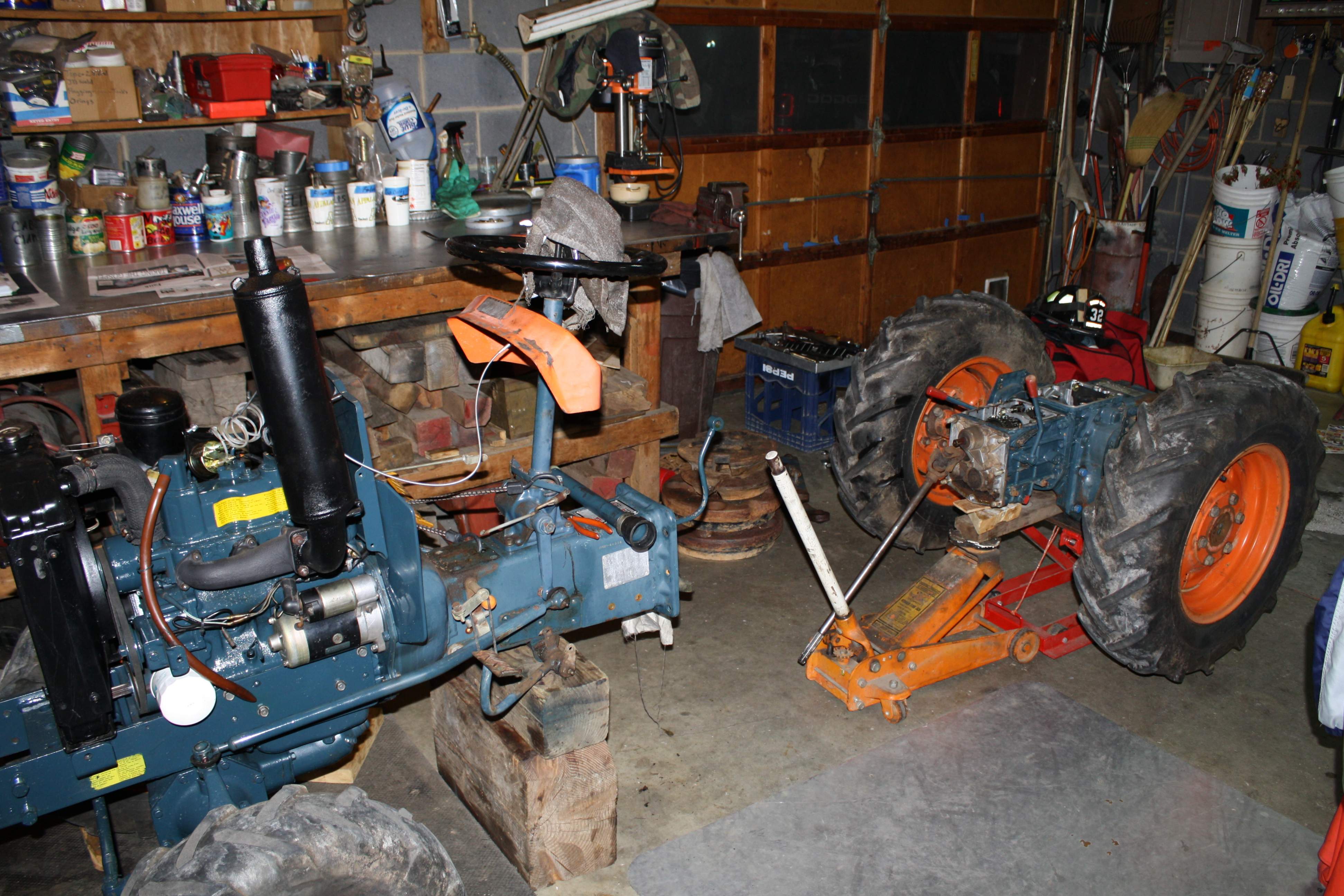

Well, got it broke down and a list of trans. parts together. Just as I expected the gear box parts are just as pricey as engine parts. I located a salvage trans for 850.00 with a 200.00 core plus shipping. The parts to renew mine will run about 600.00 so I am going to build it and hope for the best. I can't find any reason for the gear failure as of now. The oil was slightly tainted with typical tractor gear box condensation and all bearings feel good. The only thing that I can figure is that the machine was used a LOT with the FEL. The gears appear to have failed under extreme pressure. The shifter fork guide for the High Low was worn almost completely out which then wore the guide channel on the gear out. Began cleaning, sanding, and painting parts from the engine back. Will have to locate a hood due to damage on the front of mine around the head lights that can't be repaired. This is from many years of being banged on the FEL while opening and lack of a front grill guard.

/ B7100 Restore Project Has Begun #52
Great pictures once again.
Interesting are the differences between the HST and the Gear drive.
Both my 4x4 u-joints were bad and I had to rebuild both.
Keep up the good work.
#53
My joints are good but the rear yoke at the transmission has some wear to the splines. The shaft splines are good.
