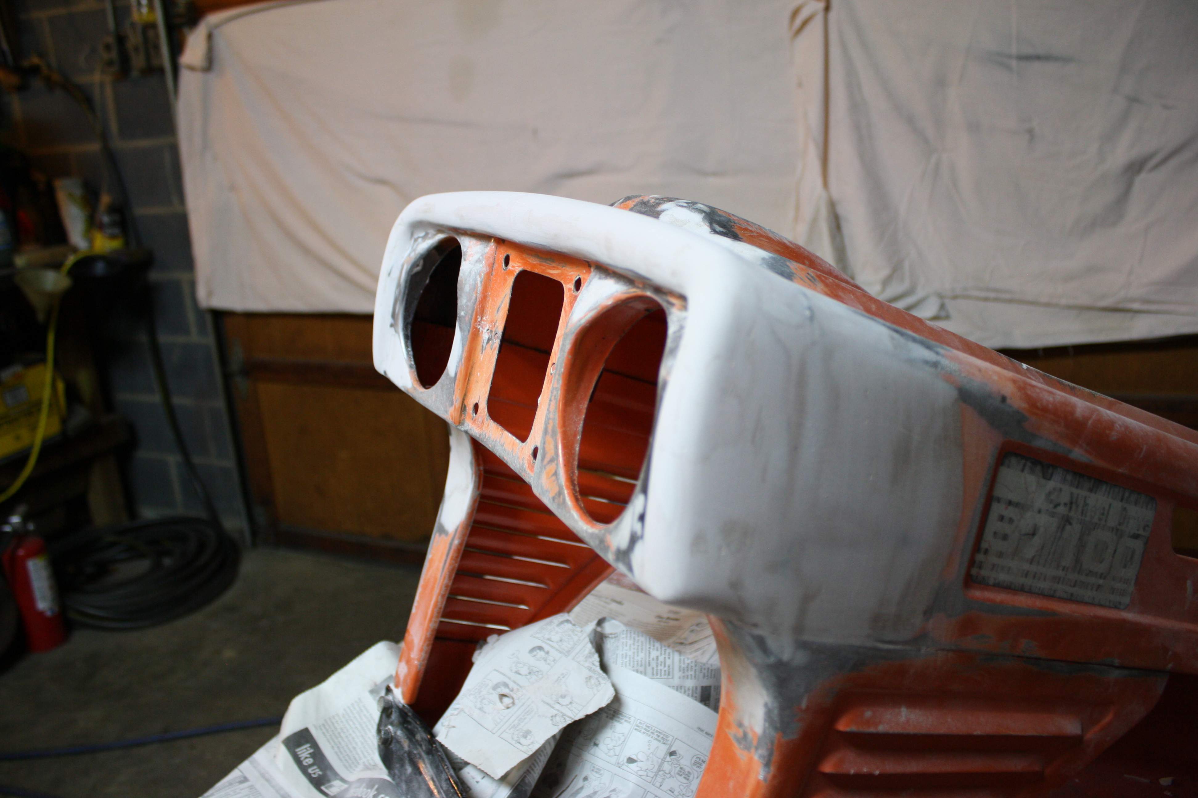

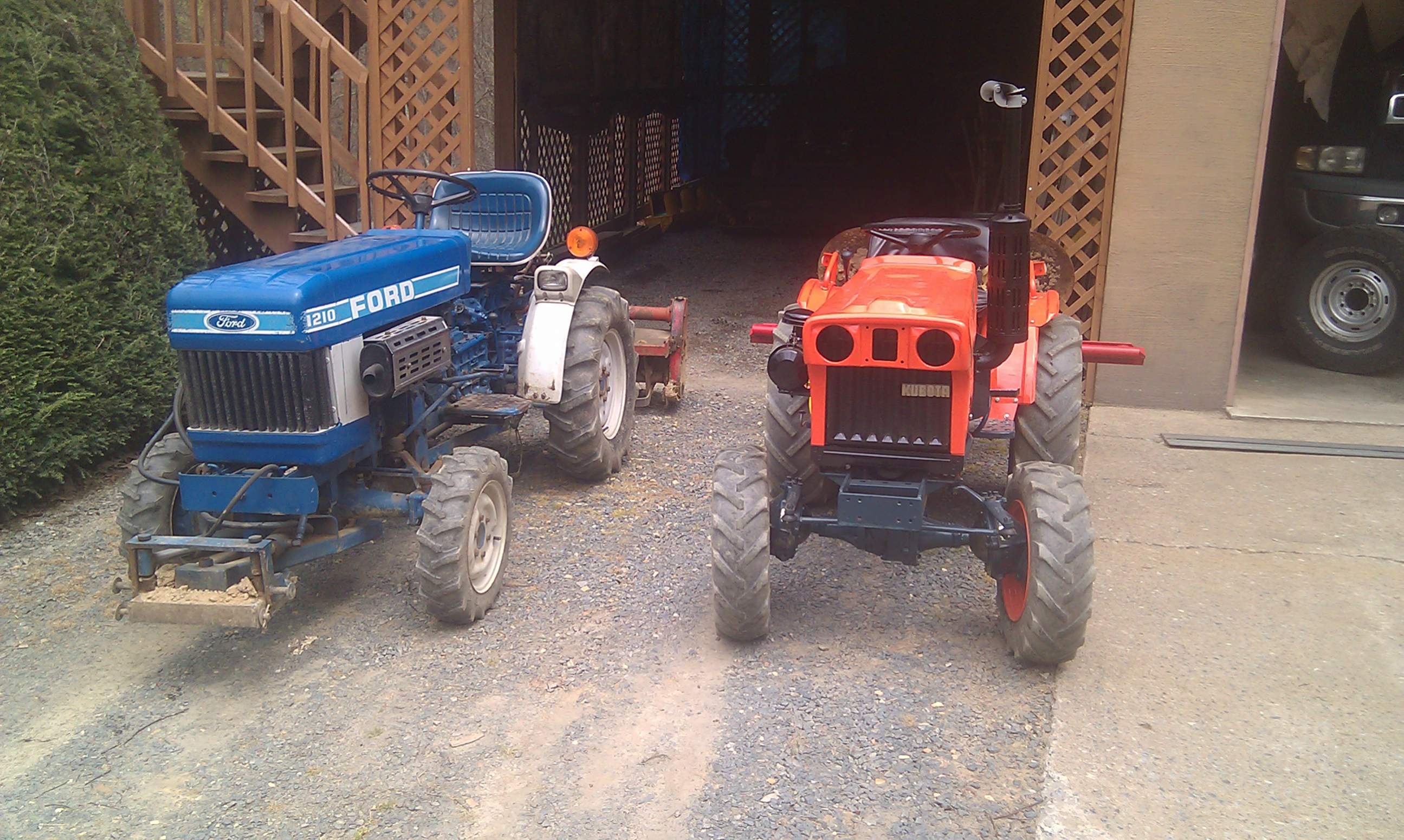

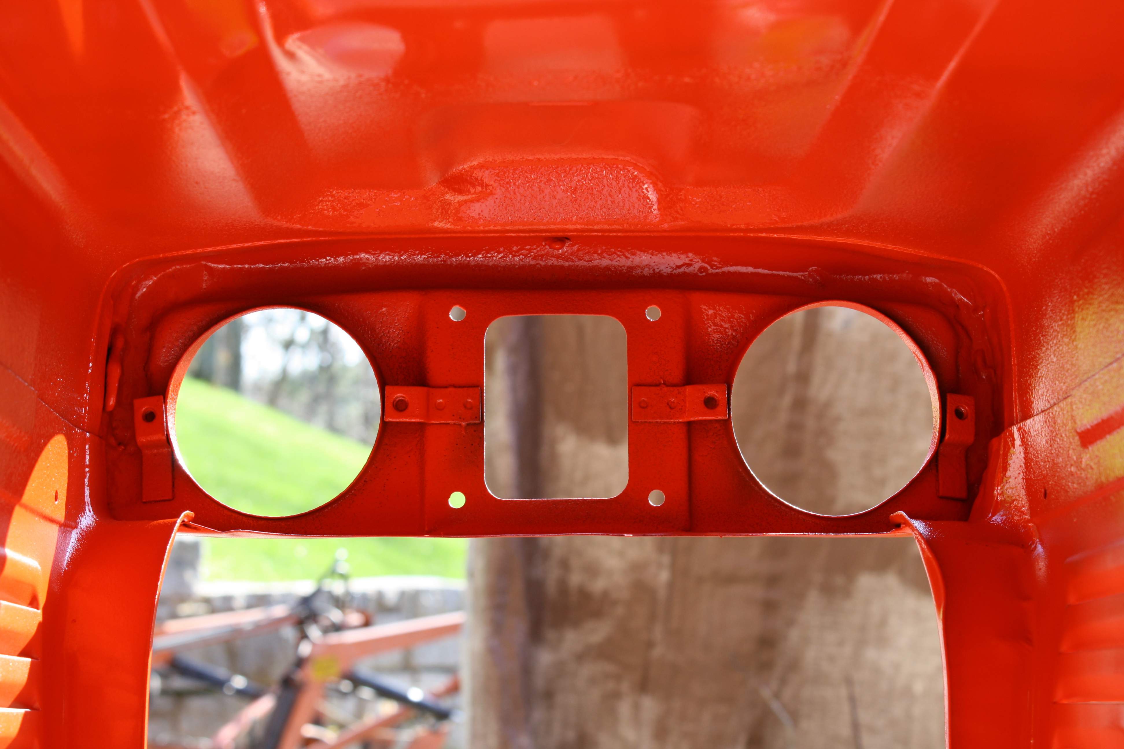

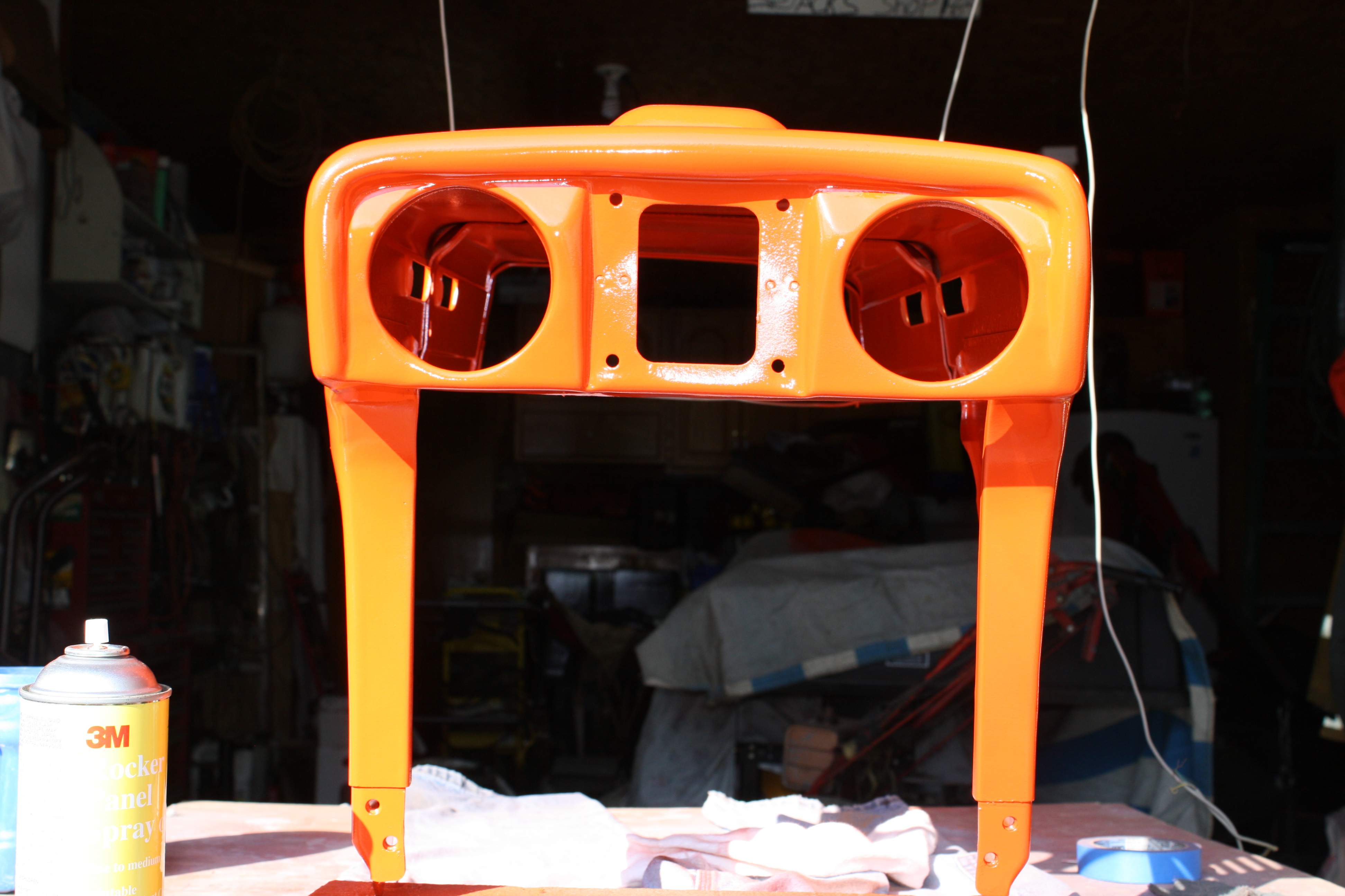

Its getting there. With a few more hours of working the shape, a coat of high build primer, a good wet sanding, then a coat of 3M Rocker Panel Spray on the front panel to give a slight texture that will hide the imperfections, it will be ready for the final orange I HOPE! Its time to rototill and I want to use the Kubota in full dress to break it in good. Give the Ford 1210 a rest this season.

Looking good. Can't wait to see body in orange.

Finally got the color on today. It turned out better than expected.

Very nice. You don't need a new hood, you just made one.:thumbsup:

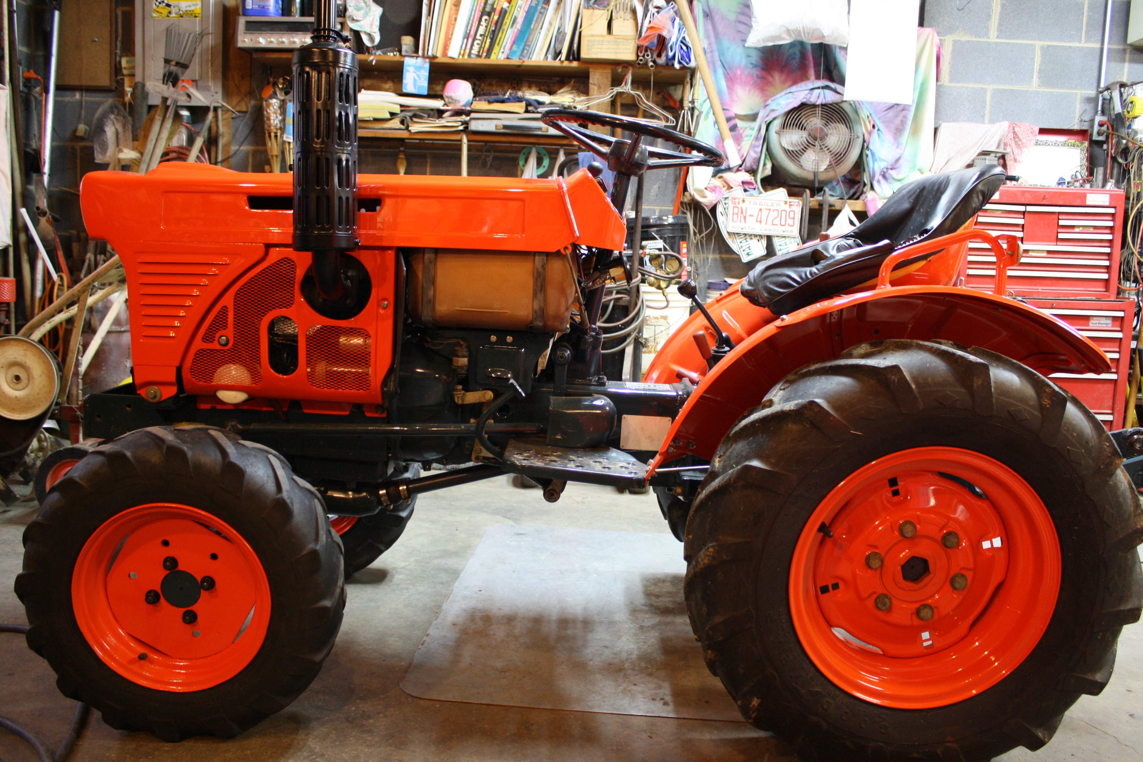

It's together. Ordered the rectifier, should be here Friday. Gathering the parts to install a temp gauge. Will order the Honda driving lights that 6mmbr installed in his B7100 and install them using the brackets that he fabricated and so graciously sent me. Thanks again 6mmbr. Had to borrow 2 knobs from my salvage Ford 1210 for the throttle and HL shifter. They fit well but aren't red. Will decide which decals I want to replace and order them soon and hope to find a inexpensive seat cover. Also used the Ford top link which has grease fittings because the one that was on the Kubota could not be freed up due to rust.

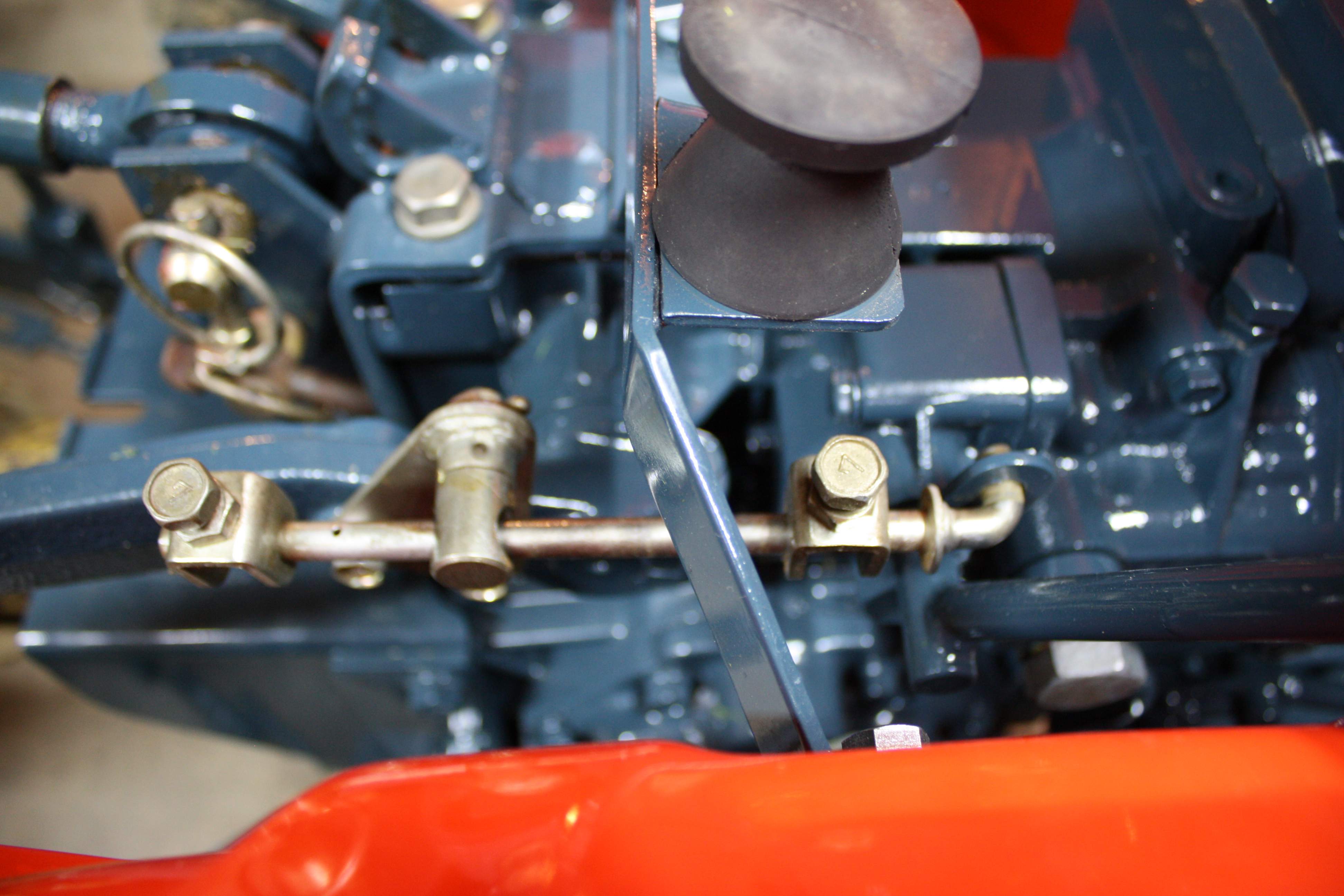

I've been out using mine and have been pleased with it. I have to figure out how to adjust the amount of 3 point drop - right now its all or none. I think there is a piece I'm missing that allows it to set down only so far.

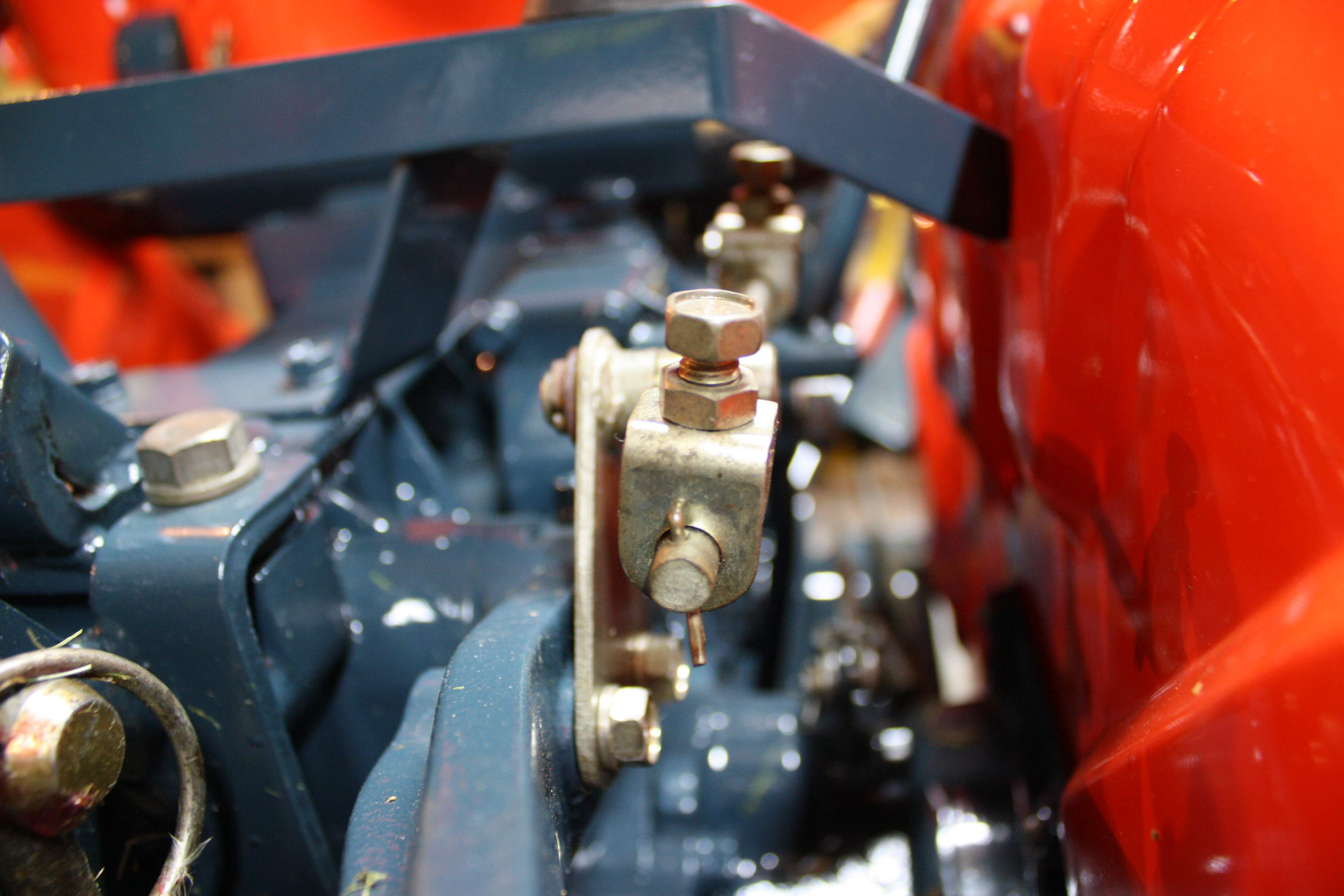

Does yours have the stop adjustment on it like is shown in the pictures ? My lift does not work like any other tractor lift that I have used before. I am having a difficult time learning how to work it.

/ B7100 Restore Project Has Begun #113
Aha!
That is what I'm missing.
Thanks - picture is worth a thousand words!
Monday: another call to Coleman's!

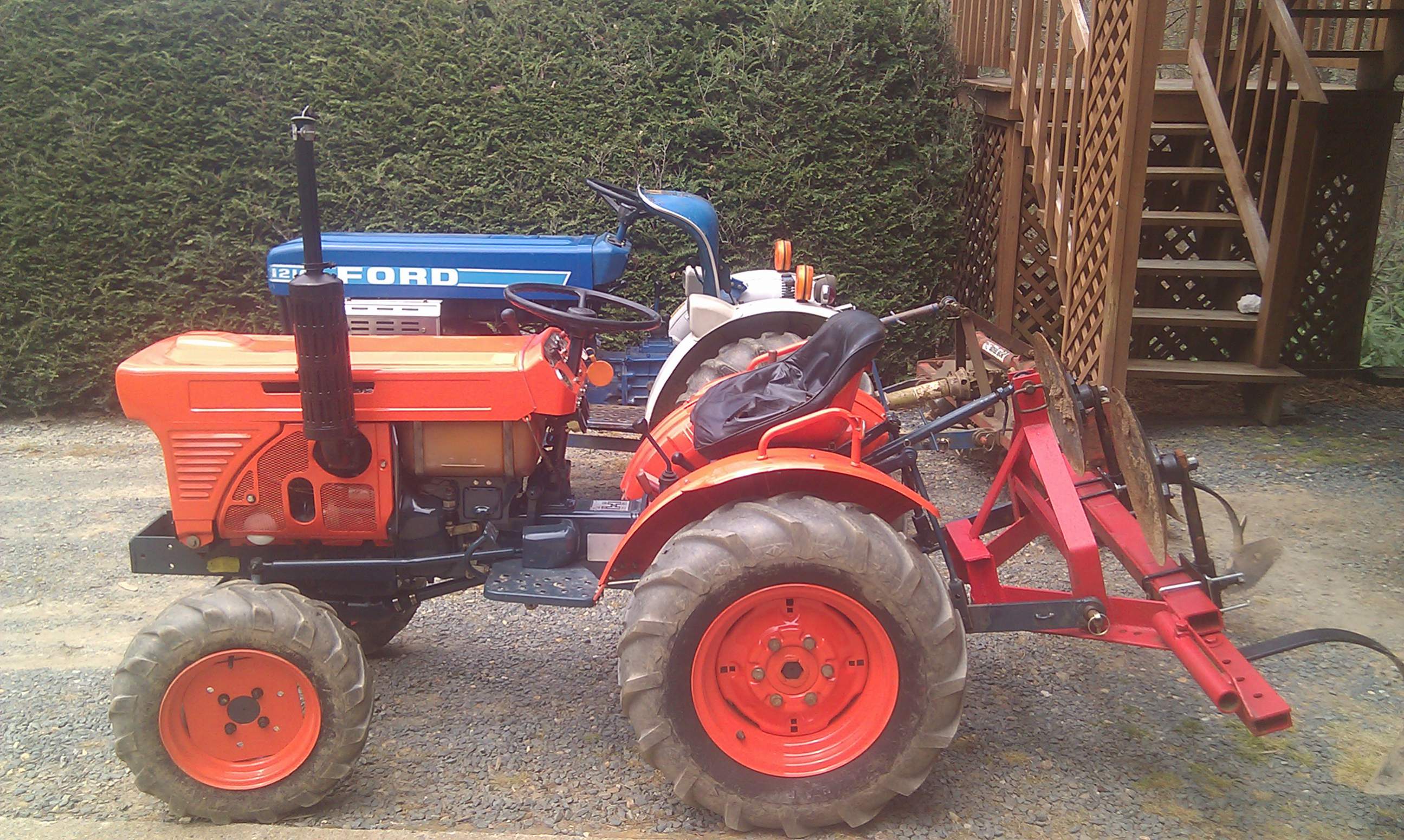

Put 4 hours on it today with the 48" Bushog brand tiller and the 42" bushog. The machine did well but the engine temp does concern me. When working hard it runs 200 to 220 degrees but shows no signs of overheating. Normal working temp is around 190. It used about 1/2 gallon of fuel in 4 hours of work. The machine is very light in the front without the loader or wheel weights on it. Did not have the camera with me to get any working photos today.

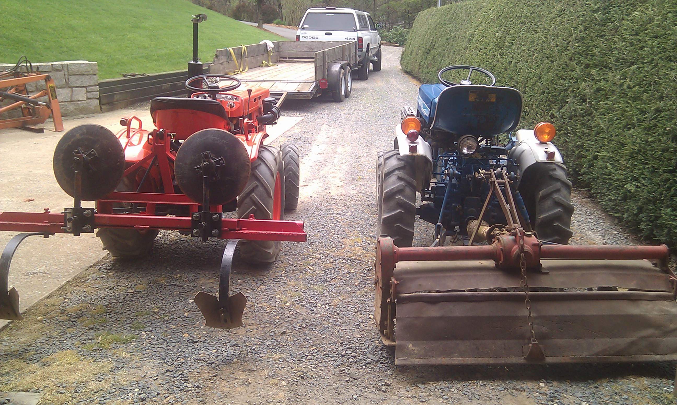

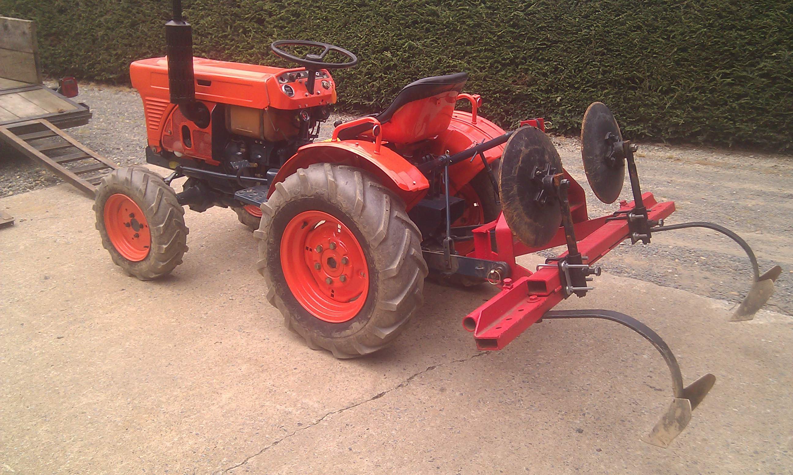

Used it today to plant 1/2 acre of taters. Until I figure out the problem with engine temps while using the PTO the Ford 1210 will do the tilling and the 7100 will do the laying off and hilling using the hiller/layoff plow that I built in 2010.
