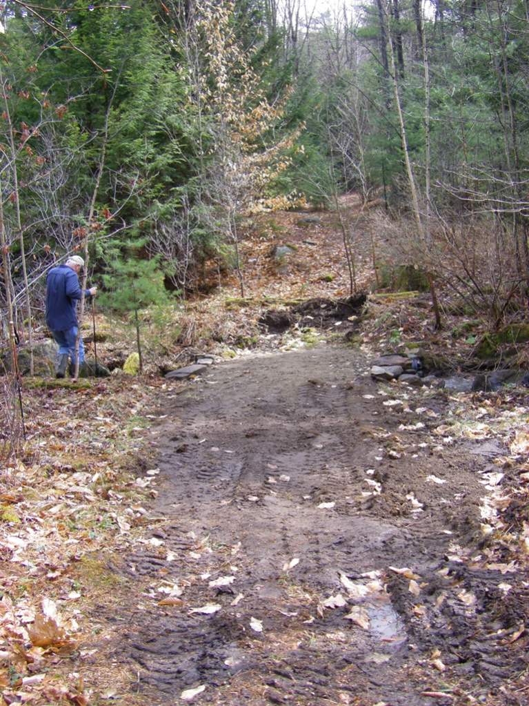

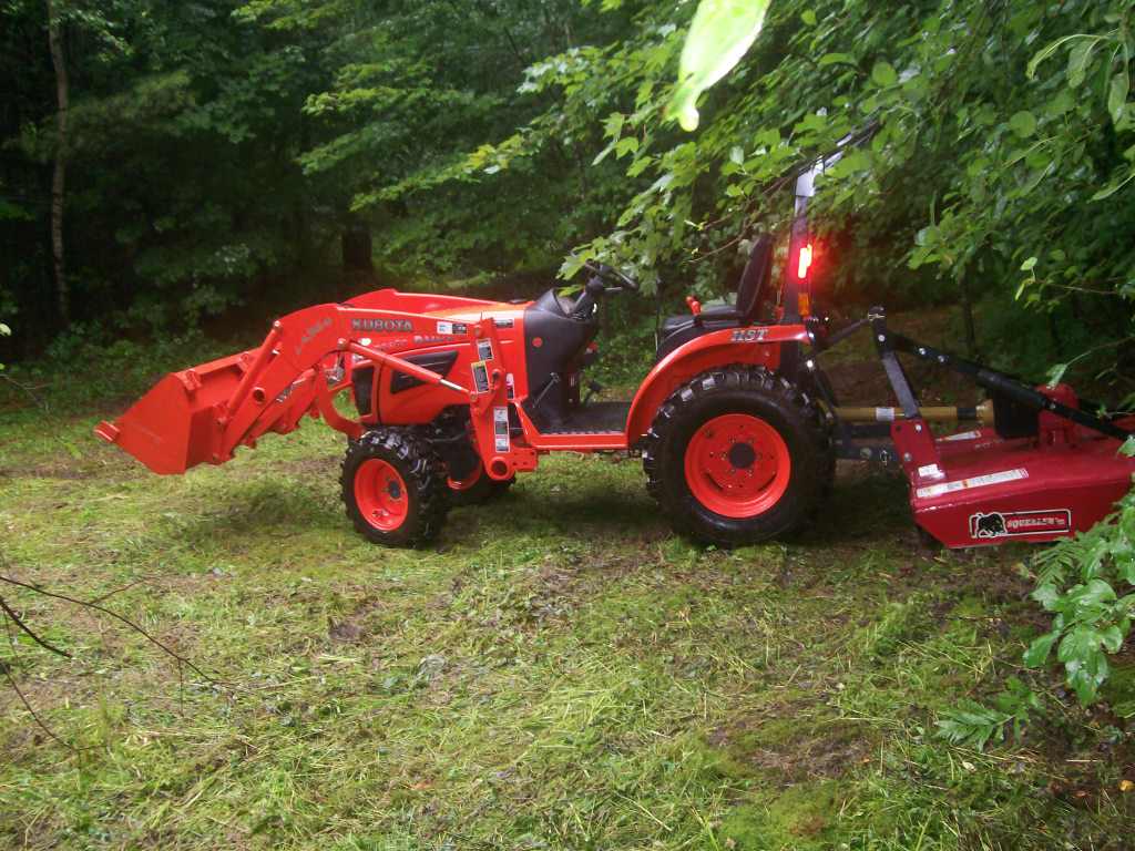

I agree that the smaller B is a great size for most projects, especially close to the house, finish mowing, etc. when compared with the larger tractors. My B2620 works fine with my 4' rotary mower, but I've never had a larger one on it so I can't speak to that. I've used it to work on my trails in the woods, and it has been great there too as long as I keep things in perspective, and don't start pushing on things that are just way too large.
