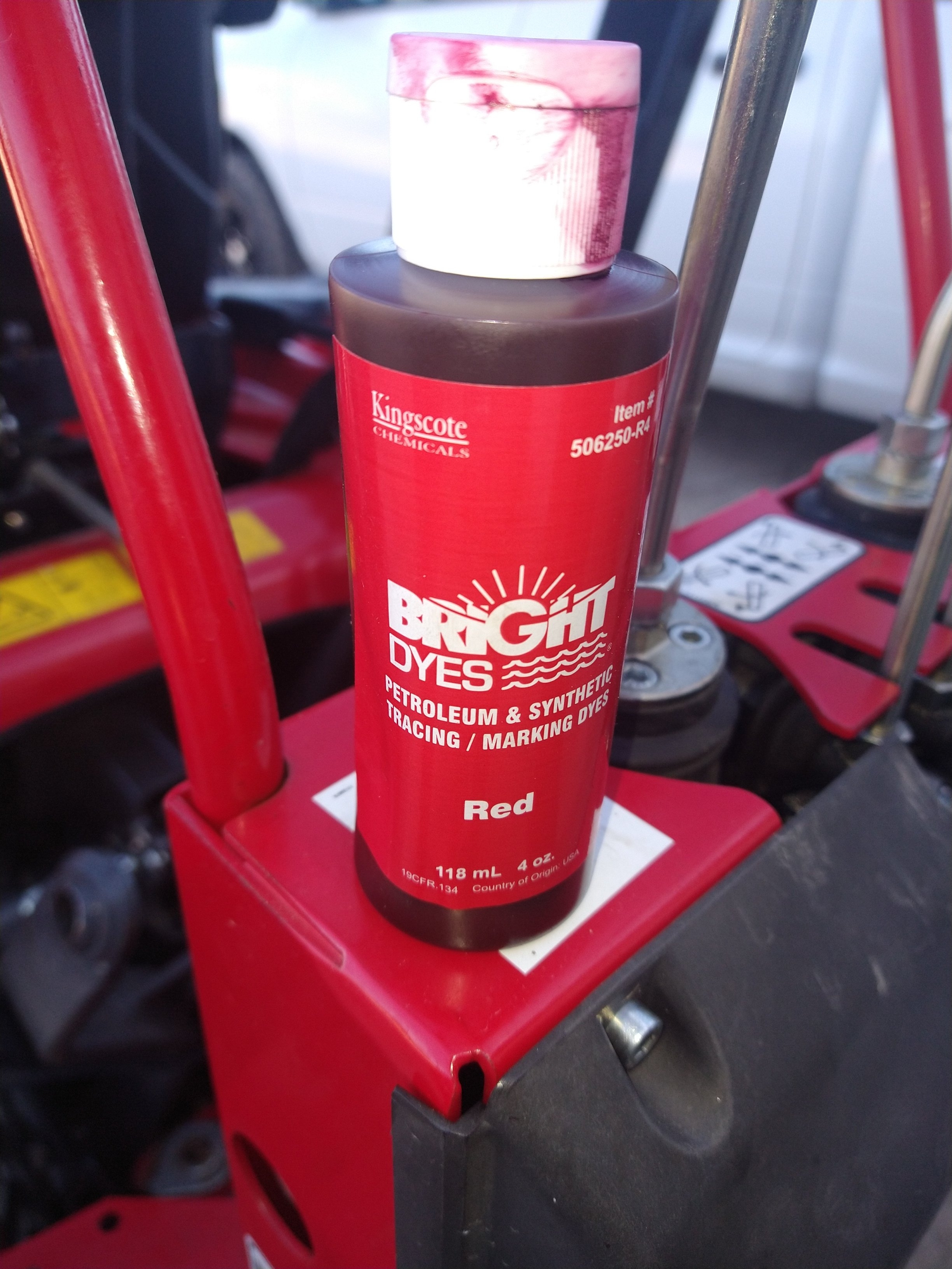

JD sells it, it's expensive per ml, you might get 2 fills out of it but they suggest it's for 5 gallons (if it's pasty or dried up, add hydraulic fluid and stir!) ... I bought mine from https://www.zoro.com/kingscote-dye-...red-4-oz-506250-r4/i/G5130815/#specifications (I bought some gloves also to bump total up to get "free shipping!")
Wear gloves, I recommend pouring/dripping it into the jug, then pouring into tractor ...
2 drops per gallon ...

I use the JD dye. It works, turns the oil red. Does not take much. My L3600 has a sight glass, could not see the oil without the dye. Easy, just pour it in. Might mix with some of the oil to pour easier.
I use the JD dye in my 25 year old Kubota. It works great

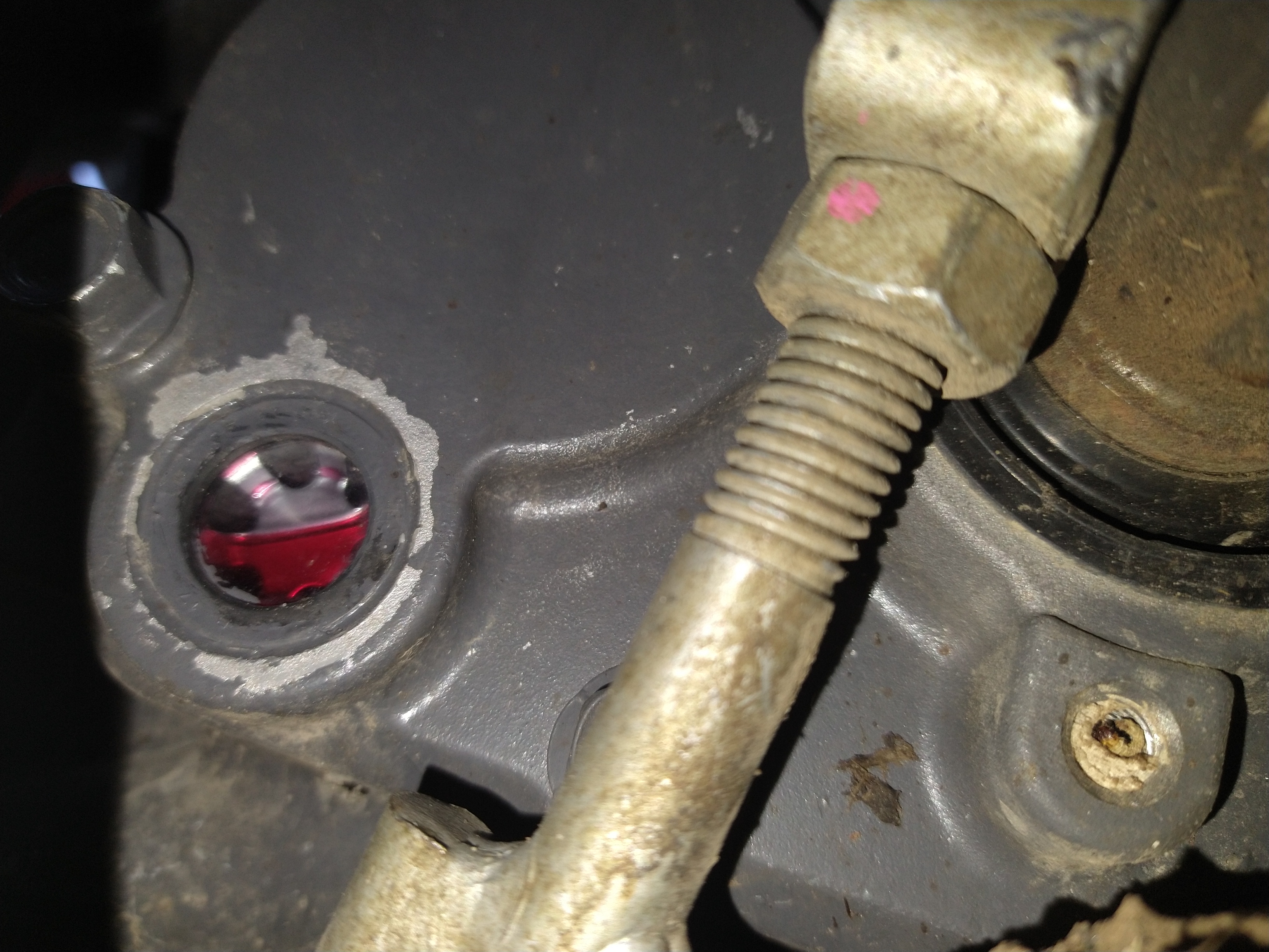

I can see my fluid in the glass fine in the daylight, but in my shed at 5am it is like a cave and I only have.... the equivalent of a 60W bulb that does not give me light enough to see the fluid in the glass and my flashlight and drop light both cause too much glare on the glass to see un-dyed fluid. With the red dye I have none of these issues.

Yep... confirmed, fluid is red. And now that I can actually see it, I can see it's also right on the mininum line. :ROFLMAO:
Will add more tomorrow. Color is very faint, as bottle is spec'd for "up to 5 gal" and my system is more like 8 gal, so I may even pick up another bottle.

I'd give it a bit more time ... Especially after you wash some more down when you "top it up" ... I know a lot of people that say it's really enough in that tiny jar for 10 gallons ...
