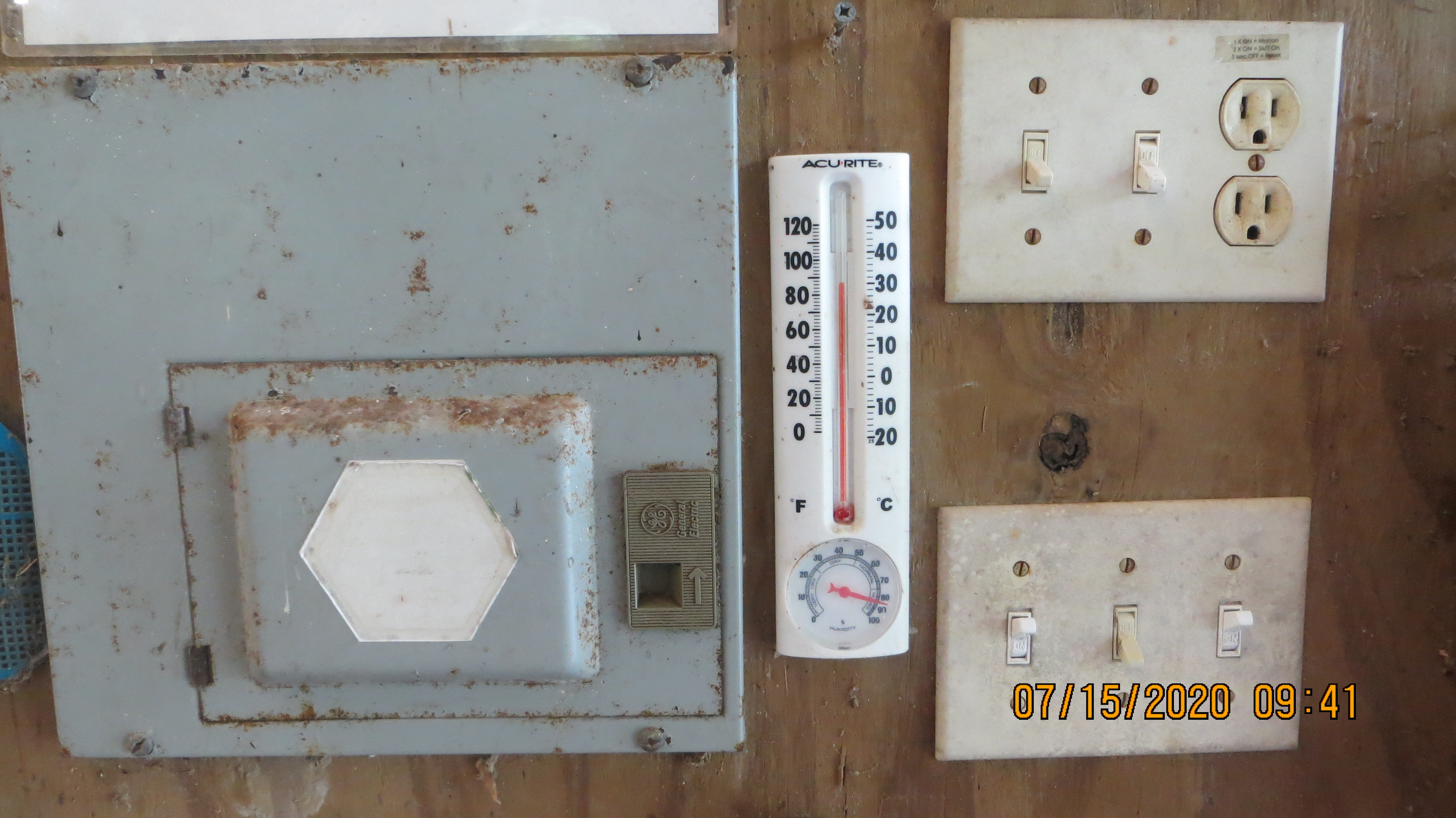

Actually, the Poor critters probably got between the contacts, got fried and left residue on the contacts. What else could it be?
But, those must have had to be pretty small ants.
/ An electrician's nightmare. #22
Wow, I searched "ants in switch" and found tons of articles. This is a bad problem. :eek:

Well, shoot.. now we will never know for sure what killed those switches all at once. But the ants are surely suspect.

We've had problems with those little ones called sugar ants. Couple of GFCI outlets full of ants and outside plastic "sealed" electrical box with some electronics in it. I went to the box to unplug a piece of gear, to reboot it and when i opened it, it had a nest with eggs, in it, ants on and inside some of the gear. I cleaned everything off, including the inside of the box, with isopropyl. Put some jelly with boric acid mixed into on pieces of tape inside the box. Used the jelly in the past, and the number of ants have really reduced.
/ An electrician's nightmare. #35
Our first home was a mobile home and it was terrible for ants in the light switches. You could tell when they were starting to build in the switch box because of the arcing sound and the faint smell of cremated ants.

LOL...Soooooo here we go........in 1998 here in south Texas both our parents homes got flooded out. So after the big rebuild of them both I looked at the switches. (horrible condition). Again 23 years later one of the houses gets rehab again after Harvey...
This is not a mystery and the ants get to much credit.
Buy another one of those 63 cent switches and buy one of the 2 dollar switches. Take them apart; or just hold one in each hand and 'feel' the action of each one. They may be rated for the same application 15 amps, but the internals have a big difference.
Personally I would replace them with a 20 amp rated switch. The lever action is quite stiff but the contacts have a sharp snap. Take a listen closely when flipping the light switch under the right (noise wise) conditions you can hear the contacts crackle. That is the sound of current passing through poor surface contact pressure. The 20 amp units, no problem. Those puppies slam fast and hard. So no matter what the future holds the switch can handle a few more additions easily.
You get what you pay for. The contact surface is less them 2.5mm, the leaf spring movement is weak and contact pressure is minimal at best. It's a wonder they survived 20 plus years. The switches and receptacle I replaced after Harvey were the same BB store 68 cent switches. Maybe three of the 12 to 14 switches replaced fell apart in my hand during wire removal at the terminal. The contact (such as they were) areas were very pitted so in reality had very little current carrying capacity with reduced surface area. Arcing burns reached up to the inside portion that made the termination.
You got more then your money's worth.
Spend the 2 or 3 bucks, per unit, get better quality switches and call it done, for the next 20 years.:drink:

Man, those old mercury filled switches were "HIGH QUALITY". I guess you could always get specification grade or hospital grade switches too. IF it was ants though, unless those better switches are sealed, that same thing can happen again on expensive switches.

Yah gets what ya pays fo'....68 cents last more then five years call it good.......there are better quality 15 amp switches for 2 bucks or so.
I bought the 20 amp because I plan on adding four more shop lights to the same breaker circuit.
With only five shop lights, I could hear the cheap 68 cent model sizzle.....arrgh....nah ain't staying.....
