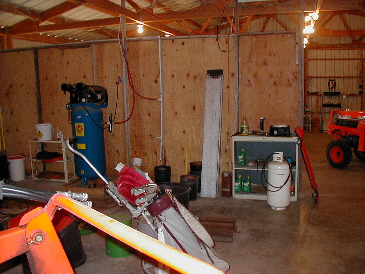

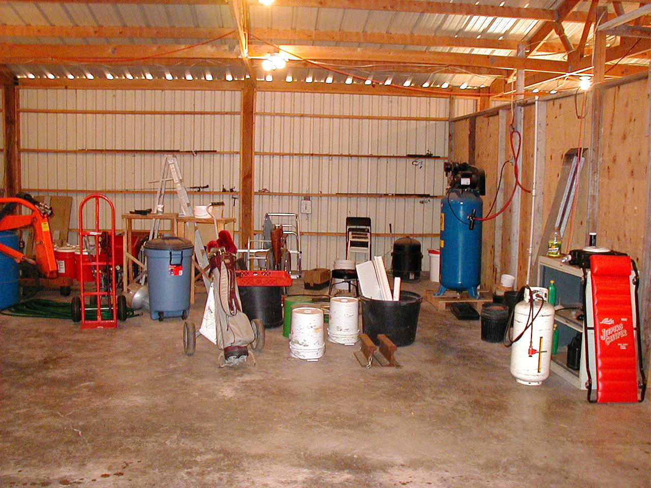

Of course the Puma is made in China, but the dealer I bought mine from (Industrial Air of Texas in Arlington) said he had some running in commercial locations that ran continuously for hours. And mine did, too. In fact, I bought it on December 9, 1998, to replace a 3 year old oilless that I had rebuilt 3 times. I used a compressor back then enough that the oilless couldn't make more than 6 to 8 months at a time.:laughing: As for how loud it was, I really couldn't say, but I think it'll be quieter than your oilless. I had it in a 60' x 40' shop on the other side of a plywood wall from my workbench. When I had to move back to town 4 years later, the realtor who arranged the sale of my place also had a very nice ranch, and he bought that Puma air-compressor from me.
