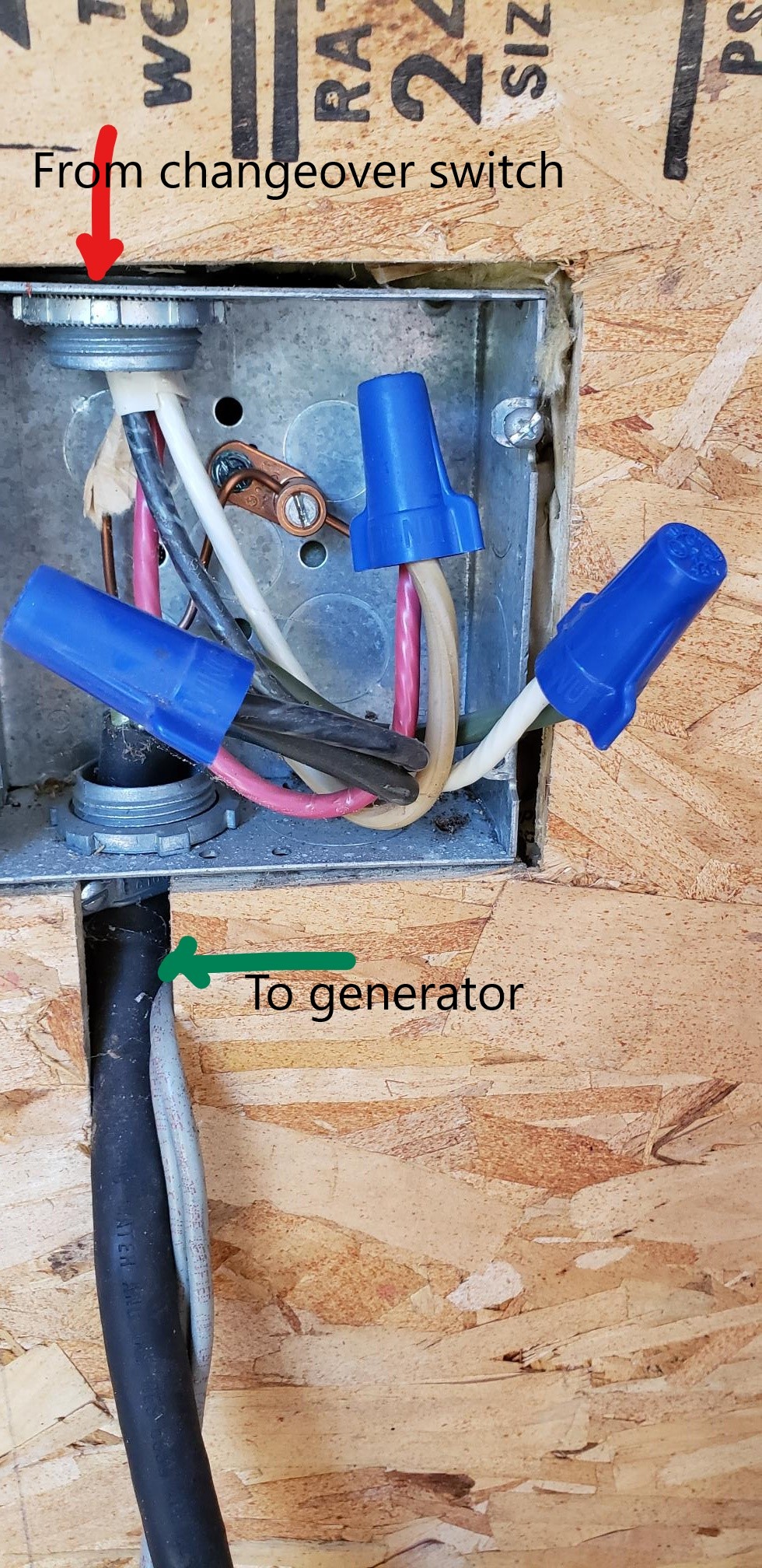

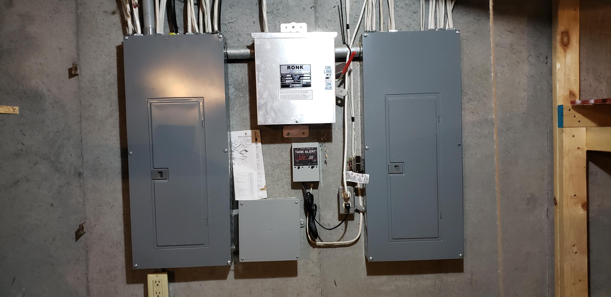

I need advice on how to wire up my generator to my house.

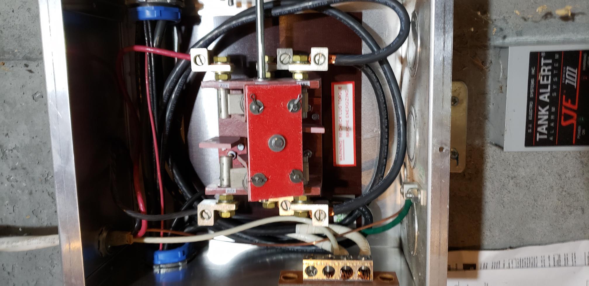

The house has already installed a manual transfer switch the services a sub panel for critical circuits. The main panel and sub panel are in the basement and the wire for the backup generator runs into the garage.
During our last outage I realized that using a 5kw watt generator I could not get a lot of the circuits powered even though the usage was less than 1kw.
Today I found out a few things

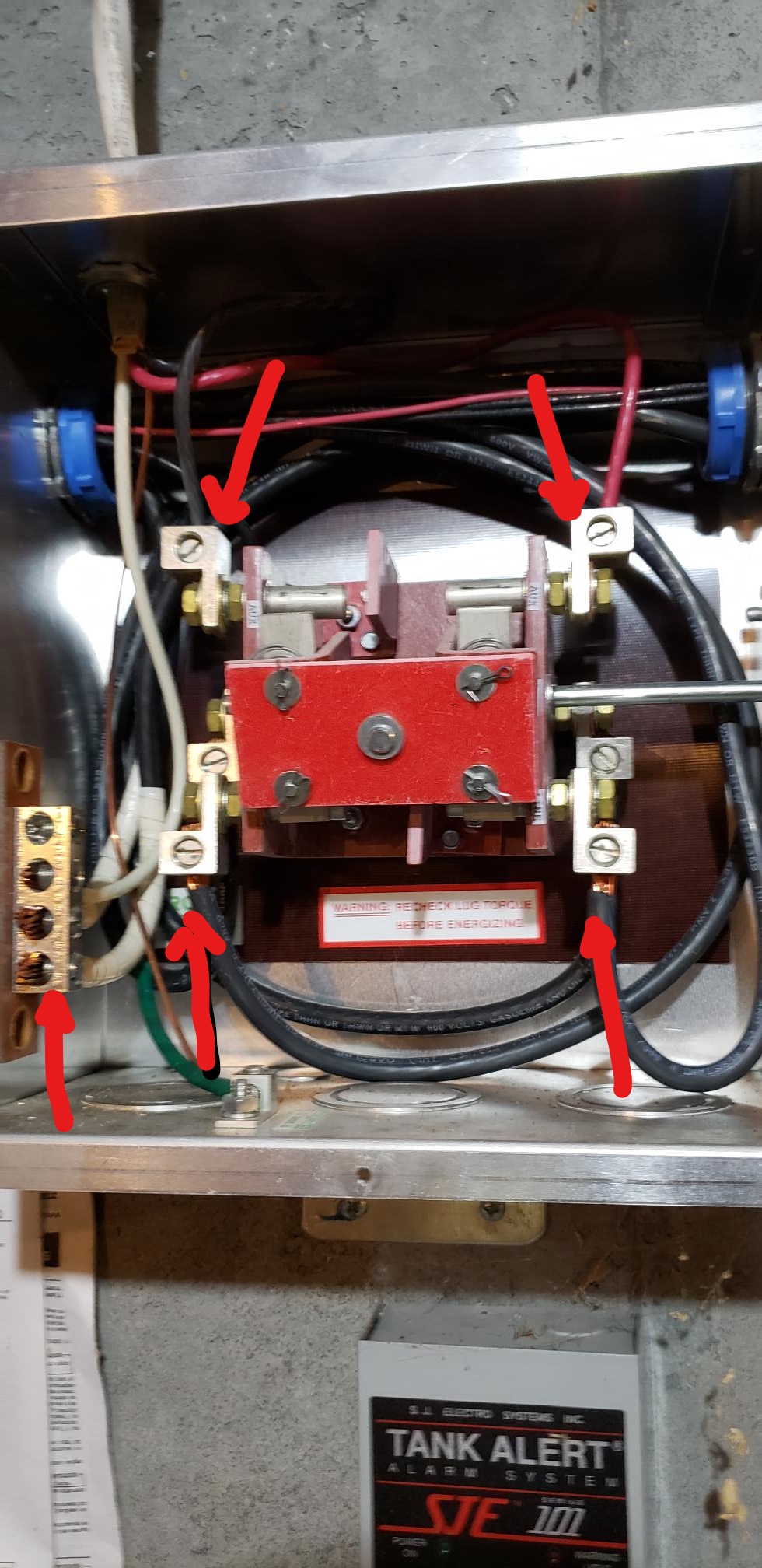

The transfer switch is wired for 240v, I suspect that I only power one half the way the connection is currently set up.

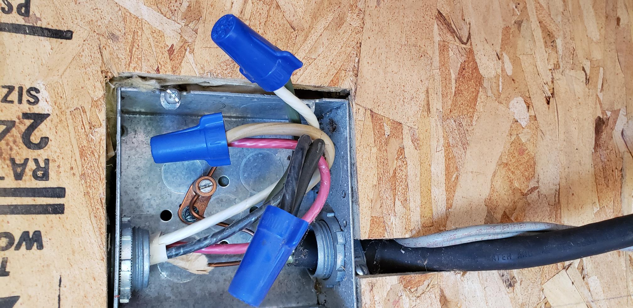

I have 3 wires (red, black, white) and a naked ground from the transfer switch to the generator hookup, but at connection box, red connected to white, black to black and the white to green (see image).
My question is what changes I need to make.
My thoughts are to change from a 3 wire black/white/green to a 4 wire black/red/white/green with the connection similar to what we have from the switch and the naked ground connected to green.

The box you show is probably wired for the 240v but either without the neutral (somewhat normal) or without the ground (not so good).
You don’t really explain what the “box” is or does. Nor do you tell us what your gen is- 240v or 120v.
Based on you lack of knowledge on the subject I’d be inclined to suggest you phone a friend or hire an electrician to help you out.

Box is in garage where connection to generator is made, changeover switch is in the basement 30 ft away.
/ Advice on Generator Backup Wiring #5
Coming from the generator looks to be two blacks and a dirty white. From the transfer switch a black, a red, a white and a ground. I would not connect like that but it really depends on how it is connected at the generator. I would keep white to white, black to black and the other black to red. Actually I would get matching wire colors. I suggest an electrician, there is not enough information here. Who made this connection? Is your generator 240V?

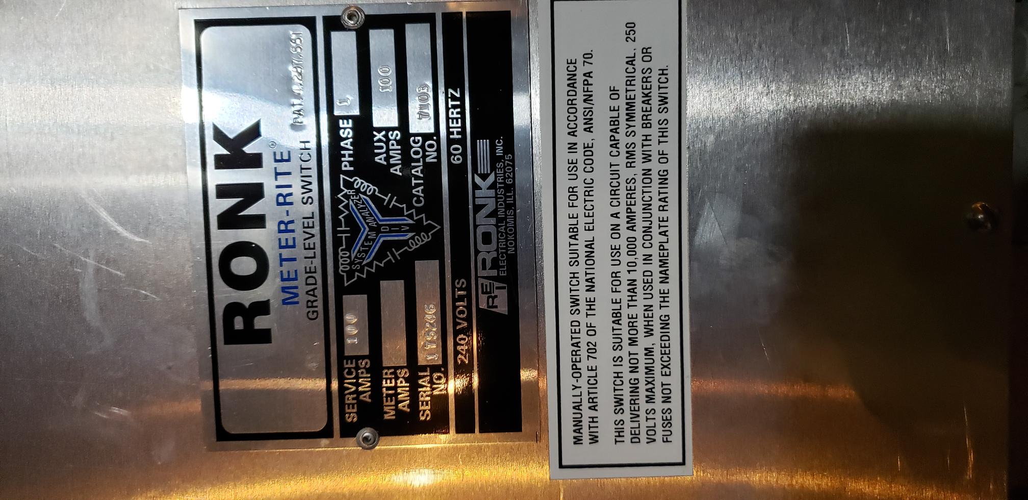

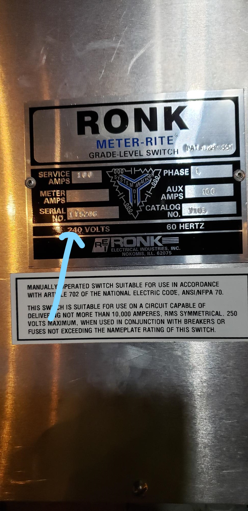

The generator is 120/240v
If you look at the transfer switch, it is a 240V switch. There are two black live wires and a white neutral for the line and for the aux we have a black and red live wires and a white neutral.

Nothing needs to be changed, buy yourself HARBOR freight multimeter. What we can't see is the connection at the generator. When the Gen is running find out what two wires give you 240. since you only have three wires. They will line1, line 2, neutral, the generator will not be grounded.
/ Advice on Generator Backup Wiring #8
You need a 4 wire flexible cord and a 4 prong male plug that connects to the generator receptacle. Not sure what the person who wired this was thinking. What should be the neutral (dirty white conductor) coming from the generator is jumpered to what is presumably a hot conductor, which should give you a short. I suspect the black wire that connects to the white conductor is connected to the neutral prong on the plug you have now. I'd like to see how the plug end of the 3 wire cord you have now was connected. I wouldn't use this setup until you get it corrected. Also would be good to see a picture of the generator receptacle.

Green or bare, ground,
white wire should be neutral,
red wire should be hot,
Black wire should be hot,
Hot to neutral should be 110/120 volts, hot to hot should be about 220/240,
ground to neutral , should be 0 volts, hot to ground should 110/120 volts,
since I don't know how other things are wired,
post 4 , looks like a neutral and a hot is miss wired,
but looks to me like you need some one who knows what is going on, to help you out, before you fry some thing,
