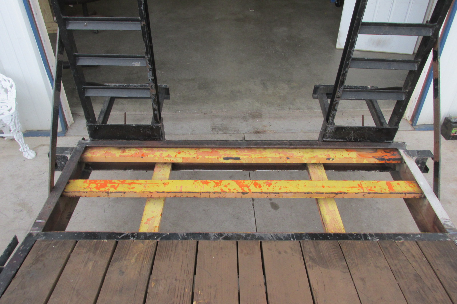

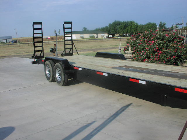

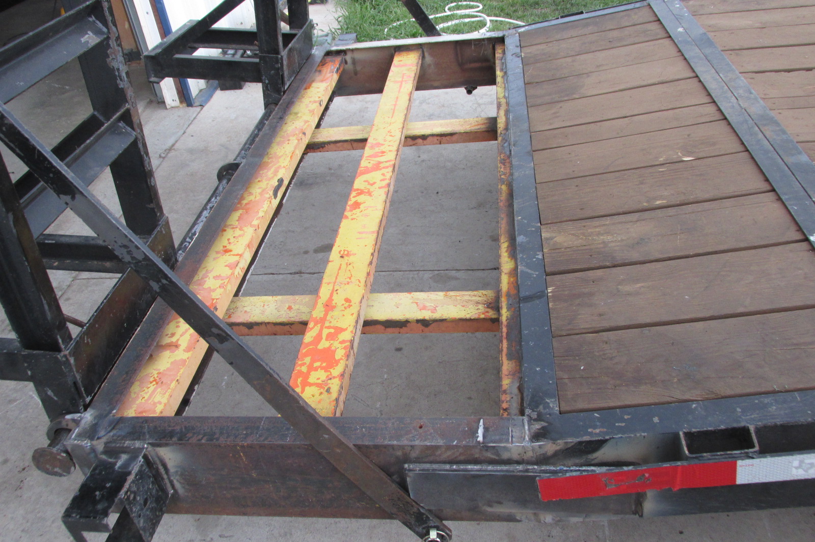

I added about 32" to my eq. trailer.
/ Adding onto a trailer lenth
#65
Nice! How far back did you move the axles?.
/ Adding onto a trailer lenth #66
I didn't move the axles because they were already way back. That was one of my problems, I had too much hitch weight.
#67
Lucky if I put on the 4' I will have to move them
